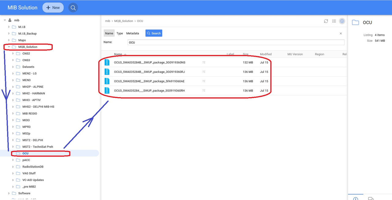

Hello, wich OCU is latest. I am looking at MIB Solution in category : MIB Solution-MQB_Solution-OCU. AM I looking ok ? There is 4 OCU.
I have Skoda Kodiak FL 2022 with MIB3 Amundsen and 330sw. Noiw I am downloading 332 from link above.

Hello again...can anyone help. Wich OCU is tatest or should I install all...ahahahaha ? Skoda Kodiak FL 2022. Amundsen MIB3.
Thx !

Which Software have the OCU now? 0330? No this is 5F or?

Wich is latest version of OCU ? Can you point nuber of latest version. Now I am on 332 firmware but do not now what OCU do I have. Did you download OCU from there ?
