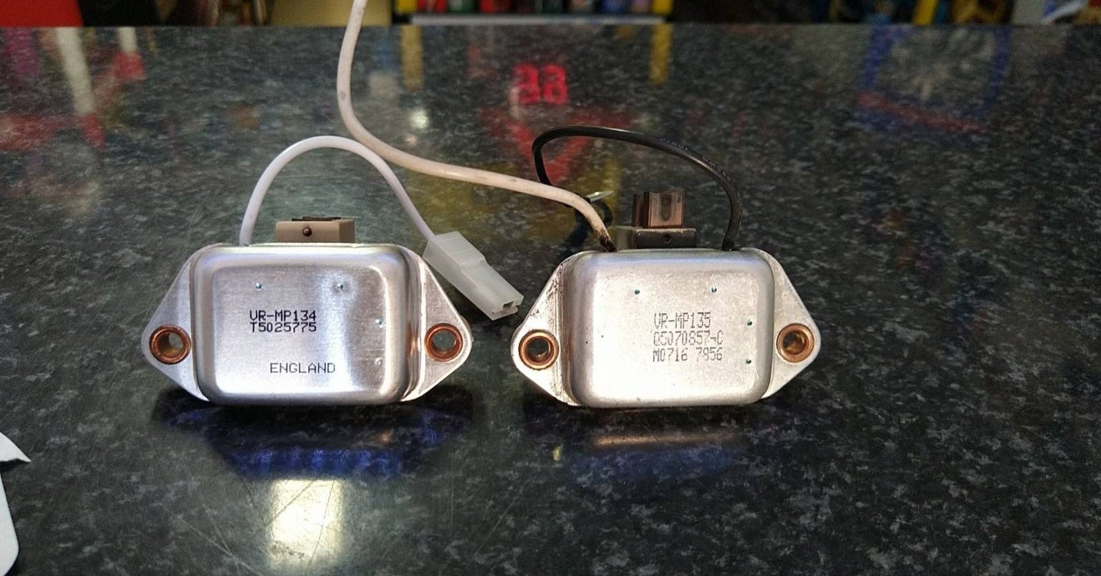

I already have a new battery, after that I put a new alternator regulator as shown in the picture, the one on the left is the new one.

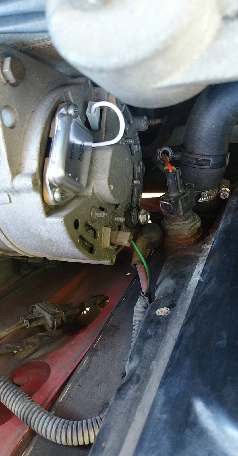

Installed on Alternator

The new regulator appears to have a different number on it, UR-MP134 (instead of UR-MP135) I have no idea if that makes any difference whatsoever though.
I have found many modern made electric parts to be crap straight of the box so do you know that this part is actually working as it should - the dent in the casing does not inspire confidence (unless you put that there).
Very old original NOS (new old stock) electrical parts may often be of good manufacture but more recent (going back 20 years in the case of Lucas) parts can be poorly made even if NOS.

You did release the carbon brushes as you installed the new regulator?
if you did, my next suspicion would be a breakage or bad contact of that green wire.

Yes, I loosened the carbon brushes when installing the new regulator.
I can give this green and red wire from the alternator feed a clean.

Alternator is not starting up. Check that green wire, it is probably not giving the alternator the 'wake up' current it needs.
Hmm.. thanks for the answer... but how can I test the green wire ? if there is signal ? I will also give a sandpaper the pin of this green wire.

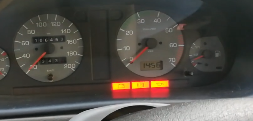

One thing I find strange, is the battery light that I don't think comes on when I ignition on (not start the motor)
Only show "Park and Oil" I think. I'll check it again
What could it be, if the battery light does not appear?
  • Sponsor
If that light doesn't come on with ignition, that is further evidence of a problem with the alternator excitation circuit.

@Joob @Breezy_Pete @nta16 - This makes sense to me now. I know that a 1998 Octavia 1 has alternator control wires, but wasn't previously aware that a Felicia even might have them at that age. Certainly a battery light not illuminating at ignition on is usually diagnostic of a loose, broken or corroded control wire.
