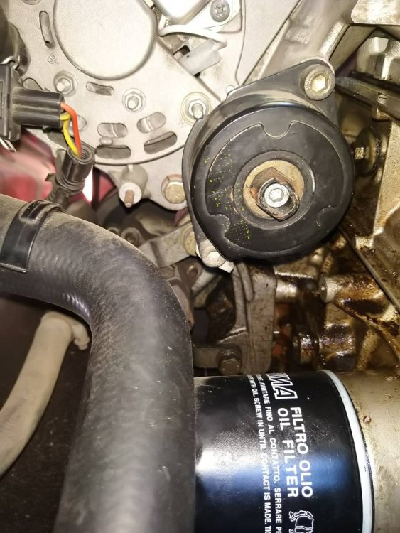

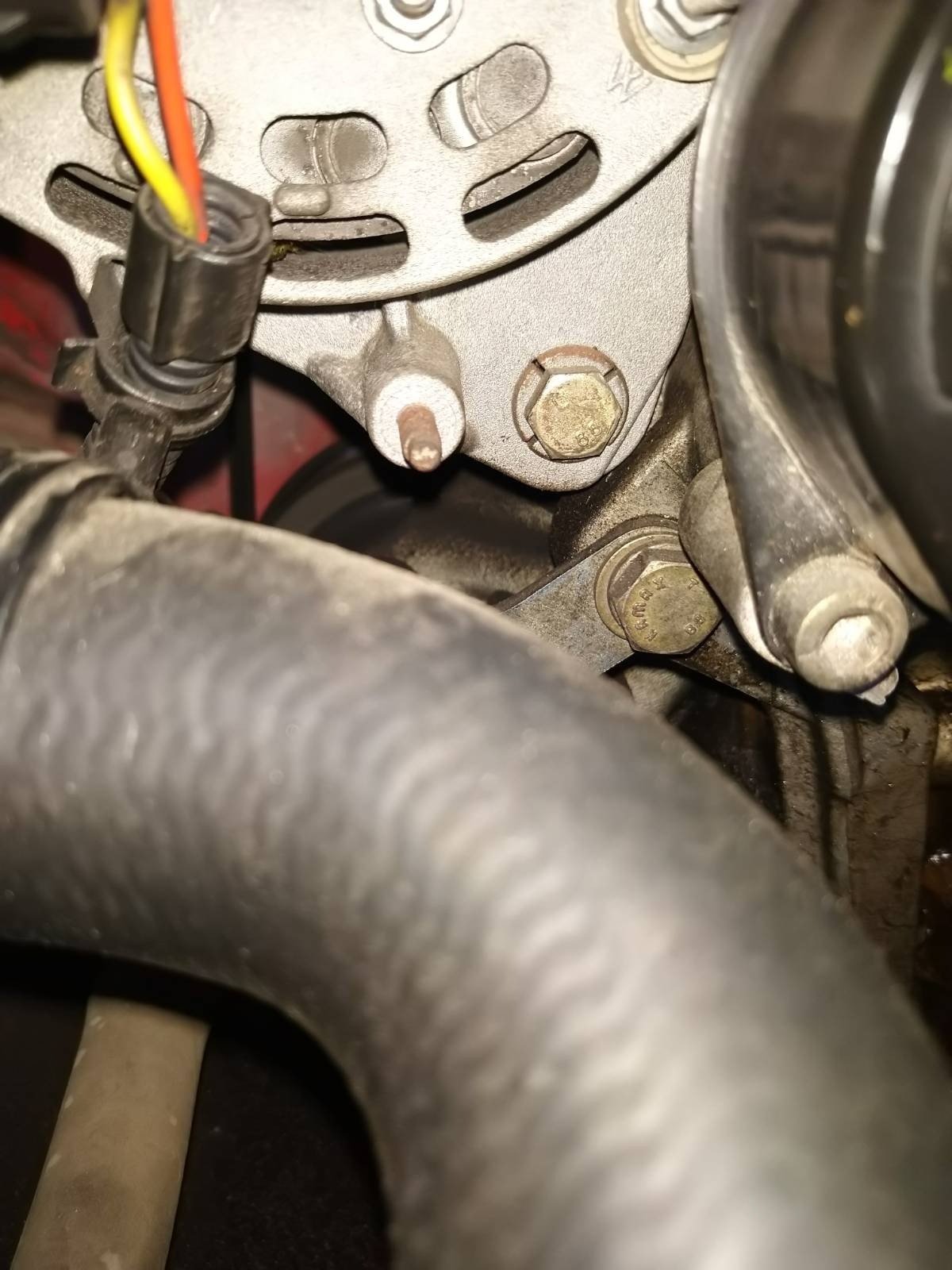

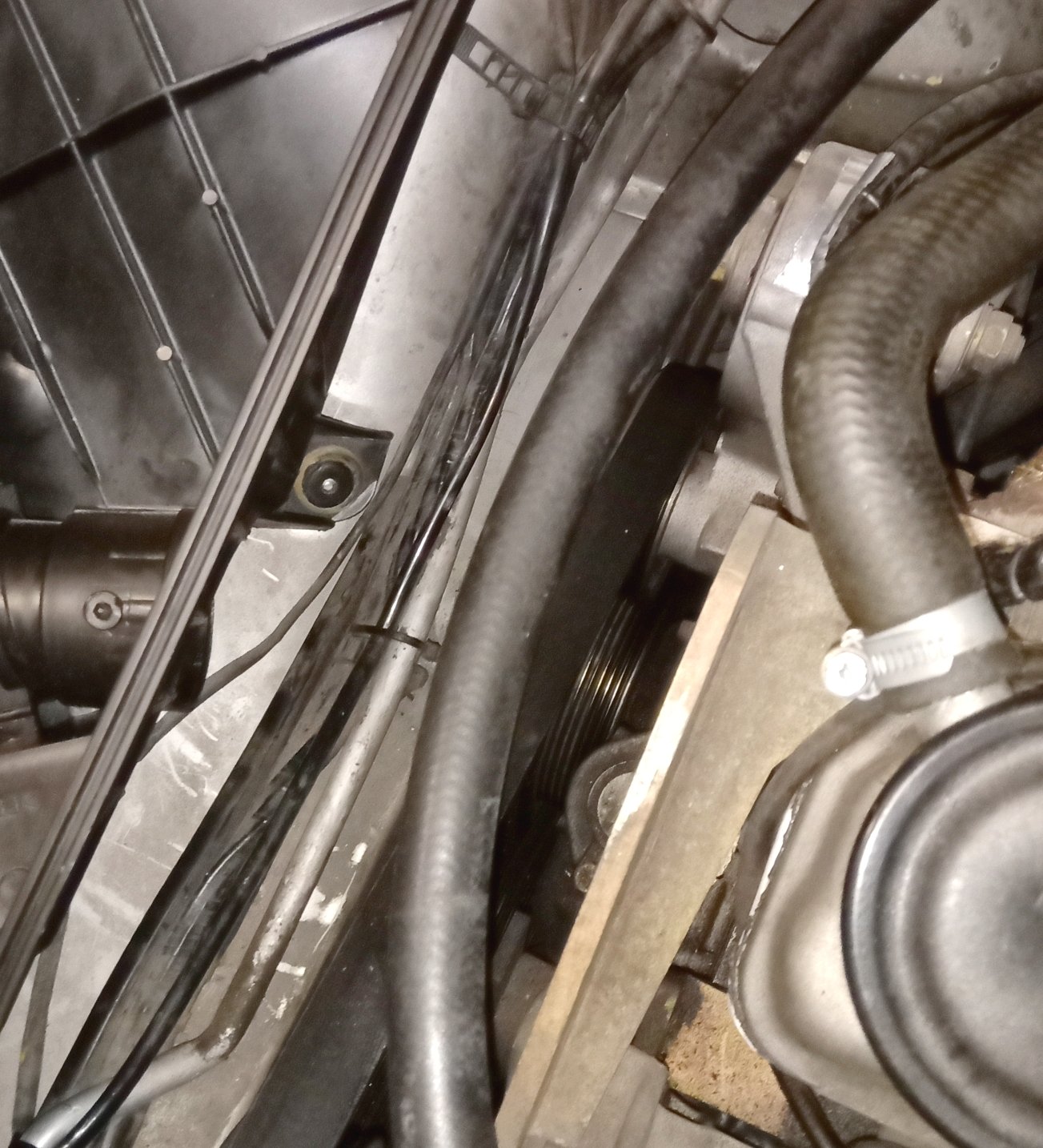

Guys, did u see how to change this alternador ?
I didn't see the regulator of tensor.
Under of alternator ?

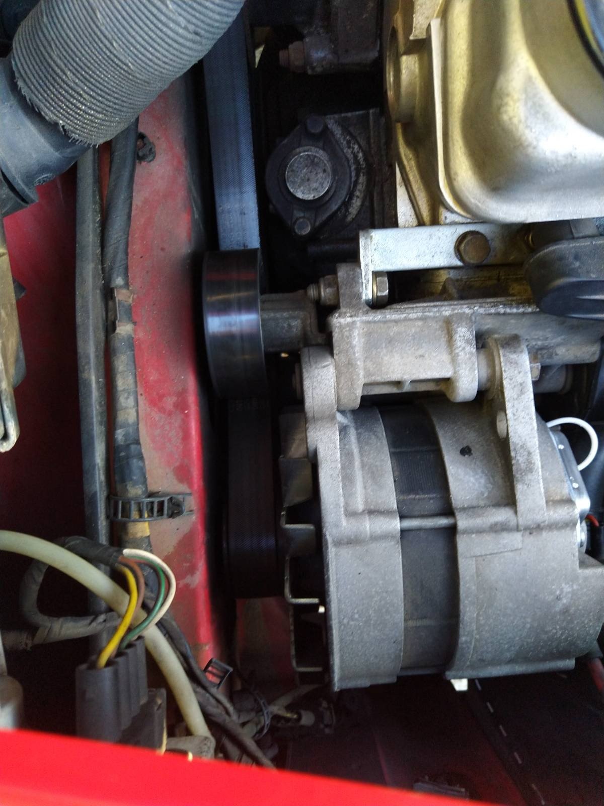

Something is WRONG, the belt must not be under the pulley !
The grooves must touch the pulley, now it's in reverse, who did this? 😲
The arrow shows the tension pulley, from there you can make things ''loose'' and work for example change the belt etc.
With the help of a lever and a hexagon socket you push a little bit and you have the proper cm to work.

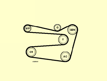

No, that type of post is very different from mine...mine is from a European car, that's why it changes for sure.

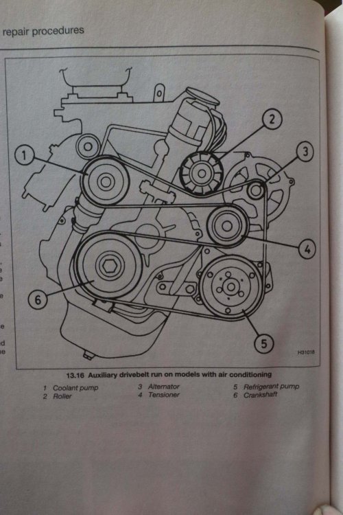

The tensioner on this belt should be the pulley with the letter T.
Then I will have to relieve the tensioner to loosen the mail, it is like the timing belt in cars.
I thought this alternator had a manual regulator and then bolt it on at the same time.

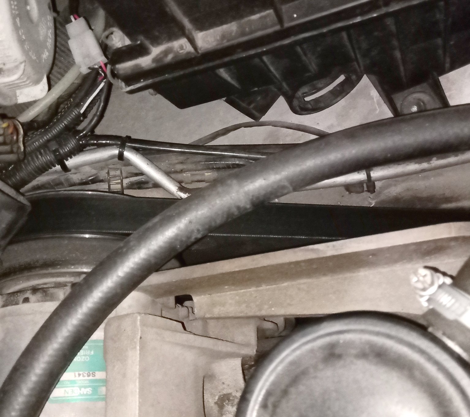

From the little that I can see from the photograph:
It is a different set up to the diagram and does not have the AC pump. (first diagram, joobs reply overlapped mine)
The poly V's on the belt are in contact with the pulley.
The roller shown is an idler pulley, it may be a sprung tensioner pulley or if it is fixed then belt adjustment would be effected by rotating the alternator on the pivot bolt shown.
The latter i am unsure of from a small photo and not knowing the engine set up.

yeah, it's like me, I've never touched this belt on this engine, I've changed the head gasket etc... but never the belt 😛
No, it's how it should be, it's how it came out of factory. Grooves must not touch the pulley - but kits that added pump or compressor above the alternator often used non-standard solutions.

Yes, under the alternator is a black cylinder with short shaft poking out of it. You need an open ended spanner to release the tensioner.

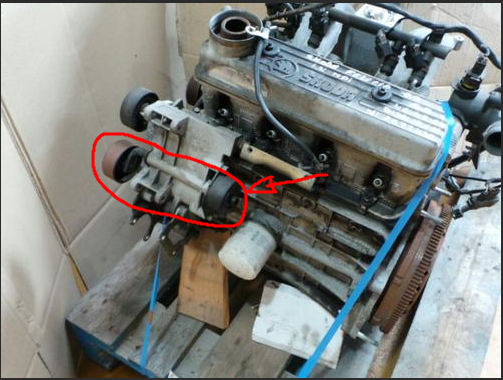

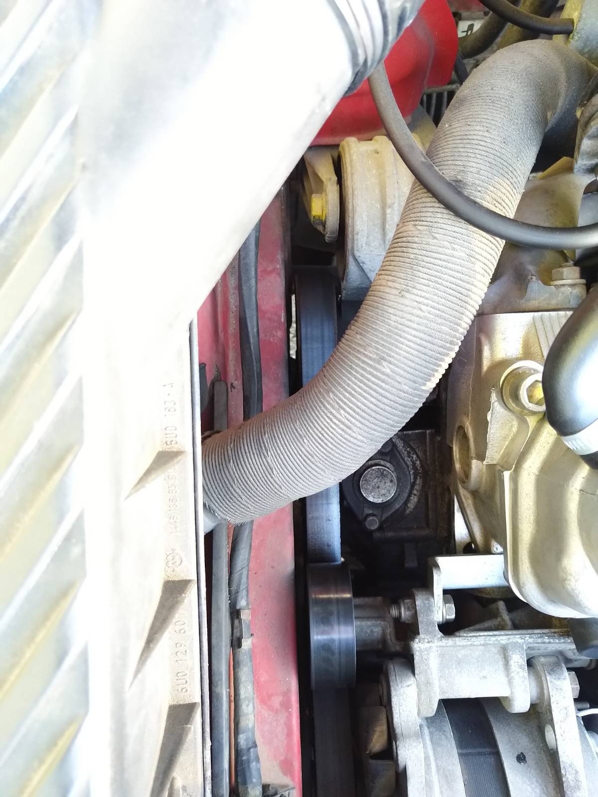

I have never seen in the past a Felicia belt this way that's why i reacted, here is mine, not good photos but due to A/C and power steering wheel things look different.

oh great, and the tensioner is under the alternator is that it ? ty

new image

Mine doesn't have air conditioning, it only has heating.

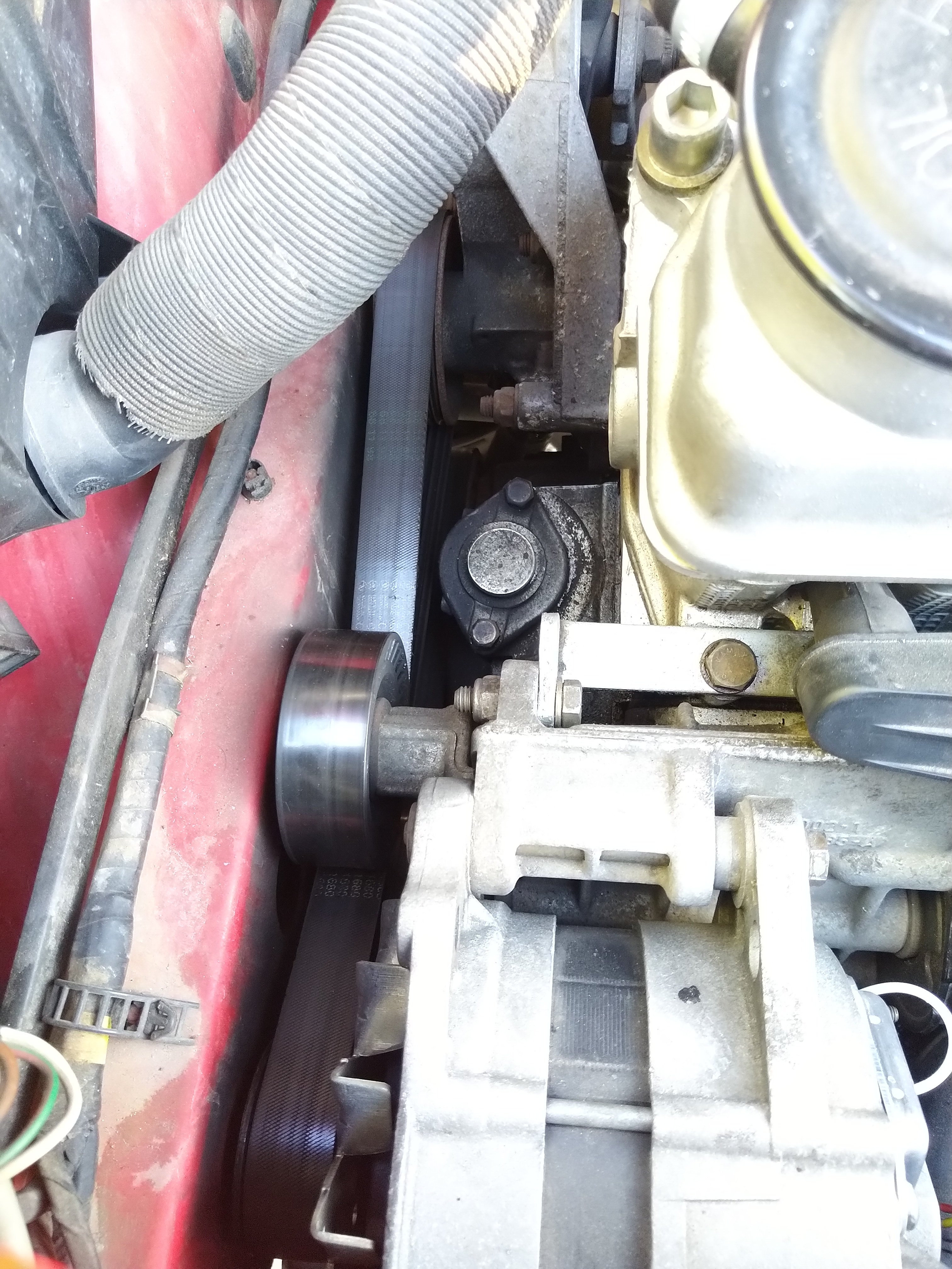

This picture is not of my car, but it looks just like my car.
https://ww2-secure.justanswer.com/uploads/MarkBarnes1967/2011-08-31_113037_skoda_felicia_1_3mpi_lump.jpg
Check the mine alternator/belt.
Edited by Joob
Yes, it's hidden under the alternator and routes the belt away from the crankshaft pulley and back to the coolant pump.
Yep, these conversions usually used the pulley pictured on Joob's photo to wrap the belt around the extra pulley, but on the factory setup, it was used as additional support between the alternator and coolant pump, probably to reduce vibrations.

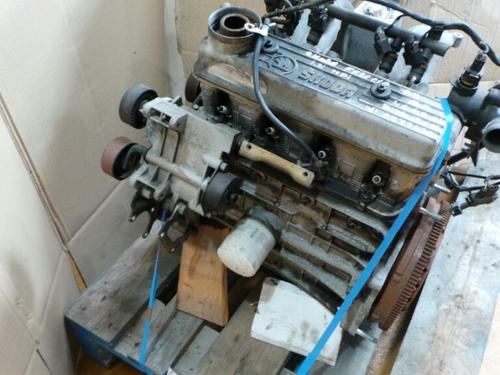

Ohh I saw a picture of the engine from the side.
Just ease the pulley further out on the right side ?
BP3484693M1 | Engine SKODA FELICIA I Pickup (6UF, 6U7) 1.3 BP3484693M1

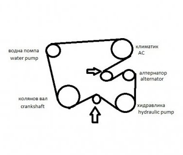

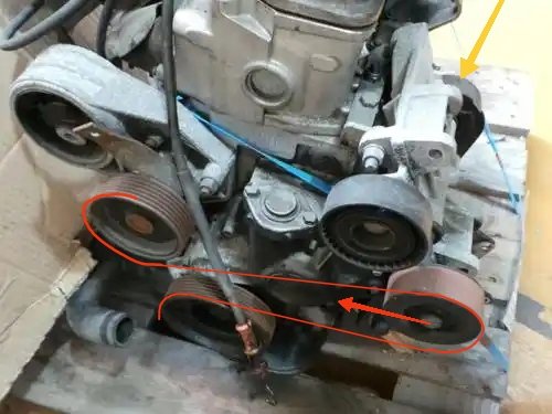

The belt goes like this in the car, you need to move the pulley to the left (towards the coolant pump/crankshaft).
You need a spanner to turn the shaft poking through tensioner spring assembly (yellow arrow)

On the other hand, it is like this.
I just need a spanner where the red arrow is now, to rotate the shaft.
