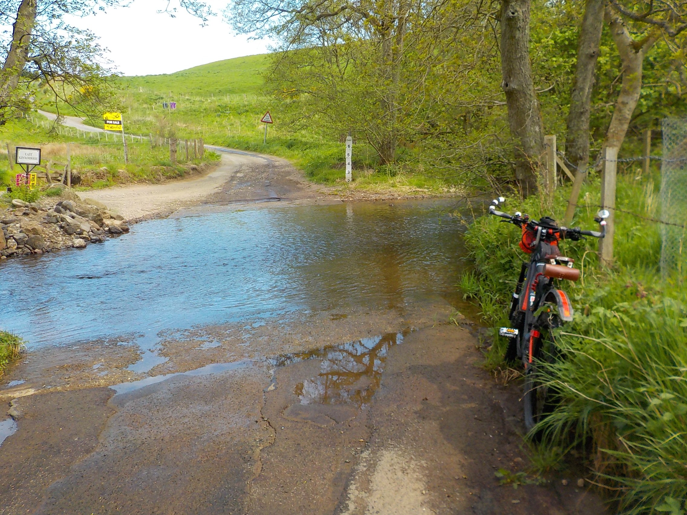

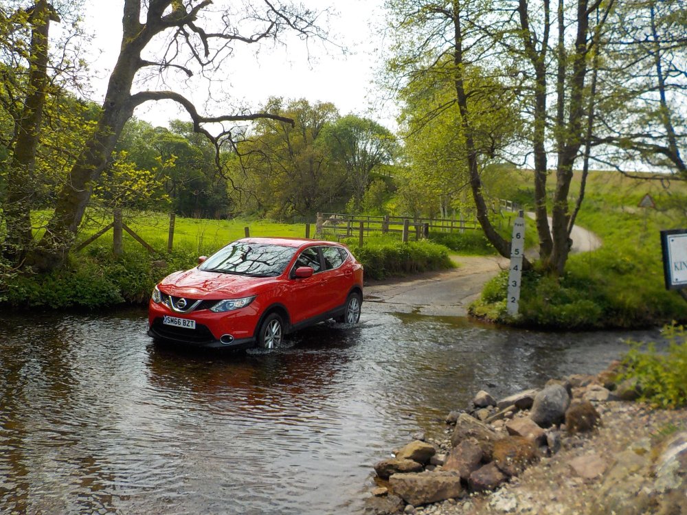

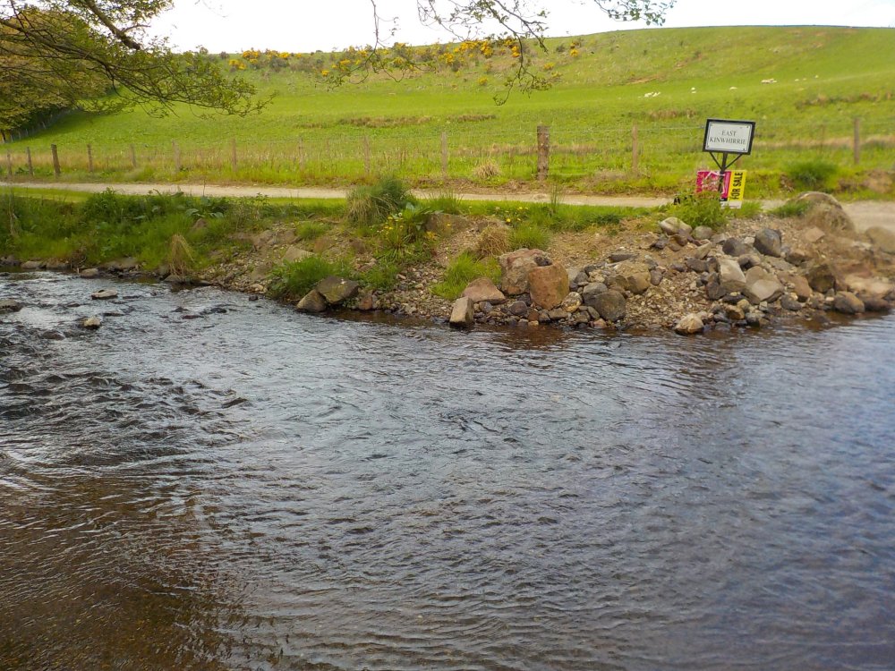

My local ford looks nothing when at the lowest water level, and even when a bit higher looks ok to go through but even on a heavy vehicle you get a shock when the car or even an offroader starts moving sideways downstream.
