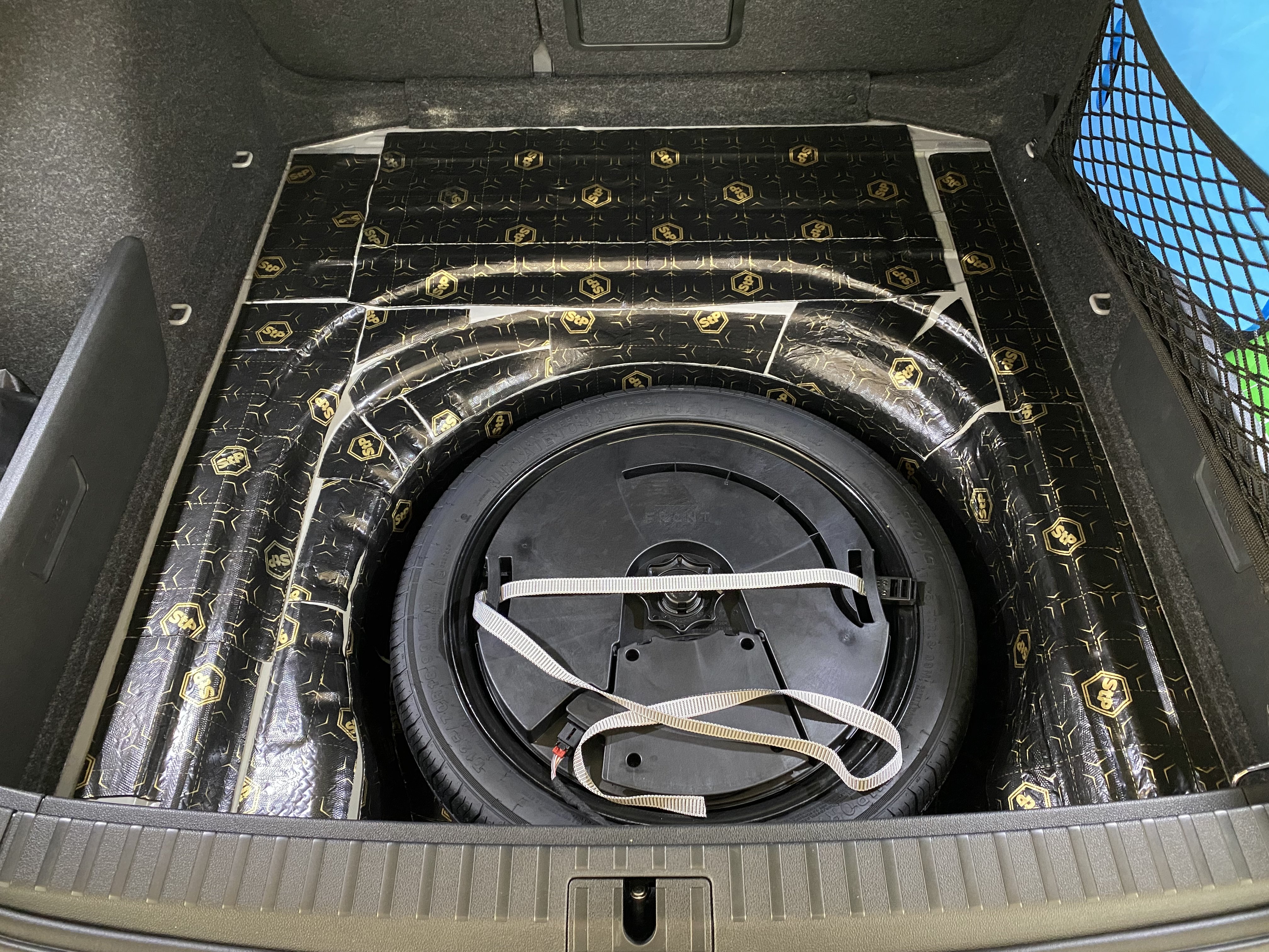

Hello, i like to add the spare wheel and all accessories in my Octavia, someone got this option as factory ? can you take me a picture of what it look like ? there is specific dampening material under the wheel to avoid noise ?
thank !
There are only a few small patches of a thin dampening material under the tire. I would suggest putting there a aftermarket sound dampening material which is thicker and it takes away a lot more sound and vibration.

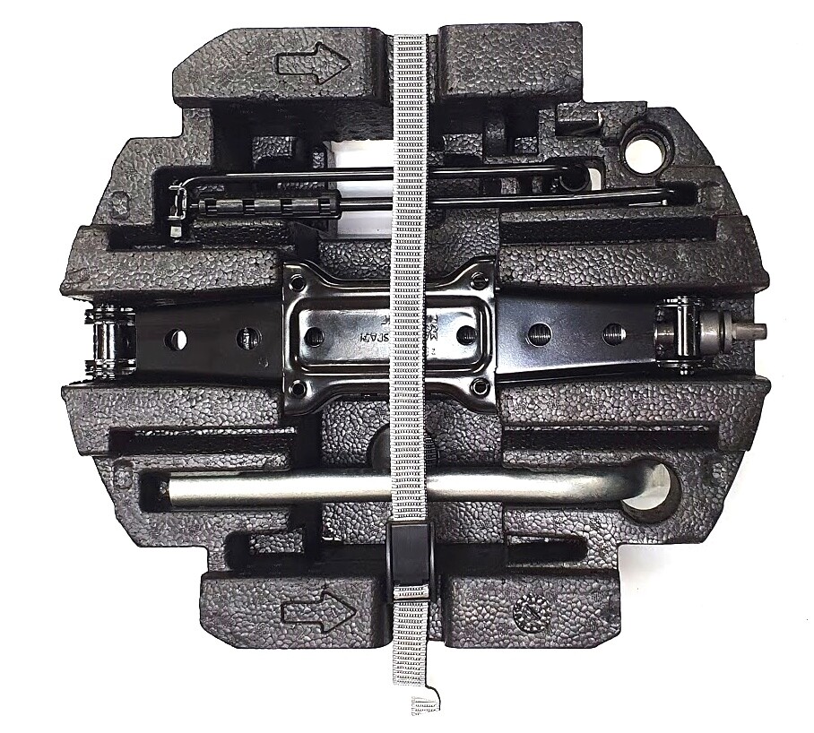

The foam kit including jack and everything except the spare wheel itself might cost about £50 from a Skoda dealer. From ebay it might cost about £100. On ebay, the parts might not have the correct OEM part numbers and might not be correct for the car.
5E3012115A is the OEM part number for just the foam for the full size spare wheel. The similar 5E3012115 (without the A at the end) is just the foam for the skinny space saver wheel. However, check with the dealer to make sure that he supplies the correct parts for your car.
skoda parts catalogue
https://www.lllparts.co.uk/catalogs/skoda/CZ/OCT/585/0/012/12000
Don't purchase this one in the photo below, as it's only for a skinny space saver wheel (unless that's what you want)
5E3012115A is the foam for a full size spare wheel shown in the photo below (perhaps just 205/60R16 or 205/55R17, maybe not 225/45R18 if the tyre is inflated but maybe 225/45R18 if the tyre is deflated). The 5E3012115A part number might be for just the foam without the jack/tools, etc.

The foam and jack kit for the Octavia MK4 has OEM part number 5E3093860B. By quoting this number, you can order from any VAG parts department. This includes everything except for the actual spare wheel, which can be obtained cheaply (from about £40) on ebay. The specification of the spare wheel is 125/70R18 3.5Jx18 ET25.5 5/112 57.1 which is the most popular size space saver spare wheel as they are fitted to a large number of VAG cars such as Golf MK5/MK6/MK7/MK8, and the various clones including the Octavia MK2/MK3/MK4. Even the Karoq and Superb MK3 uses this specification of space saver spare wheel.
Foam and jack kit for Octavia MK4 (1,690CZK is about £52.99)
https://eshop.skoda-auto.cz/cs_CZ/sada-pro-vymenu-rezervniho-kola-18/p/5E3093860B

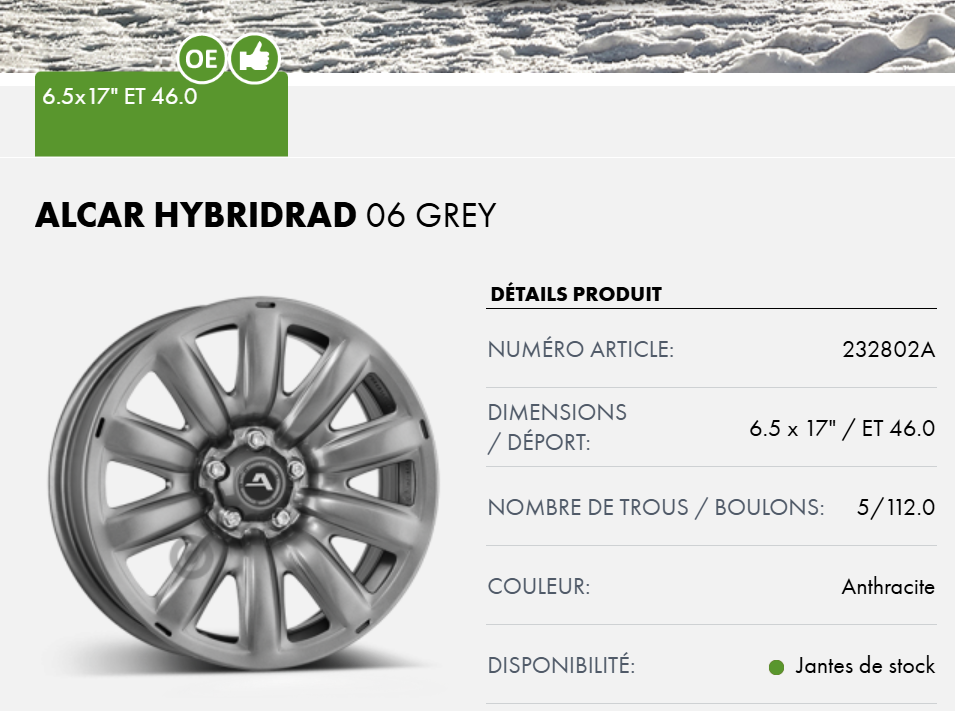

Hello, I used the 17 inch rim below
