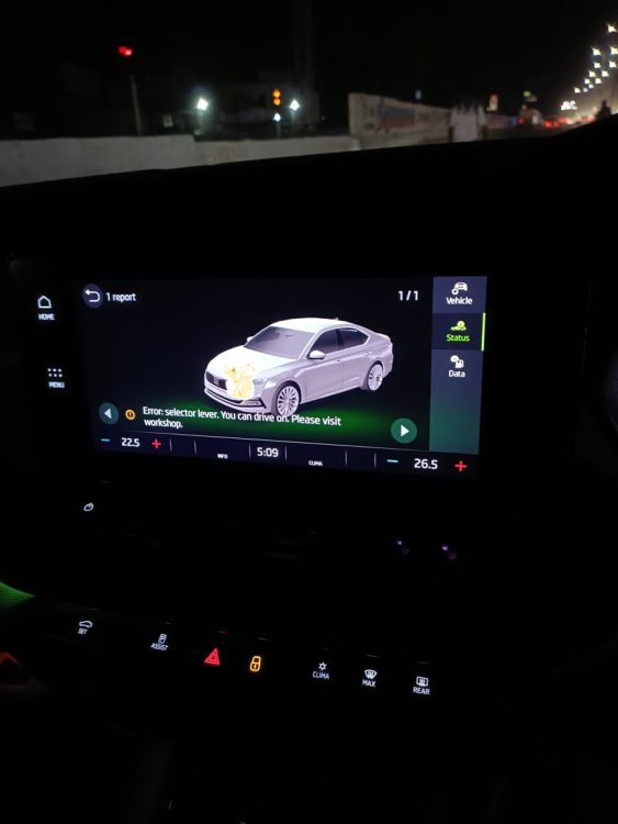

Error: selector lever...
So make sure in case of it was the selector mechanism fault in your car that they don't put the faulty 5wa713033be and they will put an updated part no

Hey guys!
I have been getting the same error for the last 4 months. I spoke to two dealerships and one of them told me to press the brake hard while starting the car and the other one agreed to change the transmission itself.
Funnily the first one worked. Every time I go soft on the break the error pops up.

Hey, guys! Just an update from me - got my car in the local dealer to check the error and do the first service. They said they'd need to change the whole gear selector mechanism, which they didn't have in stock. So, they ordered it and I'm back in on the 25th of Jan to finish the job. Hopefully, it will hold up until then, as I've got some travelling to do by then... fingers crossed.

So just an update from me here, if anyone's interested... :D Picked the car up today, after staying all day yesterday for the gear selector lever mechanism change. They told me it was a big job, and on top of that had the front diff oil change as well. Anyways, drove around a little, not a problem, so fingers crossed. :)
