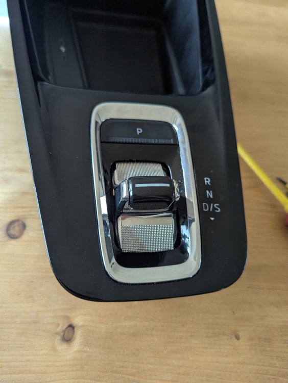

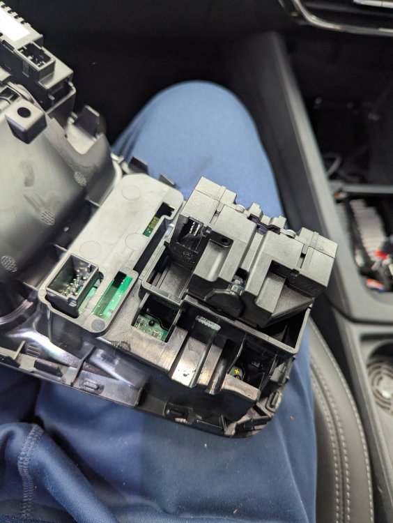

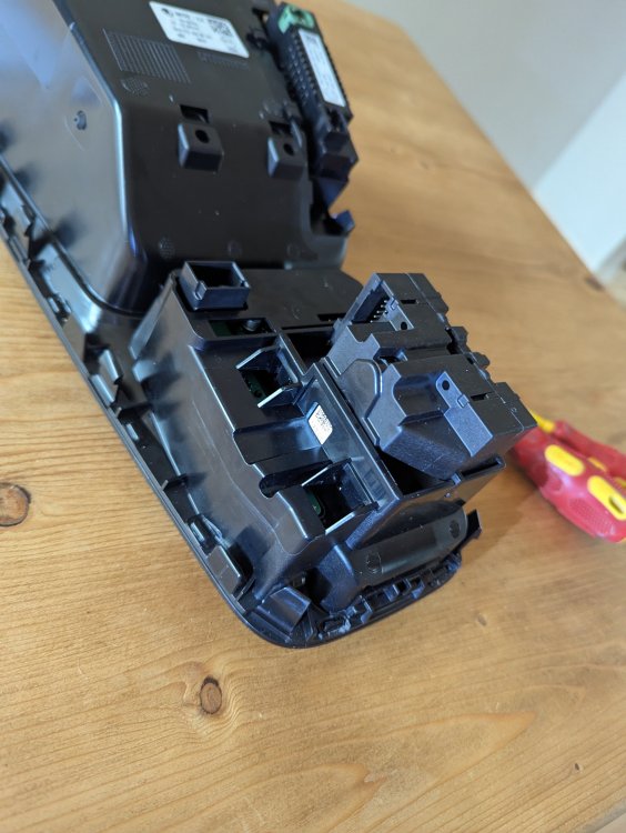

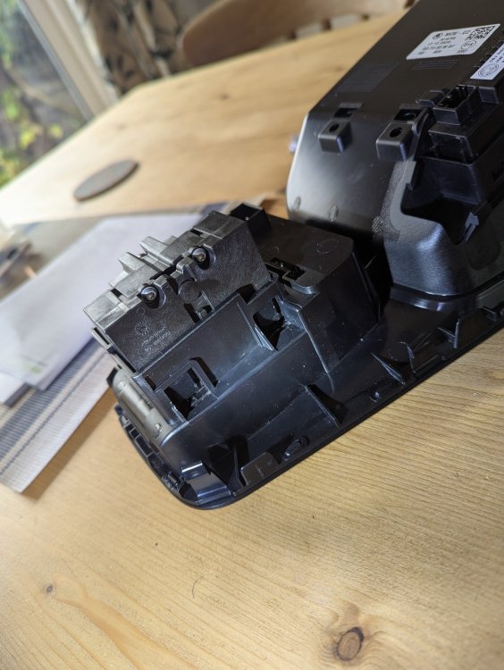

  • Very common issue, failure of a microswitch in the selector tower.   A repair kit can be had that replaces just the internal switch with a bolt on external one.    Im assuming your

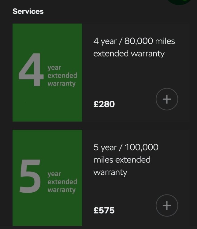

So is that the 'all in package' @BNB90 is referring to? If claims on the warranty extension are subject to non-refundable dealer 'diagnostic' charges, it should be disclosed in the PDS before you fork out for the extended cover. Anyway, it sounds like a great milking machine for the dealer!
When you order the car, you can add extended warranty, and this only.can be done at the moment of ordering it. So, I take it it's manufacturer warranty...SmartSelect_20240819_002011_SamsungInternet.thumb.jpg.4f27afb1e900f988c46691e613bee26d.jpg
The all-in package is the extended warranty you can get after the manufacturer one expires. It's like an insurance policy really, where you can claim back for any repairs. You can get a warranty for certain named parts (engine, gearbox, etc.), or you can get the all-in package. I also got the all-in one, after my factory warranty exoired in April, and am a bit surprised they charge you for the diagbostics. Possibly you can claim it back from the "insurance"? I need to check the T's and C's....

Will stick to the solenoid contacts repair stated by djmartzian above if any abnormal behavior will come up in the future, before taking the car to dealer.

Try to find the string with a plastic handle under the lever panel and you could put in drive. You only need a flat plastic tool to flip the selector panel up.
