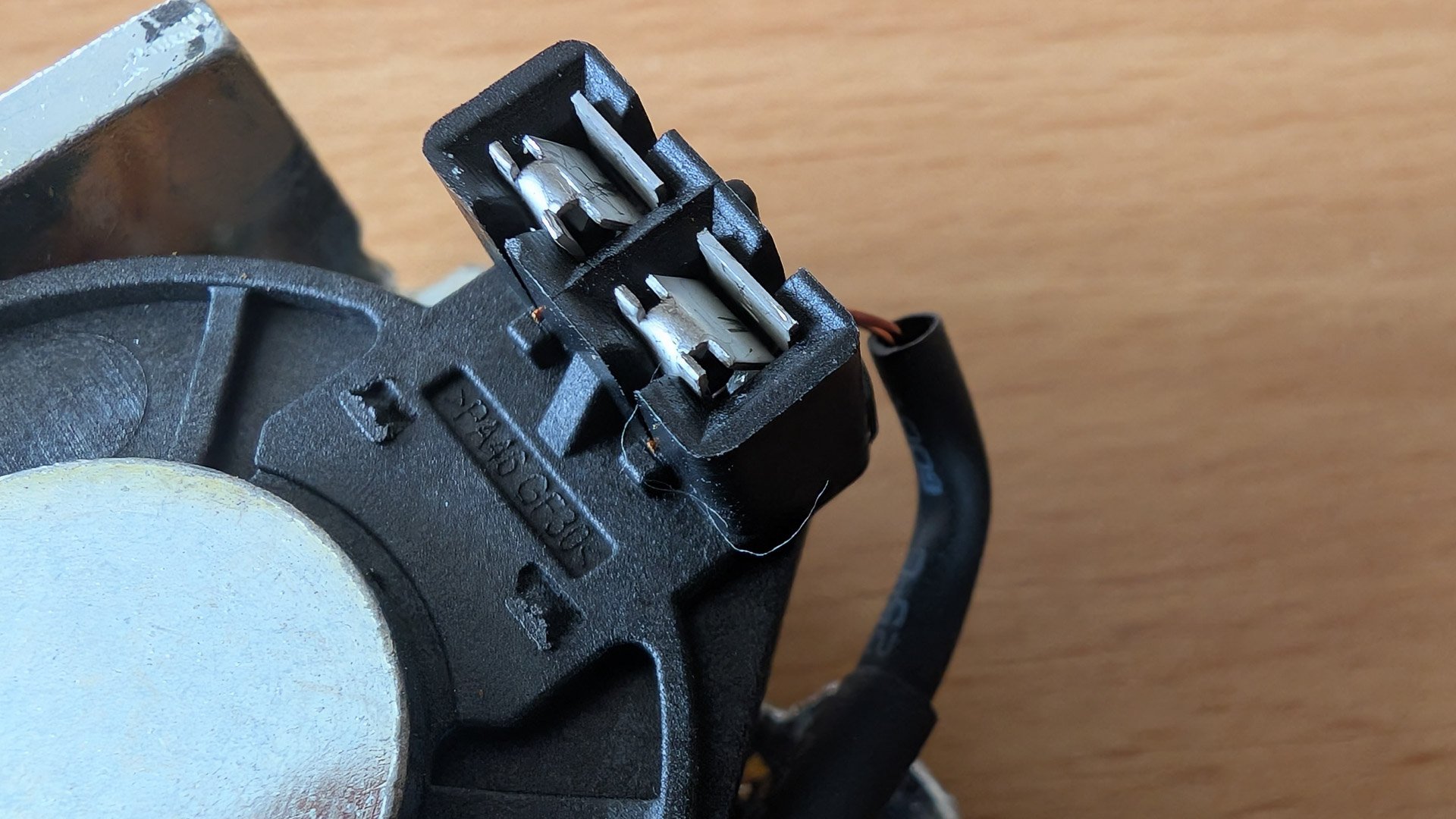

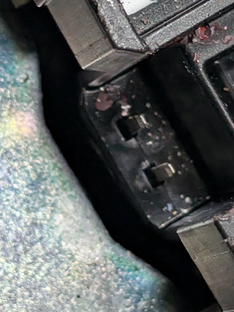

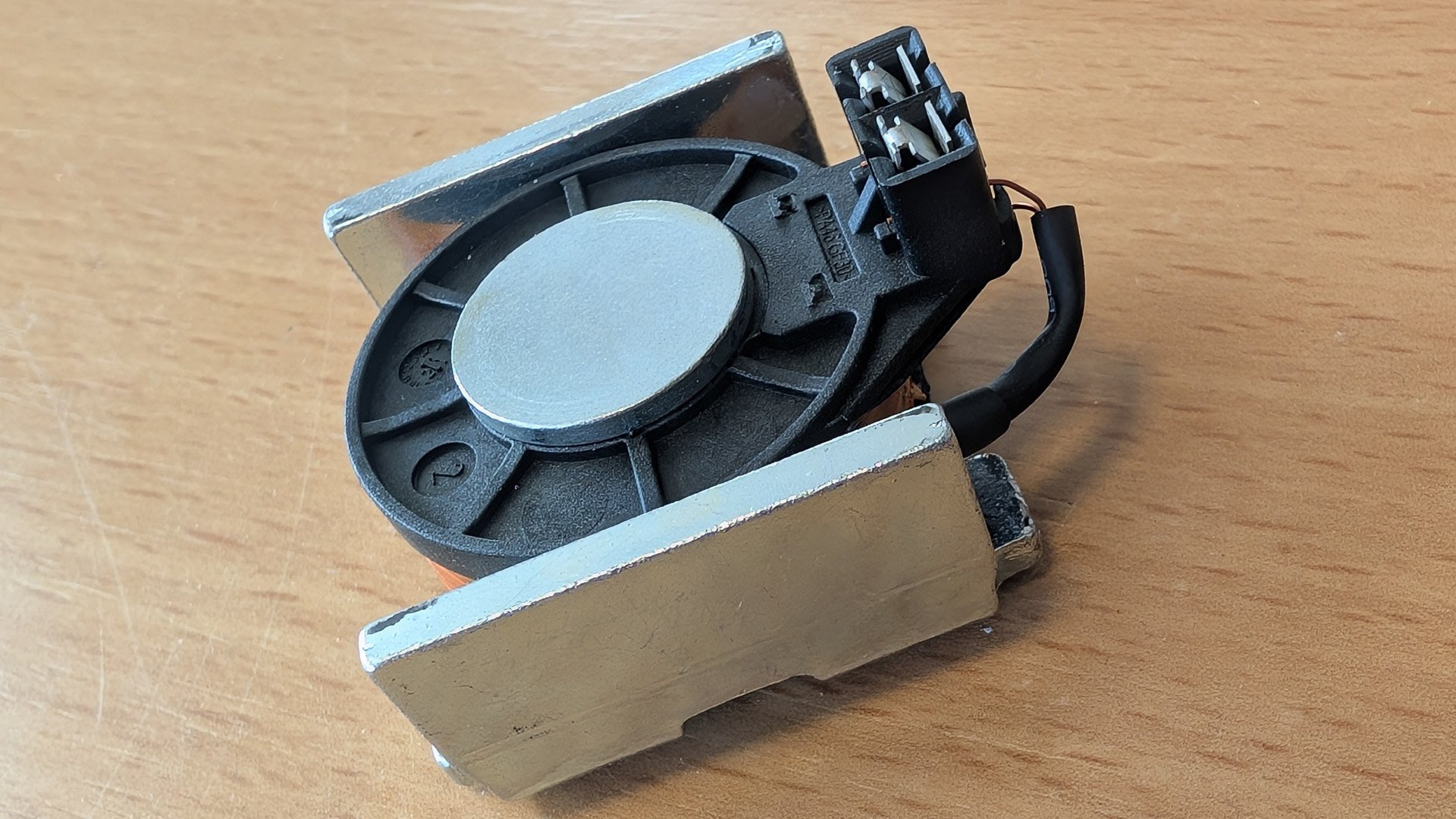

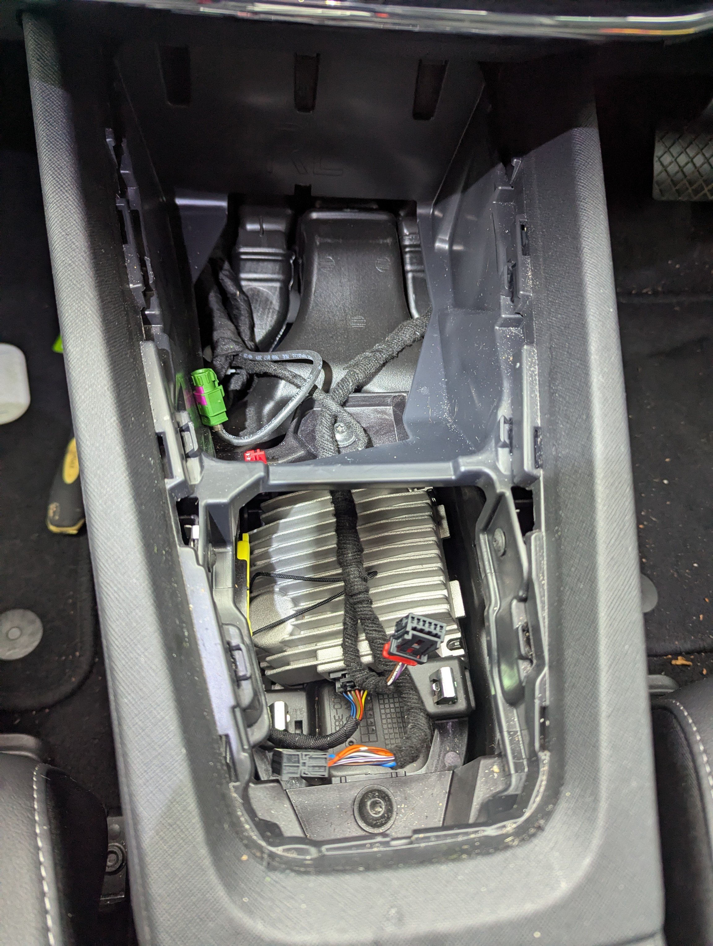

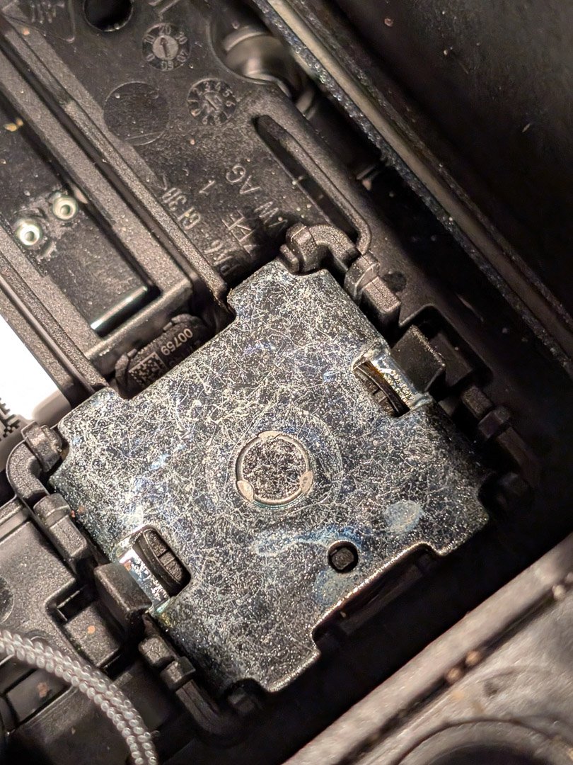

Thanx a lot for this post! It solved my problem!
I followed the same procedure:
  1. I opened up selector switch section (I bought the tooling for this; I did not detach cables so I left the selector switch section in place but opened up
  2. Removed the foam piece

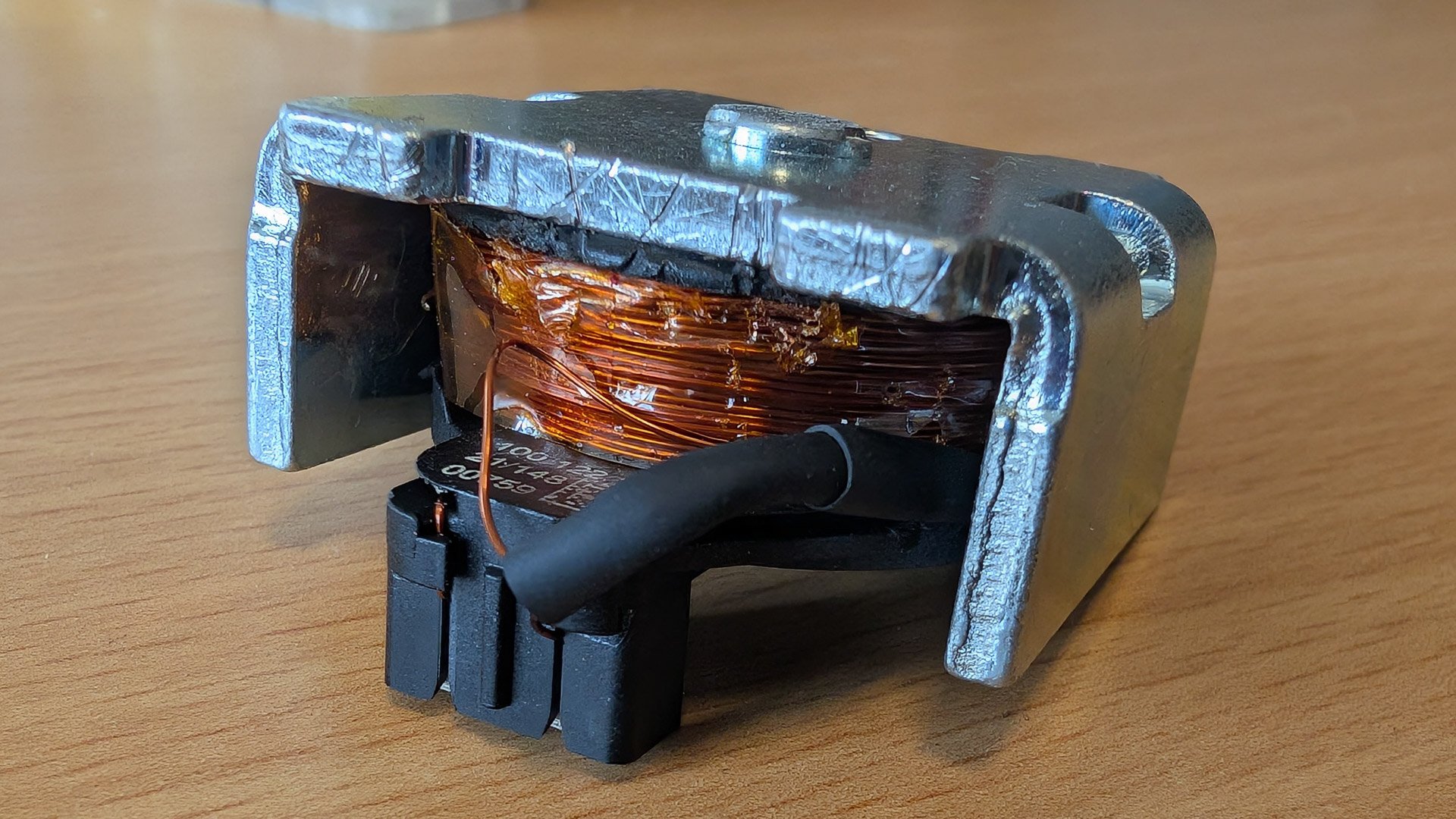

  3. Removed the solenoid
    This really gave me a hard time. It was stuck very tightly, hurt my hands doing so
  4. Bent the clips *)
  5. Placed it back
  6. Tested it: problem gone
  7. Closed
The solenoid wire was broken; it might have been the cause of the problem or it happened during removal. So I had to loosen the other end of the broken wire from under the plastic (using a dentist hook) and solder it to the loose end still attached to the clip. Isolated it with shrink sleeving and it measured 5.5 Ohm again.

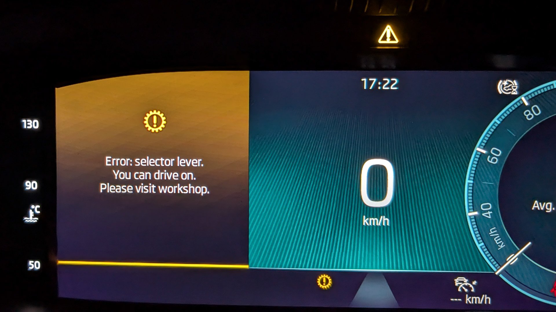

The warning
After removing selector and foam
There it is
After removal and soldering
Bent back clips
Soldered wire
Empty socket
The contacts in the socker
I wonder if they sell the solenoid as a spare part... I do not see it on Google, which is a bad sign. I guess you have to replace the entire switch electronics.

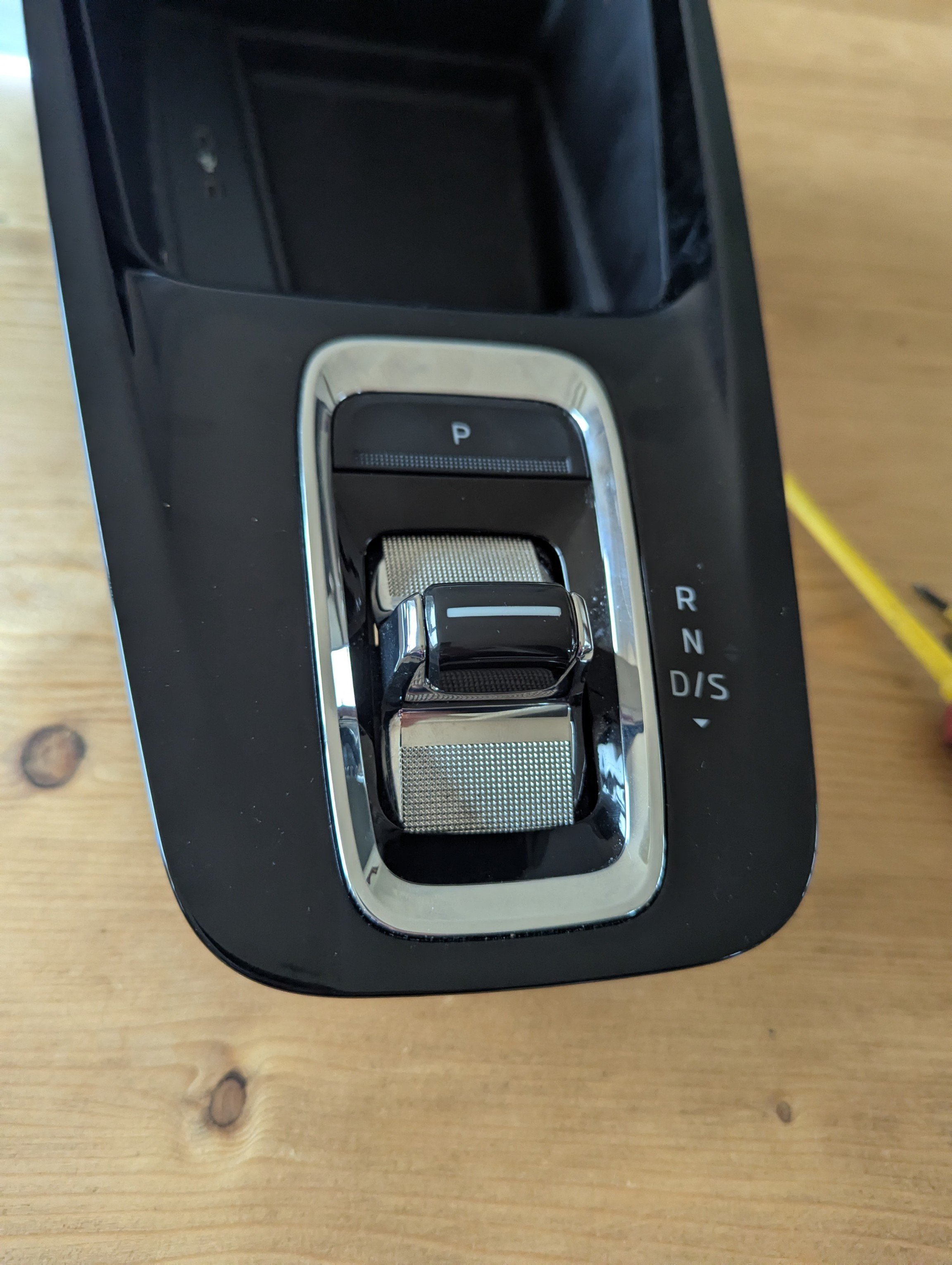

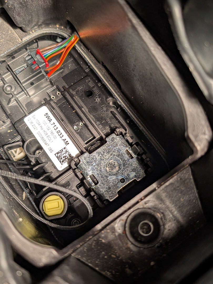

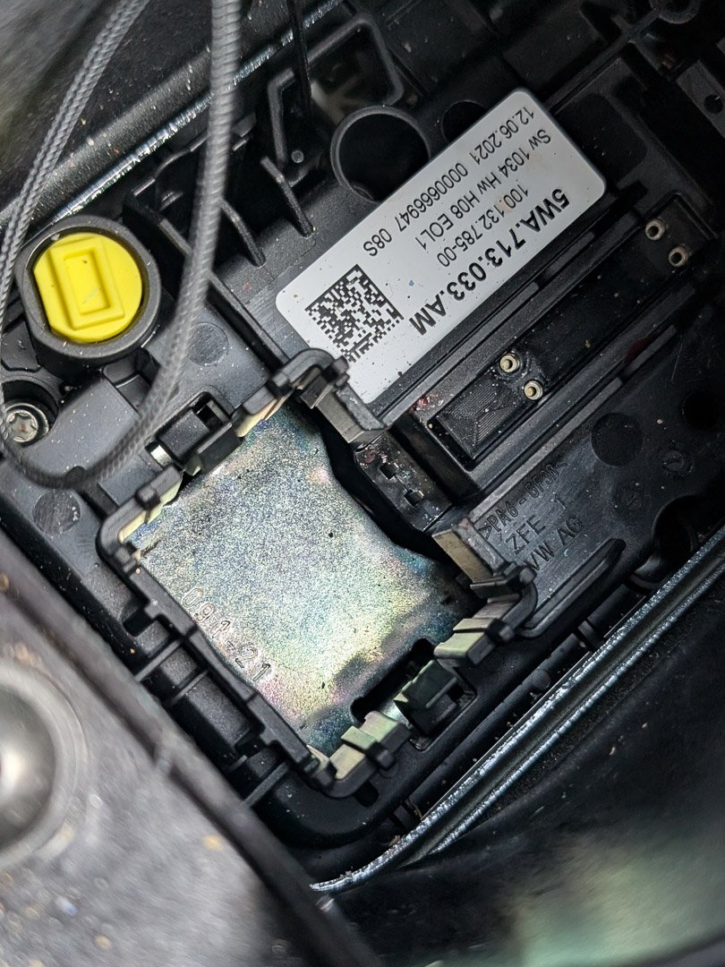

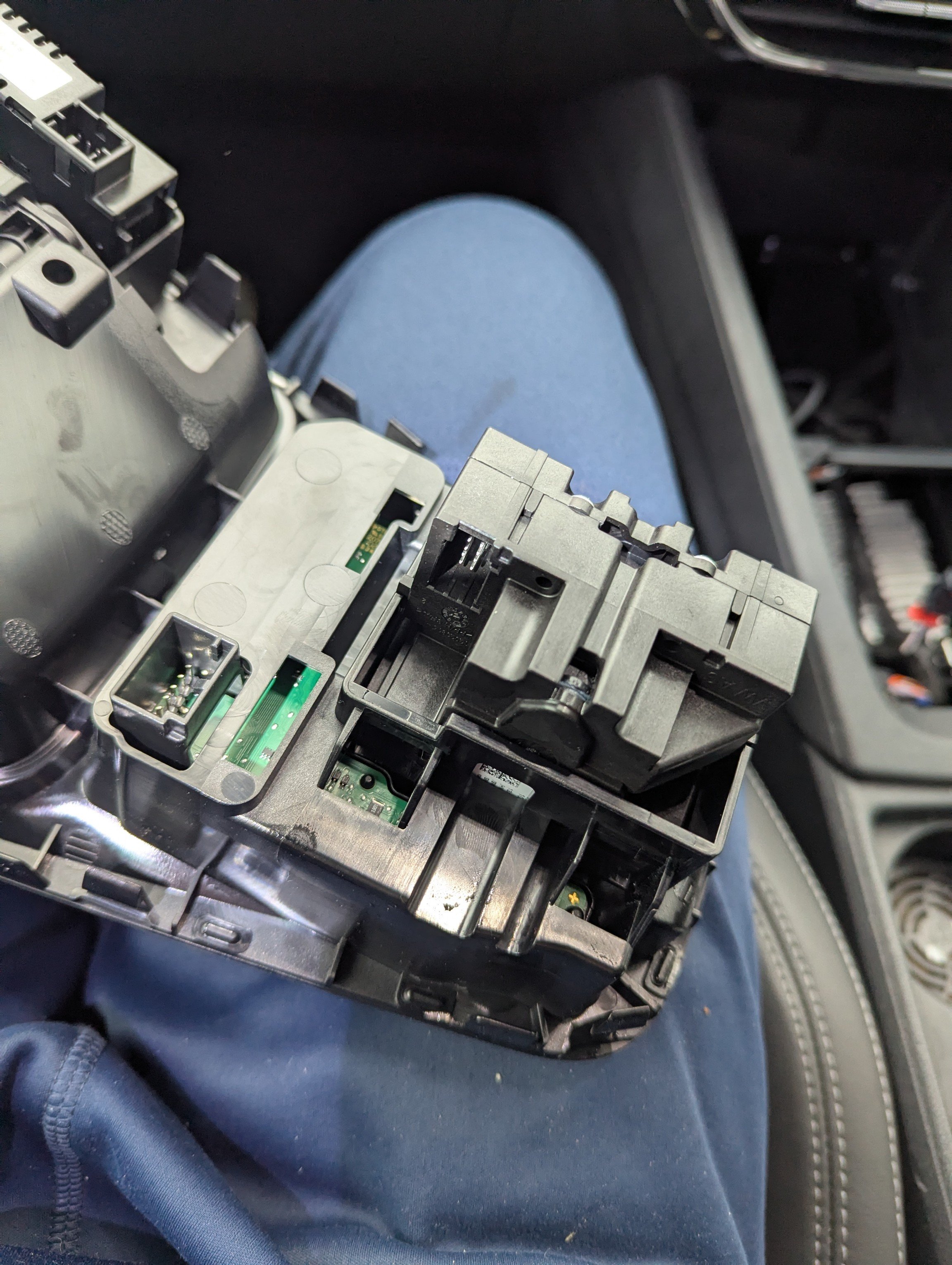

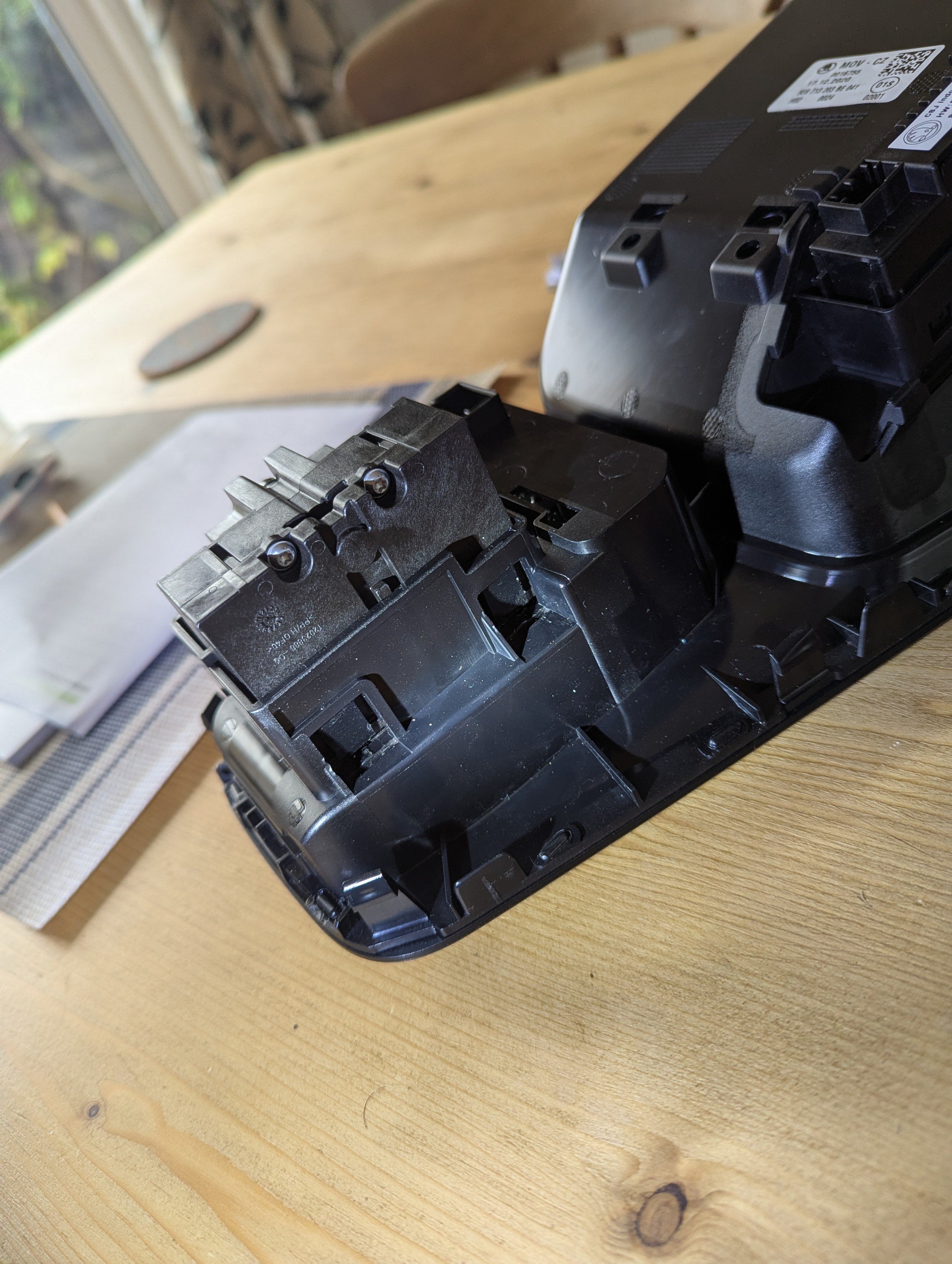

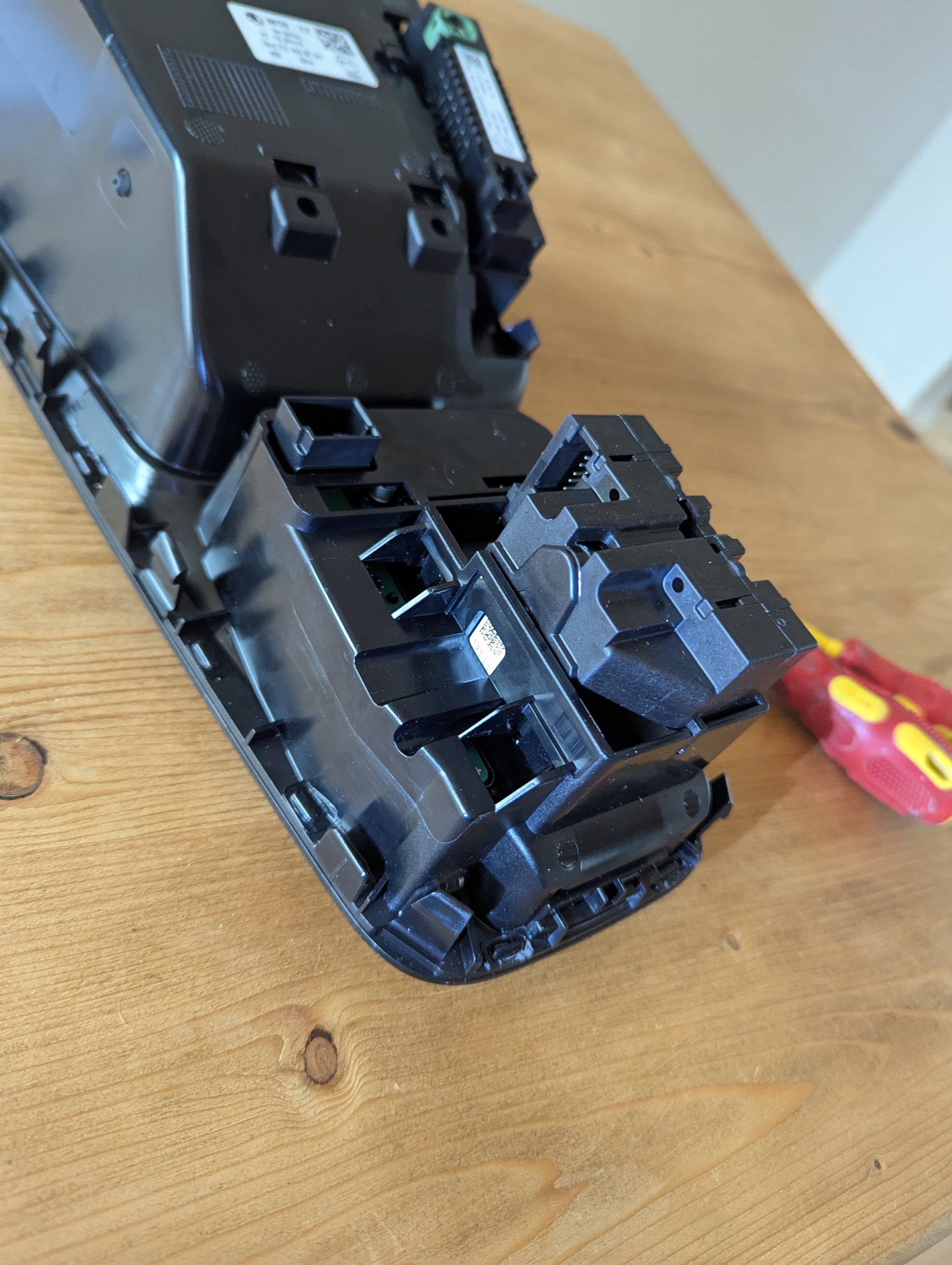

Hi, so I've taken the centre plate out, and unfortunately it's different underneath than what was posted before.
I've unplugged the cables and removed the combined trim / selector module,
I want to see the selector part number as its obscured. As that's likely the problem part.
I've released the 4x plastic tabs on the side, so it wiggles, but it won't fully release from the plastic housing.
It feels like there's something else retaining it, but obviously don't want to force it.
Any suggestions / instructions somone can point me towards please?
Thanks in advance
Thanks in advance
Sorry to hear it's different. Such a shame they changed the solenoid but managed to still use a part that get broken, seems like you have the newer version.
Can you specify the exact model you have and year and month of make? I am yet to take apart my selector lever module, the warnings are annoying but I don't want to do anything about it if not really necessary, I have the NX5 version
