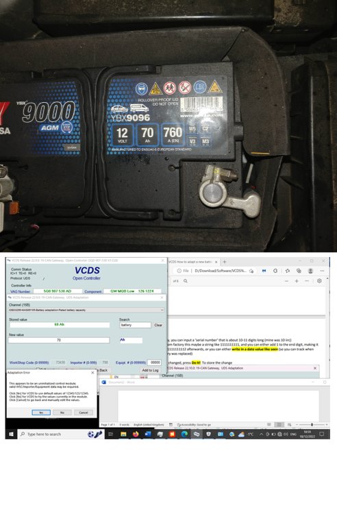

Sorry - I screwed up I followed  the picture (which has 01 Engine highlighted) and not the words (select 19 CAN Gateway) Yes I know, moronic is being kind!!
My battery is YUAUS YBX 9096 AGM 70Ah and its been behaving badly- Autostop/start does nto work; tend to get low battery warnings but it all works fine if I use a batter charger so I presume something is wring in the settings hence the need to change
Anyway second problem (after I worked that out)
All goes fine until I try to mak the first change (capacity)
Stored Value is 68
My battery says 70
So change that and a pop up says Application error and provides options.
Which one - or doesn't it matter?
The rest of the stored info appears to be trhe defaults you mention
JCB
Serial 111111111
Type Fleece
Screen shopt of erropr msg and picture pf battery attached
Thanks for any inf
The error message means you need to program in a workshop code and importer.
The program is offering if you wish to use a default like 123, and 12345 for importer and workshop ID (examples)
So you should press YES to accept, or you can delve into program settings to adjust and write own value's.

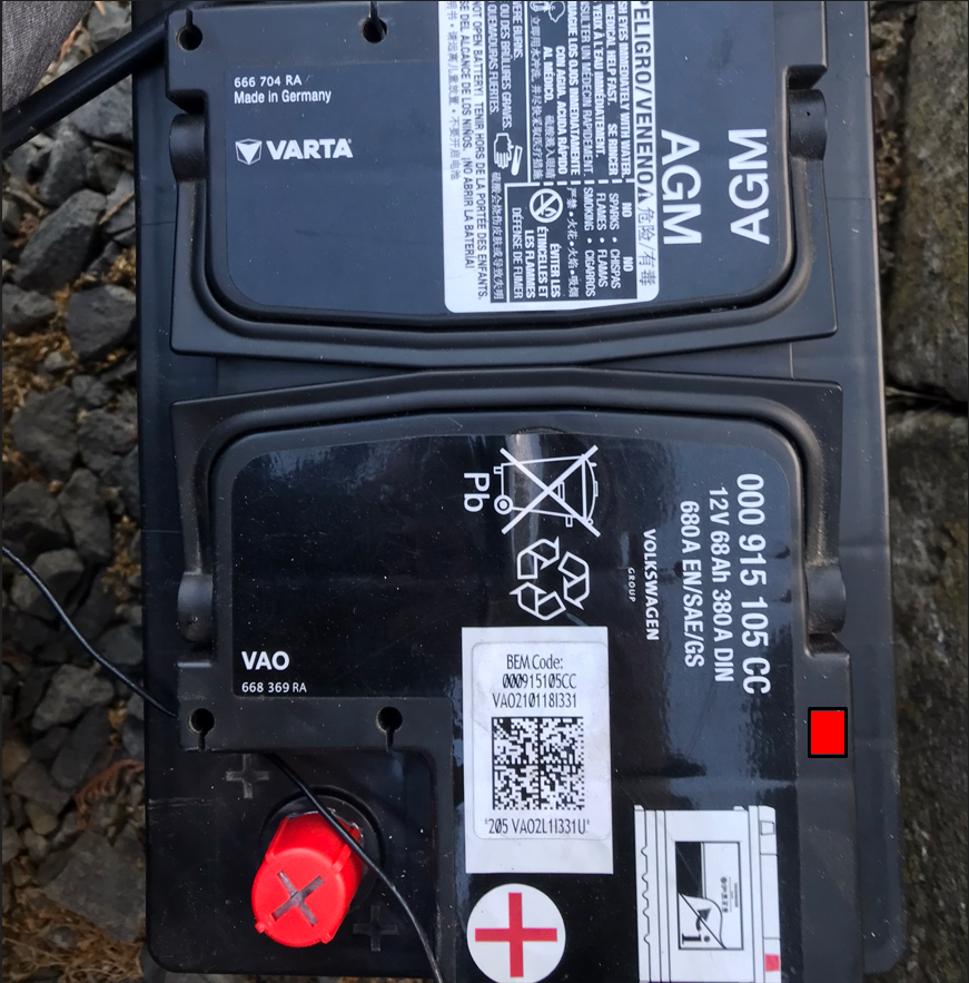

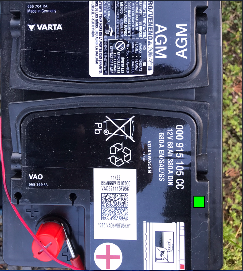

Hello, I don't want to start a new topic unnecessarily, so I'll ask here if I can.
I bought a new battery today, the same one the car left the factory line with.
At the moment when I wanted to adapt a new battery, I noticed that it has the same code as the previous battery (000915105CC) entered in vcds serial number line.
How else can I adapt the battery.
To be sure, I changed the Ah from 68 to 69 and then back to 68, everywhere I changed the previous reading by one letter or number, then back to the reading that is on the battery. Is the battery also adapted by this? Thank you.
(( Picture with RED square is OLD battery, GREEN is the NEW ))
25 minutes ago, homelessdrop said:
Thanks for the advice, but I have one more question, this serial code doesn't affect anything else?
Not that I know of, it just tells the car you have a new battery, so should make it learn faster.
