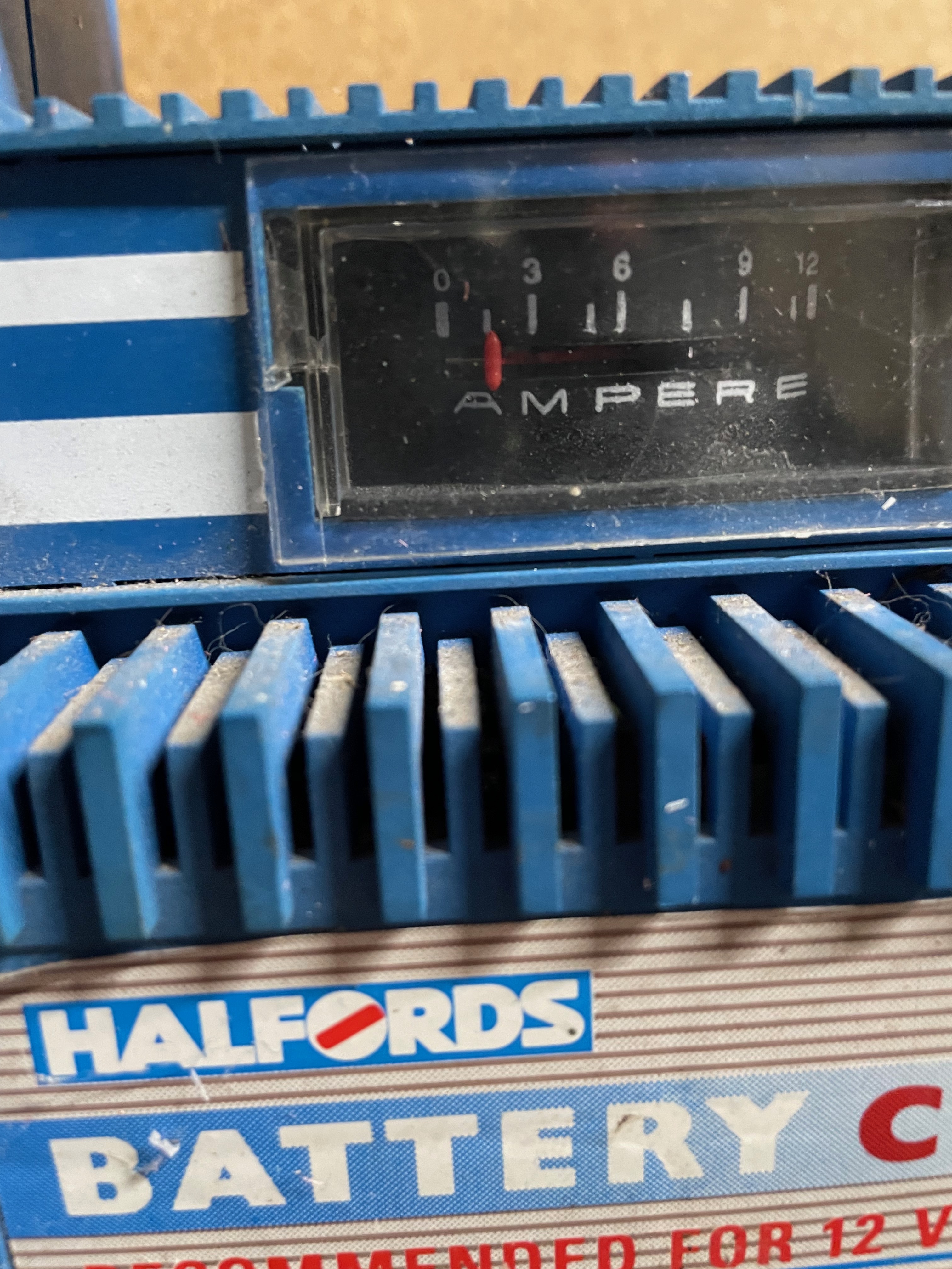

Charging has started to drop off:
So I've turned it off for the night.  Might see what happens with a bit of charging on the 'morrow, but I might also give it the requisite 12 hours and see what gives with the ol' Juke of Earl.  Provided it stops piddling down 🙄

Unless that's where the gauge normally shows for charged that's no where near ready for mating up to the car, bit more effort and patience required, no wham-bam-thank-you-mam, it's not teenage years stuff now.

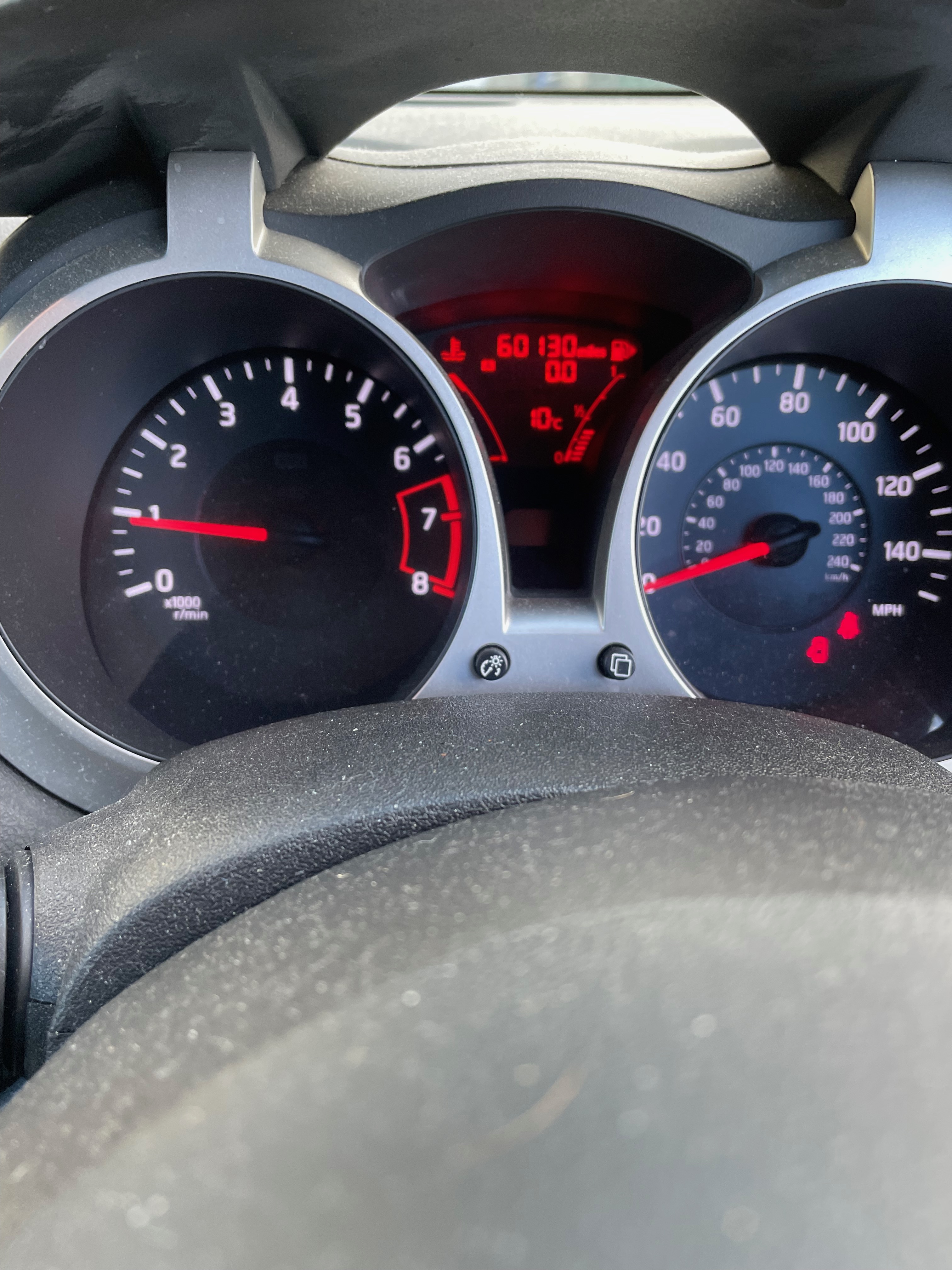

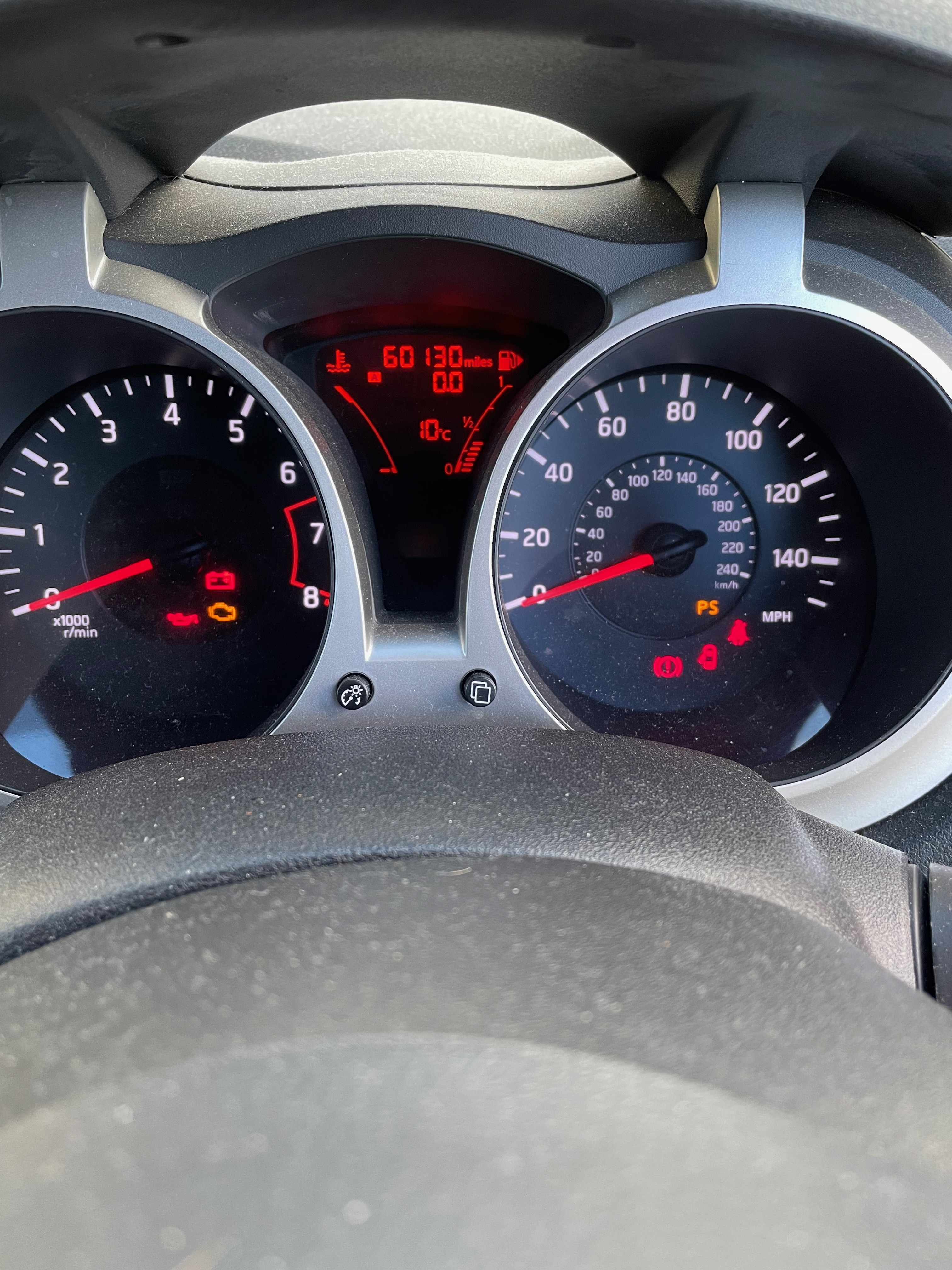

Took it off charge at 8pm last night.  At 1pm today.....
Lights:
Camera......
Action:
69323415440__89779A28-09CA-4400-8076-02F530C16016.thumb.jpeg.d493c1a9303a947b8e4c757dcbc17d89.jpeg
Came as a pleasant surprise 😎
Checked the levels, ran it up to temperature and let condensation out of the exhaust.  Moved it (brakes let go quite easily) and remembered to leave the handbrake off this time 😁

The battery was at 12.04v at 1pm, so after 17 hours.  I stalled it while freeing off the brakes and it started again fine,, not slow or lethargic.  It was 11°C at the time.  I'm not expecting miracles, it is what it is, and will no doubt need looking after if it's to survive.  In normal times, my friend has a five mile commute to work, mostly 30mph and in traffic.
But at 720A it's a fair size battery for a 1.2.  That we have 12v is a positive sign as to the cells.  Time will tell.
