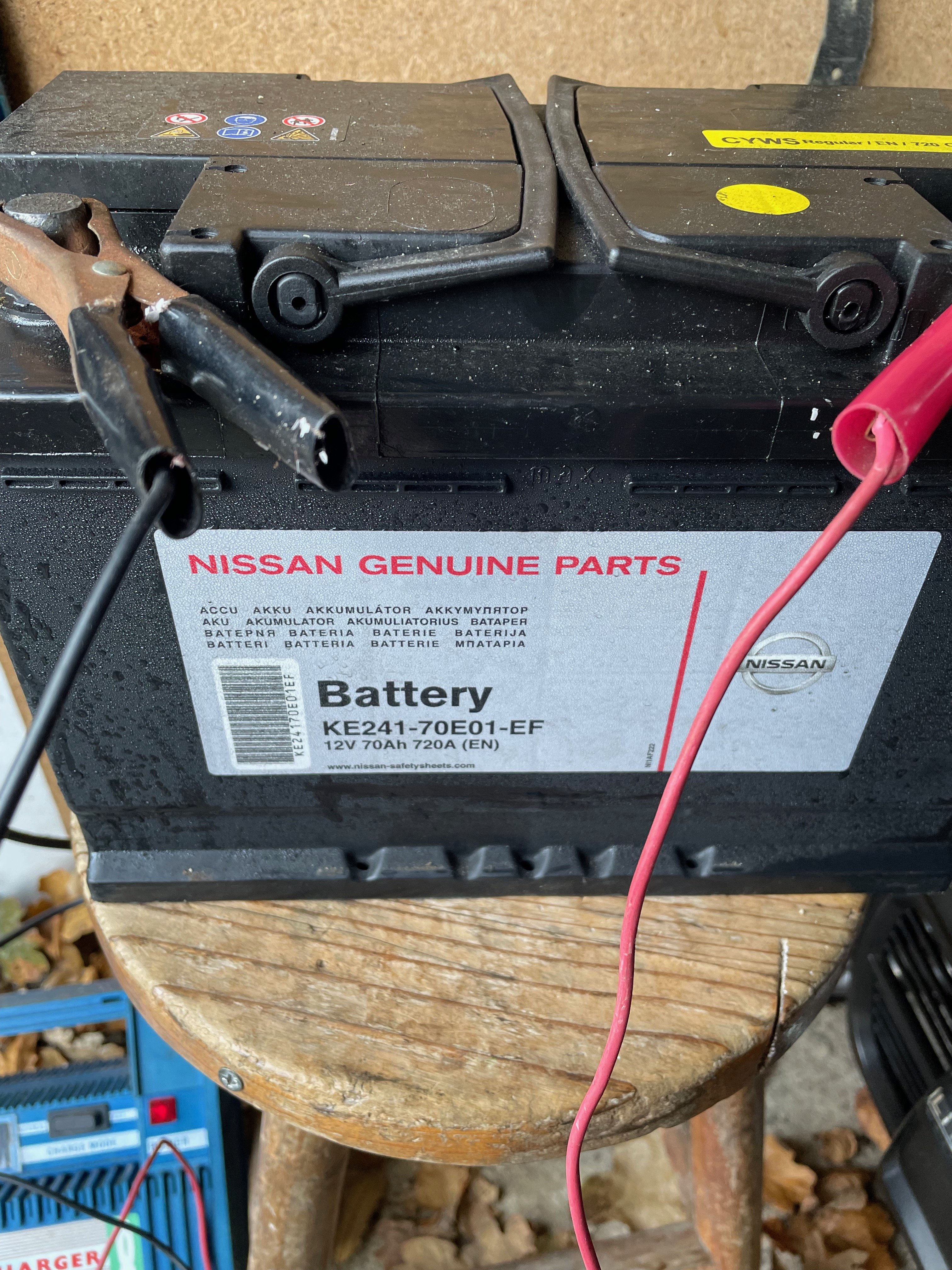

On 17/12/2022 at 13:28, Gaz said:
An ex work colleague has been medically refrained from driving.  She told me about it two days ago, silly plonker.
Her trusty '64 plate Nissan Juke hasn't been started since August 😳
I've just been round and it's dead as a dodo, not even LEDs coming on.
Looks like it might be the original battery:

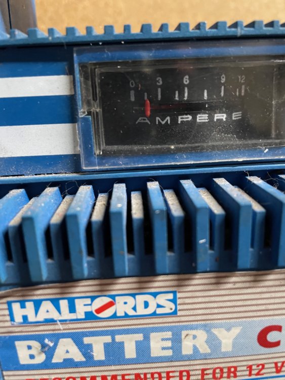

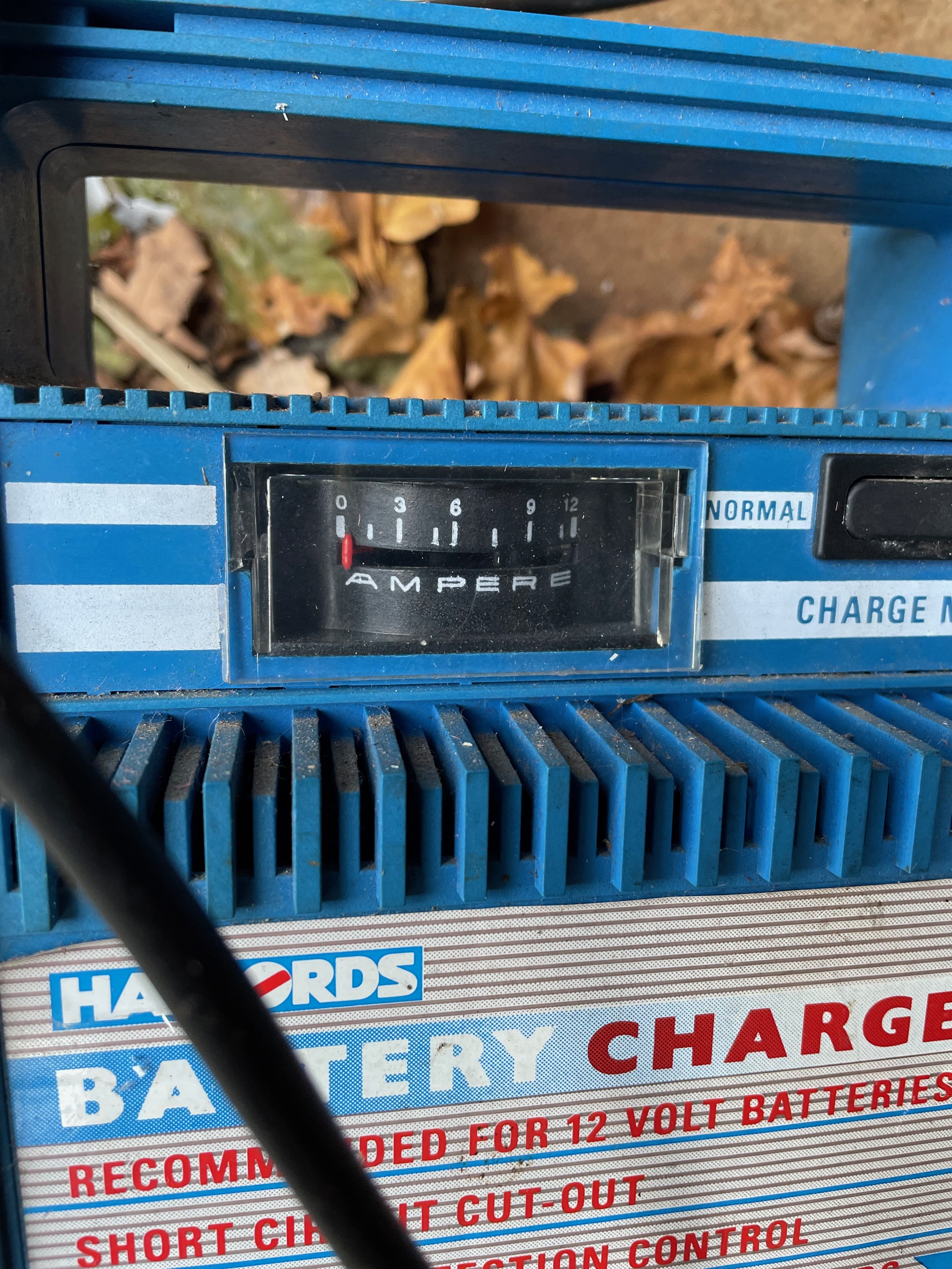

And it's now in my garage, on charge, but at first sight taking bugger all amps:
So what do we think, will it pick up and be resuscitated, or has it departed this mortal coil?
I'll leave it on trickle for a good while, and check in on it from time to time.
A quid says it's dead.

If its below a certain voltage you may need a C-Tec to get it started charging.
Just now, gumdrop said:
Under 6vdc it may need a C-tec to start it charging, if it will go at all.

It's been charged up (not sure if fully) now and IIRC refitted to vehicle.  I've seen where others have put some chargers won't bother with below 6v others below 3v, there are ways around this and use of other chargers, C-Tec being one manufacturer, they always seem a bit expensive to me but if with a lot of use they still last decades then they may still be good value.  I've found some chargers don't like it when the weather is very cold or very hot which is why I bought the Ring RSC804 as it claims to operate down to -20c and up to 40c.
I've had/got loads of battery chargers/conditioners, some quite expensive, and nothing brings a battery back like a basic, low current charger. The best one I've found for bringing them back is a cheap solar panel if you've got a lot of time on your hands. I normally start them off with a day on that, then move to a charger that's probably 10 years older than me, but that has a 1A shunt on it.

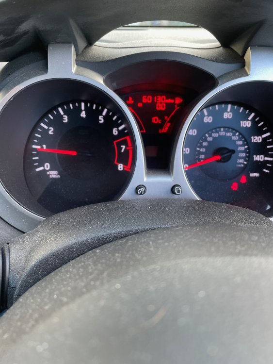

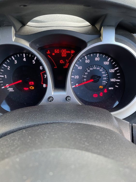

12 hours ago, lol-lol said:
What was the end of this tale ?
Early days and nothing much to report really.
The battery hasn't been charged since 19th December and is still starting the car fine.  The car is sorned, so isn't being driven, just started and warmed through, so the battery will of course still gradually deteriorate.
I've just realised I've got two small solar pv units sitting out in the garage doing nothing, so I might go and connect them up.
