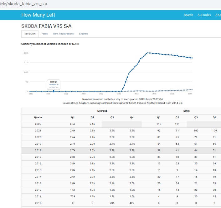

About 1,800 CAVE, then 1,000 CTHE.   Around 800 are estates in the UK.

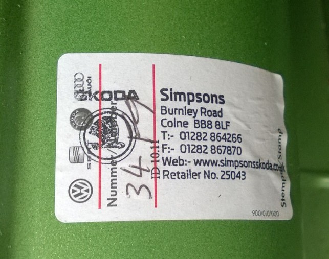

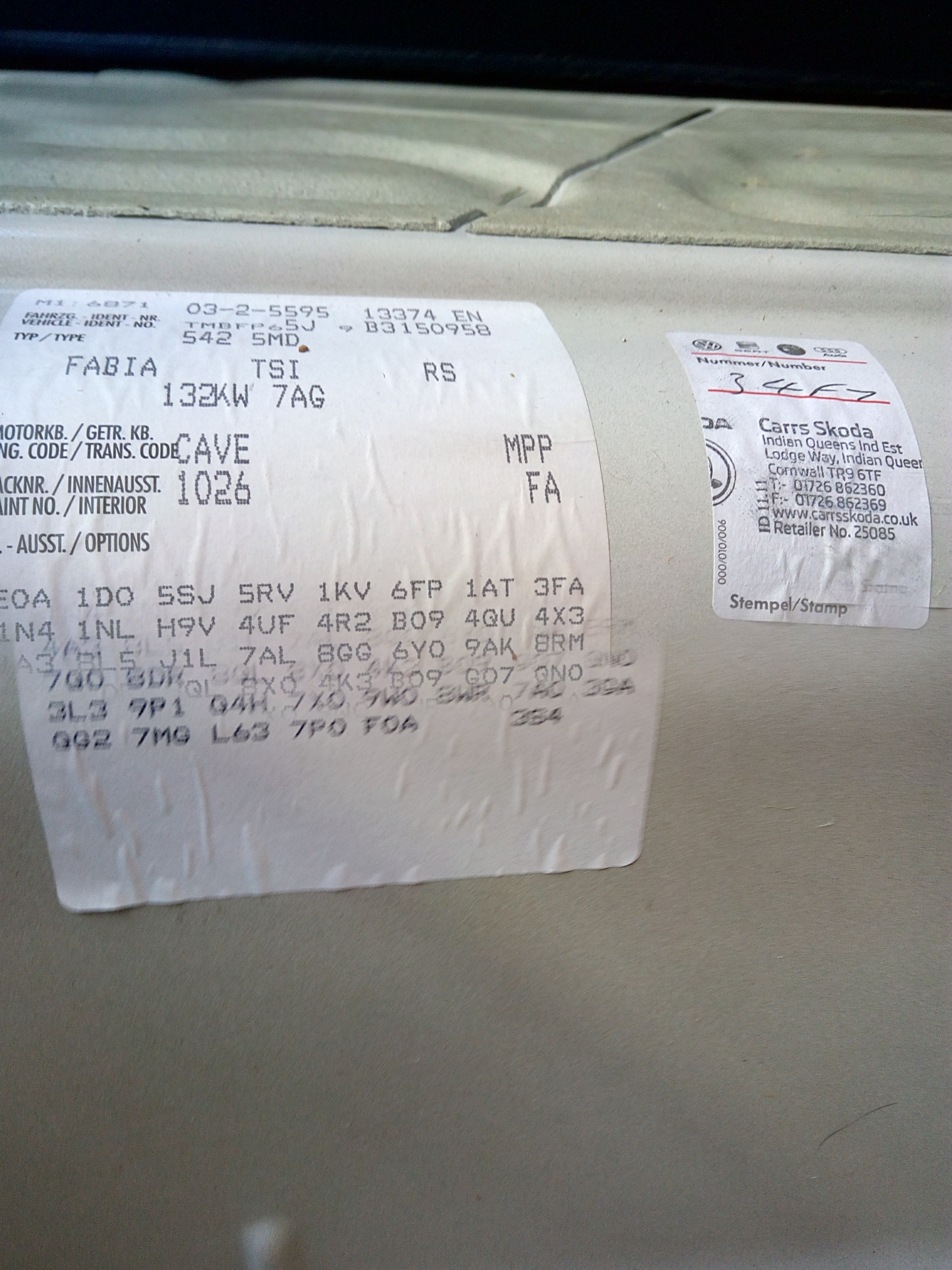

@AwesamWhat was on the sticker in the boot have on to show a engine replaced ?
If it was '34F7'  that was not an engine replacement.
Yeah it was that code! What does that represent then?
Finding at good one at a reasonable price is becoming a mission! I may have to give up and settle on getting a Fiesta St!
Service Campaign on the DQ200 DSG's from 2010-2012 before the CTHE engines started being fitted.
Sometime after March 2014 in the UK before Skoda started doing them..
Synthetic Oil changed to Mineral and a Software update.
Late 2012 CAVE or the first CTHE, & there were cars that never got 34F7  or the 34H5, these are in the pinned thread at the top.
Not a good situation there. Flashing Spanners.
On a CTHE 2013-2015 it might be '34H5' a Software update that got done started 2017;
But they never got a sticker.
