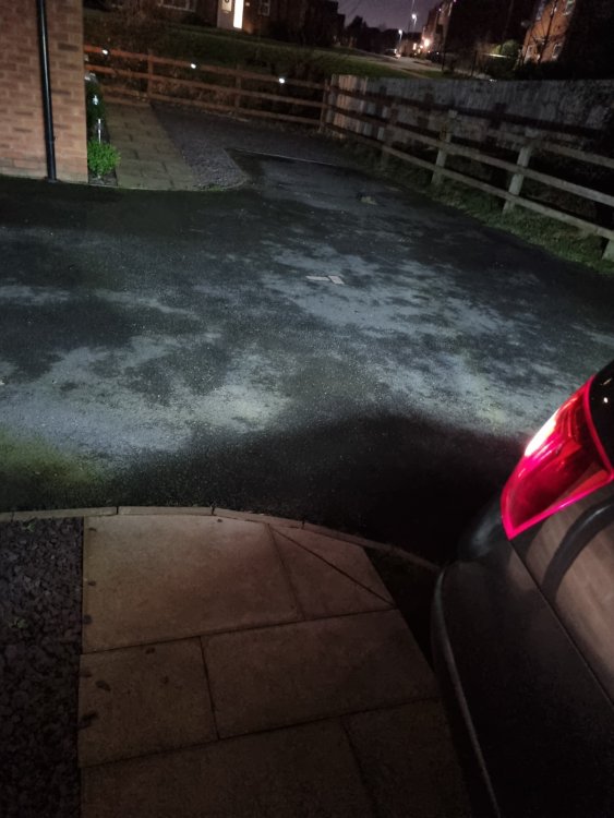

I upgraded the bulbs in my octavia recently, here is a photo.
Link LED Bulb
Edited by MATT0693
Hi MATT0693,  thanks for your reply. I'll have a look at those and maybe order some.  Thanks again. D4KGP.
