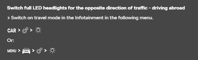

From a 2020 owners manual:
I saw that in the owners manual but there is no “Travel Mode” setting in my vehicle settings.
Is this setting only available when the gps detects the vehicle is in a different country?

Might be worth seeing if anyone local has VCDS/OBDeleven, have a look in the 4B adaptions for "Activate left/right hand drive switch-over". If there is no 4B, try 55 and look for that or travel mode 👍
This is not GPS based for sure.
Setting is either there or not. If it's not, like mentioned above perhaps it can be coded.

On Columbus go to
Vehicle
Settings
Lights
Left Hand Traffic (ticked for UK)
or Right Hand Traffic (tick when in France etc.)
