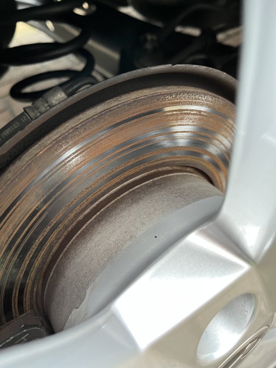

Hi all
I’ve had my Kamiq since June 22 and now has 4000 miles on the clock. I’ve noticed that the rear offside brake disc is heavily scored and rusty. The other 3 are fine, shiny and flat. I’ve checked the handbrake actuation to that wheel is working alright and it is. I’ve seen reference on this forum to similar problems with discs and wonder if this is the same thing and whether Skoda will replace the disc under warranty and not argue that it is a wear and tear item.

/cdn-cgi/mirage/d86055baa6645afb27d5d6ef3d3326feb3b3723f33def44cd5ee6e8ea6d9e48b/1280/https://www.briskoda.net/forums/uploads/monthly_2023_02/6D7C8500-595A-4FA1-88D7-3D4FFD0CE379.thumb.jpeg.ee06c842f93b674327b8e4b1379320e9.jpeg
Looks like the weather direction is affecting that. I go to a empty car park drive about 5/10 mph and apply hand brake not clicked on but with button pressed in and pull up and down to clean. You could try replacing under warranty but you might get the same
That’s a good tip re handbrake. I’ll try that.

You have my rear discs 😊
Exactly the same thing but at 11k miles and 22 months; Skoda said I had to take car into dealer to argue my case but nearest is almost an hour away and frankly I couldn't be arsed when clear message was "wear & tear". VW Group engineer who had seen the car as a breakdown - I refused ti drive it until inspected - said entirely commonplace issue and to replace with BREMBO pads not VW. Did so at personal cost locally and no further problems - yet
Common problem, the back brakes only do something like 15% of the braking.  It's more unsightly than a technical problem.
No point in getting them changed, as will probably happen again if same discs and pads fitted.   New pads will need to bed in, but might scrub it clean

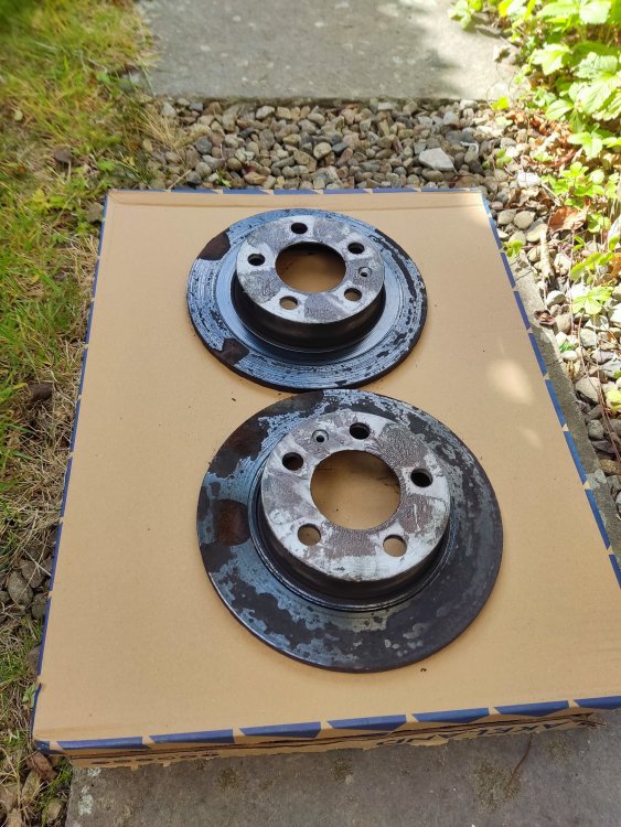

Could you share a picture of a new set?

Mine looked like that after 700 miles.
My Kamiq has just hit 15k and the marks are still there, I will be changing all the brakes soon.
