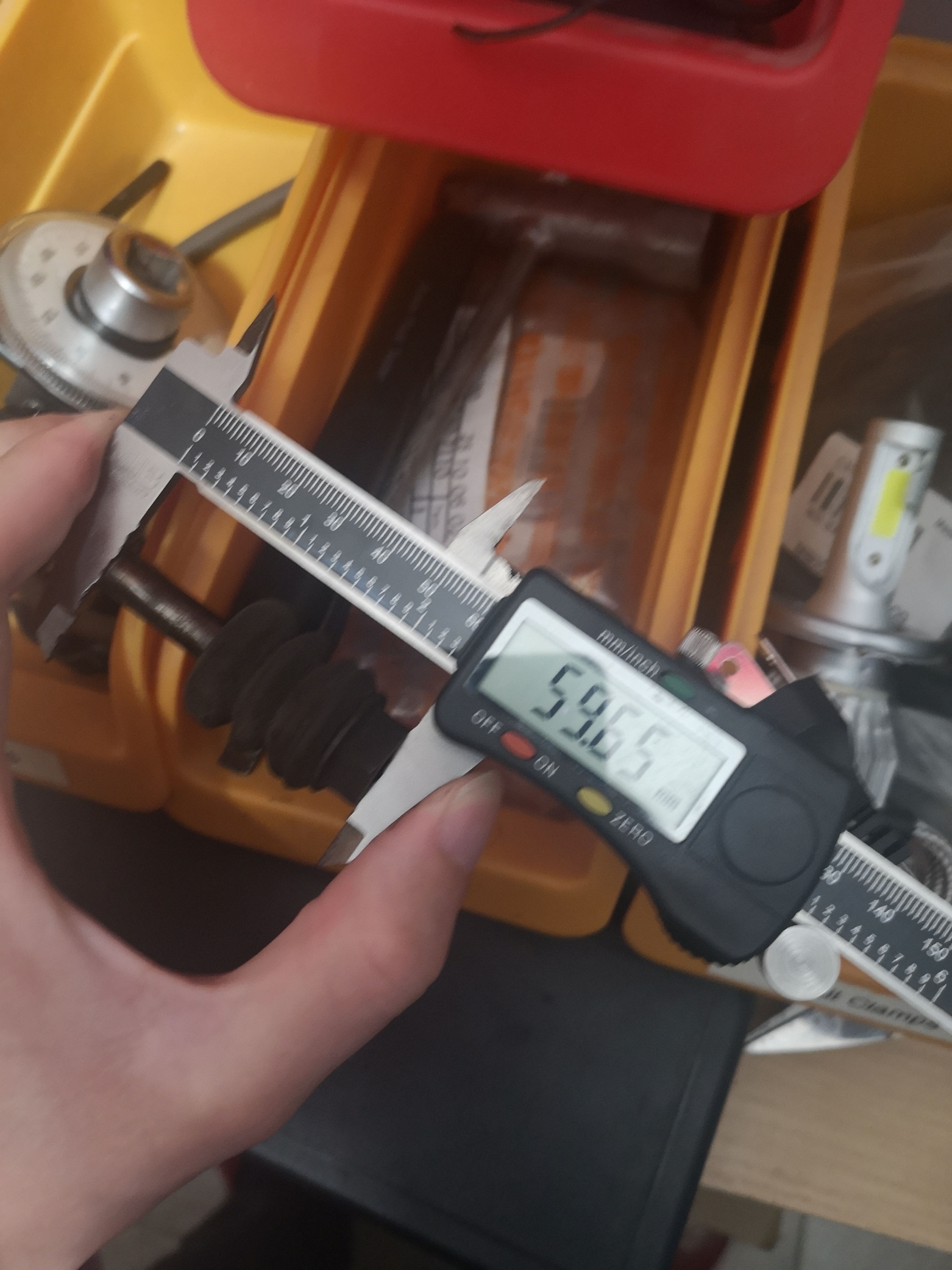

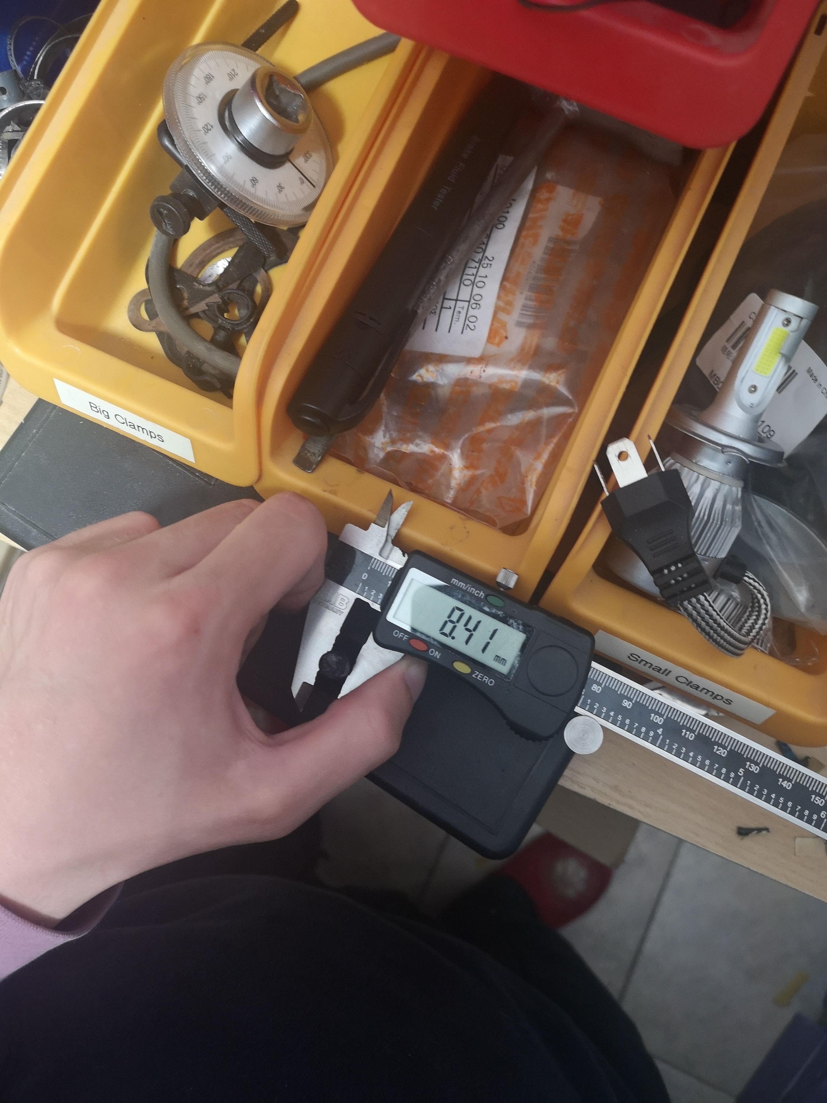

I've measured the thickness of the pin with and without its sleeve.
With sleeve: 10.6mm
Without sleeve: 8.25mm

12 hours ago, R_Blue said:
With sleeve: 10.6mm
So the carrier is it drilled out?
Actually I was waiting your measurement and gave the numbers in advance. After a quick search, I think normal pin diameter is either 8.1 or 8.3mm. According to what I've measured, looks like they drilled the carrier like you said.
So, I need a new caliper carrier set.
