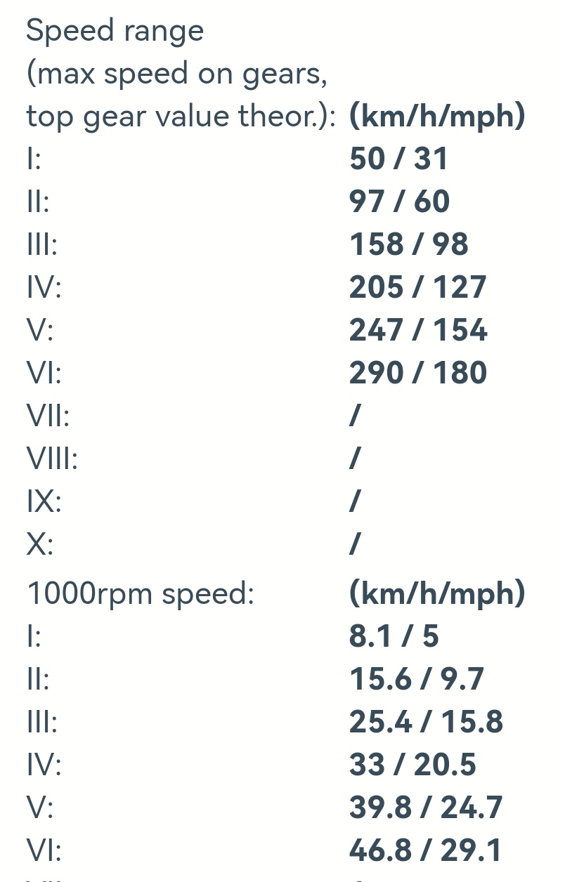

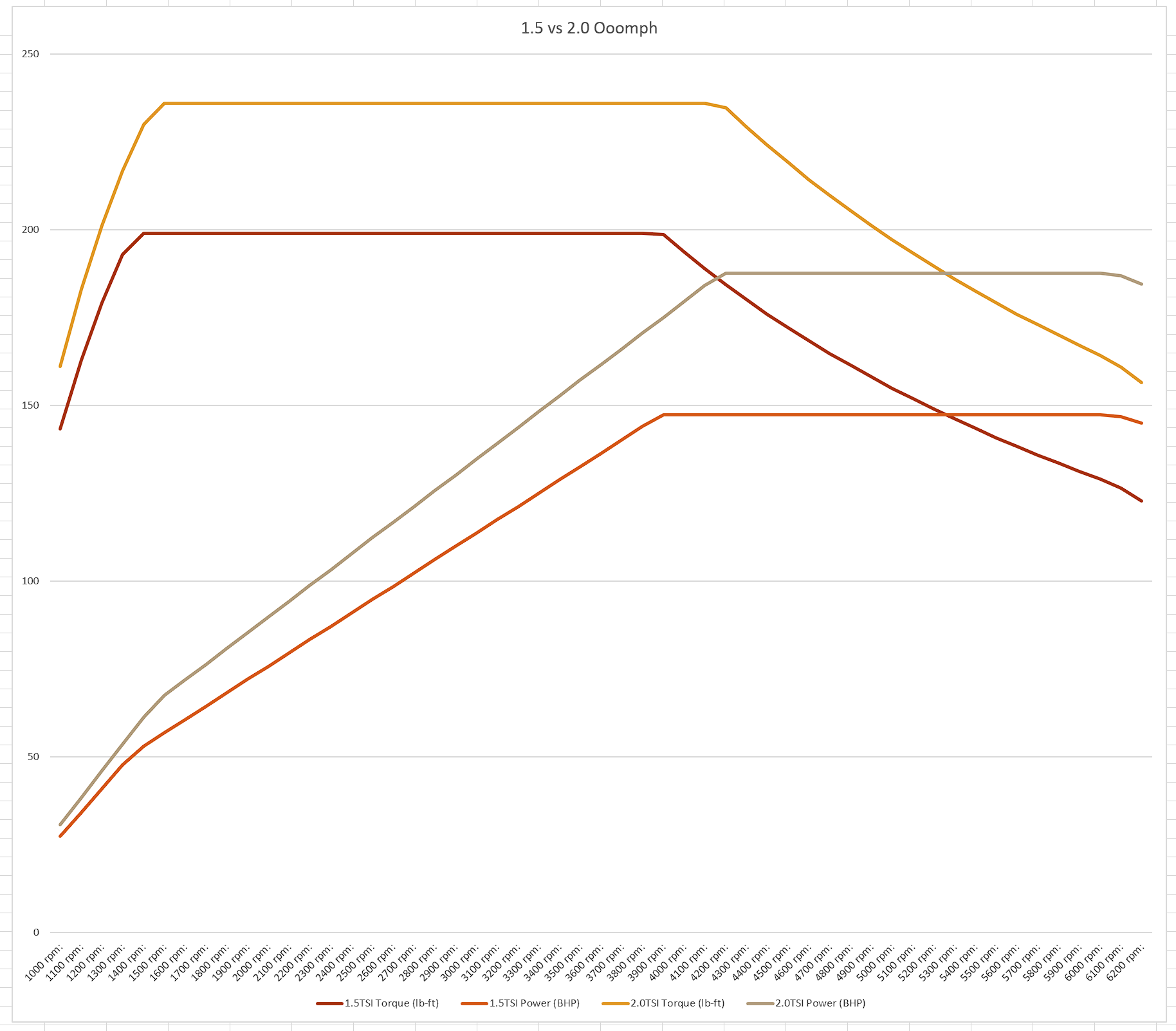

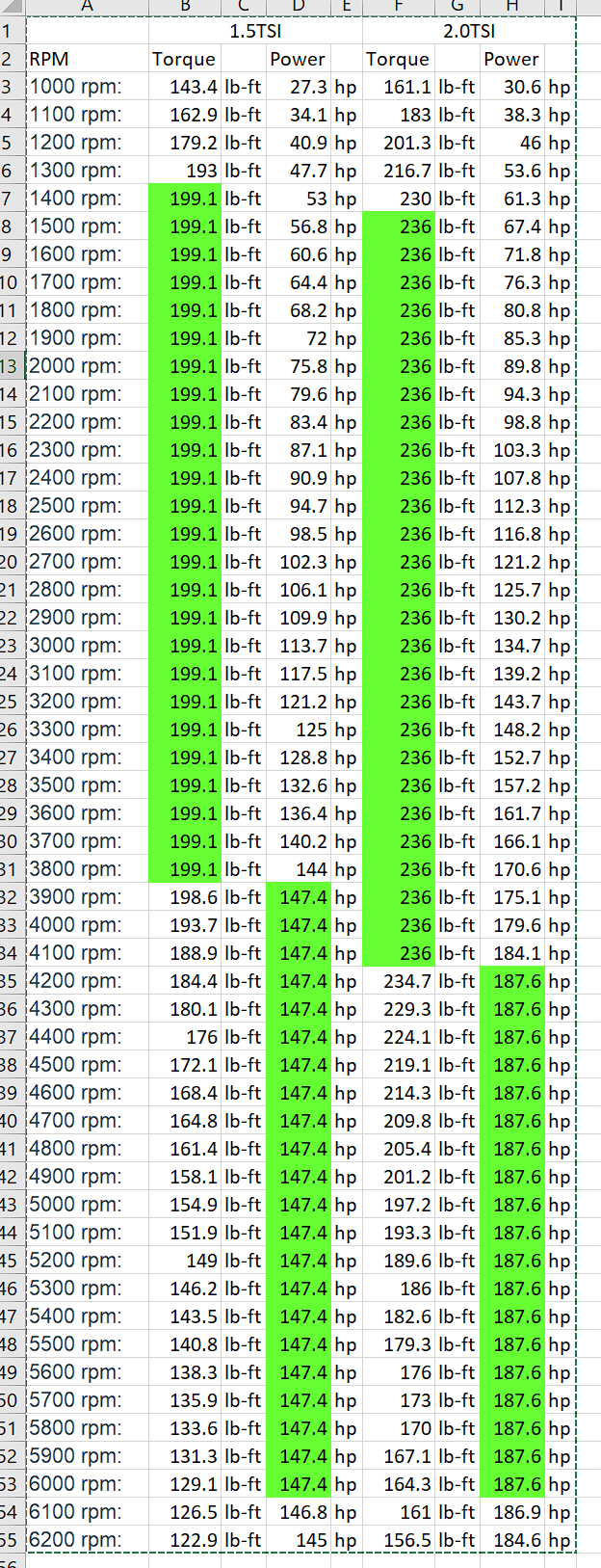

Here is some ooomph data. (Source https://www.automobile-catalog.com) which uses manufacturer's data. I pulled the data off the site myself to bung it into Excel so I could have a look at the power curves and help me choose an engine.
Speaking of curves, I've also included the Ooomph curves for both engines from the data. (Edit: The highlighted portions of the data are peak Oomph zones.)
image.thumb.png.c214dad223b5079226e52045c0ba60e2.pngimage.thumb.png.d29c86c38848d8c335f22b50e3eed18b.png

Thanks for providing this 👍

The data from the website would suggest a maximum of 60 mph in second gear and gearing of 29.1 mph/1k revs in 6th, although I'm  definitely seeing 2k revs at a genuine 70 mpg (in sixth)
