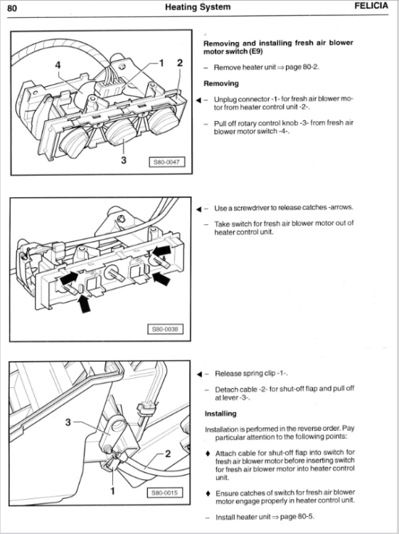

No this is something jamming the knob itself. Cannot physically move it passed "12 a clock" position. Ill take a movie so you understand through a mirror so you can see the rear.
Ahhh the stop has shifted

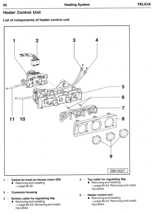

Is there anything I can do without taking the whole control/knob unit out of the dash? I can see the rear of the control has different "plates" that move and the outer part feels like its not where it should be - it doesnt get passed the part where the wire is attached. Ill take movie/pictures tomorrow, its cold like in hell here at the moment.
you need to remove the whole assembly sadly
Damn.
But its fixable? Does it happen again if I fix it this time? Perhaps its better to buy an other control panel? Also the heater knob is hard to turn - from 12 a clock and back to cold.
So, out with the instrument cluster, loosen alla the cables at the flap-ends and get control panel with all the cables still attached to it, out through the instrument cluster hole? How hard is it the attach the cables back to their places again....?

Fixed. Thank you for the help.
Wonder why this happens.... See the the arrow - that pin should be inside the outer plate.
LORD it wasnt fun job - and still have to put all back again. Have no idea how Im going to get the plastic clips to the air flow flaps on place..... Always one thing to get clips out and totally other job to get them to attach again....
So what I did:
Out with:
Dash insert
Instrument cluster (had new cable on it so couldnt get off the cable from cluster, took off on the gearbox) - left hanging
Glove box insert
Loosen all four cables to air control flaps, two in engine bay and two are reached from glove box hole
Now I could get off the ash tray insert when heater control panel is loose
Attached wires to the cables from engine bay and pulled them inside car
And after turning the heater knob, I could get the controller out through instrument cluster hole!
good catch!
Is it not exactly what you though?
GOD oh mighty it was NOT fun to get the cables to the air distribution flaps on place. Was just about to cut open the dash insert... But got the clips on place with lång 90 degrees angled pliers from the ashtray hole (the lower flap) and the heater controller hole (the upper flap) and from the glove box hole with all sorts of angles tools to push. Its doing keyhole surgery, blind. Couple of tools to through in the wall is good to have too and loads of swearing, when you loose your temper.....
