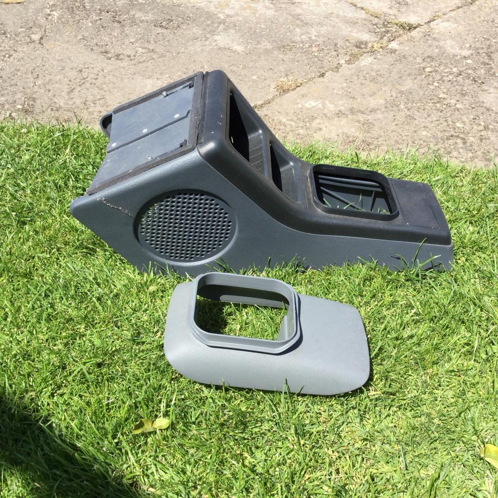

And I am curious about the two speakers(?) there doesn't, to me, appear enough room behind them for speaker magnets(?) or enclosure with the inset box tray (open area)
Felica 1.3 had already made a space for 2 speakes in the central console.
https://nemigaparts.com/img/catalogs/etka/st/101863500.png
https://m1.secondhandapp.at/2.0/5b27b219ccf1ea406c3fa31e?height=1024&width=1024
Even for the 1.6 can be found.
https://www.megaparts.eu/en/product/228925056#gallery
Thanks, but that position was probably for lower powered speakers and an expected acceptance of lower quality sound as the market for the car when new was not generally aimed at those that wanted higher quality "ICE" (in-car entertainment) as it was called in the UK then.
As with other components, items and parts in cars they can often be put in an available space rather than by full design.
