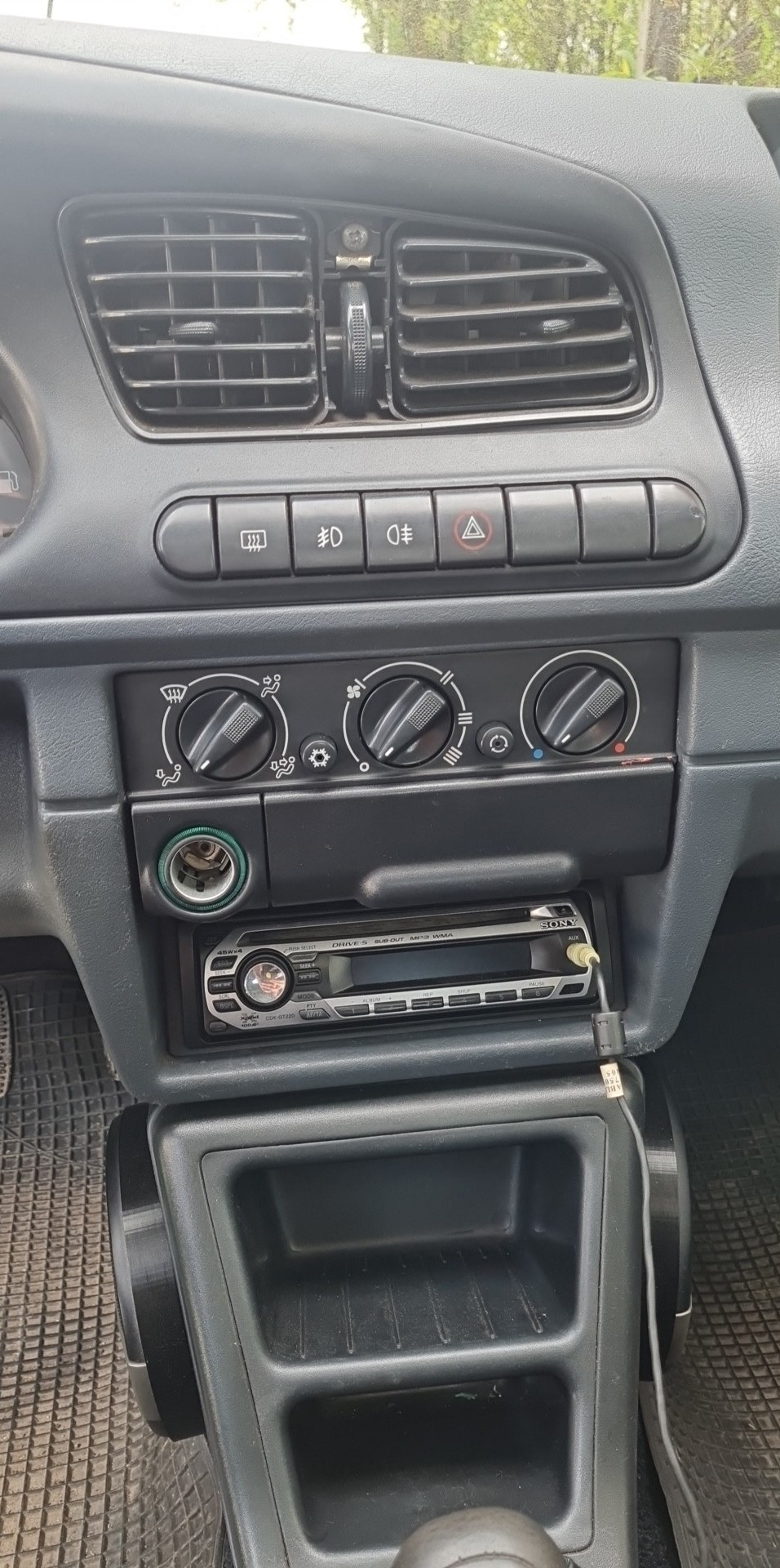

No, the AC controls are integrated in fan/heater controls as you can see.
I was in cellphone last night and i couldn't see those 2 small buttons below.

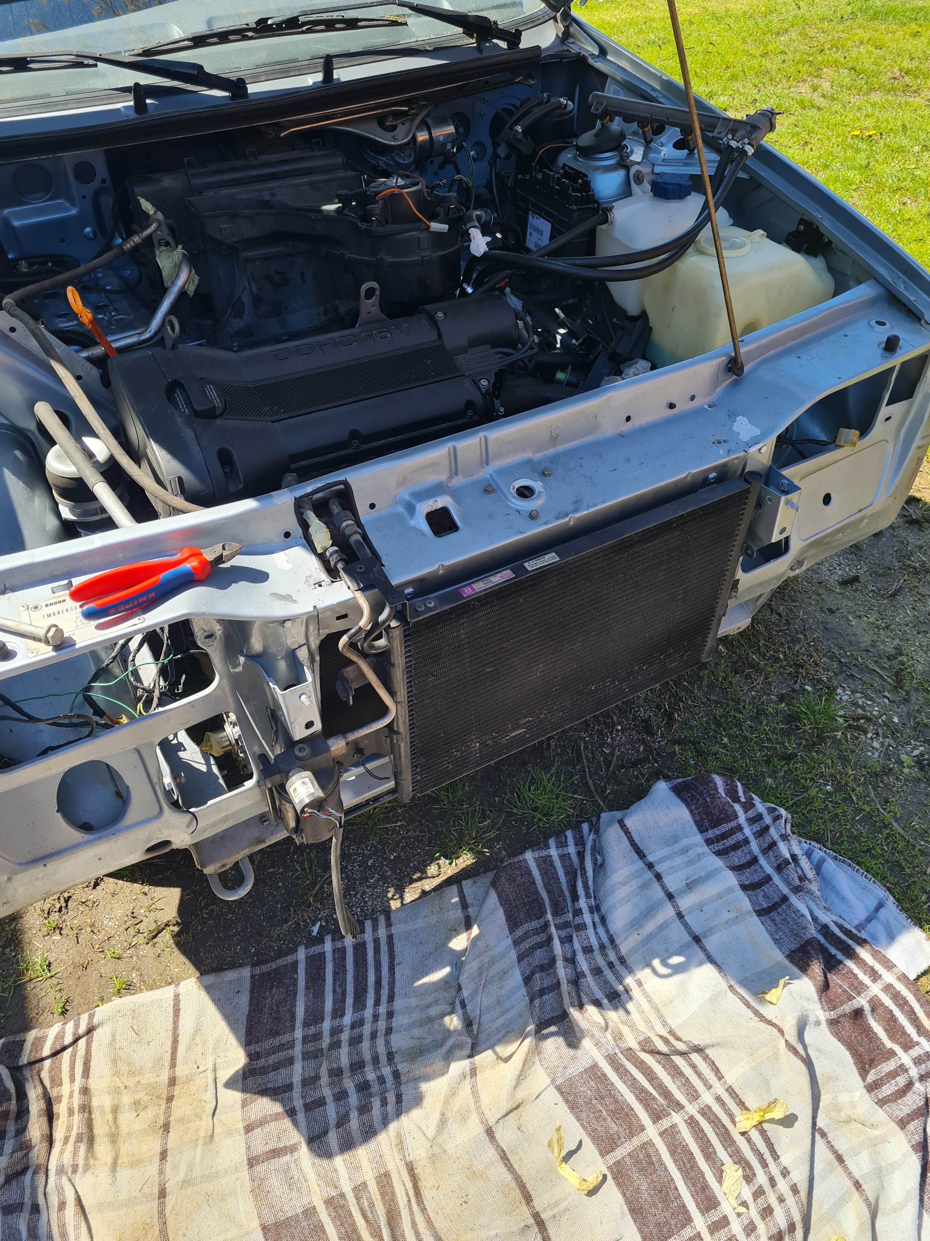

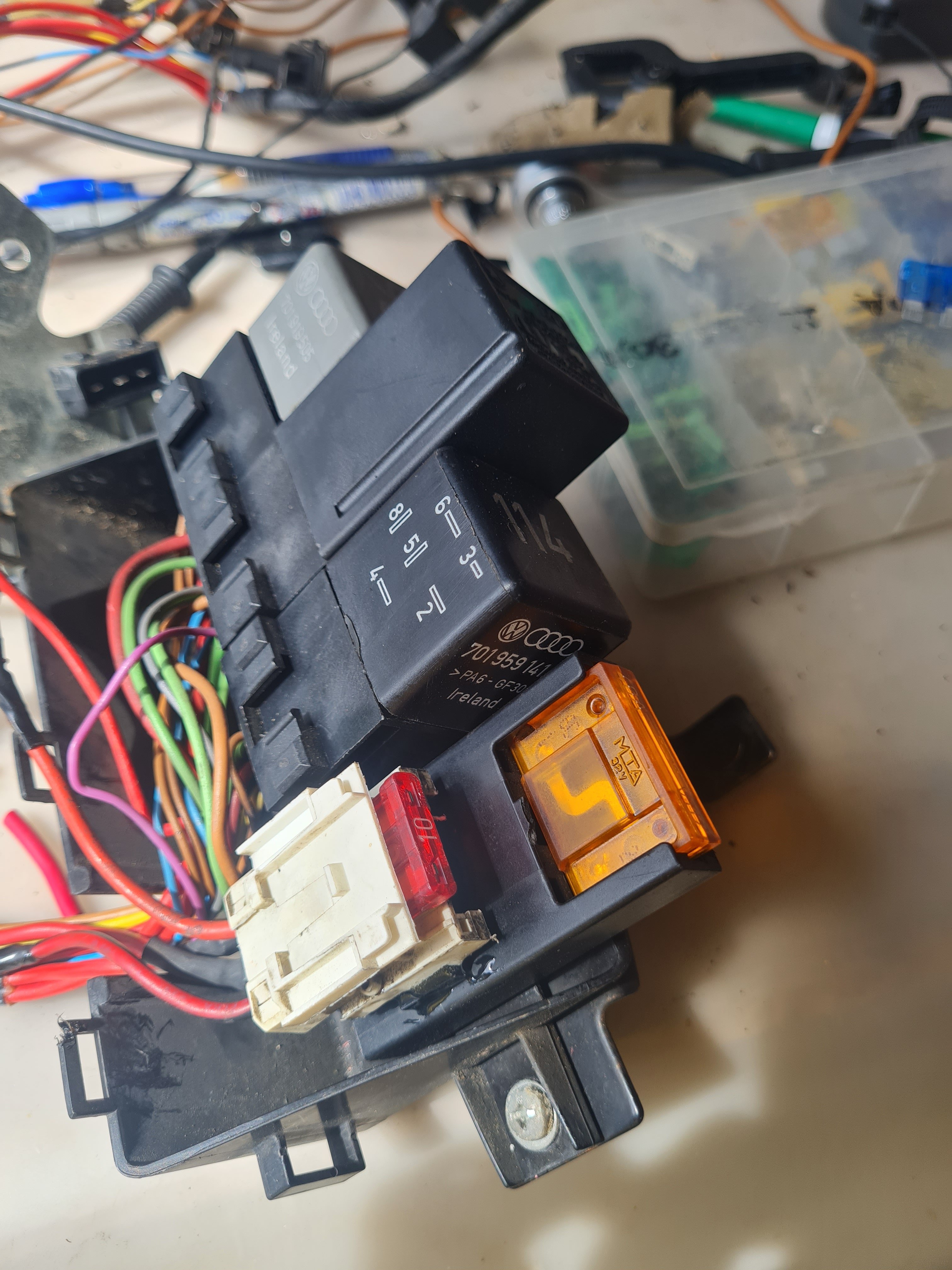

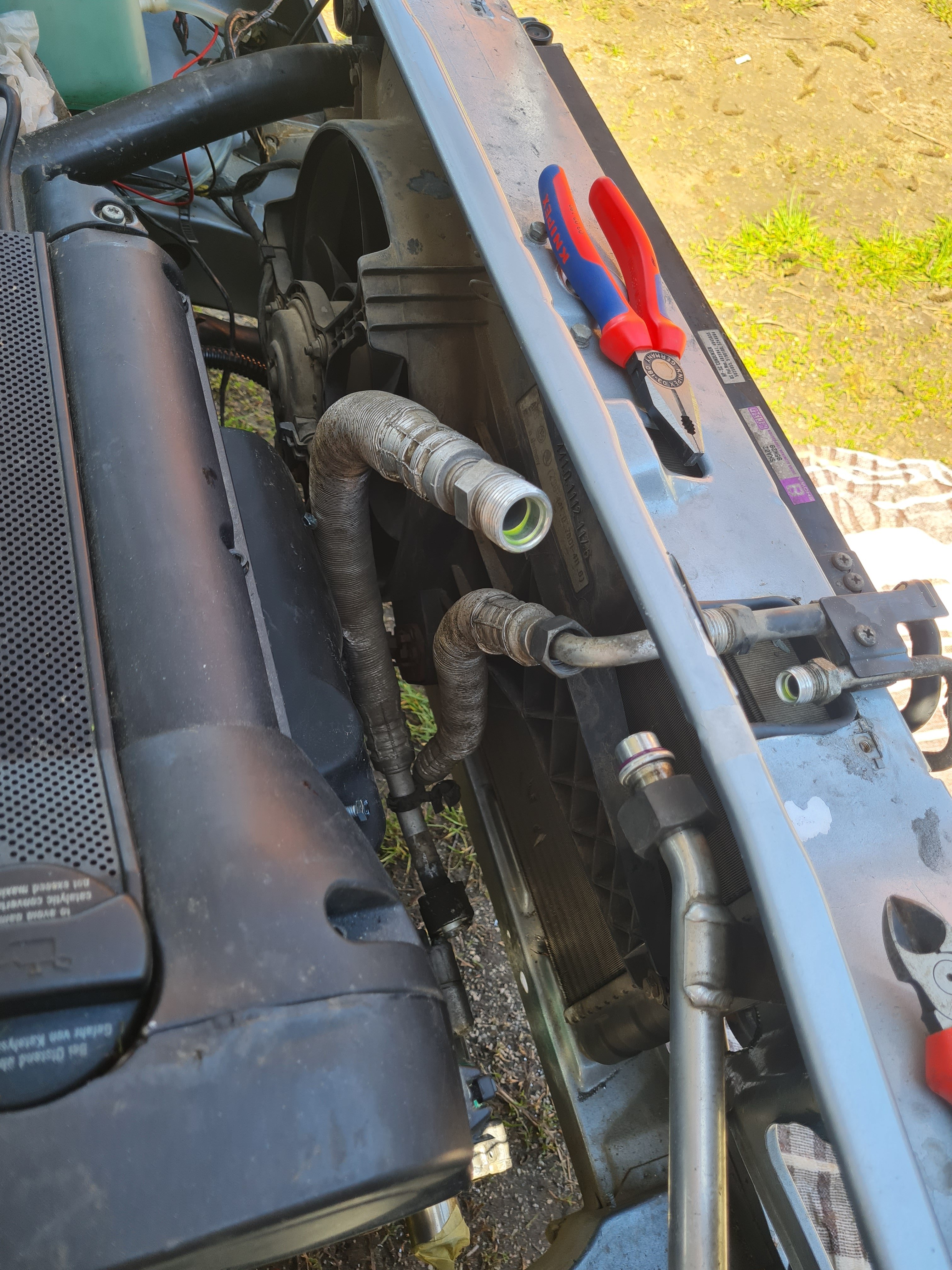

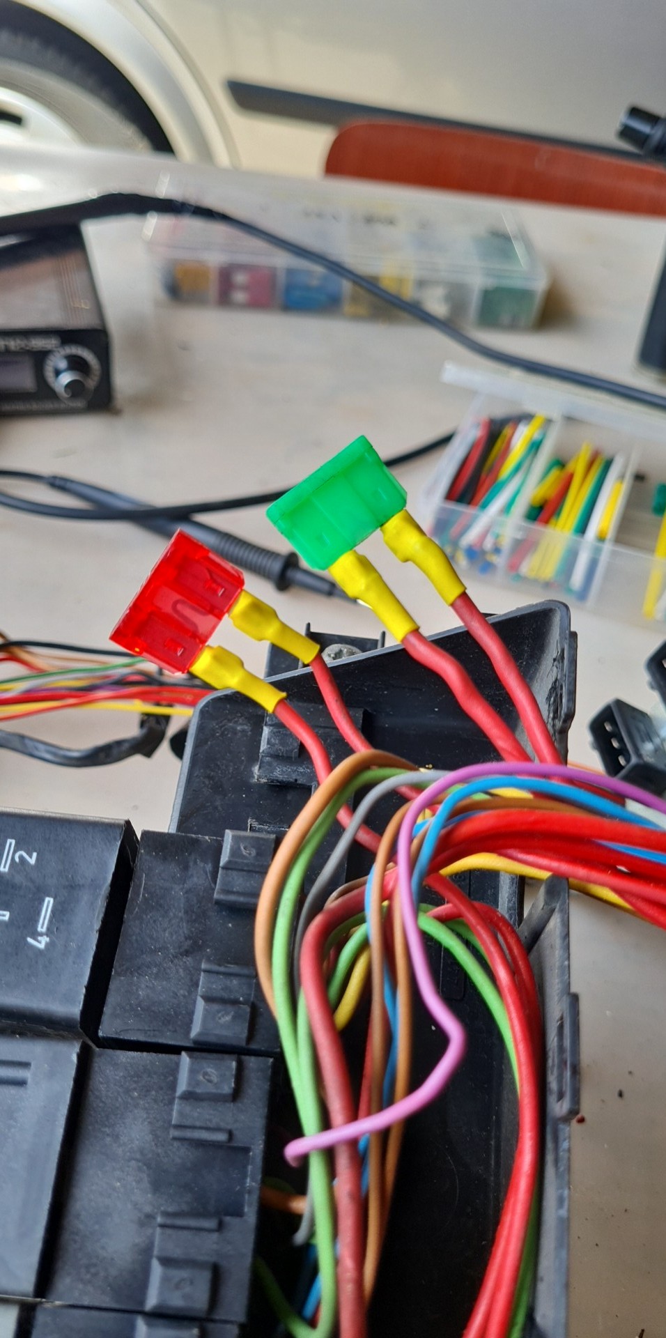

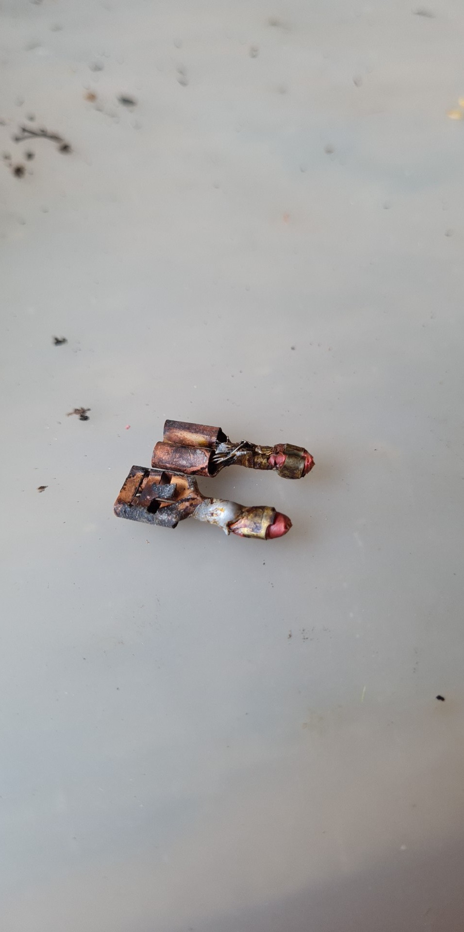

So, I did a few things. I modded the alternator/compressor/power steering pump carrier to fit my 120A alternator. I made some cuts to fit AC condenser and engine coolant radiator to fit in the Favorit. Luckly threw that together and looks like it will fit. I also repaired the radiator fan resistor (it burned out), soldered new fuses to the AC control unit box (I removed old 19mm fuse housings because they were badly corroded but I will order new fuse housings (161 937 501) and replace them. There was a bad job done by the previous owner when he was repairing those fuses and stuff like that.20230422_124436.thumb.jpg.1f89c59c489981b3cc1e106ba15a125a.jpg20230422_123558.thumb.jpg.c831b4527e223277dd4be11e754bc868.jpg

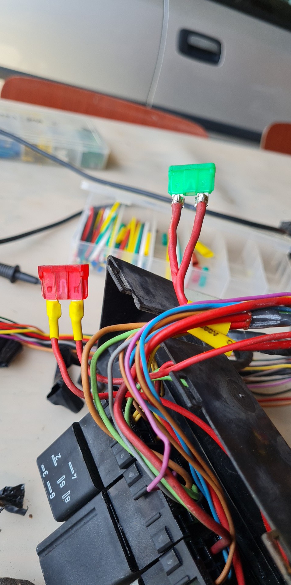

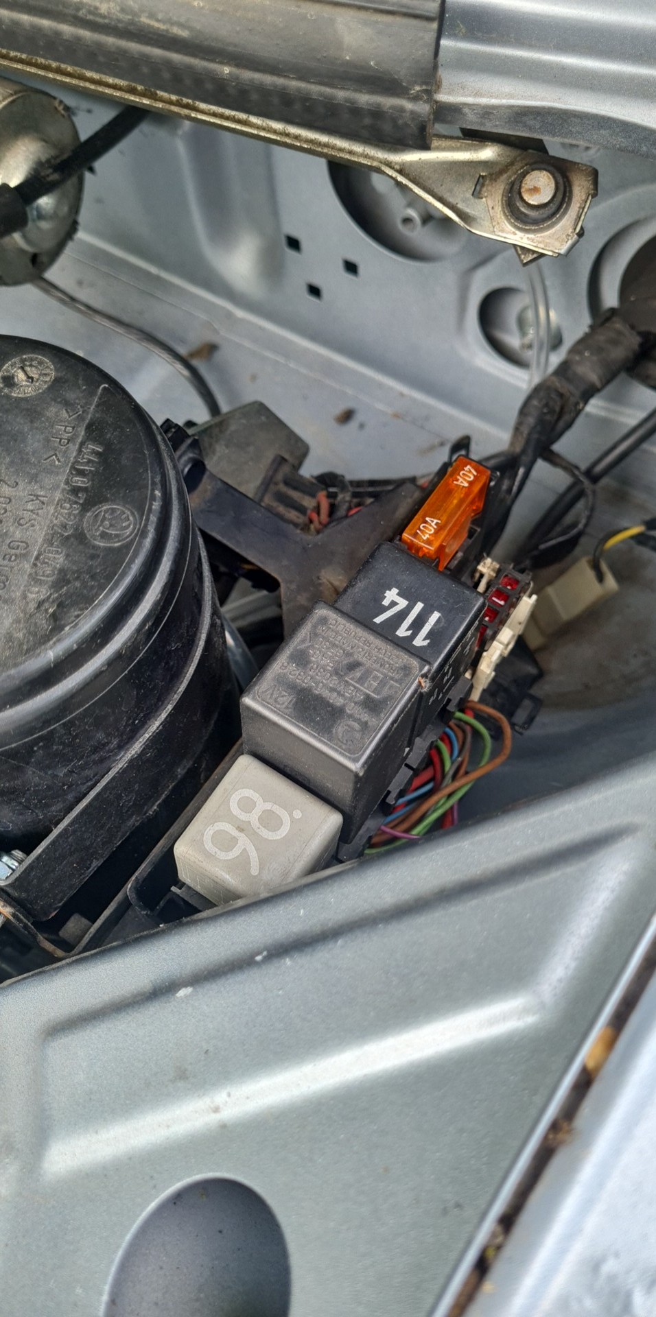

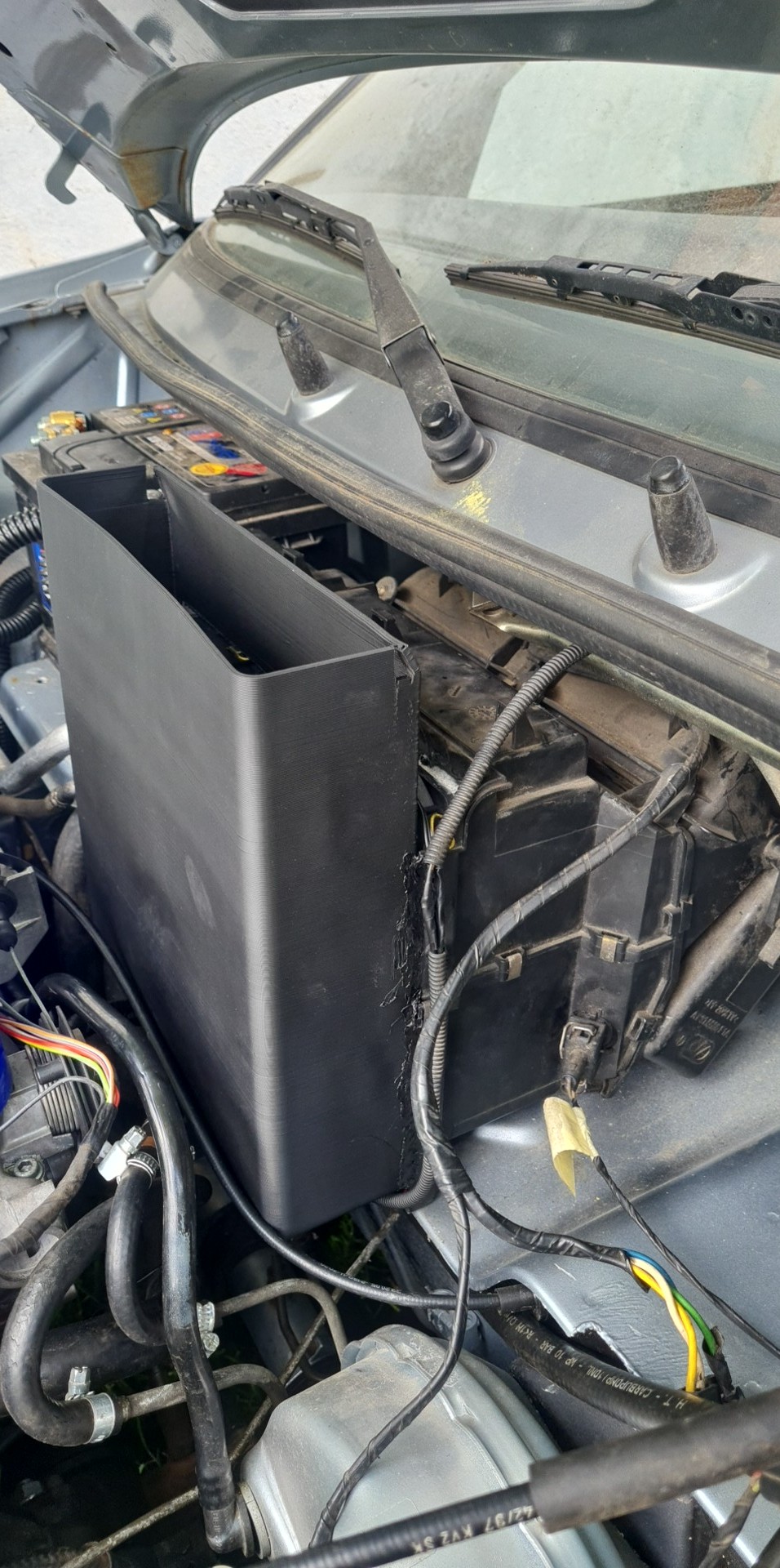

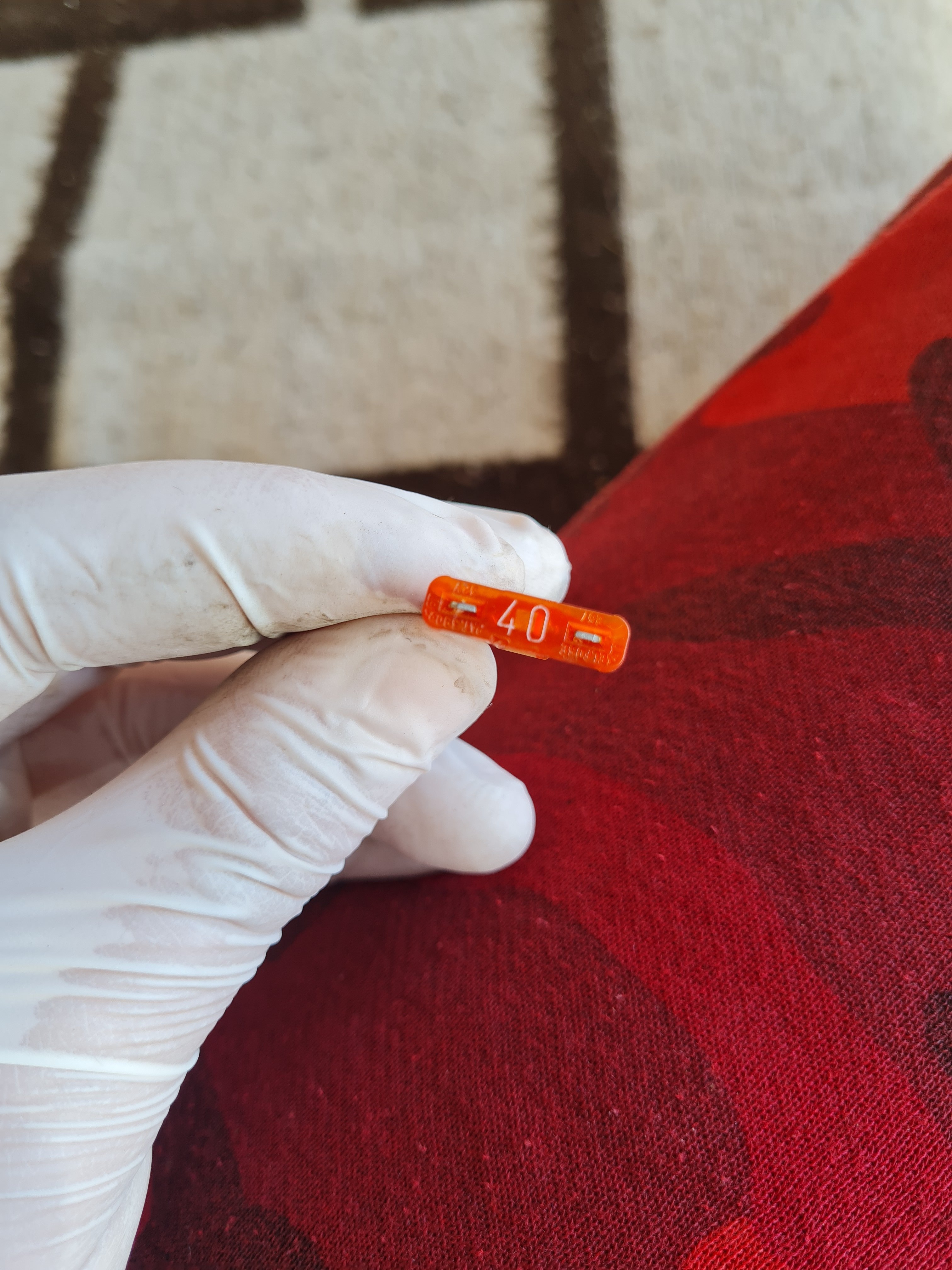

So as I said, did a temporary repair for the fuses and did some fitting onto the Favorit. 30A fuse should be a 40A, don't worry, I found one 19mm 40A fuse but I am thinking to replace the 19mm fuse with the 29mm 40A fuse because its easier to get a 40A 29mm fuse rather than 19mm 40A fuse.3cee0d1d-9dbb-47a4-9568-550221241bc5photo.thumb.jpeg.39ee23b6e77e2c6c510f814afdfd1518.jpegb1ef32ed-7f2c-488f-8ef0-37b375583d1fphoto.thumb.jpeg.5c1b170bd529833422da93eaa4d75df5.jpeg35726fcc-ba36-4525-9040-c4de02d44e0ephoto.thumb.jpeg.2a7e5526d4bf6fa637e7cfdc08064410.jpeg20230422_153759.thumb.jpg.a4a00783cfa422defbe0a5e37ada43a0.jpg

What you are trying to achieve here is on the highest difficulty level.

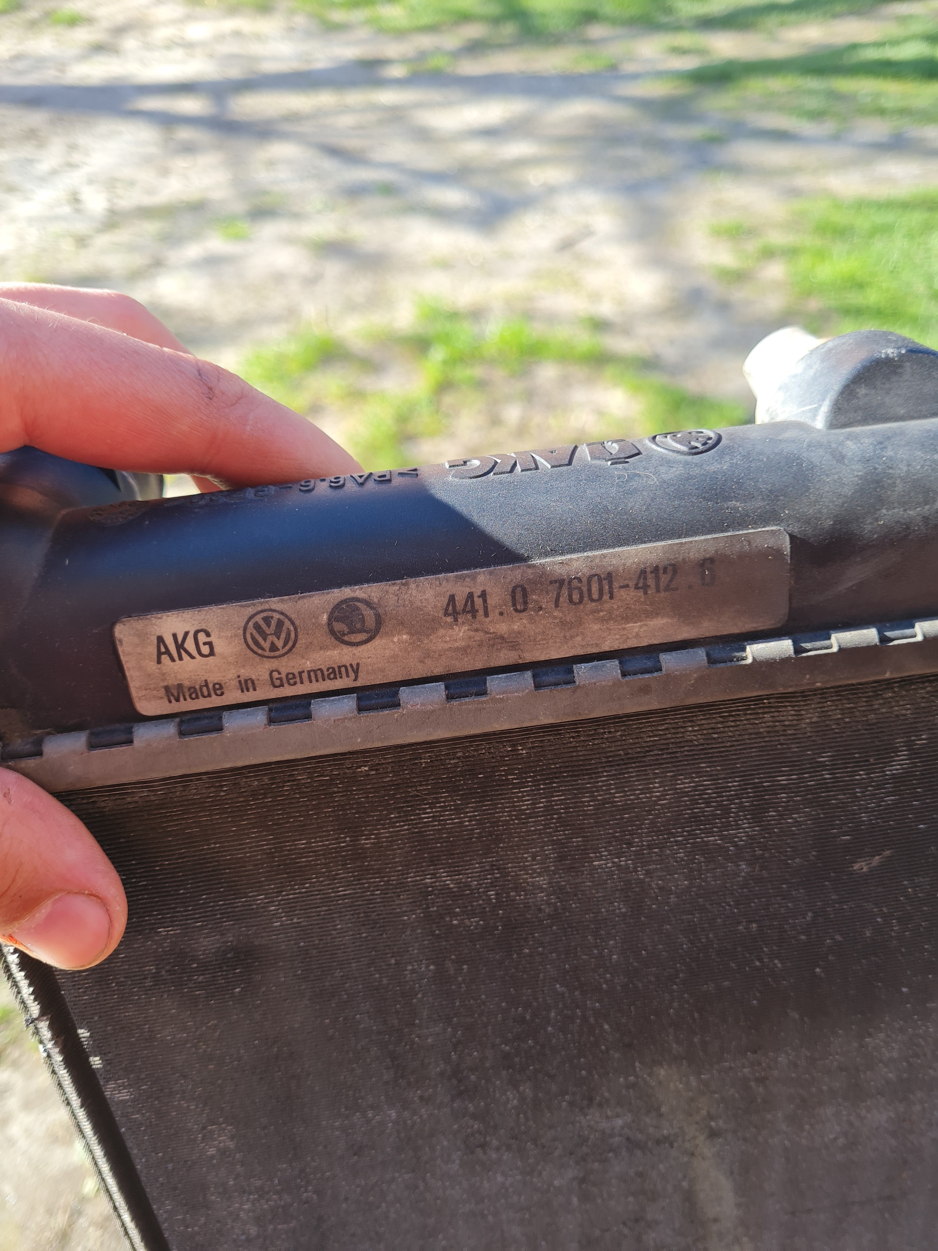

Did you used Felicia 1.9D radiator and fan for cooling the engine?
Thanks😁
I used the Felicia 1.6 with AC radiator, same as the 1.9D if I am correct. (441.0.7601-412.6)

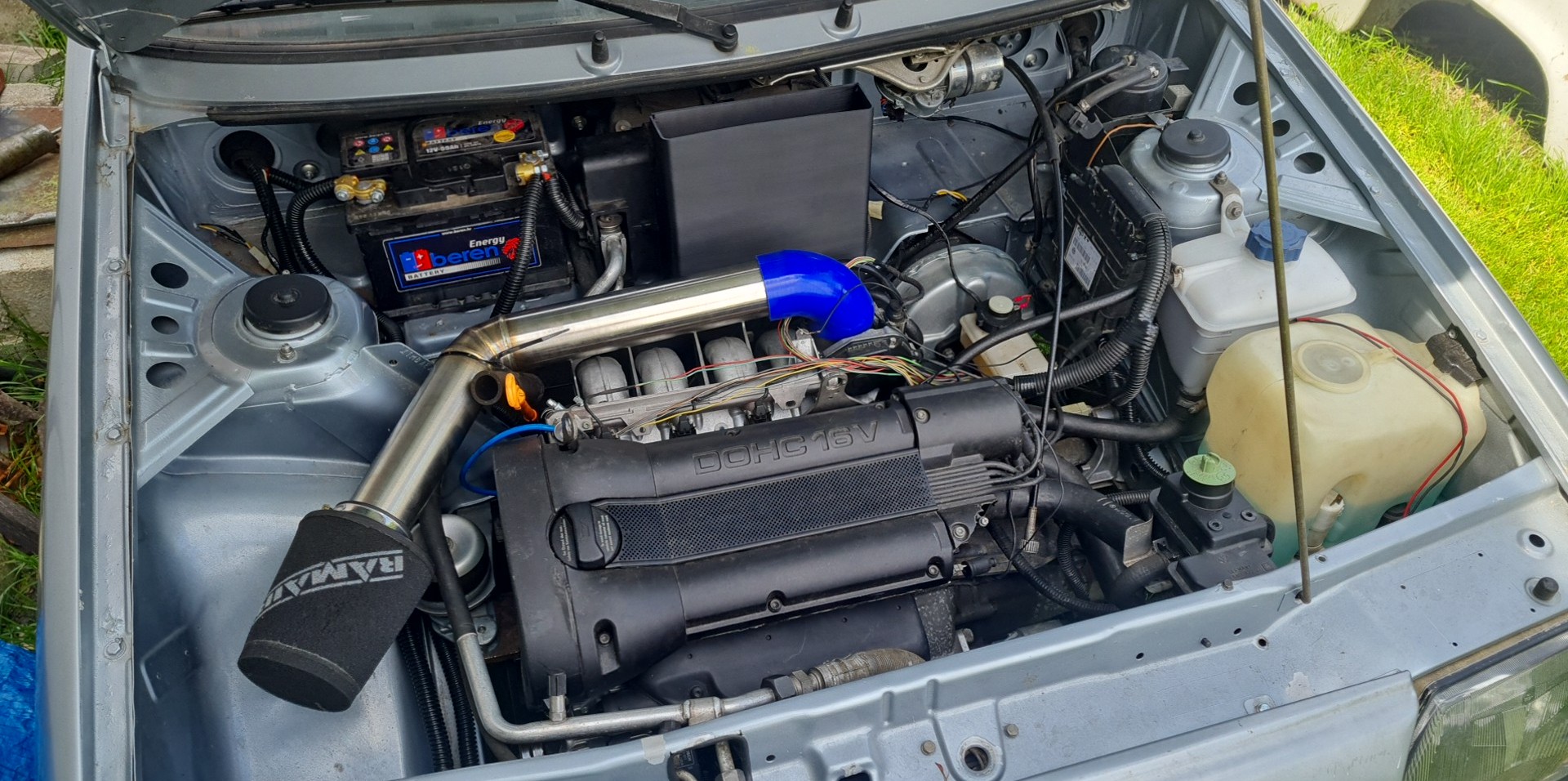

This is awesome. Looks like it's quite tight around the inlet manifold - will the original airbox fit?
There is no original airbox. I will make a new intake manifold because its interfering with ac/heating box.

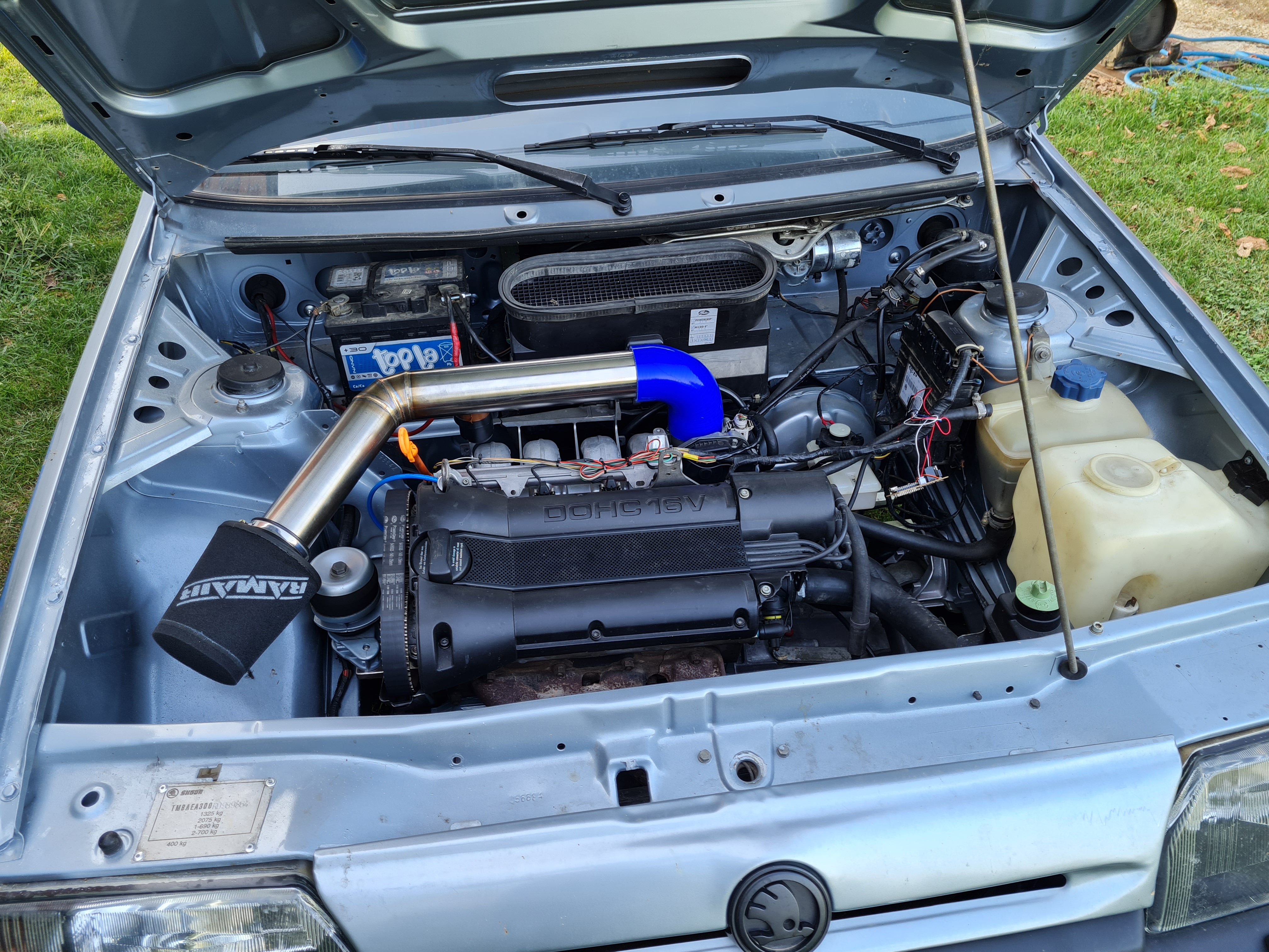

I use this when it's time for extra ''outside'' fuse, no problem with water-dirt etc.
After many-many tests with many kinds of air filters-POD's (sponge-gauze) etc i returned to the factory air box with K&N filter with the tube that brings fresh air inside from the grille.
With all the other patents i had noise plus hot air from the engine bay to ''feed'' them.
Yeah, about those fuse holders...The wires are too thin, I need at least 4mm2 in the fuse holder. I will convert to 29mm fuse. If you have high quality OFC fuse holder it will not corrode.
I know about the air box, but I like the induction sound and it looks good :D

You are right but a standard air filter box (02:27) can work even with a turbo 195 Hp
Although some guys do it different (01:26)
New intake manifold just for AC? That's dedication 😃
Does it interfere with the throttle body?

So today I have put new fuse holders and made some adjustments with the wiring. I will also NOT be using recirculation (I know that hurts the efficiency, but whatever🤣). Its too complicated to fit original AC with recirculation in the Favorit with 1.6 AFH/AVY...There is just not enough space. I will be posting more pictures tomorrow.20230423_141306.thumb.jpg.044e3c74e78f58994fda9552c2f28808.jpg

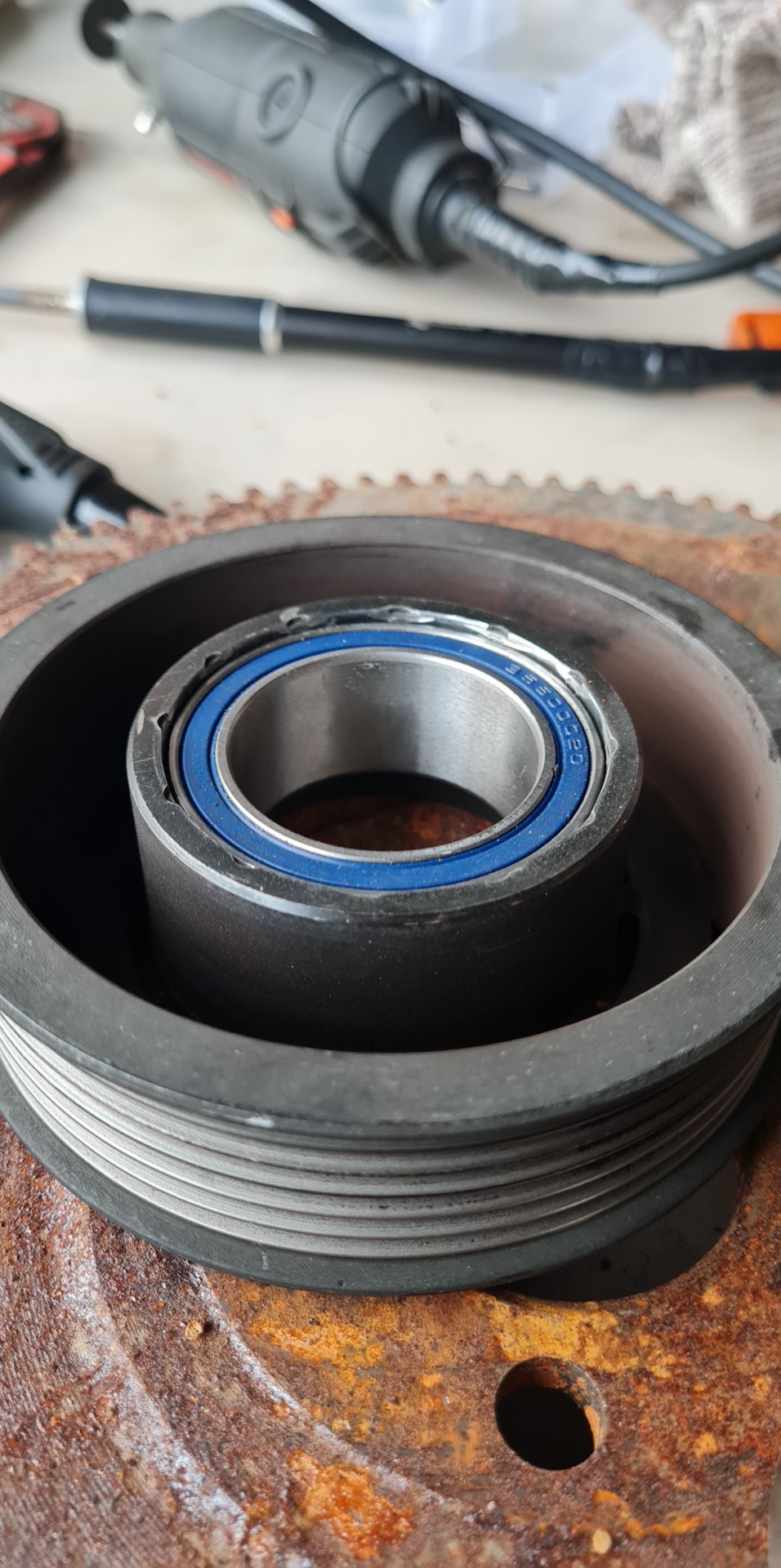

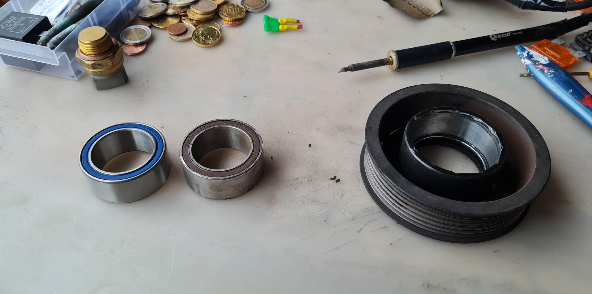

Got the new bearing for the compressor and new seals for AC linesreceived_918063549520102.thumb.jpeg.253dae024015b9a1b78e7272c87bc6f7.jpeg45392561-15df-4bac-a640-cb00d71981acphoto.thumb.jpeg.7d608322c14be3757b168ee8a5364351.jpeg
A/C successfully installed, I will be posting pictures tomorrow.
cea7cf87-adac-402f-82c8-279fe7e25443photo.thumb.jpeg.1497579afe86dec73c14ee902899ea76.jpeg86bf541c-b60d-4aa6-8eca-cc63aff15e46photo.thumb.jpeg.ef799398dba0d2600076e66aaeb82583.jpeg64297cb0-b348-46f7-a2d6-7564acf124d1photo.thumb.jpeg.1ba8083cd3c3712791494788c35050cc.jpeg8750203c-8d7a-43f7-8add-66be20a8e5d1photo.thumb.jpeg.253c780cef622a430481267884700748.jpeg90e52986-7cb2-44d9-9dc6-4877bfd7c945photo.thumb.jpeg.f845f04ea8bedd1ecba33f996f982652.jpeg
