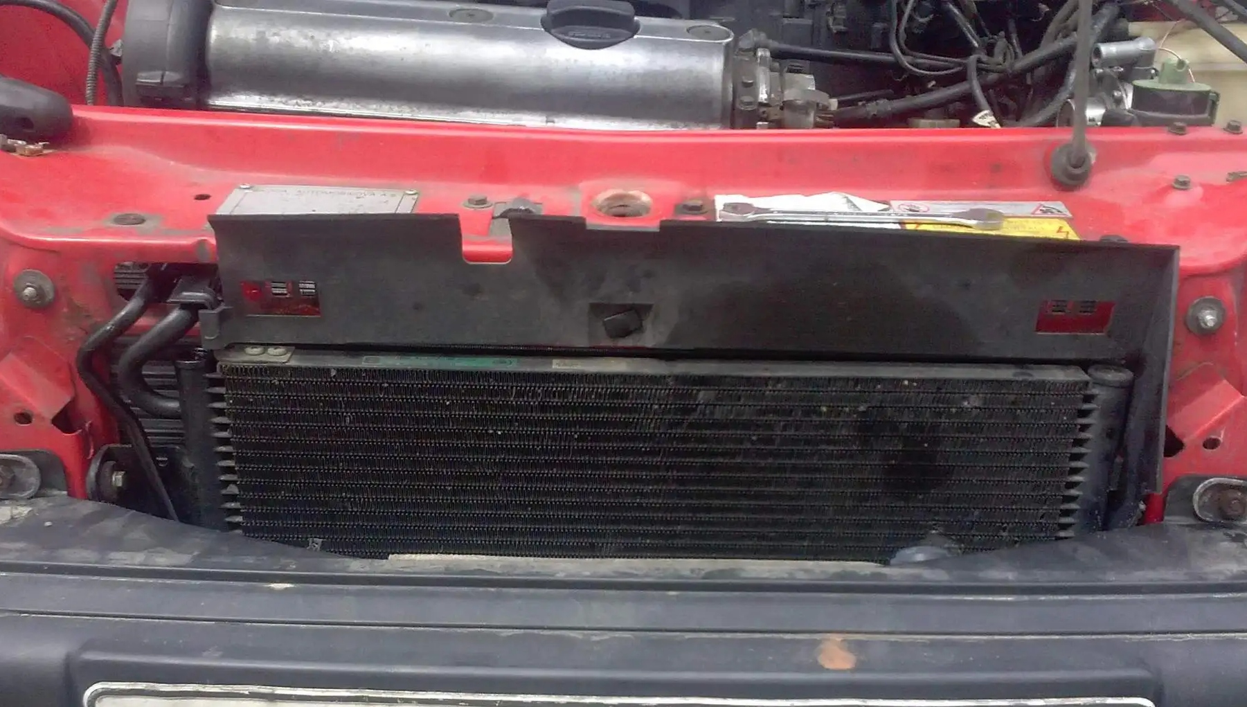

I will post photos tomorrow, i have gap of 3-4 cm till the plastic end of inner radiator reach a bolt with a hose from the outer radiator and i don't know if a bigger radiator can fit in there.
Here are 2 photos from my radiator, the back (the smaller) has only 3-4cm space till reach the bolt.
I don't see how a bigger radiator can fit in there. 😟

I don't know if and how a 1.6 radiator can fit in a 1.3 engine bay since things are very tight.

Can you move the condenser tonthe side to fit a longer radiator?
The 1.6 radiator is about 10cm wider than the 1.3 one. 1.9 is about the same width as the 1.6, but taller.
Edit: found dimensions and heat rating on jmjm.cz - although I'm not sure what's source of the information.
1.3 - 33 kW, dimensions 285 x 485mm
1.6 - 43 kW dimensions 285 x 590mm 1.9/1.6AC - 60 kW, 322 x 590 mm.
Edited by Papez
If i can "steal" 1-2 cm from one side and the 3-4cm from the other (which i can based in photos) then maybe.

Btw, I found photo of the condenser mounting on the factory AC. Pipes are routed through the body, above the radiator - that's how they could fit a bigger one for 1.6.
