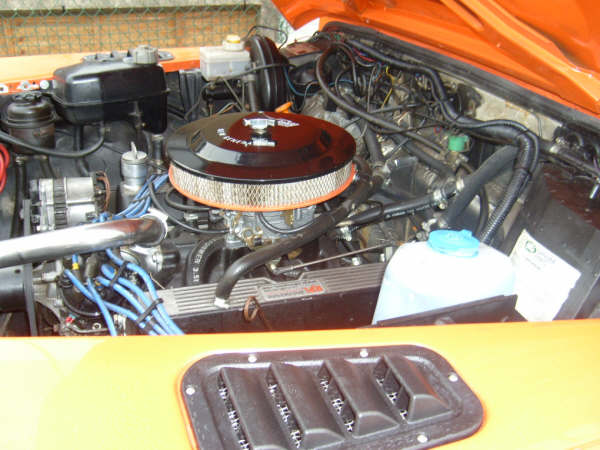

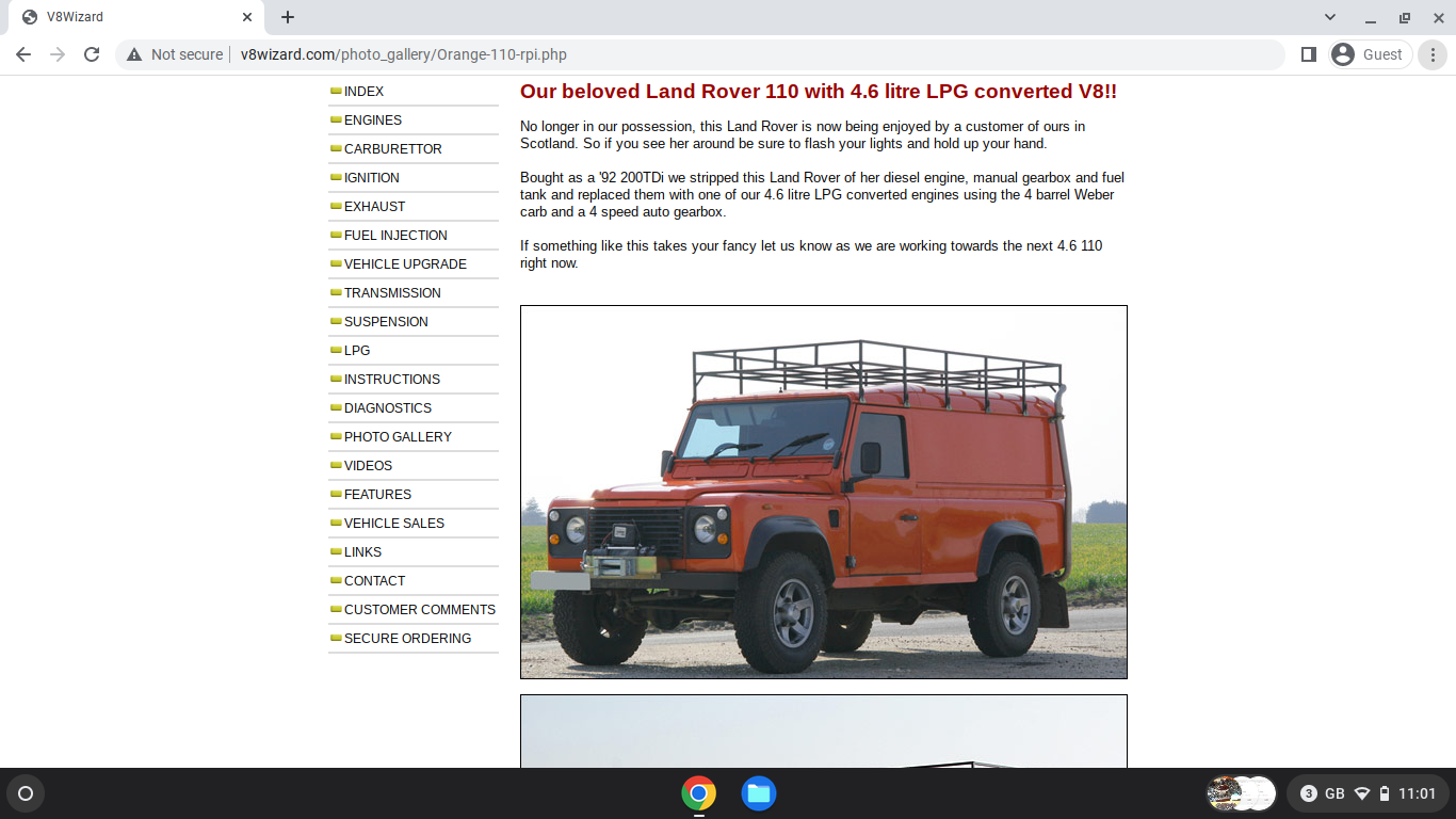

Of course they did, they were behind the radiator in the engines compartment drawing air through the radiator and aiding cooling.  You have fans on some cars Infront blowing through. You have cars / vehicles moving and the airflow going through.   A switchable additional fan was very necessary on my last 4.6 V8 auto running on LPG.
EDIT.
Pics of larger capacity radiator and addition fan missing right now.
Edited by toot
@toot : You have also hood vents to help the hot air come out from the enfine bay.
No.  For cabin air intake.
Just instead of the plates with holes you get on top of the wings.
At some points they were blocked because not required offroad, and for engine air i ran a Snorkle and wading plugs and raised breather axles and exhaust.
As it is you engine does not overheat.  Run water wetter as a coolant if needs must, but your needs do not require.
