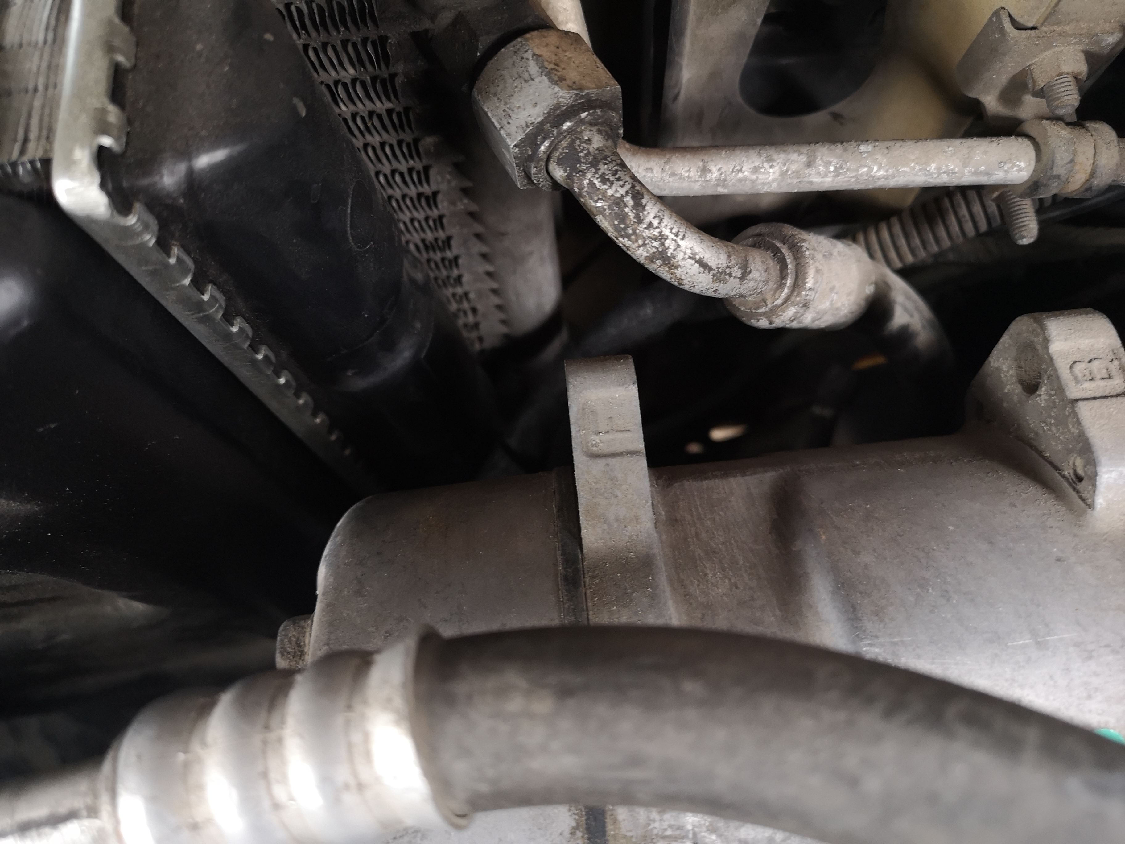

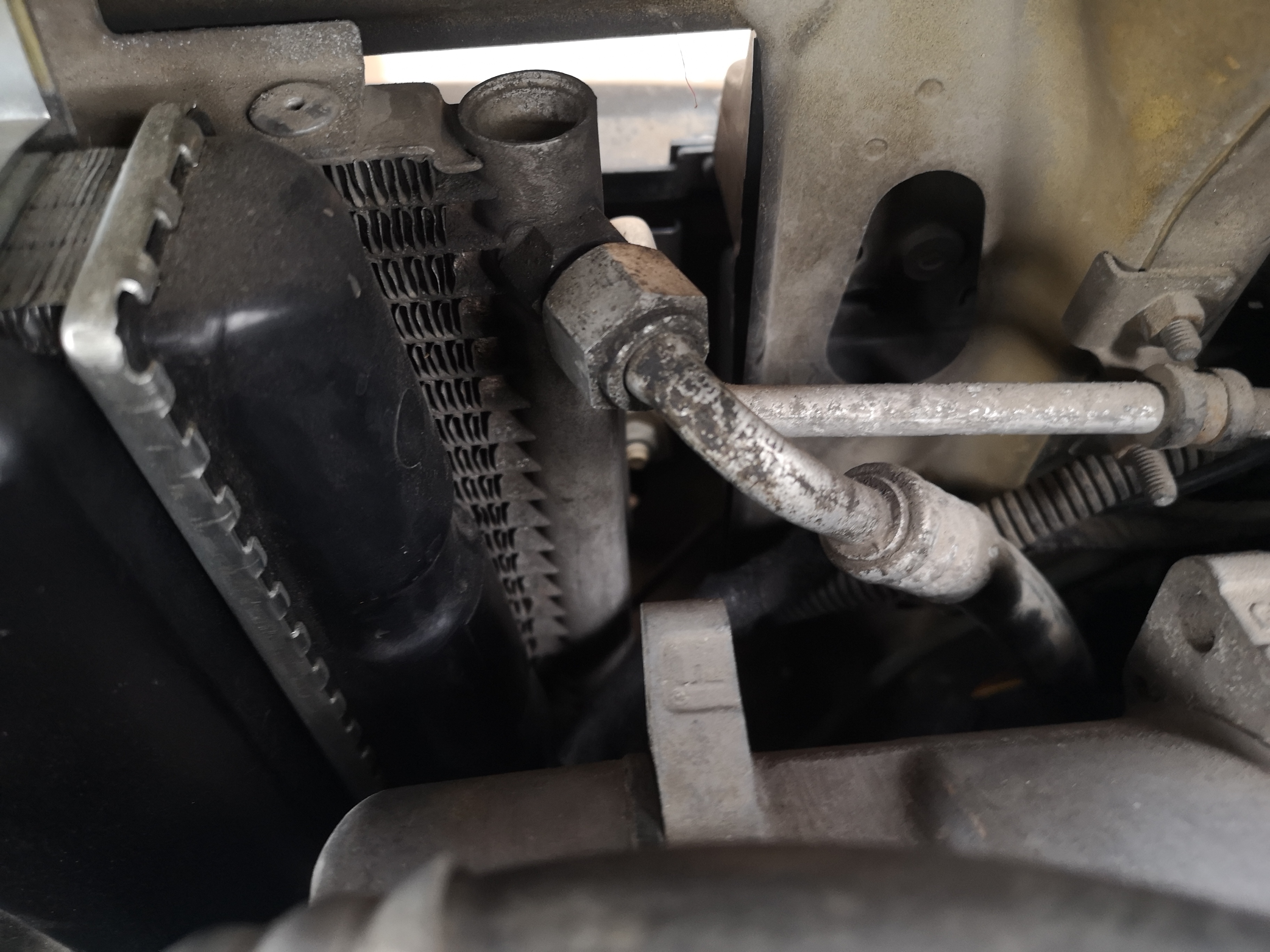

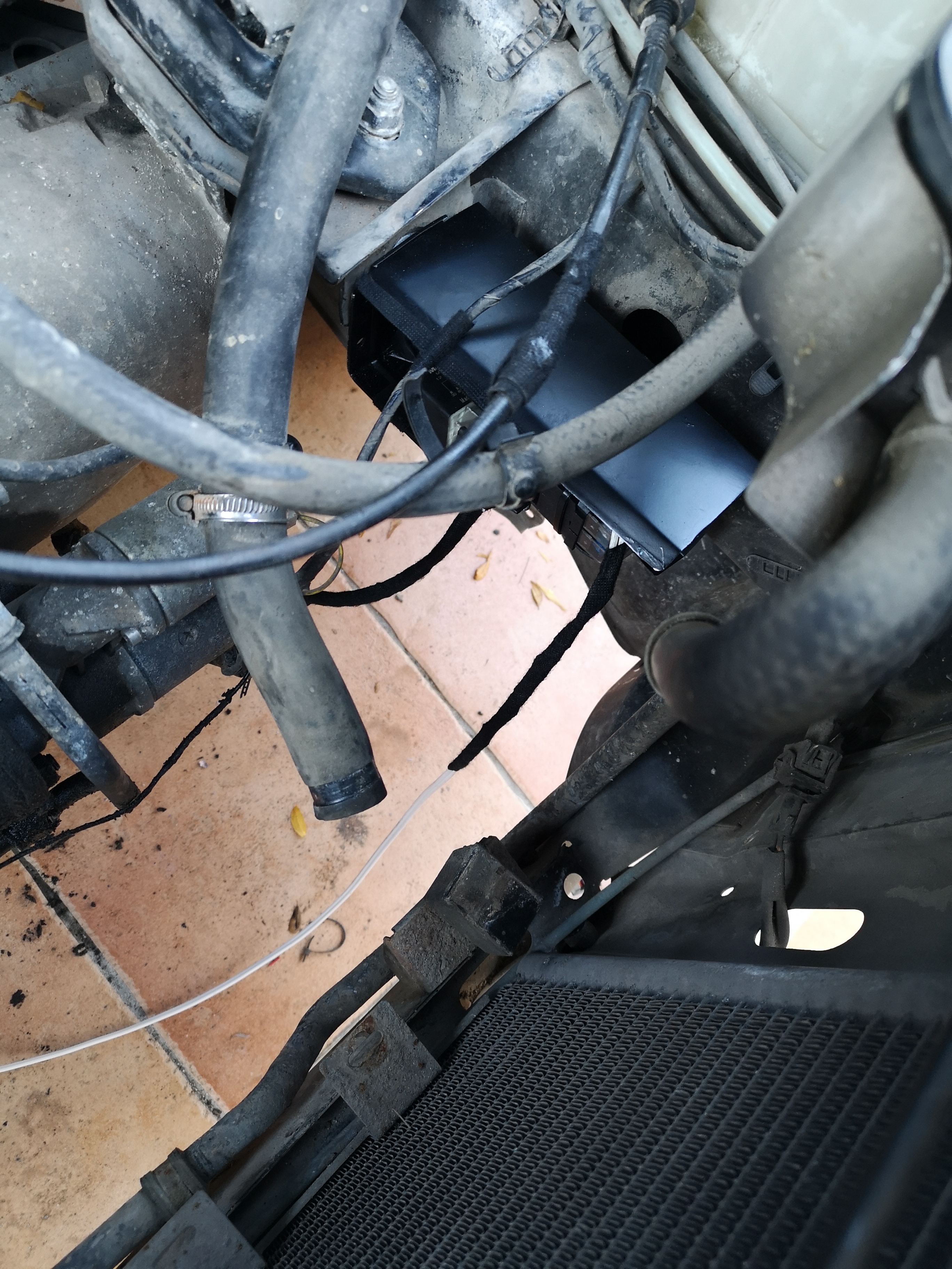

This is the front-left
the front-right

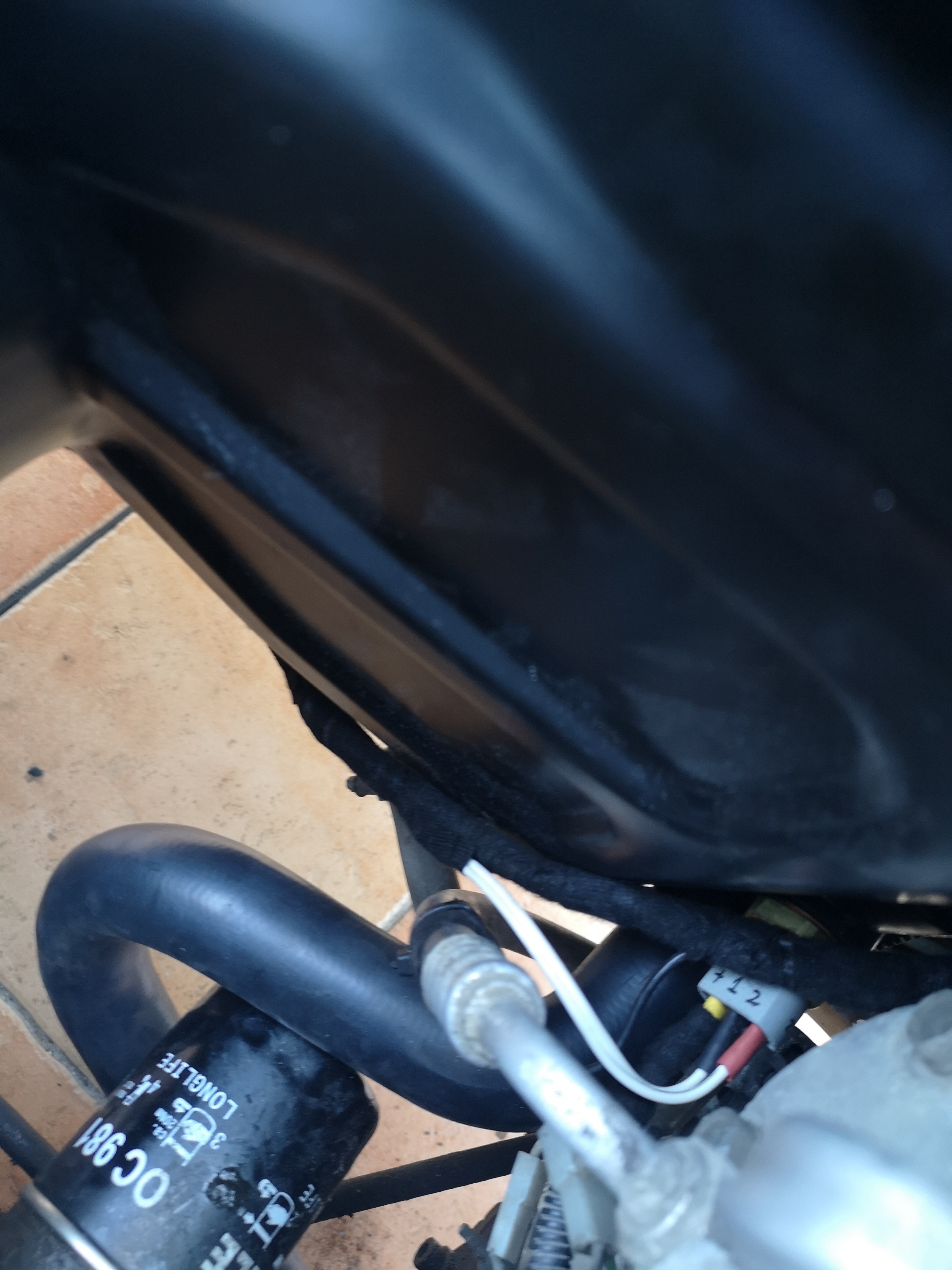

and the Inside-right side.
I see an empty space down there, the hose is from the end of the radiator estimated about 8cm plus at least 3 from the other side is 11Cm
From the 1.3 radiator (485mm) to the 1.6 radiator (590mm) we have 105mm (10,5cm) so it may fit even a little bit tight.
It seems that if you moved the radiator to the left, it'd be covered by metal - negating the difference in area.. Only solution would be to route the condenser pipes properly, following the factory installation - which would be probably quite expensive.
@Thefeliciahacker Do you have, by any chance, an installation manual for the Alex AC unit for 1.6/1.9? It'd help to see their solution of the issue.

My car has enough space and enough cooling.

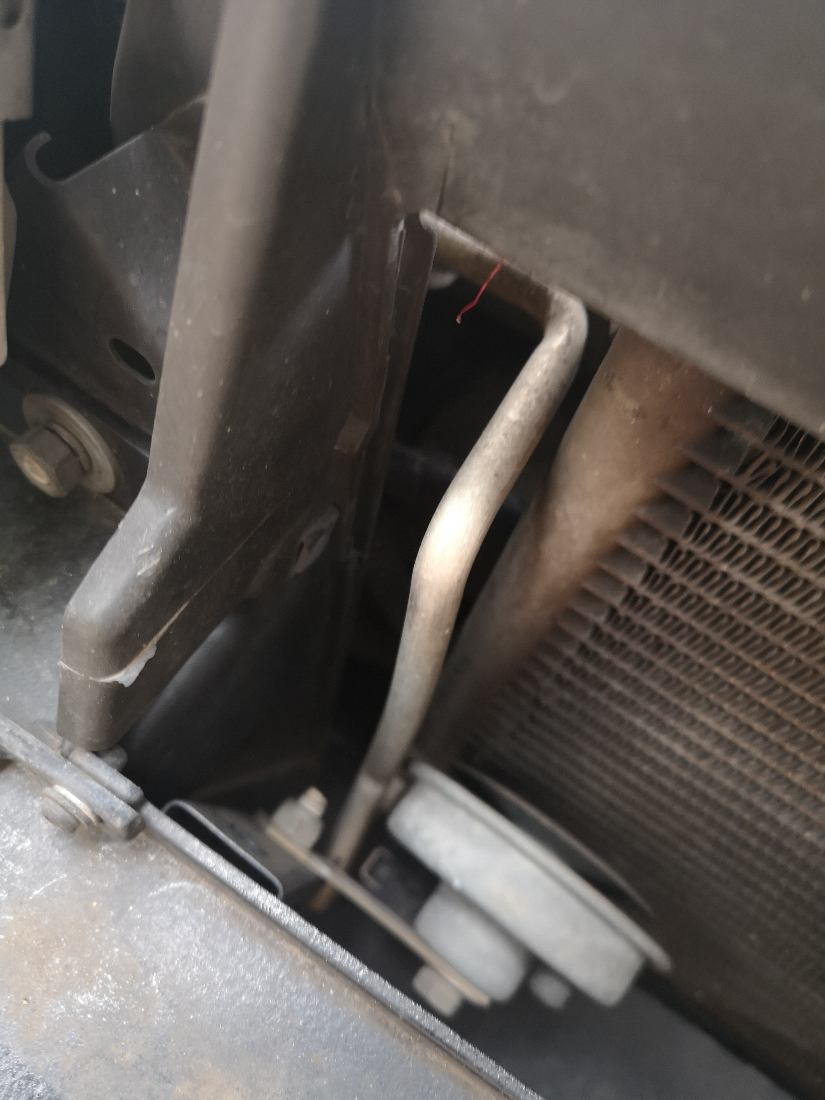

Where does the upper pipe go? I can't see it in the photo. But that fan shroud looks nice :)
Enough cooling - there were instances where my Felly didn't have enough cooling (highway, 120kph, uphill, 30°C), even without condenser covering whole rad 😁
Isn't that for the thermostat?

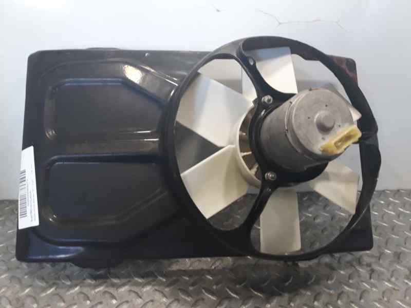

Also @Papez It's a duct which increases the efficiency of the fan. I found this out when working on a 2.0l Cortina; I changed the cambelt and didn't replace the shroud, with the result that the engine temperature, which had been stable at about 90C, went up and down between 70 and 110C.

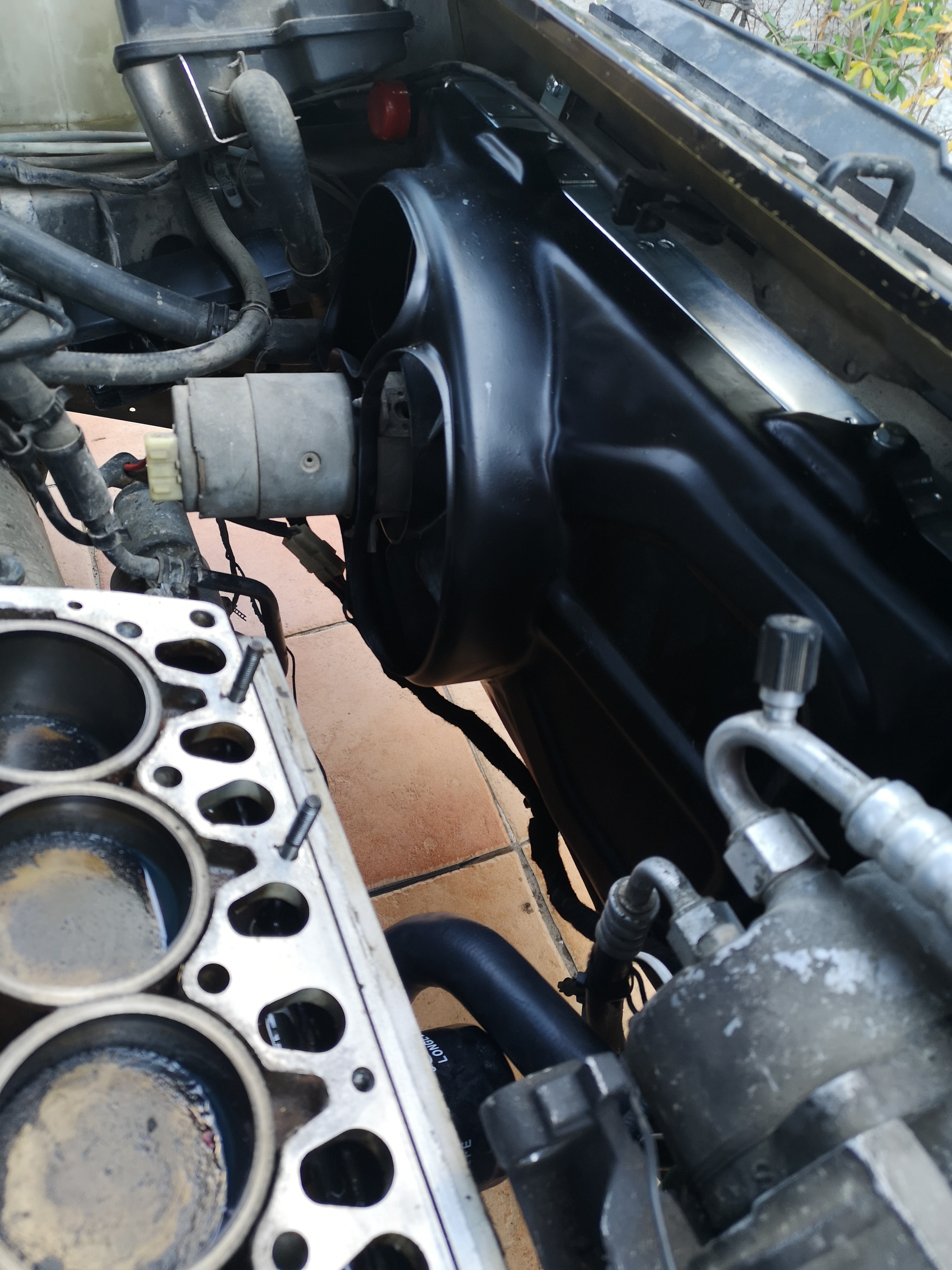

I have brand new mahle rad the upper rad hose sits right below the hydro steering reservoir
Yes, it has been mentioned elsewere that removing this plastic duct only makes things worst, the inclinations on the sides makes more incoming air to "hit" the radiator and not lost in turbulances around it.
I meant pipe to the condenser pipes/hoses.

To install the 1.6 radiator i had to pay a guy to modify the front duct to make it wider and pay a mechanic to modify the condenser pipes to gain few cm. On the other hand some cm will be lost on the other side since car's body metal sheet covers them.
The body shouldn't cover the rad - the plastic shroud on the passenger side is cut away with the 1.6 rad. Unfortunately that's where the condenser pipes are run in your car..
