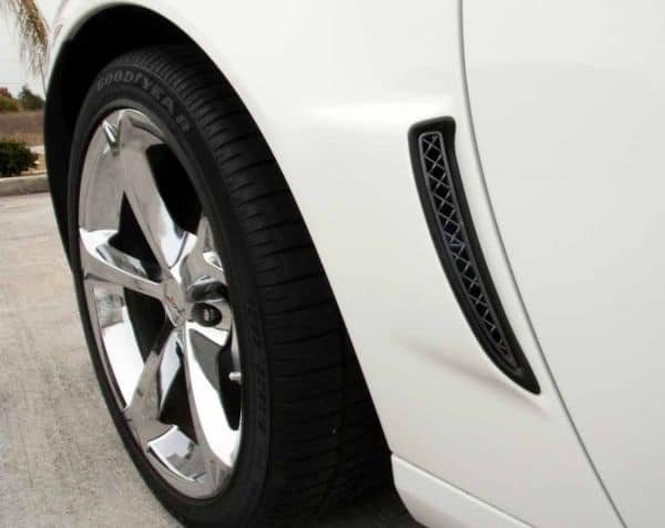

I will make my Felicia like a Corvette with side air vents to get heat out from the engine bay.
C6%20Side%20Air%20Vent-black%20w-chrome%
ACC-Blakk-Stealth-Side-Vent-Inserts-1.jp
LOL 😄
