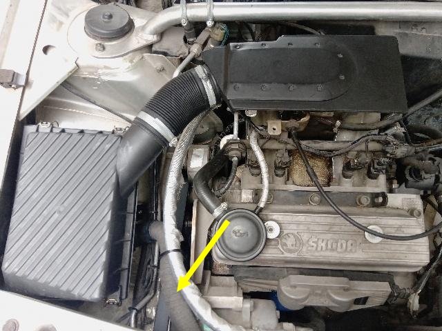

  • Also, there's not much space above the throttle body, which is the reason why the factory cover is shaped in this way - I'm not sure whether would a normal L bend pipe fit.   But I've seen p

    Same code, one (top) bought in a parts store and the other (beneath) is from an e-store.       Look the same in diameter but as you can see they have a difference in the end.
  • D.FYLAKTOS
    D.FYLAKTOS
    Unfortunately the 3.40' is a ''rule'' for VW no matter the season but if there is one positive thing is that now with the modified air box filter in the first few hundered meters the car is one click
As i can see here the diameter is almost the same till the end when becomes narrow.

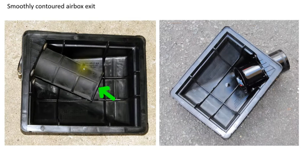

 I have just found something relative althought i don't agree with the holes in the bottom of the air filter box.
https://www.rs2000-16v.co.uk/newsitefiles/filters.htm
On the other hand i have seen this trick with the tube and the bell mouth in racing cars.

I start searching for "Bell Mouth" and "Velocity Stacks", i have found these:
My thought was to install a tube like this to make more air come inside the tube to the throttle like this
