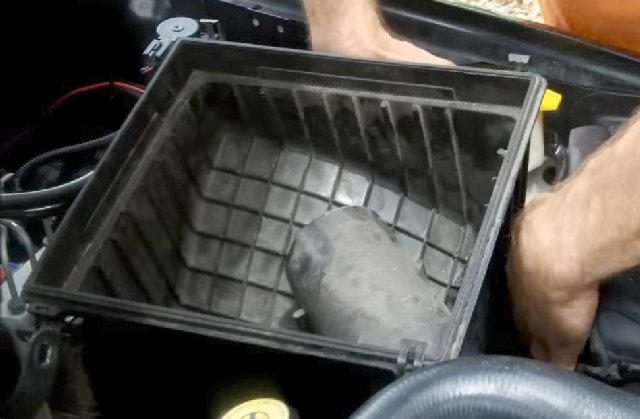

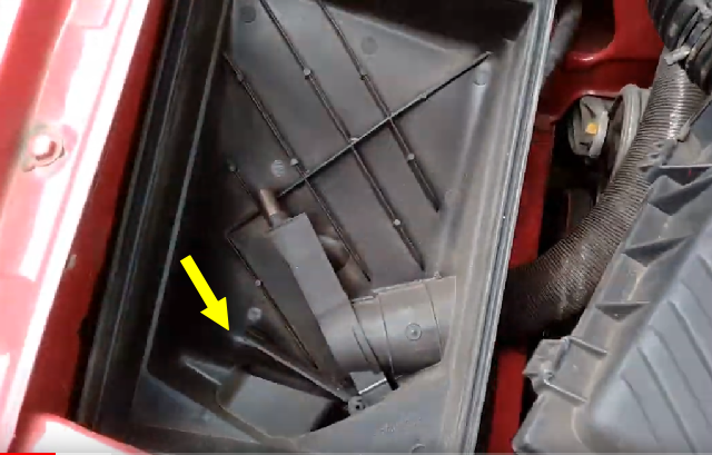

I have found from another Felicia the stock air filter box.
Inside the mechanism is stuck, the flap is semi-open so the car takes some hot air inside the throttle even when does not need it for exampel Highway.
I have never regret that i have removed it.
no its a thermal spring when the car heats up the flap close the hot air intake...
Yes but the car was cold, the flap must be closed but as @Papez has said in the past that flap may times get's stuck in one position because the wax that used as a ''thermostat" has a leak.
From another car, take a look the inclination of the air filter box and ho much space that tubes covers.
On the other hand i have seen dozens of videos with guys making holes beneath the factory box only because the sound would be ''better", more ''roaaar", i not interested for that kind of things.

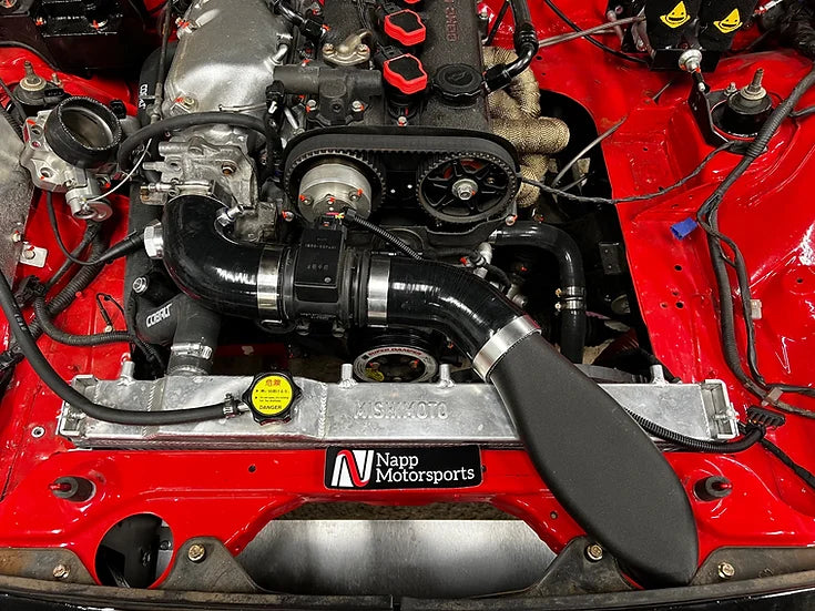

Here is the ''Ultimate'' Miata Cold air intake
NAMiataCobraIntakeMAF.webp?v=1697595216&
From round goes to this squeezed shape and then back to round, in the video say about Bernouli etc.
I wonder if that worth the $395.00 USD and what kind of improvement offers.
See? That's an engineer's idea, no work inside the air filter box as the amateurs do, ha ha...

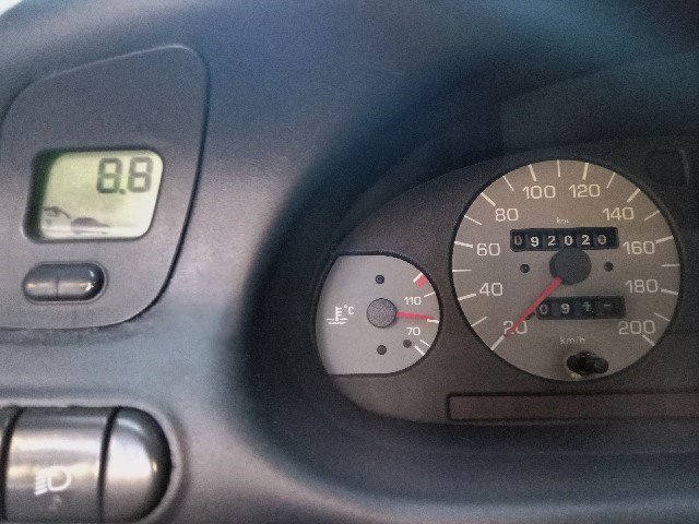

I post in other topic that i drove 41 Km distance, City traffic, about 20 Km Highway, 2 Km Mountain Roads and the rest City traffic till i come home.
This wasn't for Fuel Consumption but for the Radiator flush circulation but i grab the chance to measure it.
Total (Σ symbol) 8.8 ltr gasoline for 91.9 Km which means 9.57 ltr/100 Km or 29.52 Uk MPG

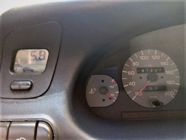

I just remember that i took some photos before i start that test so i can calculate precisely the Fuel Consumption for that 41 test distance.
Tomorrow i will post the results and make @Thefeliciahacker feel uncomfortable (AGAIN). 😁
Luckily i found the picture that i took before the test, from the 47.3 Km went to 50.5 Km plus some gas spend in extended idle for the coolant flush-add distilled water plus additive.
So from that point i went to 91.9 Km and spend 3 ltr gasoline (from 5.8 ltr to 8.8 ltr) for a 41.4 Km distance test (include City traffic) so the Fuel Consumption was: 7.24 ltr/ 100 Km or 39.02 British MPG.
