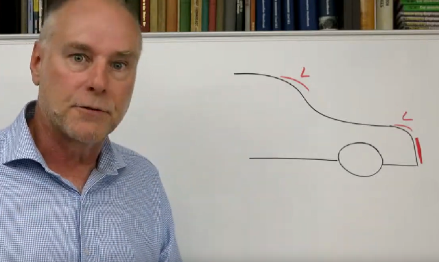

I first installed that hose without having seen this video.
Listen what he says at 4:19 ,so i did the right thin !
As we say here: ''Better late than never".
