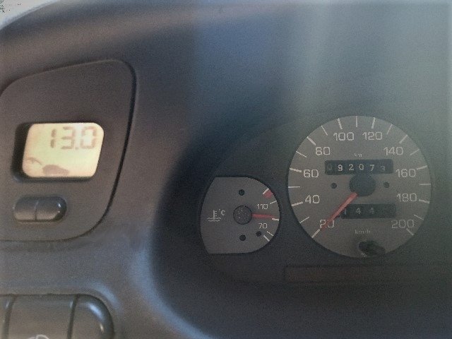

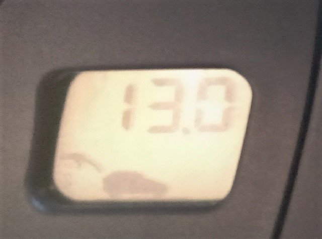

Here is the result for the Fuel Consumption.
The photo is not good by i had the sun reflections plus the worry for the tyre and the burned motor.
The Σ symbol is visible, means Total.
I began with 9.6 ltr gasoline and 94.9 Km on the odometer and i finished with 13 ltr and 144.5 Km, so i consumed 3.4 ltr gasoline for 49.6 Km distance.
This is 6.85 ltr/ 100 Km or 41.24 Uk MPG for a mixed road conditions test, better than the previous but i feel i had to make another one before i say Case Closed.

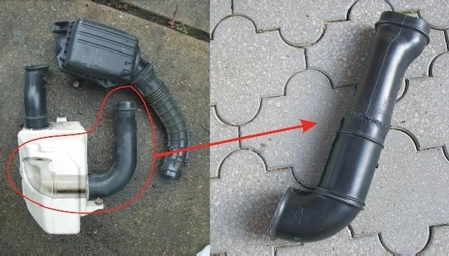

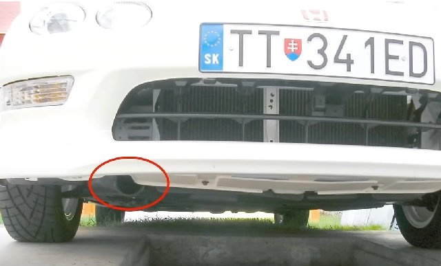

This is a project from a guy with Integra Type R DC-2.

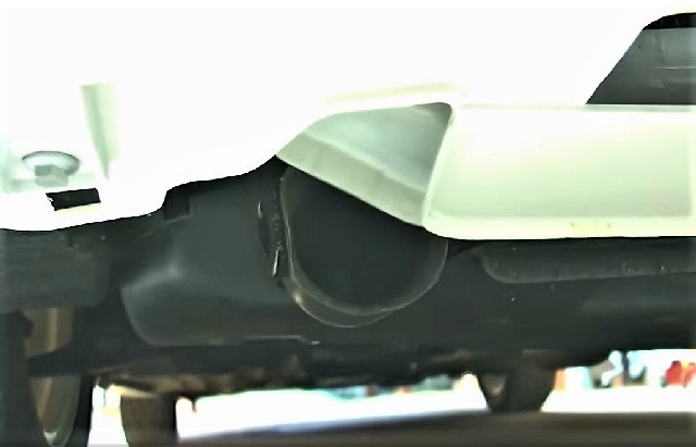

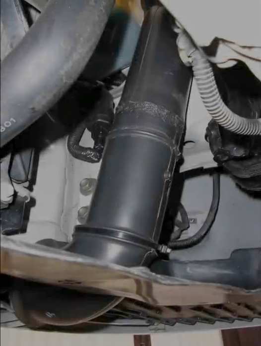

This tube brings fresh air from a high pressure area inside the air filter box.
I want to locate the position that Skoda has the factory spot for Felicia, must be a hole behind the bumper but i will try to find a tube to extend it so the air will income better.
This can be done only if the car is lifted, i will try to find an opportunity in a local repair shop here.
That guy doesn't want to go anywhere near areas of flood water with that.
The tube has a J shape, i don't think it's so easy for water to come up.
He kept the factory air box filter.
The red highlights are his.
So the engine might stop through lack of air and it's just wet legs pushing the car out, which is better.
There must be a drain hole inside the air filter box, mine has but for sure it's not enough if the front of the car dives into water (big pothole or stagnant water).

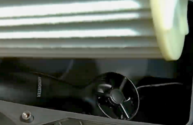

Here is the video from that modification.
Take a look at 0:53 the Anemometer which installed to take measures.
There were no measurements that I noticed from before this was fitted as a comparator.
Interesting that the inlet scoop was partly covered from direct line of air by the the body rail, disturbed air might be better or worse.

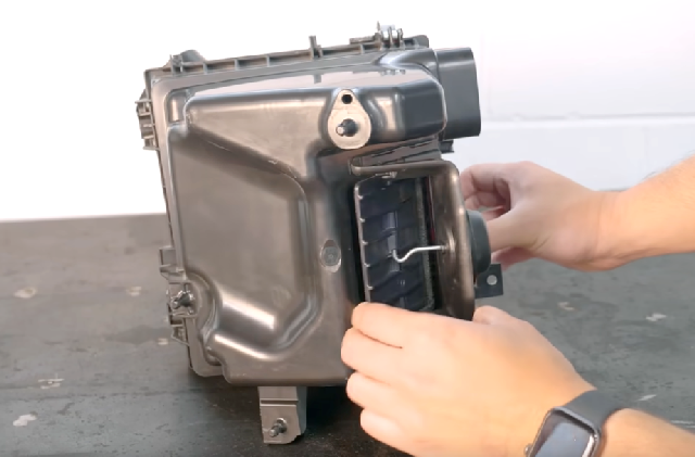

Here is what i found today, Toyota GR Corolla Ownership | Good and Bad Times Ahead.
At 16:50 till 18:02 says for bad factory design that sucks hot air, see? the engineers are not ''perfect" guys and always there is room for improvement.
Here is how they solve the problem.
Warm air intake?
https://www.grcorollaforum.com/threads/warm-air-intake.1479/
So even in modern cars an small modification can do the difference.

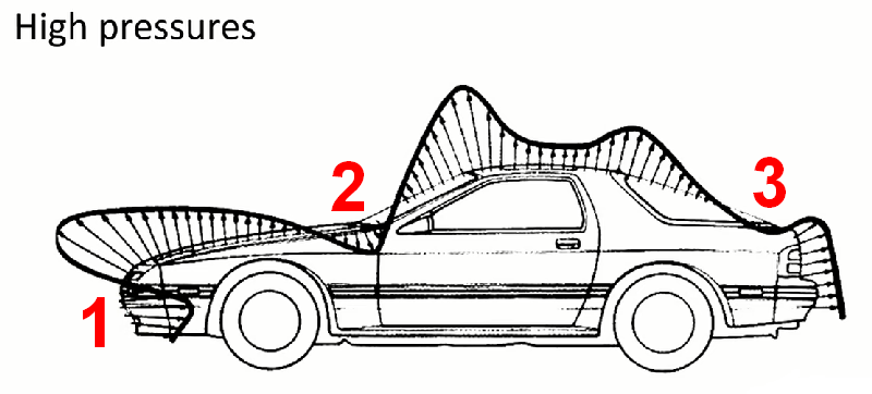

Another very interesting video about High-Low (and Wake) pressure surfaces in car's body from Julian Edgar.
https://www.youtube.com/watch?v=F1ZWBlHhR9s

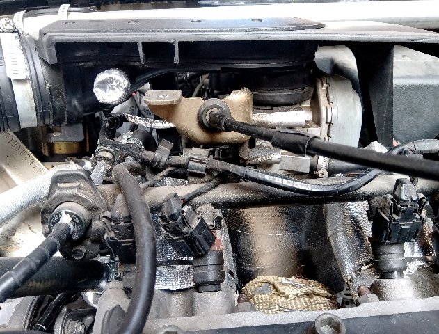

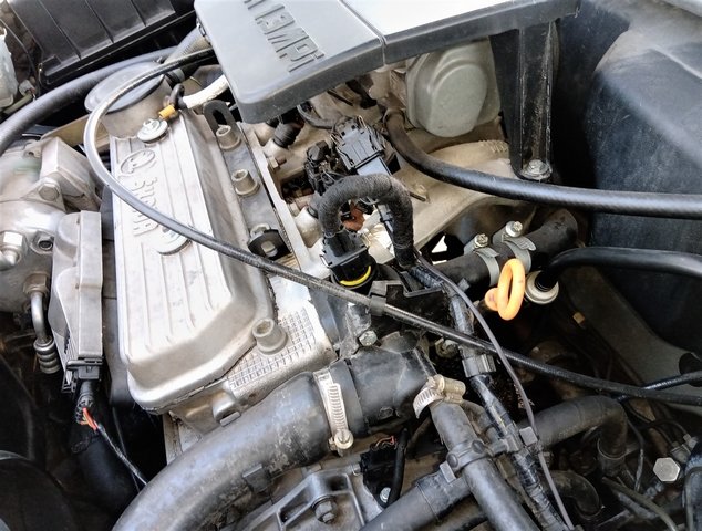

I don't regret even for a second for cutting that part of plastic, helped me to install easier the Heat Shield, lubricated easier the cable, cleaning the throttle quicker etc.
Unfortunately i didn't had the chance yet to locate the exactly point (behind the bumper) that brings fresh air inside the air filter box but i think the extra hose in the grill mesh did it's job.
The summer Fuel Consumption tests are over, photos and comments in a new topic.
Since we talk about covers, air intakes etc i have found this.

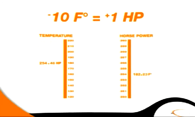

For every 10 'F colder air some engines can take 1 HP.
As for the cutted cover take a look how it was
and how is now.
In the past i couldn't work-maintenance-check things beneath it as i can do now.
By the way i saw a spot from the exhaust manifold that has been ''uncovered'', i will fix it soon.
Is your engine in the region of 254.46 hp to gain this 1 hp at 83c.
The climax was going from top to buttom, was a snapshot.
Was an (general rule) example of how the hot incoming air affects the performance.
Fair enough, but +1 hp at 254.46 would surely be within margin of error of testing but I do understand your general point.

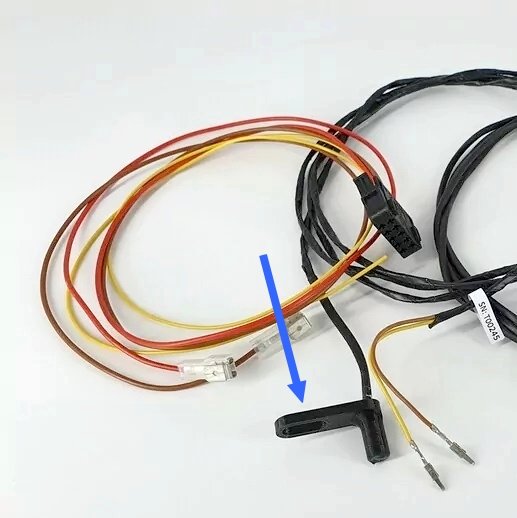

The TC-6 comes with it's own temperature sensor, since i already have 2 small digital gauges in the central console for in-out temperature i have the thought to make this as:
''incoming air sensor" inside the air filter box.
it's already has a hole and i can use it to put a small screw and attach it inside the (modified) air filter box.
One tiny hole, the cable comes out and i will ask from the electrician to make an extension of the existing cable and a small plug so if i had to remove and carry away the air filter box this wire won't be a restriction.
I can't think any other use of that sensor.

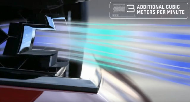

For educational purposes:
The Chevy Bowtie emblem on the “normal” 2014 Camaro is a large, textured gold form with a chrome trim piece running around the border. The Bowtie badge is designed with aerodynamics in mind, but having any solid object across the grille can affect air flow – even if only by a small amount. After all, that small amount could be the difference between winning a race and losing to a car with an engine running a little cooler late in the race. The Z/28’s Flowtie has only the chrome outer edge and the middle is left open to allow 3 addition cubic meters of air to enter the engine bay each minute. This allows the engine coolant and the engine oil to both run about 2 degrees (F) cooler and that translates to more durability and more power during the rigors of road racing.
https://www.torquenews.com/106/even-chevy-bowtie-grille-emblem-camaro-z28-high-performance
2014 Chevy Camaro Z/28 - Increasing Air Flow 'Flowtie' Badge
The results were a win. Affectionately referred to as the “Flowtie” by the engineering team, the hallowed out bowtie added just enough airflow to the engine to cool it by a staggering 2 degrees during track sessions. 2 degrees may not seem like a enough to justify the production of a new emblem but when you are developing the most track capable Camaro ever built everything counts and the modified bowtie earner its spot  on all Z28 Camaros.
https://www.newroads.ca/flowtie-chevy-camaro-flowtie/
