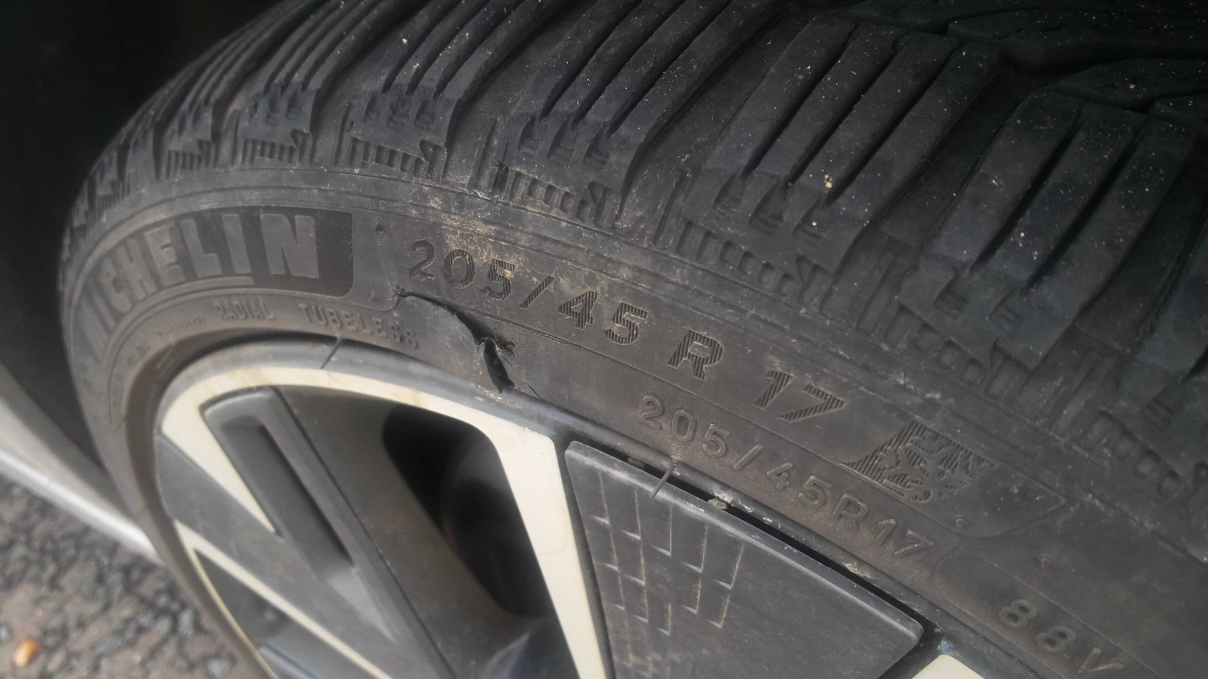

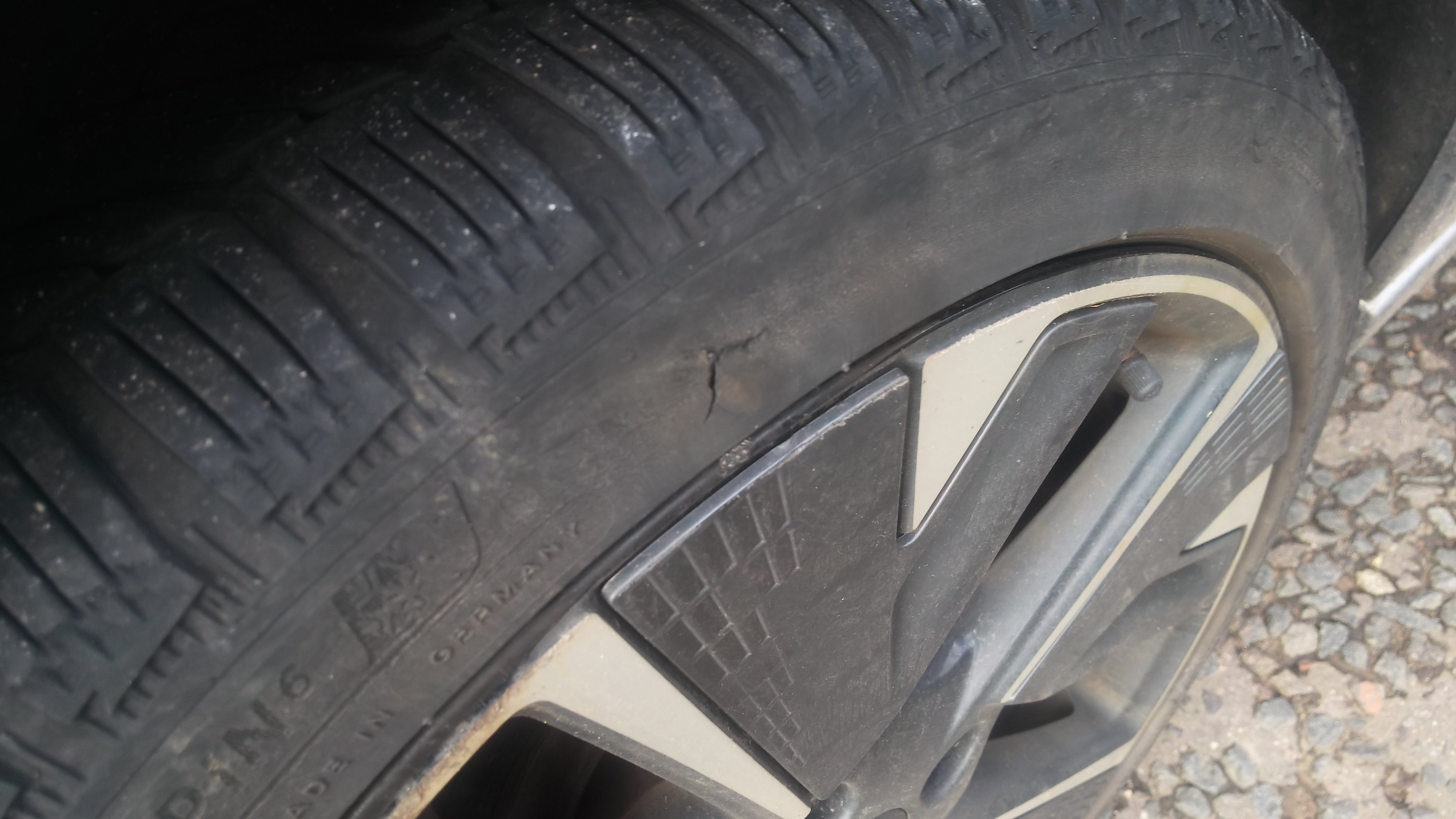

Alighting from the car the other day, the missus spotted this damage to the NS front tyre:

Annoyingly, this is the third time that we've had tyre sidewall damage on this car.  The previous two instances were full penetration punctures that flattened the tyre.  One was definitely my fault - I know how it happened, though I didn't realise it at the time. The other occurred while the missus was using the car, although she had no recollection of kerbing the tyre.  We also had to have a tyre replaced due to uneven wear (almost certainly due to the tracking having been knocked out of alignment due to another "wheel/obstacle interface incident" which neither of us recalls).
As far as I can see (but I'm very willing to be told otherwise) this one doesn't penetrate as far as the plies inside the sidewall, but I'm still concerned that it may be unsafe.  The tyre appears to be holding pressure just fine (for now) but I'd be interested in the informed views of the Briskoda motorati on the wisdom or otherwise of continuing to drive on it.
If this one needs replacing too, that'll make four tyres having had to be replaced before their time in six years 🙄
The lesson we need to learn, obviously, is to be more bl00dy careful in future...
Edited by ejstubbs
  • ejstubbs changed the title to Yeti tyre sidewall damage
Difficult to say really.
Your tyre might give another 15k miles before the end of its natural life, or you could have a blow-out tomorrow with untold consequences.
If it were me I'd probably get it replaced.
The tyre is needing replaced before hitting more ironworks on a road or what ever that does get hit.
I hate having to scrap a tyre / tyres, but then a blow out is worse expense or safety wise.

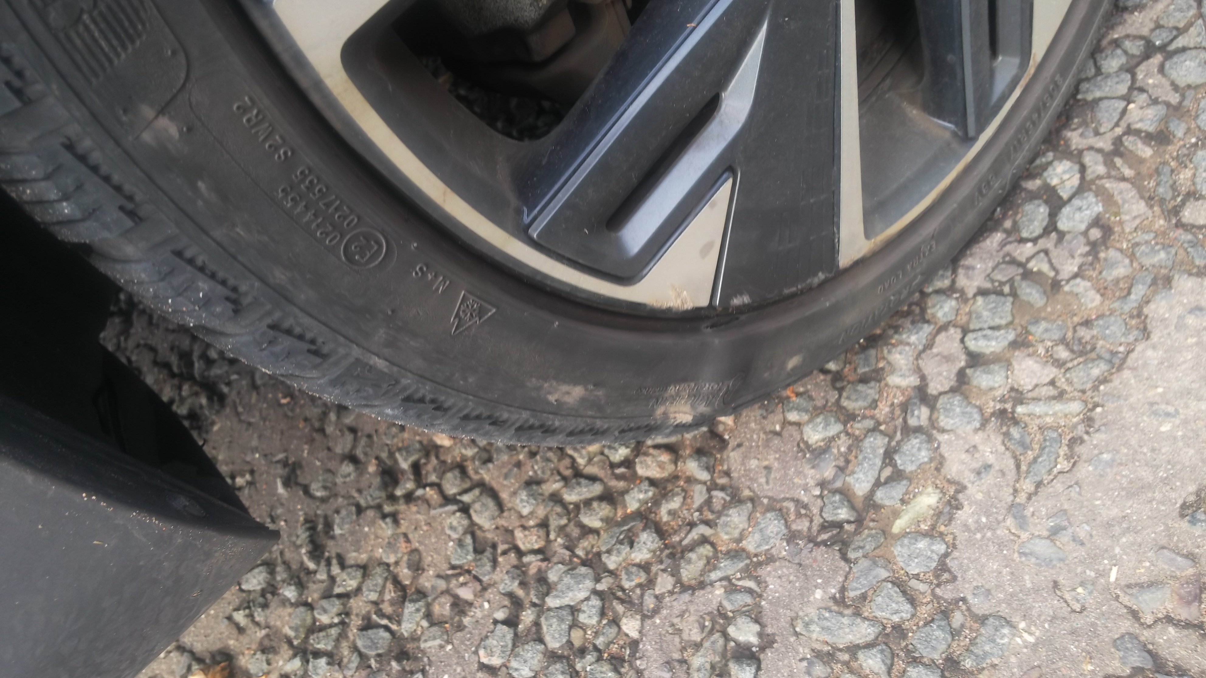

1971863221_DSCN2020.JPG.ee90ed8ae61d7ea0b4d09c801ca96b72(1).jpeg.75ed84eb97a775c4768b4c868a3dbf0b.jpeg
1089573104_DSCN2023.JPG.df9576e0cb8c2797b7d64bdf745d4f8a(1).jpeg.b0a2a5e7ef15d80e1470c534d84954d8.jpeg
211720605_DSCN2017.JPG.81487c82ac411093f0cbb0d483d453ca(1).jpeg.f620992a54b8071211b3e68af2134f86.jpeg

Definitely not worth the risk.

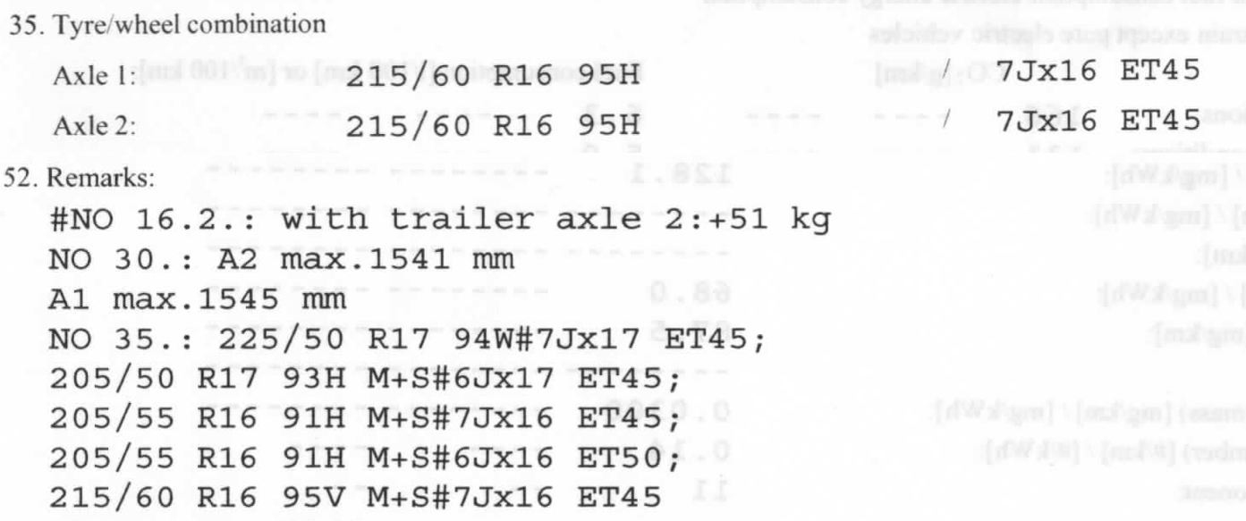

What tyre size is it?
It looks like it's the wrong tyre size for the Yeti, as it's showing a load index of only 91.
Tyre sizes on the Yeti, normally have a load index higher than 91.

Hmm, should be load index of 95

It's a 205/55 R16, which the EC Certificate of Conformity for my Yeti* says only needs a load index of 91:
* It actually bears the Yeti's VIN, it's a not a generic document.
Every major tyre centre I've checked offers the 255/50 R17 with load rating, which tallies with the above.  But as I say, I've got the 205/55 R16s which only need 91.  The only one requiring 95 is the 215/60 R16.

Every major tyre centre I've checked offers the 225/50 R17 with load rating, which tallies with the above.  But as I say, I've got the 205/55 R16s which only need 91.  The only one requiring 95 is the 215/60 R16.
You might want to check your speedometer reading, because the standard 215/60R16 tyre size has a 5.1% larger outside diameter than the smaller 205/55R16 tyre size.
At an indicated 50mph, you might find that the actual speed is somewhere between 45mph and 47.5mph, ie. 5% to 10% less than indicated, on the 205/55R16 tyre size.
