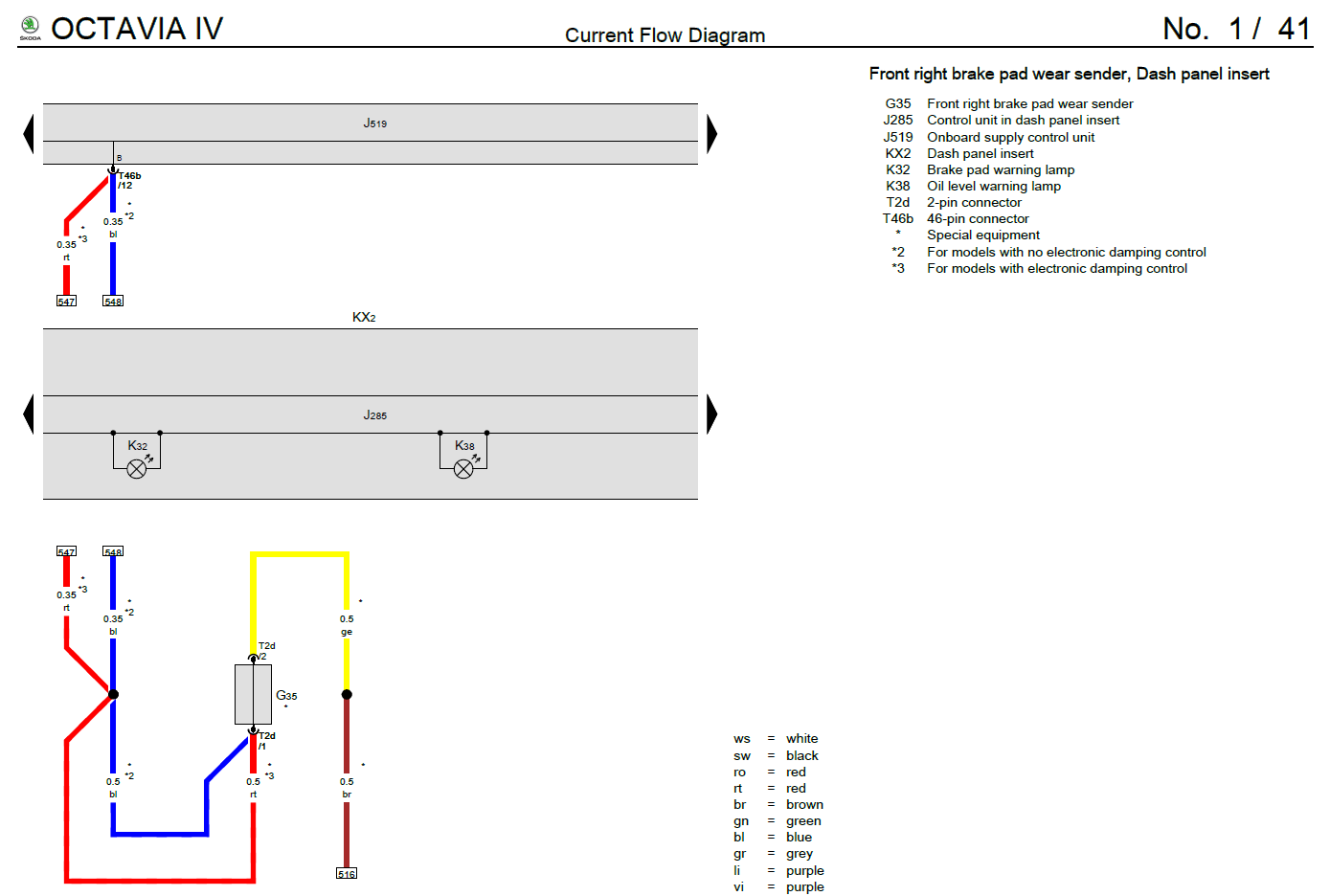

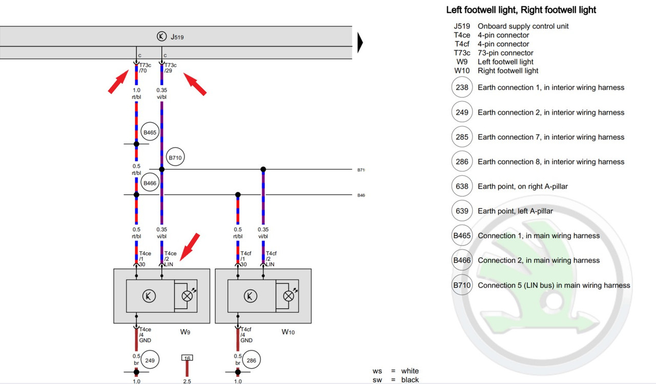

The schematic:

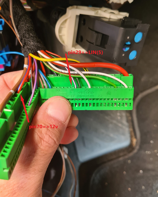

So there is a need for Pin 29 from the T73c connector and Pin70 from the same connector (T73c)

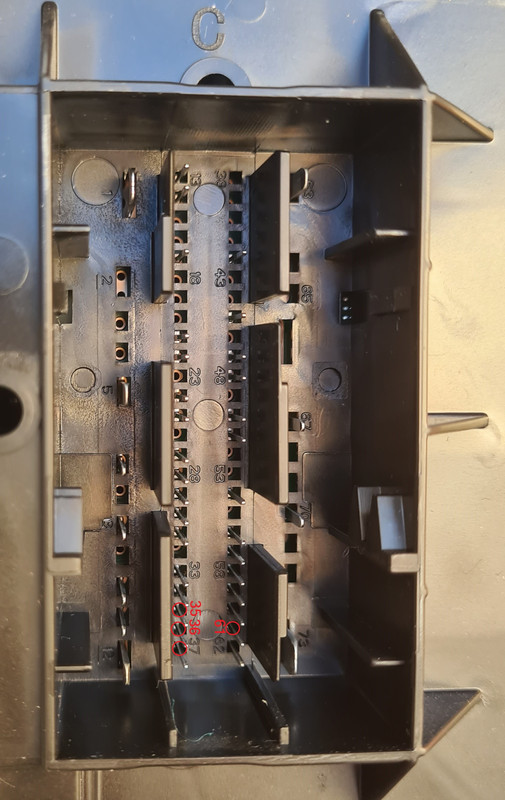

My BCM:

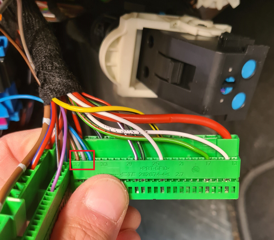

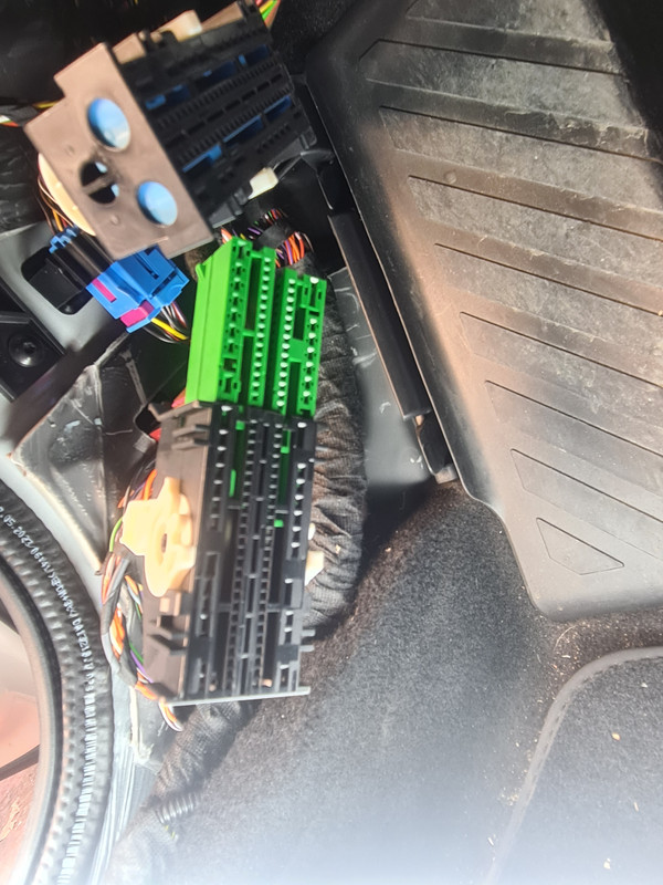

OK, pins are already exists, that's good (we have seen and read a lot about missing pins from various versions of BCMs)
The connector (from my car)
So far so good. Looks like I'll need to put a wire on pin 29 and  splice from pin 70 a wire for current.
And that's exactly where I'm at so far. I haven't made the connection, I'm making the wiring.

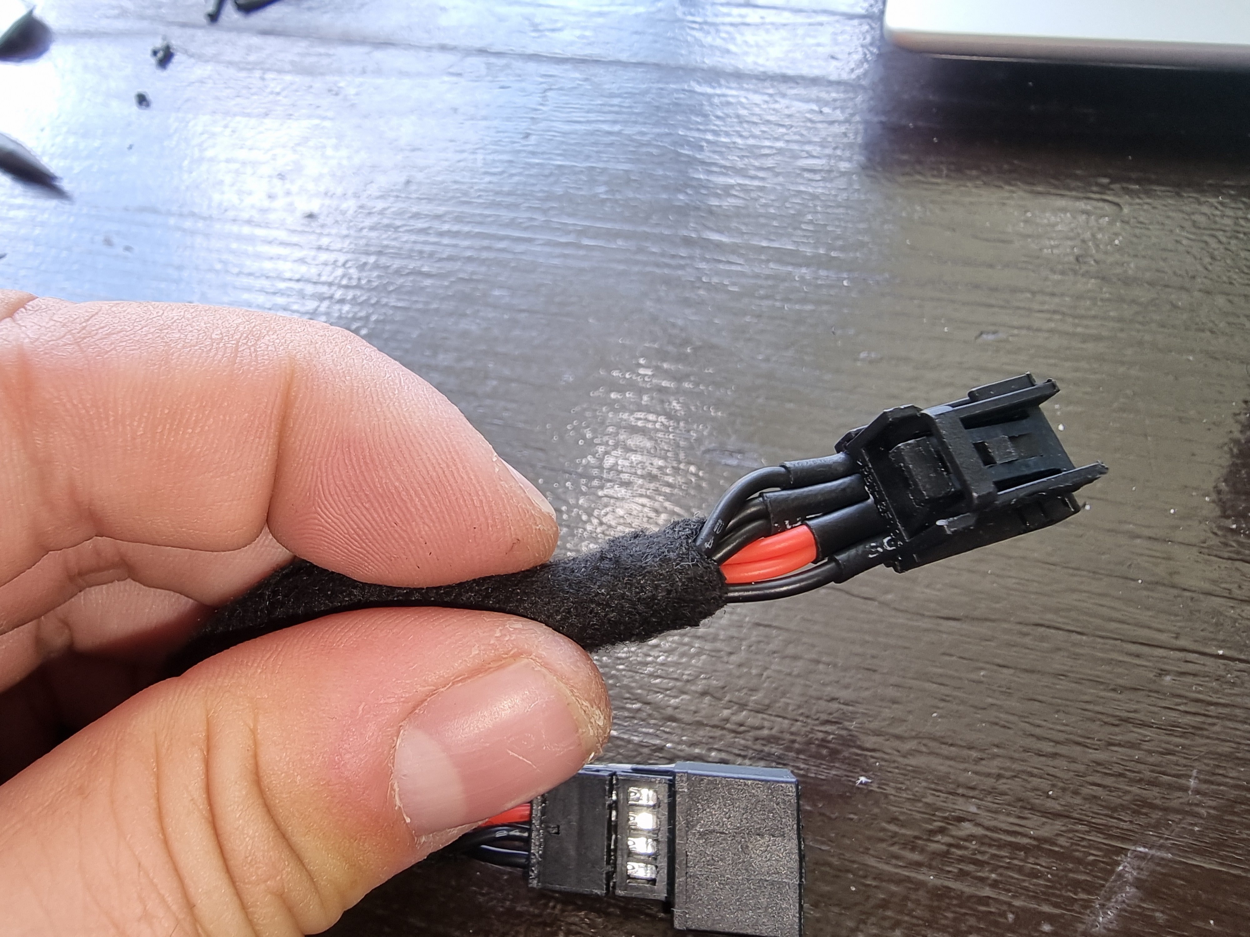

Hello @Giannis20,
Since you already did some research, you might know what pin types are used in BCM connectors? Can you please share this kind of details?

Hello @Giannis20,

MQS
This might help also.

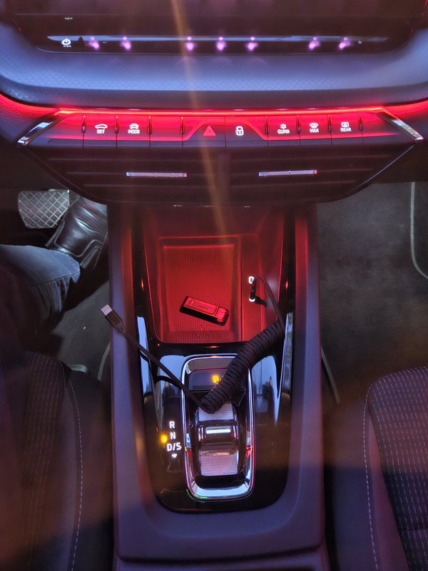

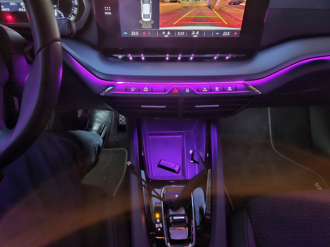

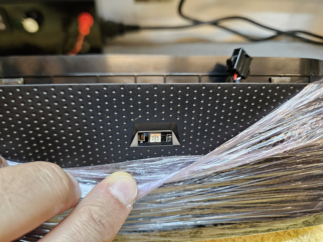

Small update

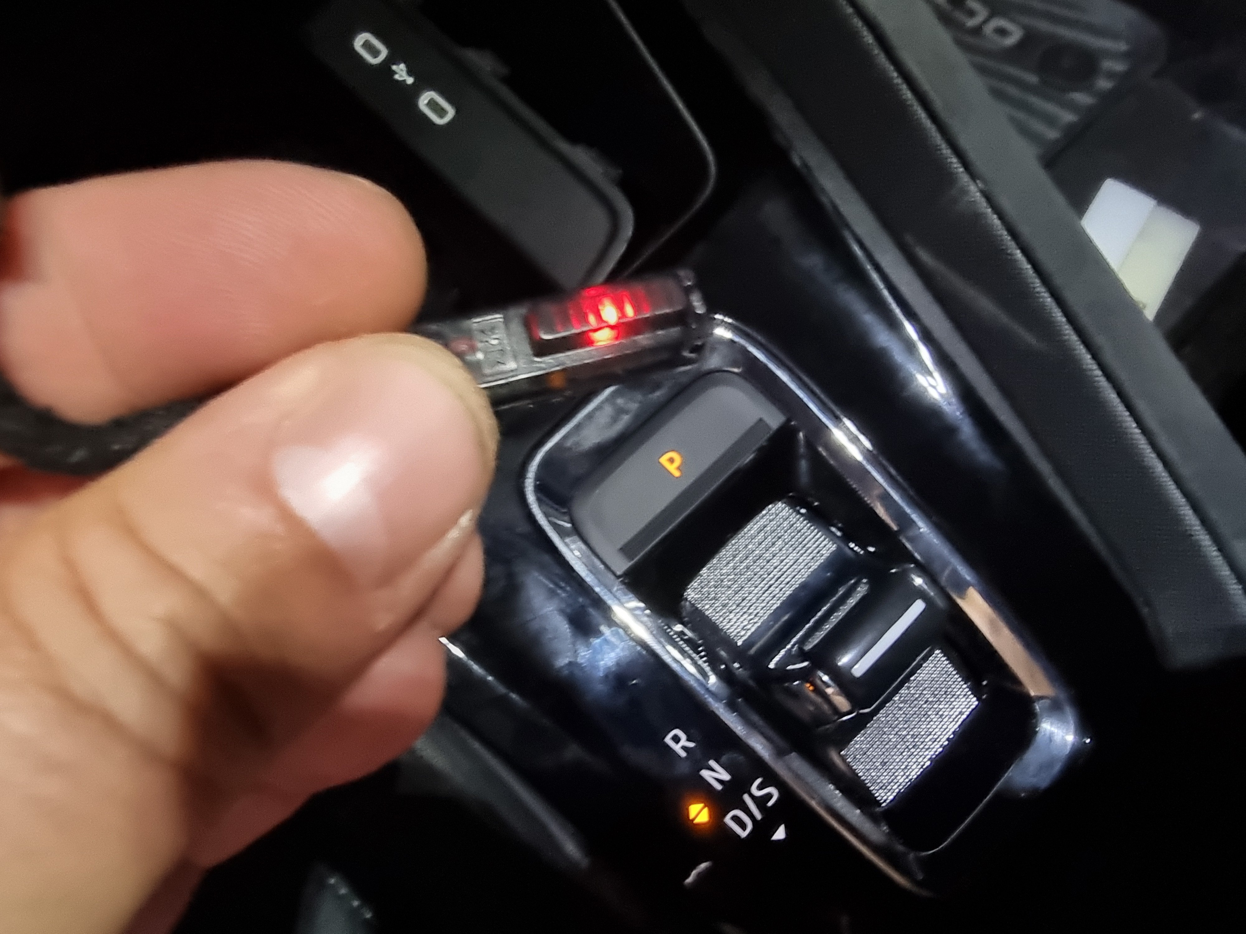

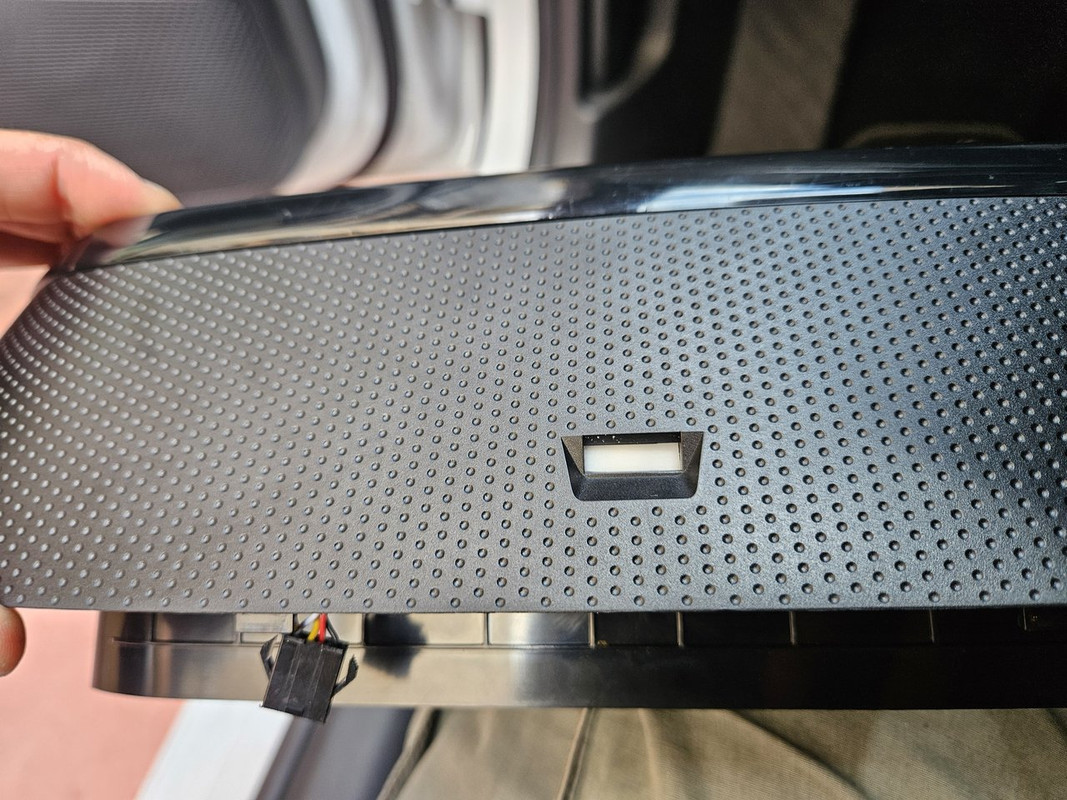

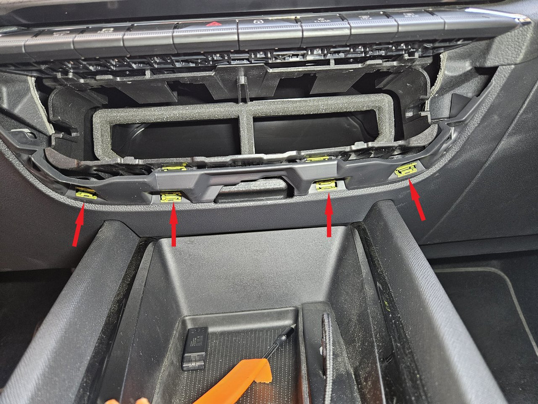

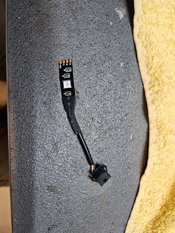

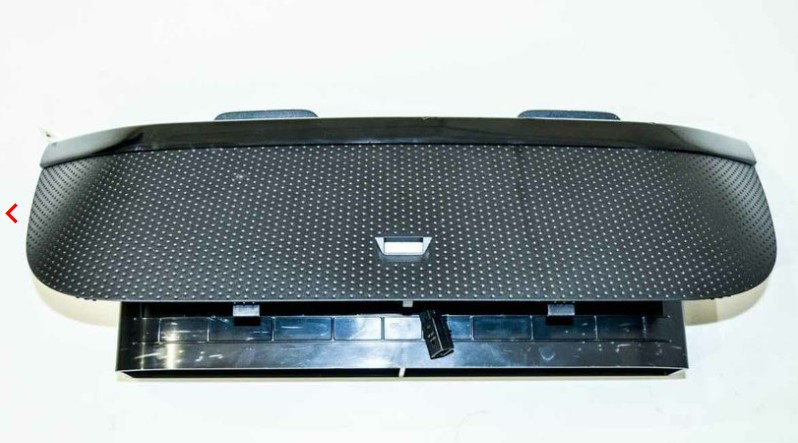

I saw on the internet that there is a small LED light on the center console.
This is it. As you can see there is a small opening and inside there is a LED.
Mine of cource didn't have that light, there was only the opening
So, i did a small LED RGB light from a LED stripe that i have.

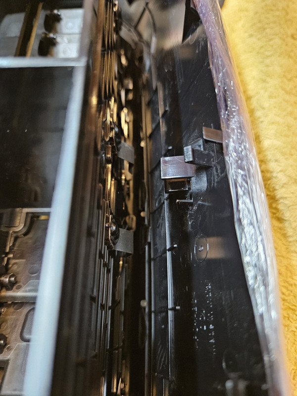

I removed the cental vents , it's just a snap, there's no screw or anything like that. There is a small thread about that
Anyway, i upload again my photo.

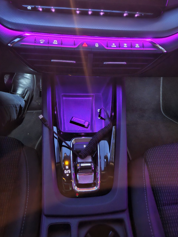

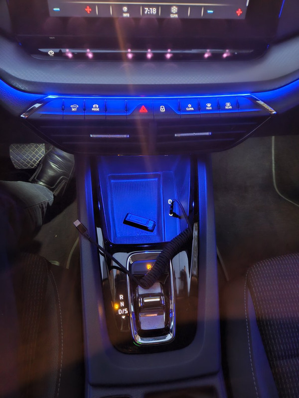

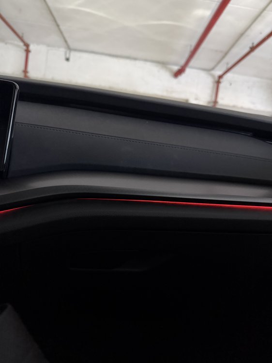

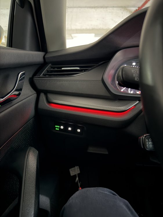

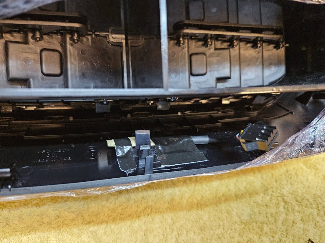

As I have described, I have already installed interior lighting in my own way. I also connected this LED there (it is 5V)
I did the wiring.
Αnd installed the LED whichever way I thought would be best.
And this was the result.
I didn't like the intensity of the light, so I decided to put a white acrylic piece in front of the LED.
This is the result
Μuch better, and the appearance is like the factory one
Some photos from the lighting, in the evening.
In reality, it is lower in intensity than what is shown in the photos. I am extremely happy with this result as well.

amazing, I noticed the golf had lightning in this area. My VRS doesn’t, though it has the other ambient lights.
do any Octavias have this as standard?
Any interest in making some more up the same as yours to sell? If it’s plug and play, it might be easy to install.

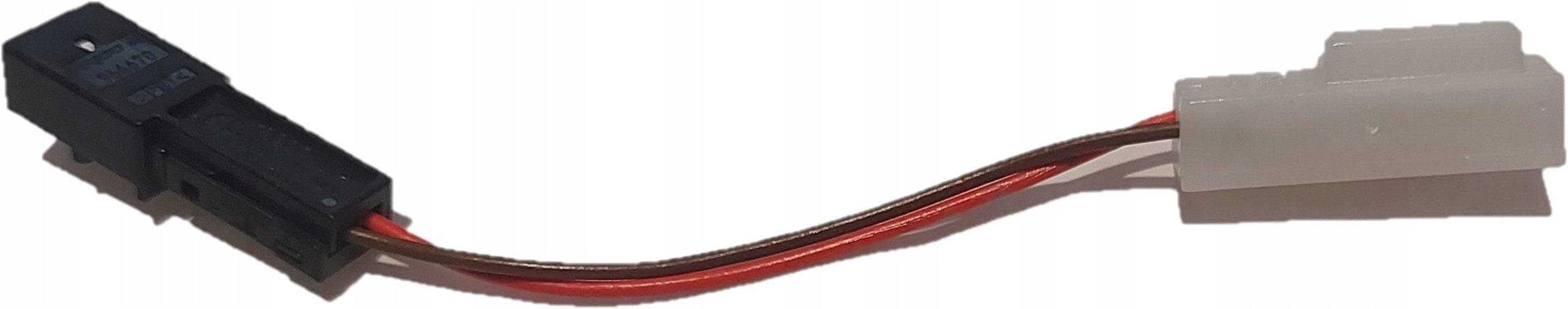

Same here, my vRS has the hole but no led in it.  I wonder if there is a Skoda or VW part number for the led that fits….
Actually there is an original part for this LED light.
The code is: 3v0919173a
But i don't think it is plug and play. This light has only 2 wires. so it is only emites one color (possible white)
Edited by Giannis20

This was the only point I didn't explain in my presentation. And that's because I thought the way I did it was particularly complicated.

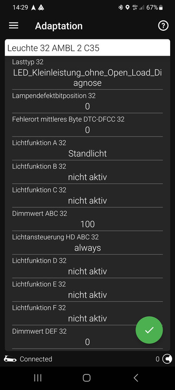

However, since many people have asked me through messages, here's what I did very briefly.
I connected a wire to the 3rd connector of the comfort control module (BCM) at Pin 35. This is the + for the lighting system module.
Then i program that pin to operate as parking light (standlicht in Deutch)
This way it provides power whenever the lights come on and I get exactly the result I want.

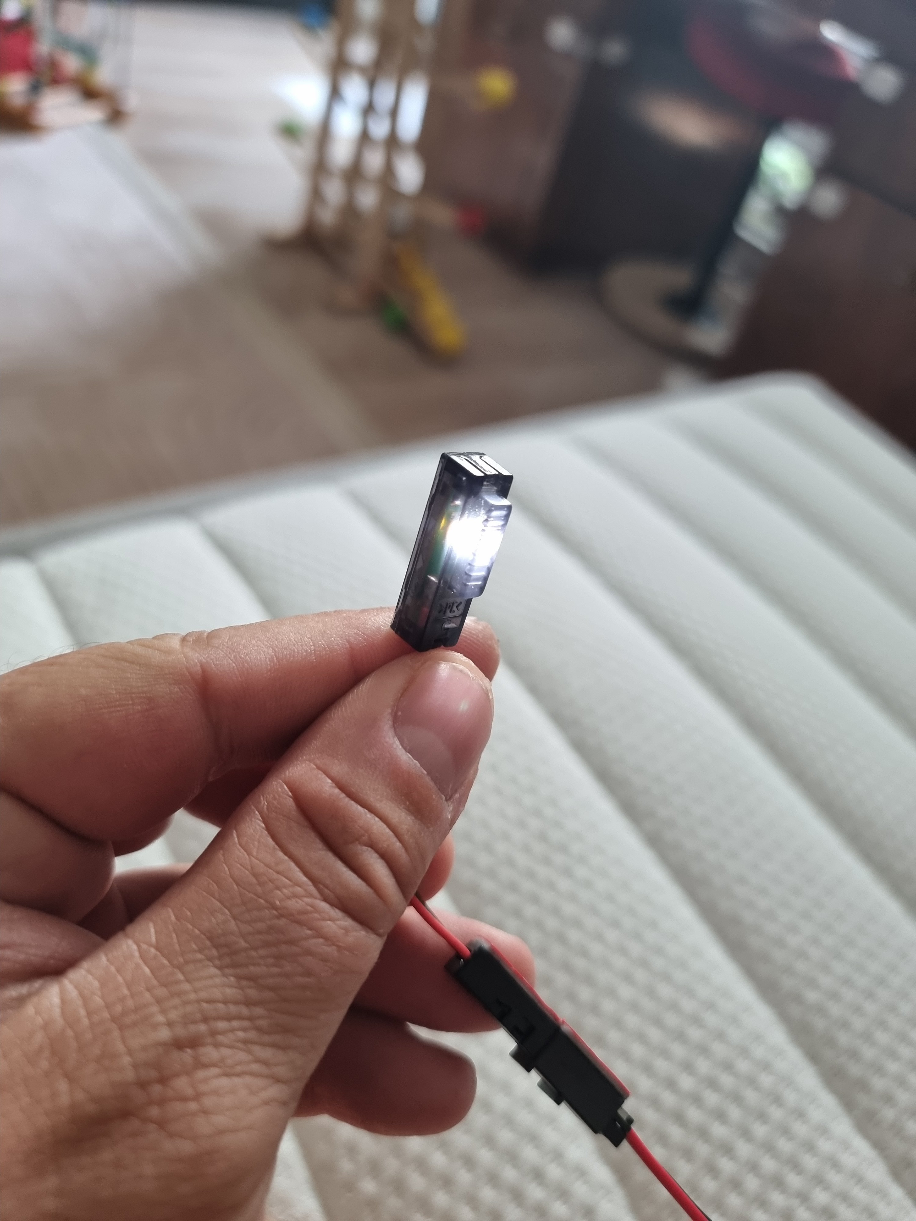

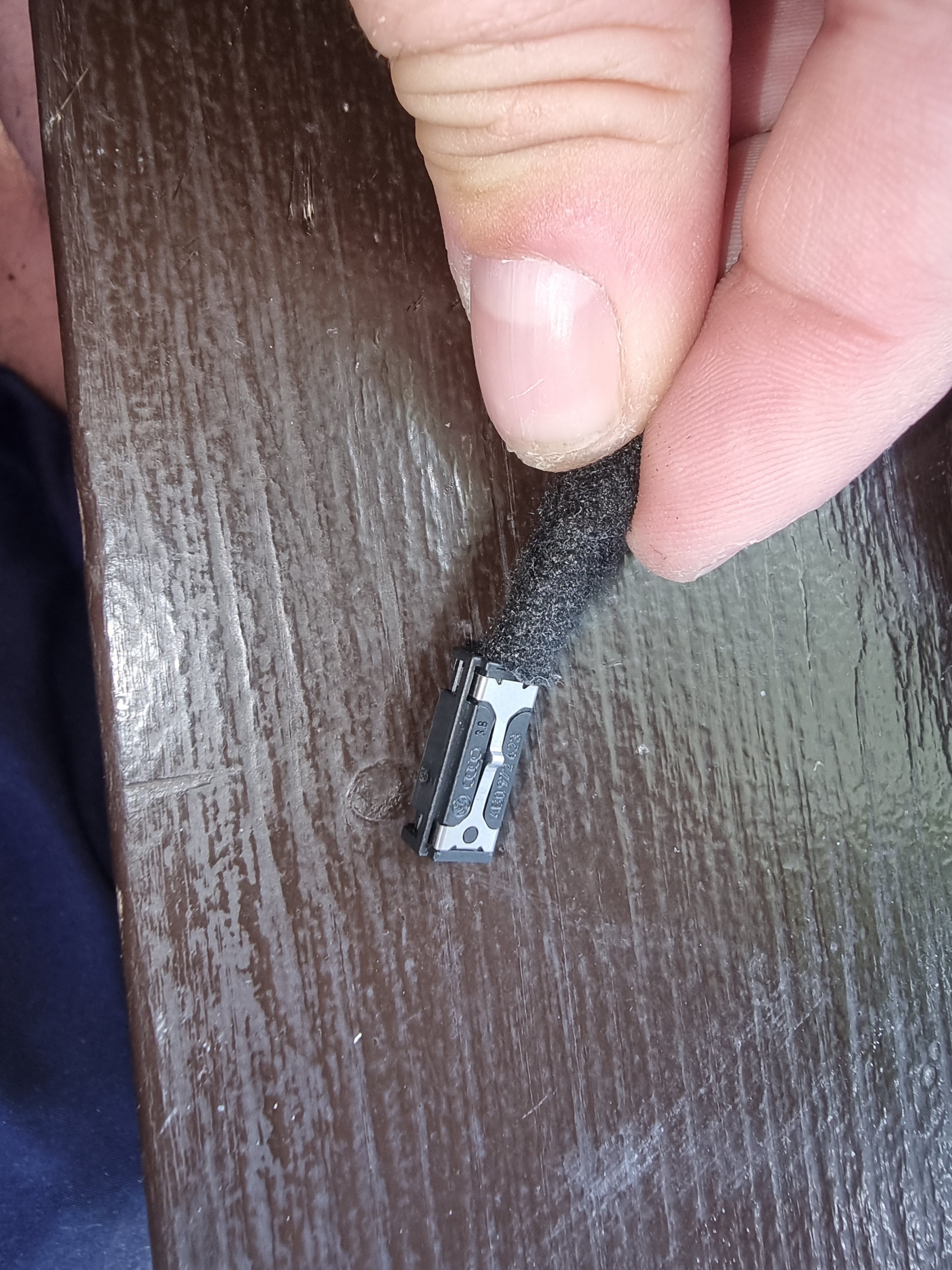

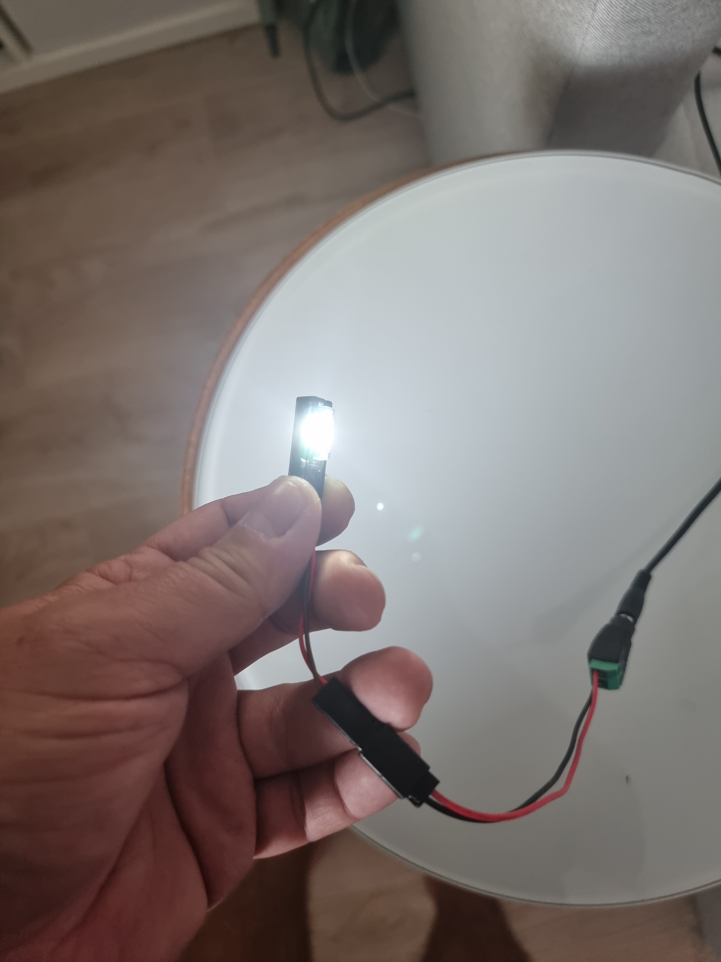

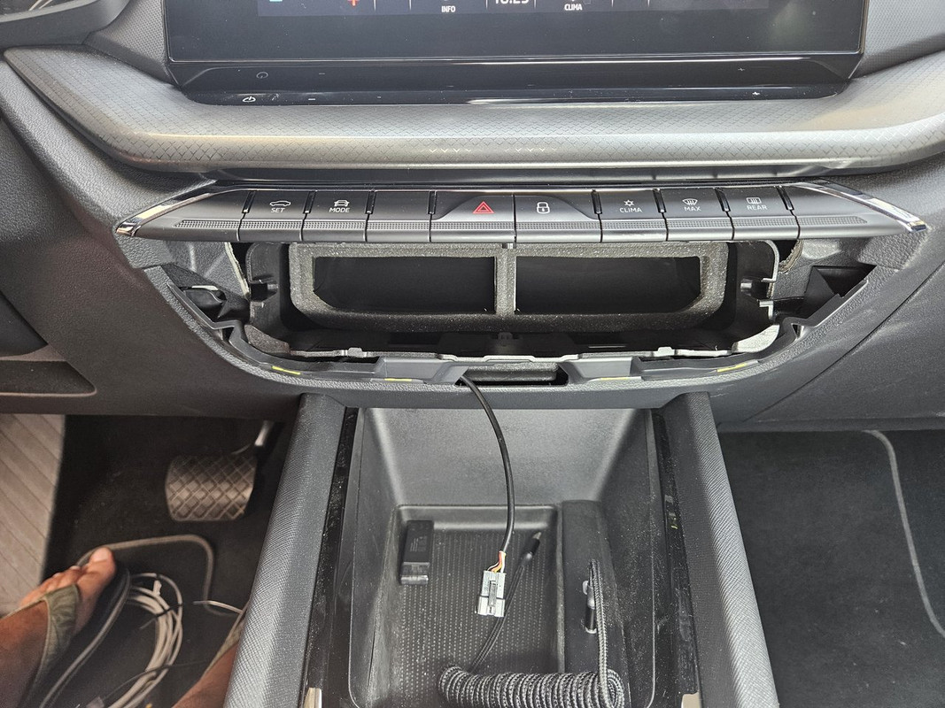

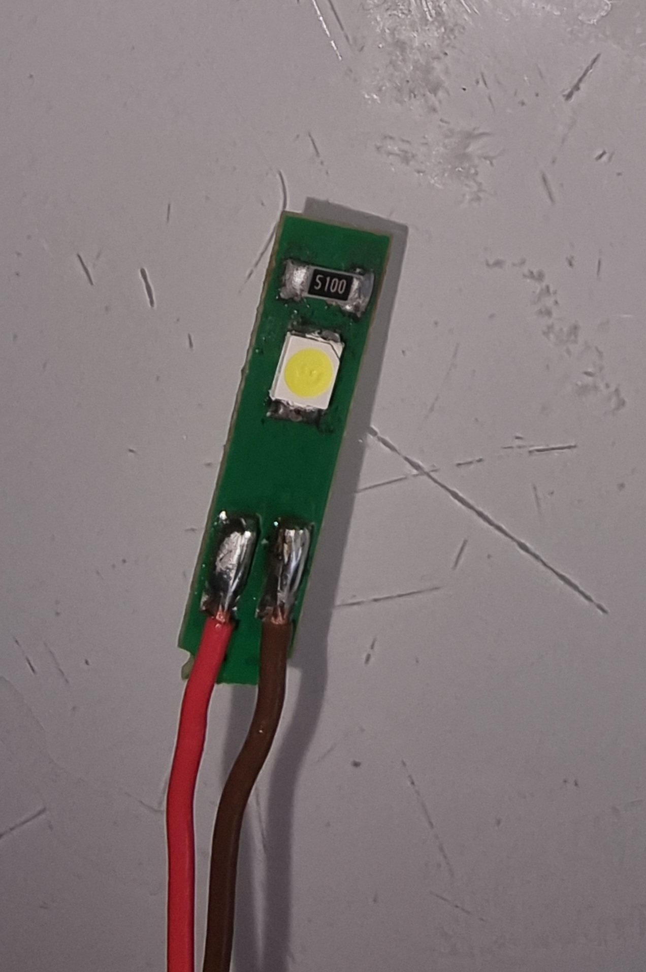

I am trying to do the LED light at the central vent OEM style.. I ordered the unit for 20€ and will make a harness. Just thinking where to put it on.. maybe glove box light, but i have to investigate how the switch works..
@Giannis20 Do you know how the glovebox lightening works? is there a switch?
I bought the original 5E0919173A LED light for 20€.. it fits perfectly in the hole.. now i am thinking where i can put the LED on.. maybe glove box light?
You have an idea?
Thanks!

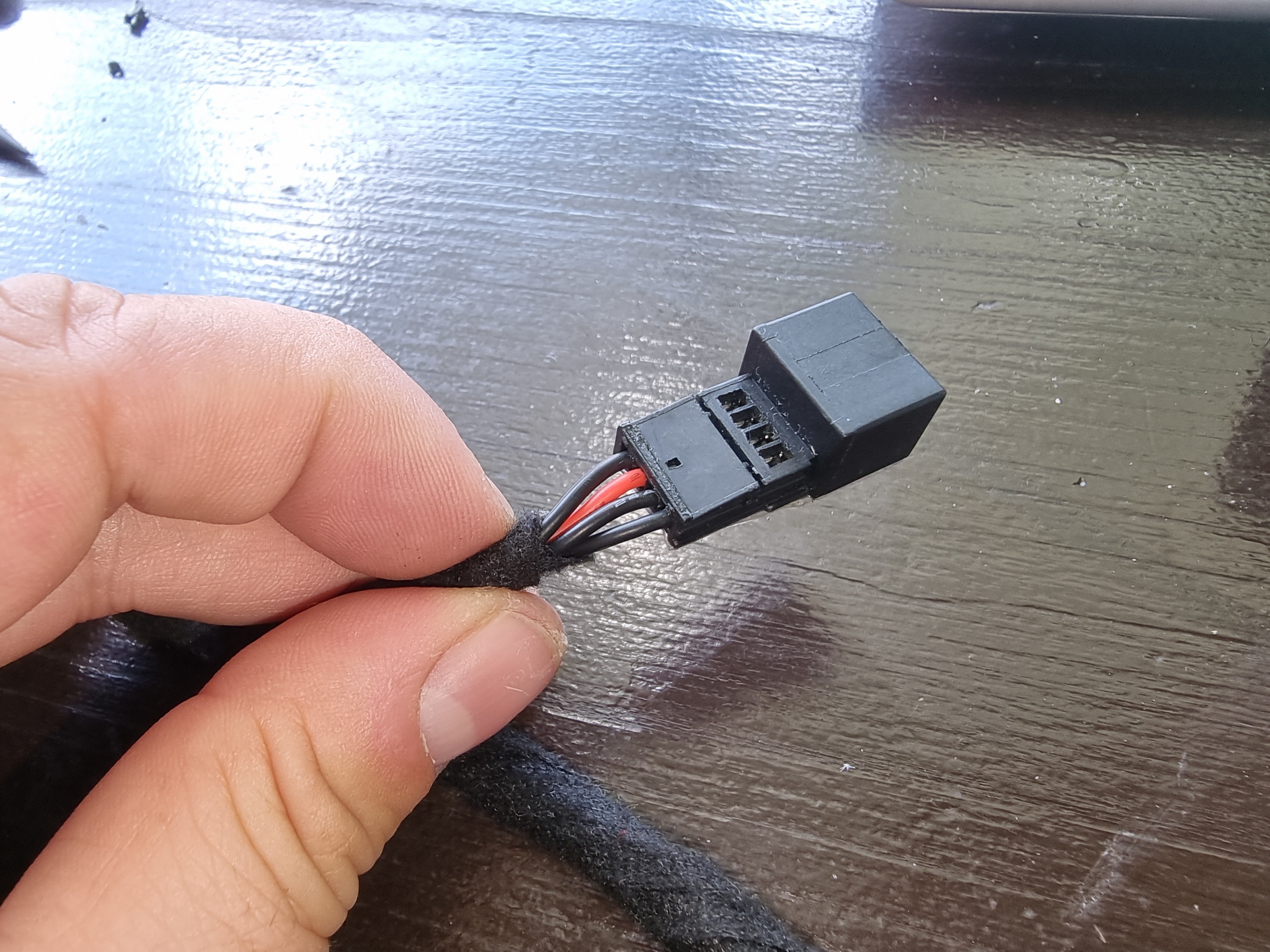

I made an adaper .. catching the light from the USB C Supply :) Didnt test it yet in the car but i am sure it will work. I will post pictures after testing.
Edited by Lukas_2611

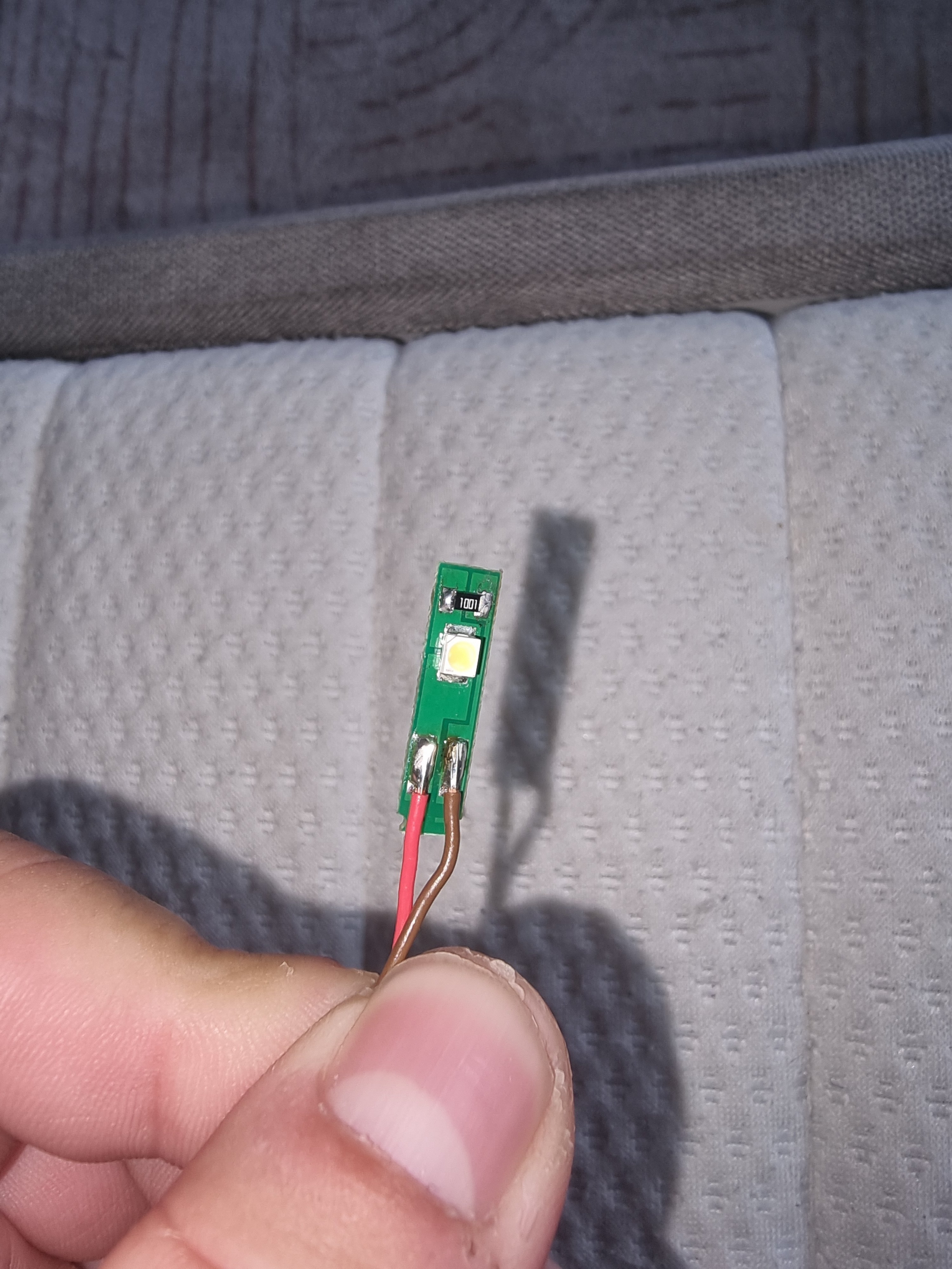

So Ive made an adapter taking it from the usb c lightening.. it is working perfectly.. but.. two different OEM Version came in red..
The red light isnt really visible.. and i want it in white.. looking for a solution..
So.. almost done.. switching polarisation made the LED glow white..
To make the original LED brighter i switched the resistor from 8000 Ohm to 1000 Ohm.. now its nice and bright .

The whole unit costs 12 Euros at my local skoda dealer..
A lower resistor is just letting more through to the LED and it will glow brighter..
The original light was way too low for me so .. i will leave it this way..

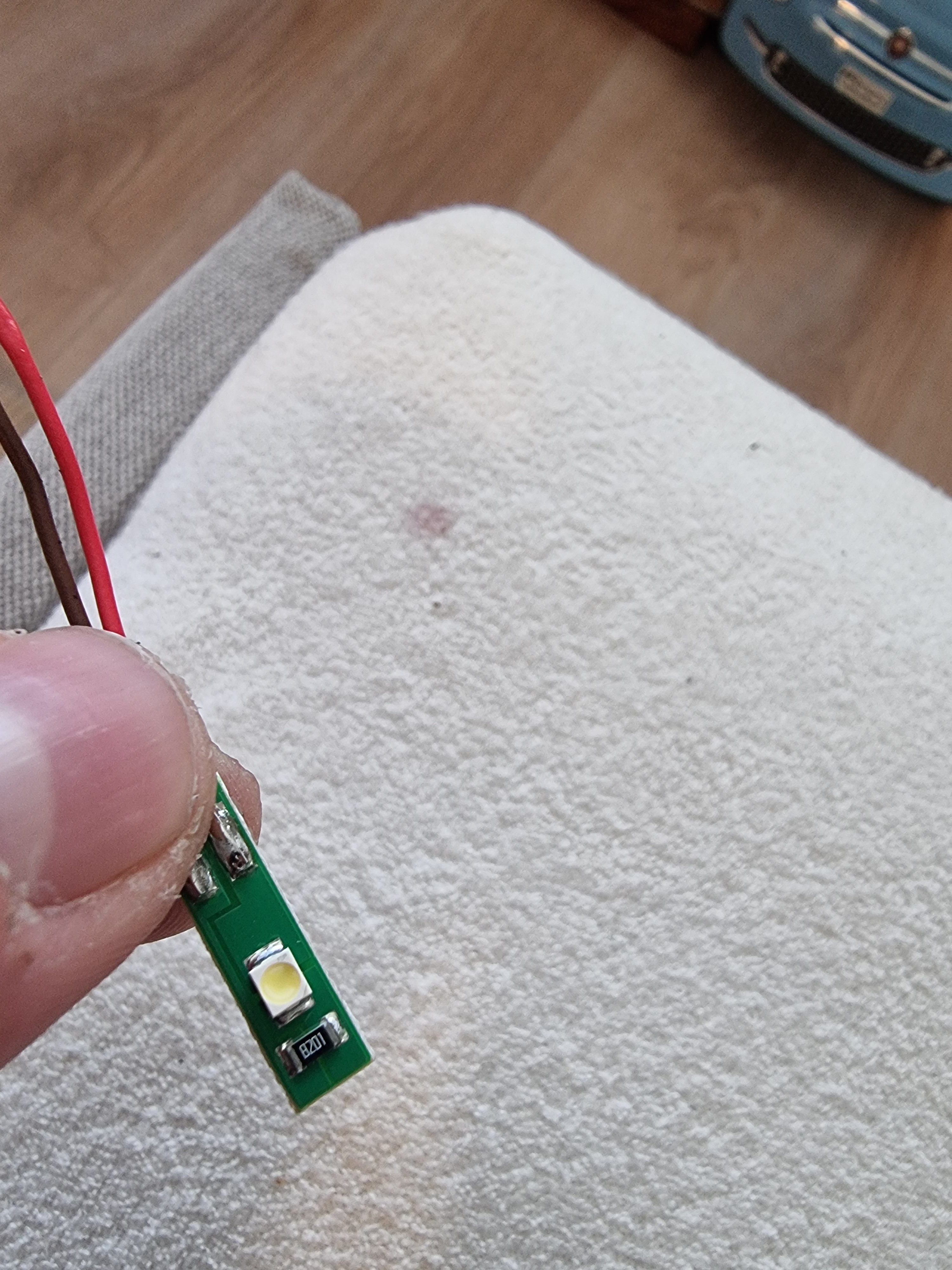

On 20/08/2025 at 19:55, Warrior193 said:
Will that significantly affect the LED life?
So to avoid damage to the original LED i changed to a brighter LED with the correct resistor ... tests look amazing..
First Pic original Skoda.. second with new LED..
