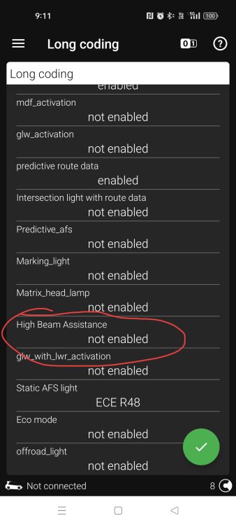

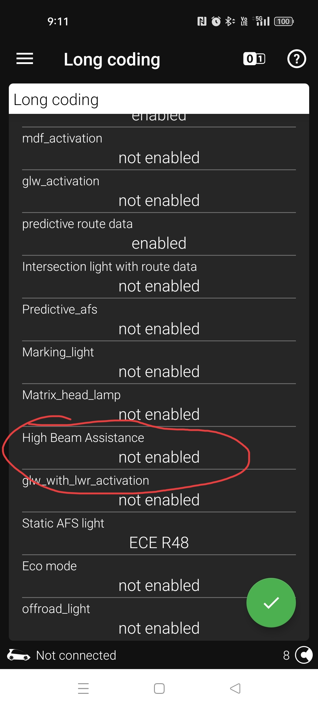

Hey @langers2k, why my High Beam Assistance is showing not enabled.
I have enabled it through app in obdeleven. It is always activated unless someone put the headlight in off position. Then i have to re-enable it. Can I toggle this option to enable? What effect will it hIMG_20230905_211242.thumb.jpg.8668ff8755d99d07bcaa83f8ba1690a9.jpgave, just wondering if you know about it.
Edited by automass

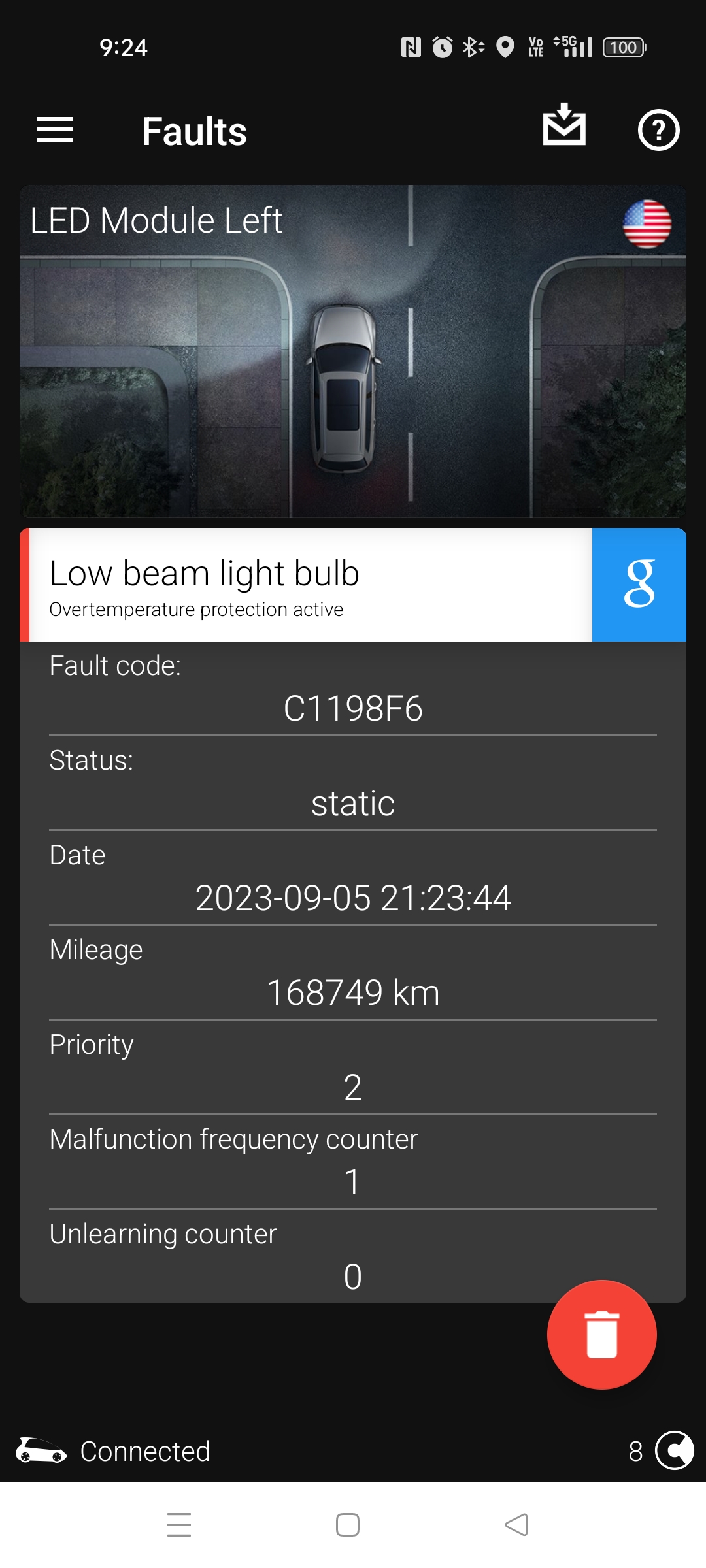

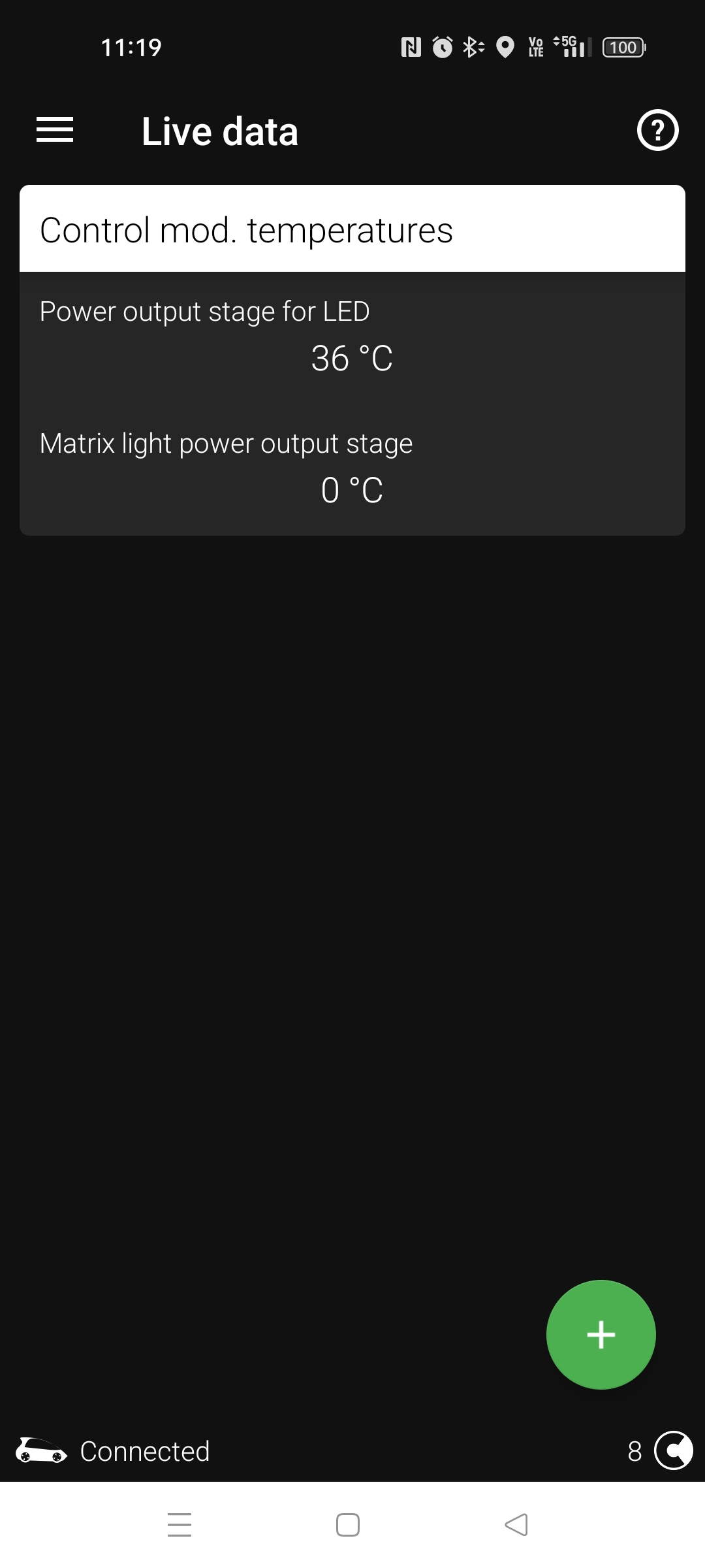

N.B: why am i getting two faults in D6 and D7 regarding high temperature. They can not be even deleted.
Because it's not enabled. Nor was it in the original lcode you posted in this thread.
Assuming it's correctly coded in the other modules, try setting 4B to:
000000070100046600003D41010000000000000000000000000000000000
The change is highlighted and is in byte 11 if it helps.
No idea. As it can't be deleted that would suggest some kind of fault is still present. Nothing in 4B should cause the overheat error although it's possible the changes we've made have stopped the errors being hidden. This is all somewhat of a guessing game given I have no idea what has been to this car previously to get it in this state.

What is Adaption map? Where can i find 4b?

OBDeleven calls them backups and you need to select adaptions then save. Some how it is then possible to get that info out of OBDeleven as others have previously.
4B is the multifunction module you've been recoding...

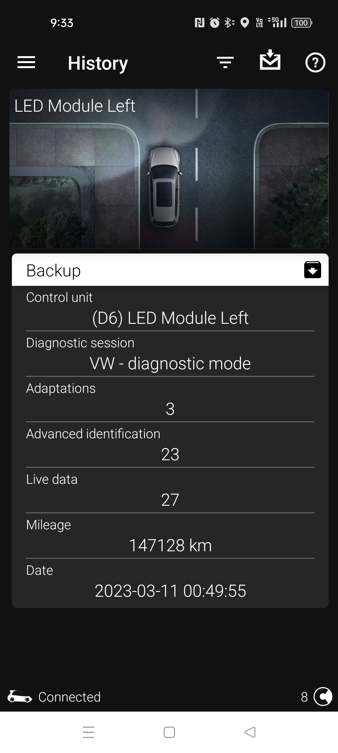

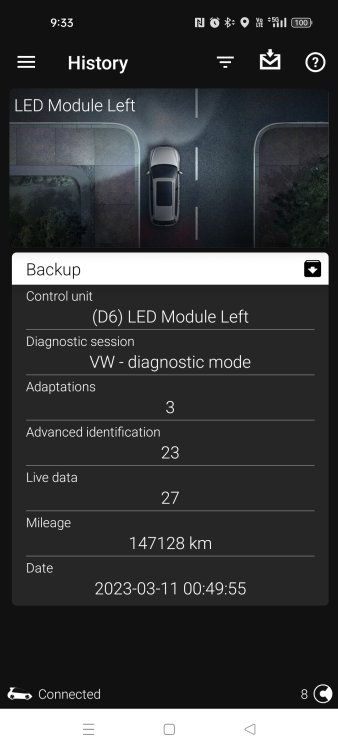

I can see module 4b and 19 but exactly what info do you need. I did try to perform back up and saw it was done 100% but it didn't give me any option to open up anything.
N.B: if i go history I can see all the changements which were made.
Edited by automass
Fault is deletable. I have managed to delete and they are not appearing any more.
