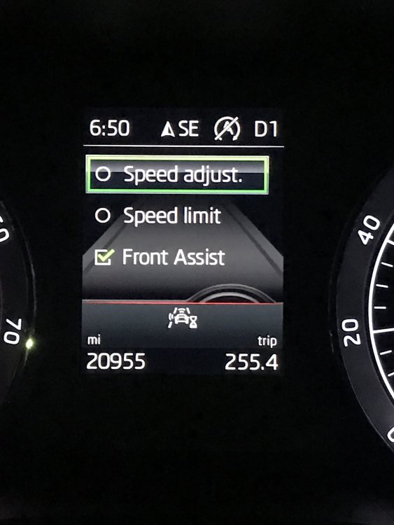

Does a 2020 Karoq SE Drive have Lane assist? I can’t find any reference in the assist menu. All I can find is a screen including Front assist. But no Lane assist.
And, there is no lane assistance. I can cross lanes at will.

 From pic I attached you'll see the car has Front Assist and it's activated. Does that mean it has a camera?
Going back to question in first post -  Does anyone know: 'Does/Should an October 2020 Karoq 150 SE Drive have Lane assist?'

If you have a thin black plastic cover between the headliner and rear view mirror, you only have rain and light sensor. If you have a wide plastic cover(10cm) then you should have a camera, therefore you can get lane assist.
It is not a standard feature, it comes as an extra. Front assist uses the front radar built into the grille of the car.

Lane Assist.
MrSecretPotato: 'If you have a thin black plastic cover between the headliner and rear view mirror, you only have rain and light sensor. If you have a wide plastic cover(10cm) then you should have a camera, therefore you can get lane assist.'
Car has thin film. So, no camera, therefore no Lane assist!!
