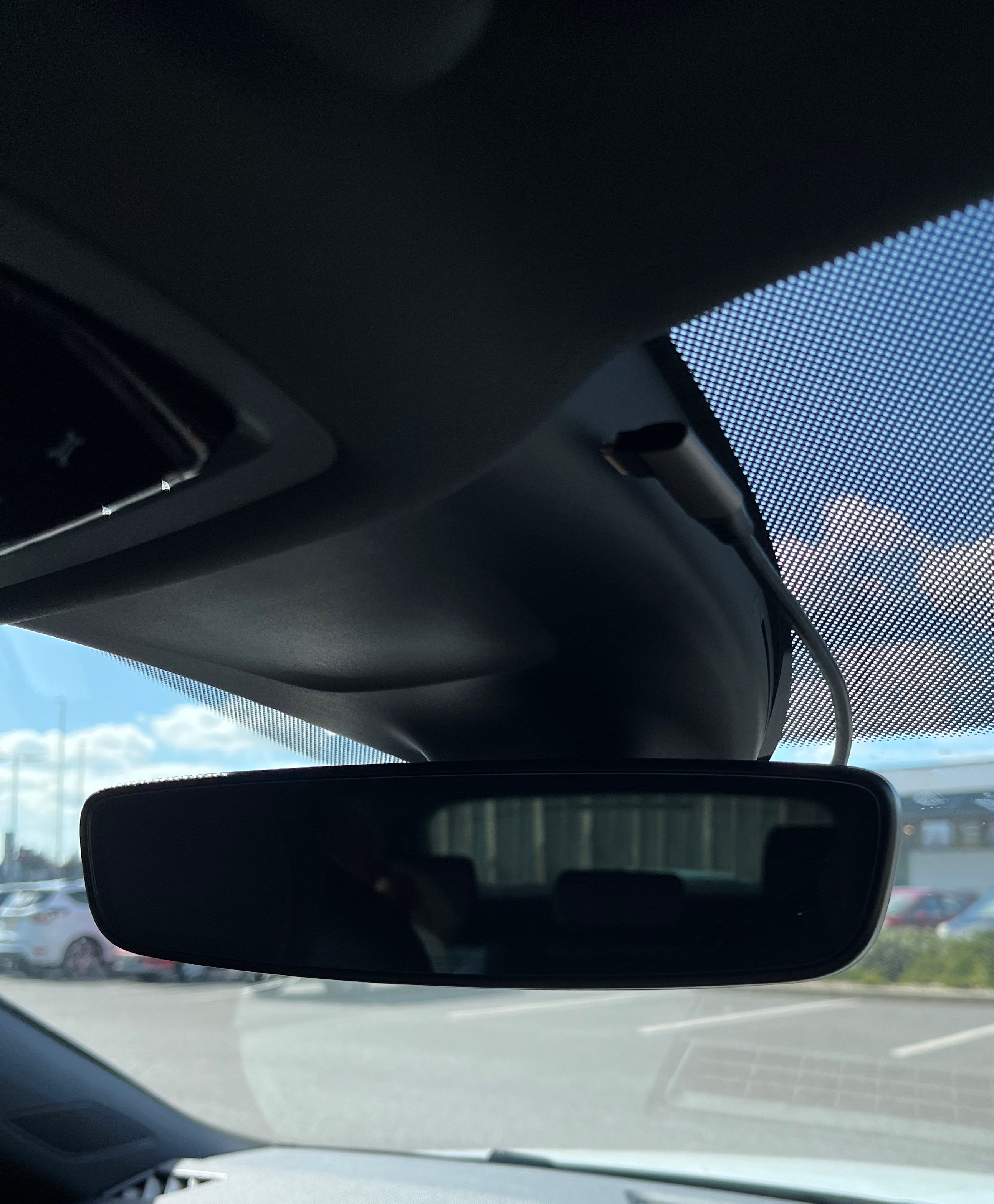

I have a Garmin DC2 connected to the power socket with a 30cm USB C cable that has a 90 degree elbow.
The cable is tucked into the small gap between the windscreen and the mirror / camera housing so it is not visible.  The dashcam is then fitted on the passenger side and is hidden from the driver by the mirror.
The socket is powered off when the car is switched off.

Here is a picture of mine:
I like this. I thought mine was pretty neat but this is better! I had a look at the Amazon page but it appears to be out of stock at the moment. I'll get one if it becomes available again. The separate elbow connector I needed with mine (on the Garmin Mini 2) has always niggled me a bit, makes it look slightly clumsy.

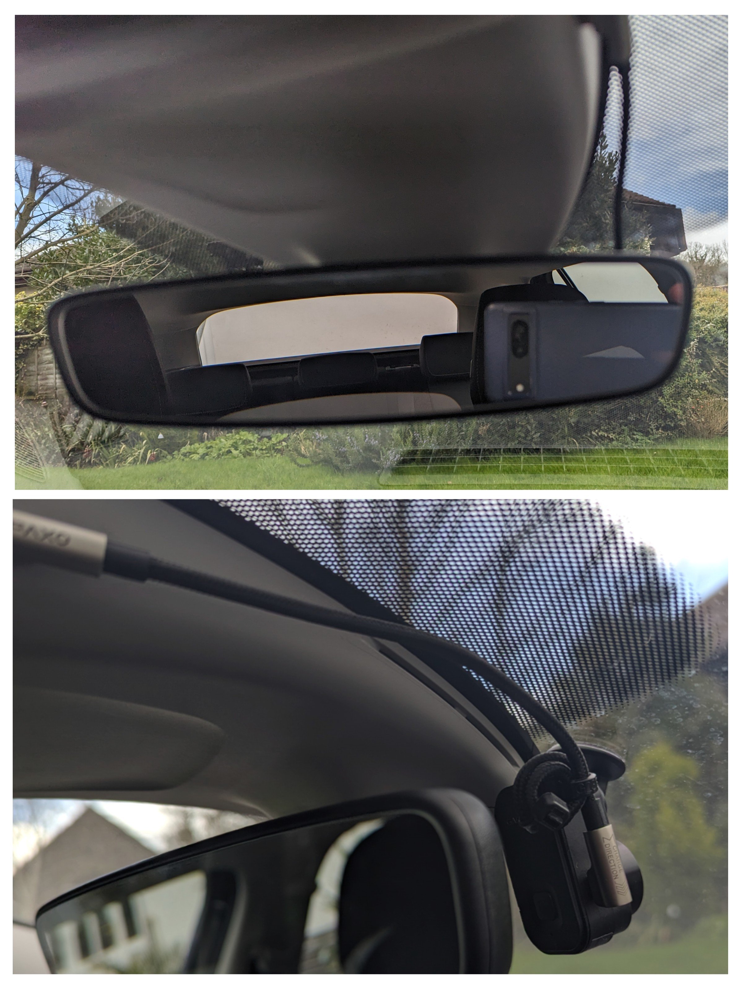

I spent way too long trying to find a lead I liked more than the one recommended by @RobL50, but couldn't find one...
Initially I tried the left handed plug version hoping it would reach all the way around to my Garmin mini 2 mounted on the passenger side, but it's not long enough for the camera to be concealed behind the mirror unfortunately.
So I ended up with the right handed plug version with camera on the driver's side. I used a couple of small cable ties to create a coil to take a little length out of the cable at the camera end. Nice and neat I think.20240328_152452-COLLAGE.thumb.jpg.d05333c168a7ed6b87c277e1c1ed4eb6.jpg

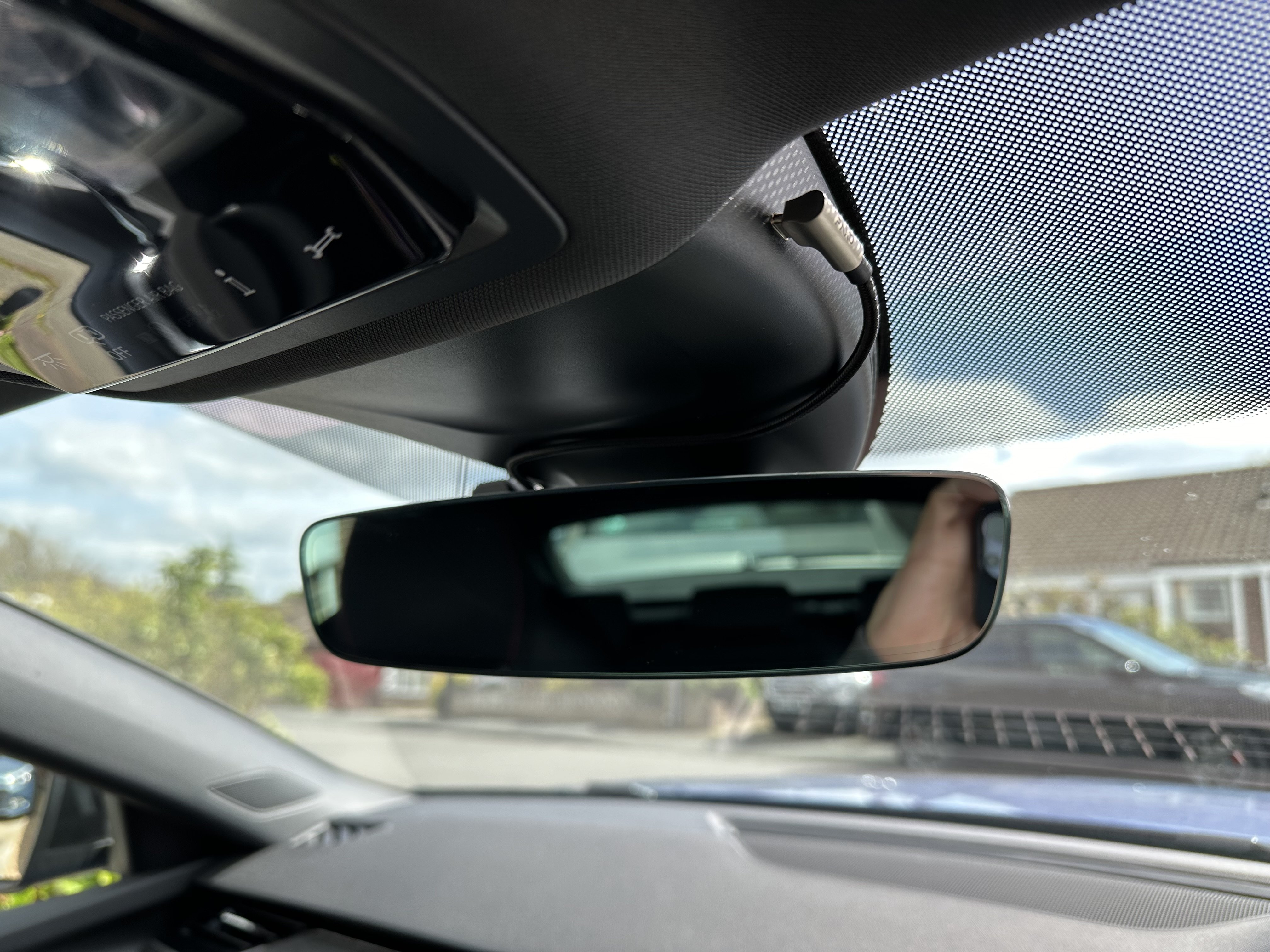

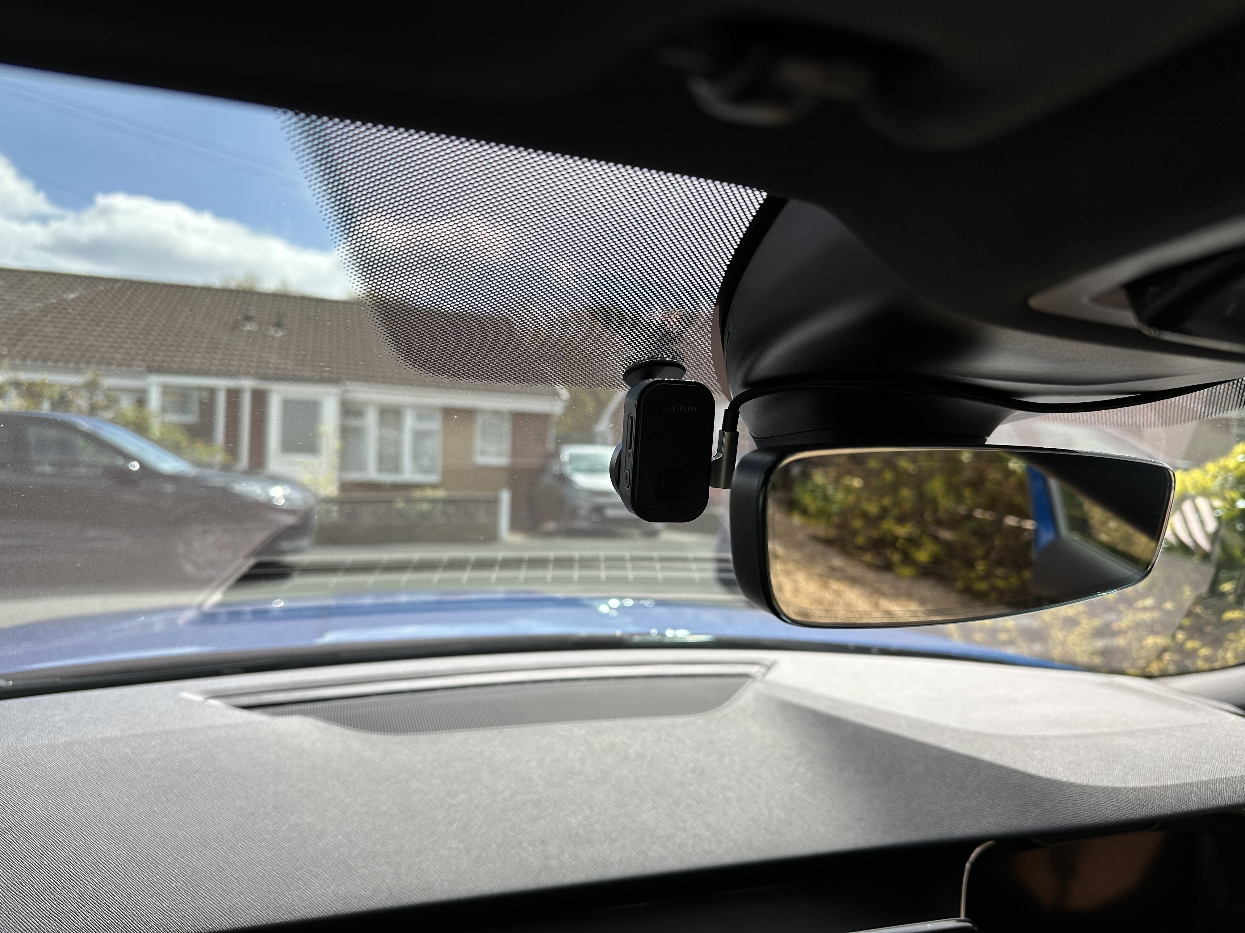

All now sorted. My original cable was 25cm and just too short as previously mentioned.
One of the alternatives I have had delivered today was a 30cm lead and this is just the perfect length to reach over to the camera on the passenger side of the mirror.
