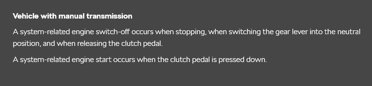

Is the feature not in the software because some cars in the range have stop/start, the engine could be stopped but ignition still on, leaving a danger that the car will re-start when no-one is there.
With stop/start, removing your foot from the brake pedal restarts the engine.  Also, the engine appears to restart if the volts on the car drop, so opening the driver door and so activating the interior lights would possibly set off the bongs.

3 hours ago, Stonekeeper said:
1110650279_Screenshot2024-01-31at18-13-23Skoda.png.7bd0163fff54e6b951f2edb28e65cb07.png
