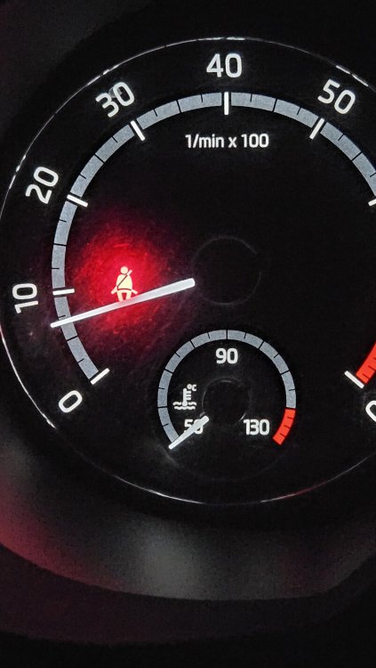

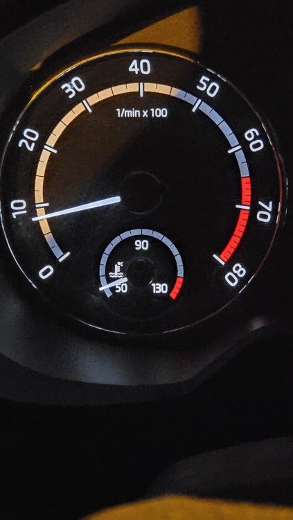

Hi,
my Octavia MK3, DSG has a idle RPM at 1000.
How much does you Octavias idle when engine is cold and warm?
Best Regards

I live in Sweden. At the moment + 5 celcius outside. I have a DSG box. The fan in ON when starting the vehicle, first its revving higher and then decreases to exakt 1000 RPM.
If the fan is OFF it drops below 1000RPM (much more harmonic)
I still feel its to high, beacuse the usage of AC is fundamental in the idle equation.
I had a Golf 7.5 1.5TSI, even with the fan ON the RPM was below 1000RPM.
The reason is that I feel like the engine is brumming a little to much. Campared to my Golf 7.5, my engine noise is high when sittning inside the vehicle.

Yes. 22.5 degrees. When I shut down the fan, the RPM does not drop below 1000RPM. I give it a veeeery smal rev, then it drops below 1000RPM.

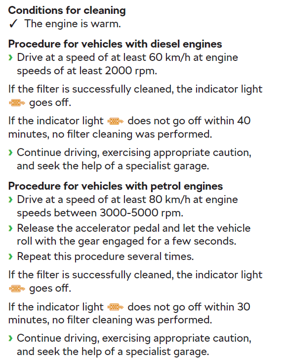

OT, but just incase a TSI with a GPF ever does need to get cleaned up with a Regen and they can do, remember and Read the Owners Manual.
They are different from a TDI and a DPF, but there is still a procedure.

When the AC is off, the RPM drops below 1000RPM. Maybe around 850-900 RPM
