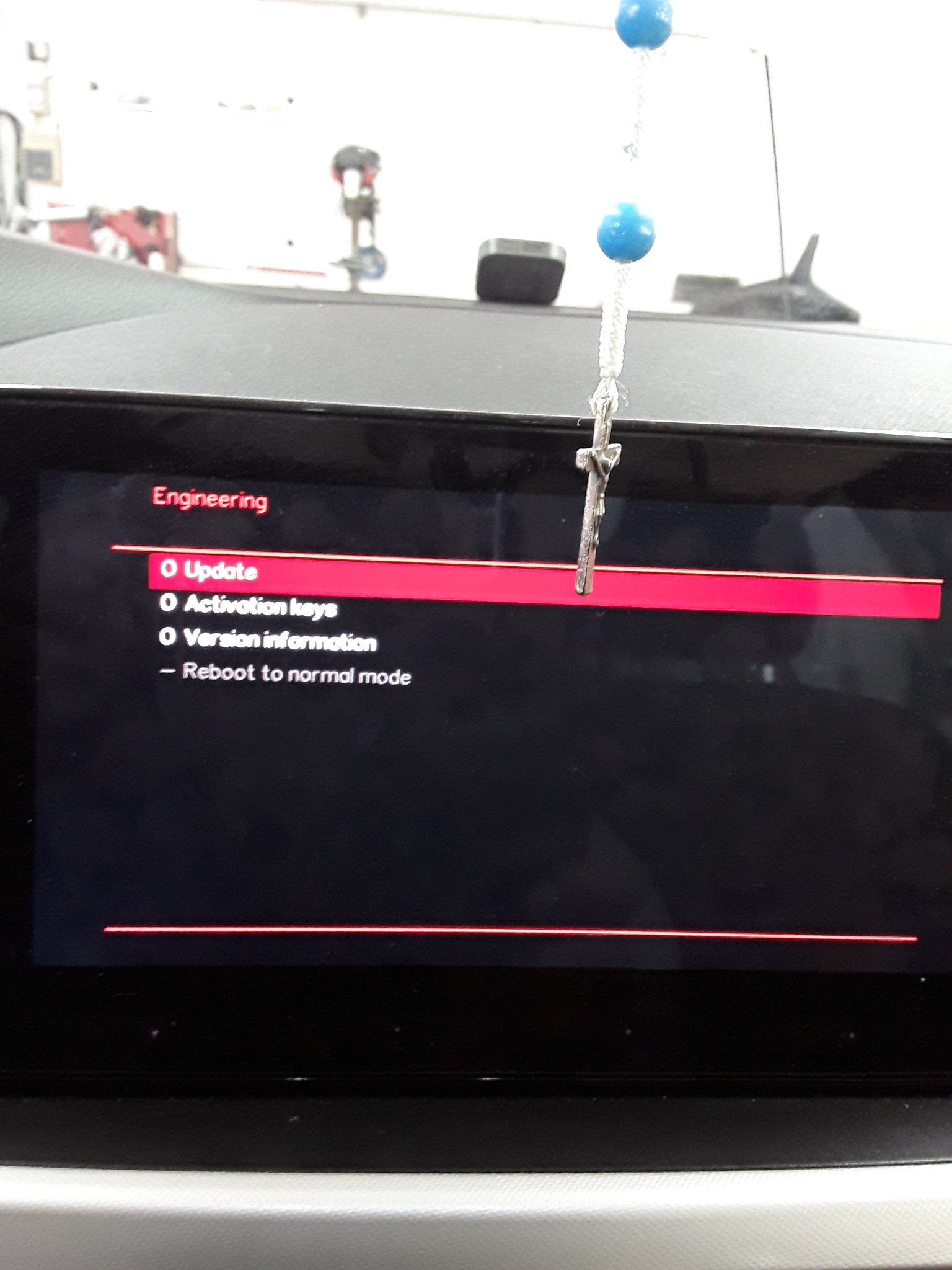

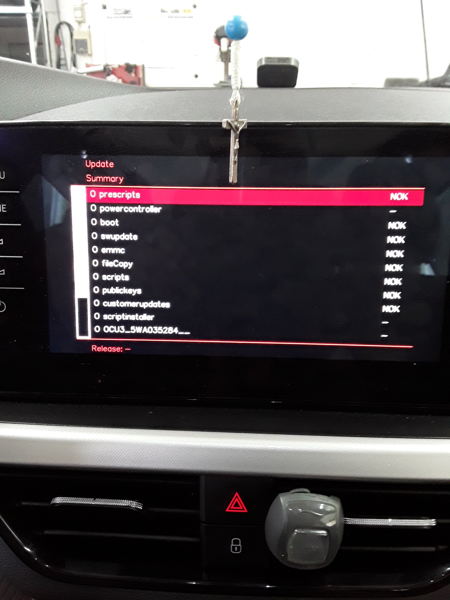

Well I've got myself in some strife. I'm stuck on MOI_RW_SKMQB_R23802P.
Like the EU version, MOI3_RW_SKMQB_P27801 contains three versions - 0238, 0268, and 0278.
Well the update from 0156 to 0238 went fine.
But now when I try to initiate an update, it just reboots back into red menu.
I really don't want to get stuck on version 0238. Among other bugs, it puts 'pre-production hardware' across the screen while using Android Auto.
I think the copy of MOI3_RW_SKMQB_P27801 I've got is missing some files. But that was hard enough to track down in the first place.
The copy of MOI3_RW_SKMQB_P30800 suggests I could upgrade from 0268 if it can get it updated at least that far.

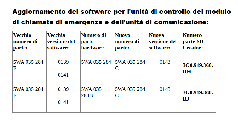

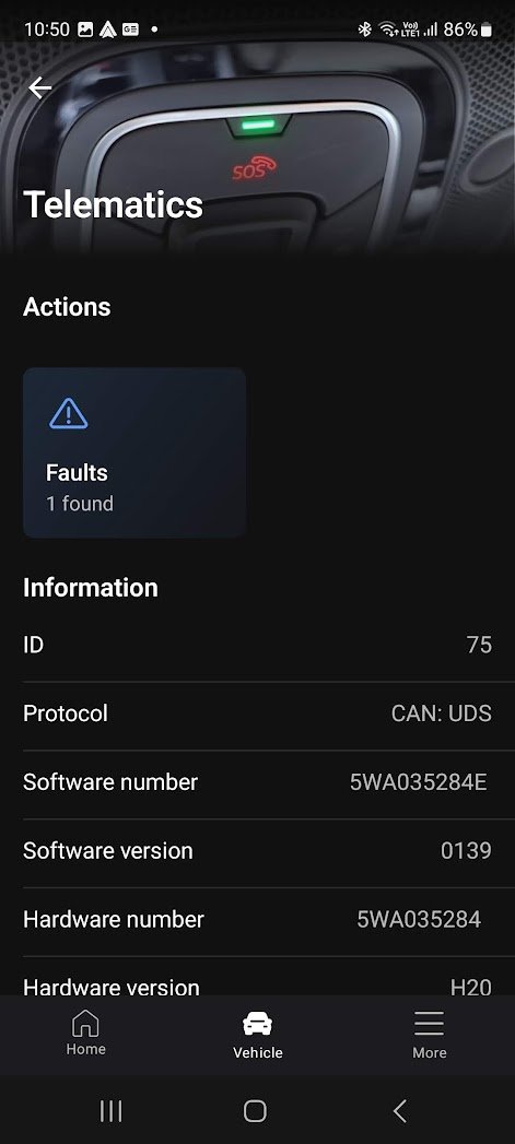

Hello, could someone tell me if OCU update file to 143 matches my actual configuration for a Scala Monte Carlo 2020 ? I have a doubt with "E" at the end of software number, which is not in hardware number.
IT'S OK Address 75: Telematics (J949) Labels:* None
Part No SW: 5WA 035 284 E HW: 5WA 035 284
Component: OCUGen3High H20 0139 >>>> for my Kamiq MY20
HW Number ist not in Relation with SW Number
I have VCDS original Rosstech and " Address 75: Telematics (J949) Labels:* None
Component: OCUGen3High H20 0139" is original LOG after update from OCU H20 088 to 0139 SW add ......"E"
During Update emergency light ON et engine ON or connect charger

Thanks for information, update from version 139 to 143 has been made successfully and I have "G" at the end of software number like mentioned in table

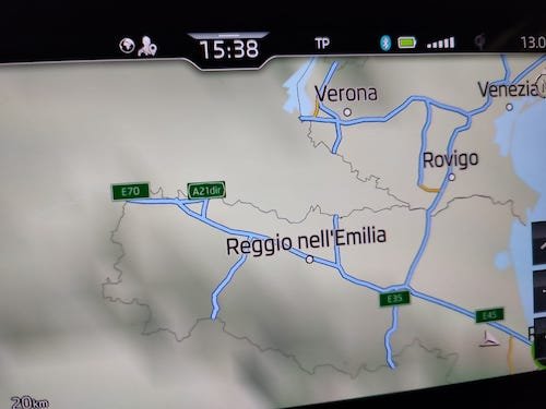

I'm having a problem with the maps, I'm seeing 2 cities from Cyprus (always same 2 cities: Limassol and Nicosia) in random places everywhere on the map, and they appear mostly when I zoom out.
Maps are stuck to 23.6. Tried with offline update via USB, but also with Infotainment Online, no change, no new road appeared, nothing.
Swap codes are looking good, the 00071c00 appears to be installed and valid.
While navigating throughout other countries, maps are looking.. not great, not terrible, however, navigating through Cyprus is a total mess (please see the attached picture).
I managed to update to 0332, the emmc ended with status "New", however, nothing changed on the maps.
Connected with ODIS, tried to format the Navigation Data Bank, but every time I tried to start the operation, it would just return "Incorrect Results" as the outcome and won't do anything.
Is there anything that could be done further at this point or this unit is "bricked" forever?
Thanks a lot!

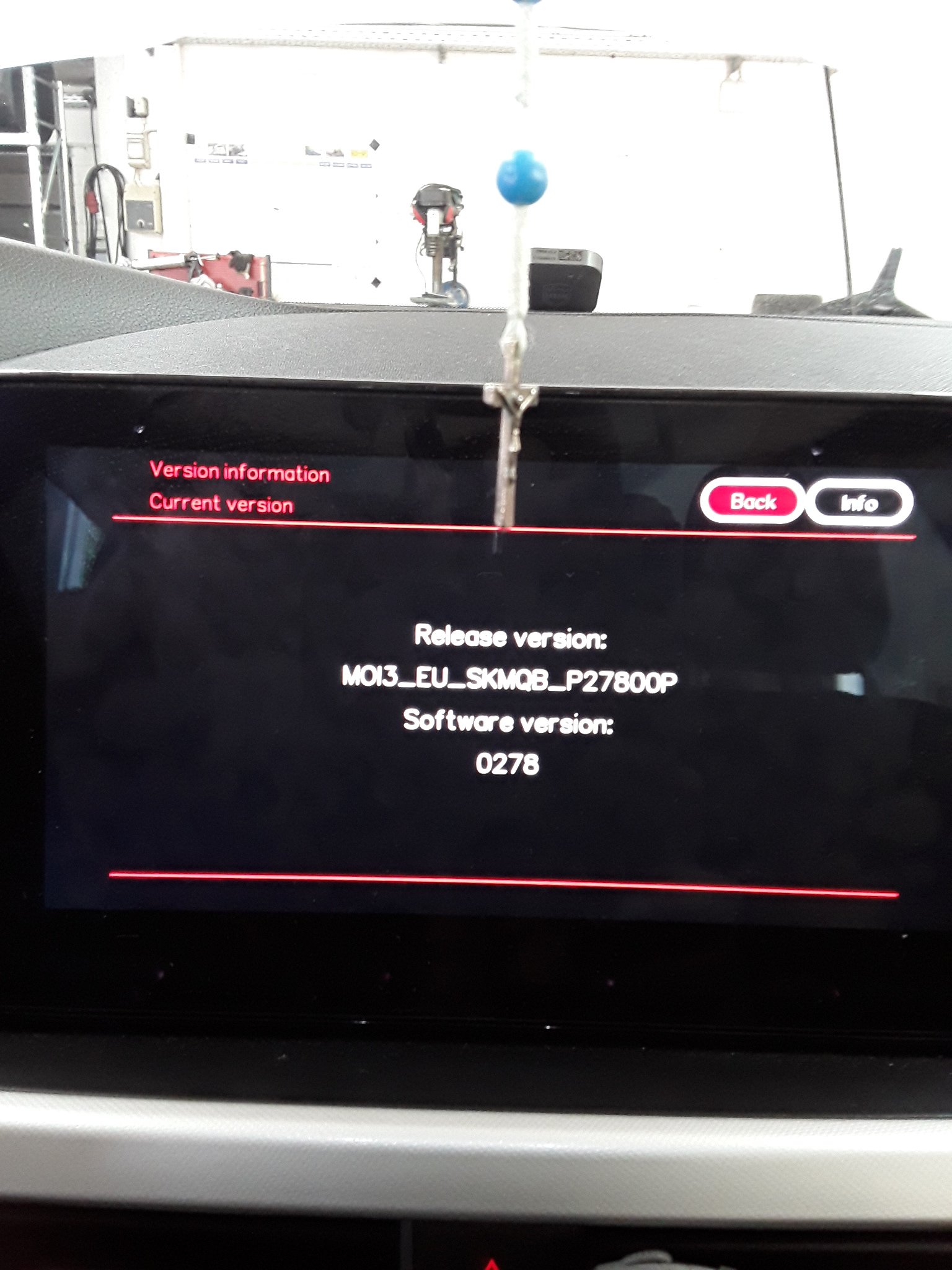

I drive a 2020 Skoda Kamiq. I was having trouble logging in as the primary user and found this forum. The software on my device was version 0156. I then performed the first update 0156-0238-0268-0278 via USB stick. But now it stopped. The charger was connected, so the voltage wasn't the problem. What are the options? Is there something like a recovery firmware? I can't perform the other updates either... Thank you very much for your help.

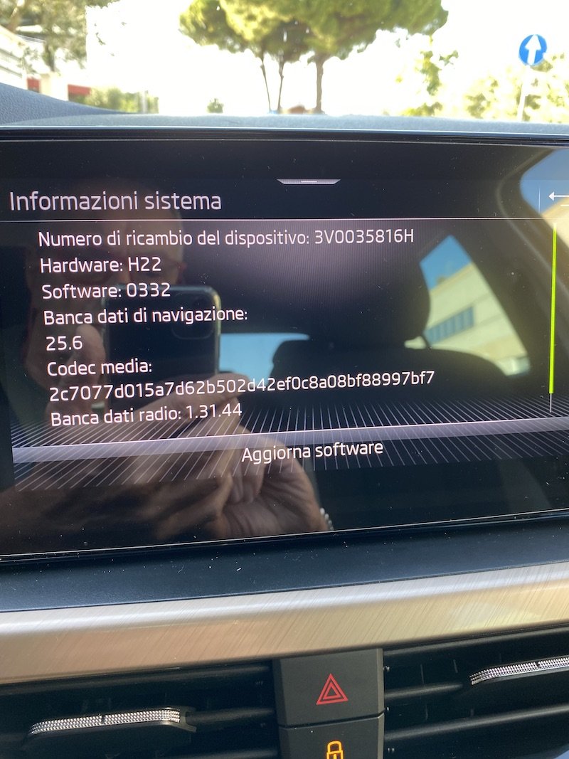

Karoq 2021 successfully updated 330-->332
seen no improvements but all seems to work correctly.
Is this the same process for the scala ?
And can't we just update without any odbeleven(or other) ?
I don't care if the gps will be broken
Thanks.
Which is your actual version number ? If greater than 308, upgrade to 332 can be directly done, and if not you have to install intermediate versions. Also if from 1xx version to 2xx, there is a problem on GPS license.
For my Scala update from version 156 to 330 has been made by dealer. But there is a regression with Skoda Connect services and I can't be primary user of system and dealer does't know why (infinite loading message). I found help on this forum to update OCU to version 143 but problem is still present. I wonder if update MIB to 332 would solve that
