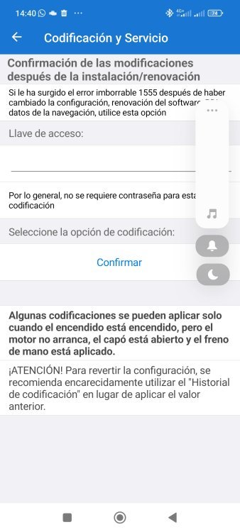

This is with Carscanner, no new code needed.
Screenshot_2024-01-24-14-40-36-110_com_ovz.carscanner.thumb.jpg.749badd2a4652922c01ac5047ca77a63.jpg

if I understand correctly, the 1555 error is the same as the B201A. https://www.carscanner.info/coding-mqb/

Just a question: if I upgrade from 306 to 308 and then to 330, I need to clear 1555/B201A every time or I can clear it only at the end of the update to 330?
Only at the end.

Seems to works fine, no 1555 error (actually I saw it, and corrected, with carscanner. but nothing was show on the display)

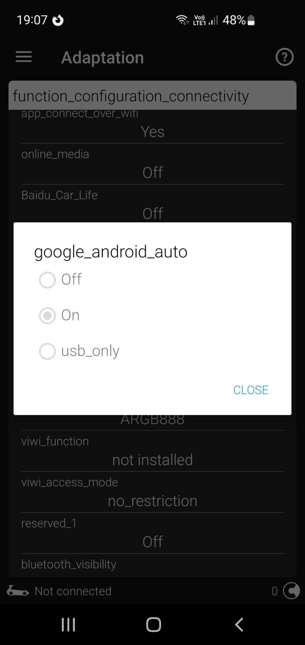

- I managed to enable Wireless Android Auto with ODBEleven by switching from "usb_only" to "On" for the google_android_auto option :
And so far no more issue with the built-in navigation or the reverse camera.

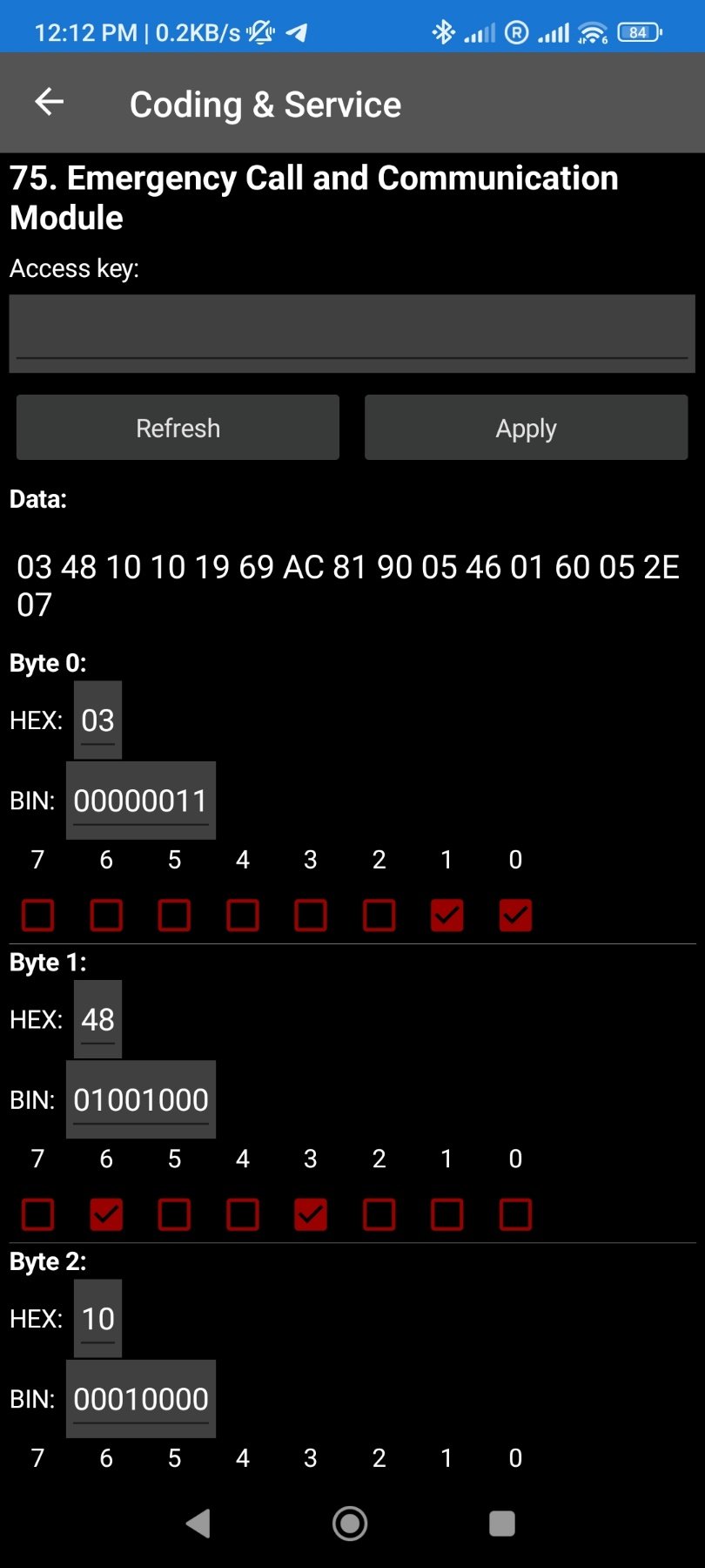

Hi all and @r0bb10. Thanks for the detailed instructions! Was just going through them prepping everything (on a Superb IV 2020) and wanted to check on the OCU Crash Signal update to go through CAN - how can I update that through CarScanner? I had a look at the menus there, but couldn't find anything to do with 0075 module or OCU. Actually I lied, found it in the long coding section, but unsure what values I need to update (screenshot attached)zvi
Many thanks for the help in advance!

What is your OCU versión? If It is 88 you can update to 143 by simply way
How do I check the version? Apologies for the basic questions, still getting up to speed with all of this and don't want to break anything.
In Carscanner -- ECU IDENTIFIERS and read It.
