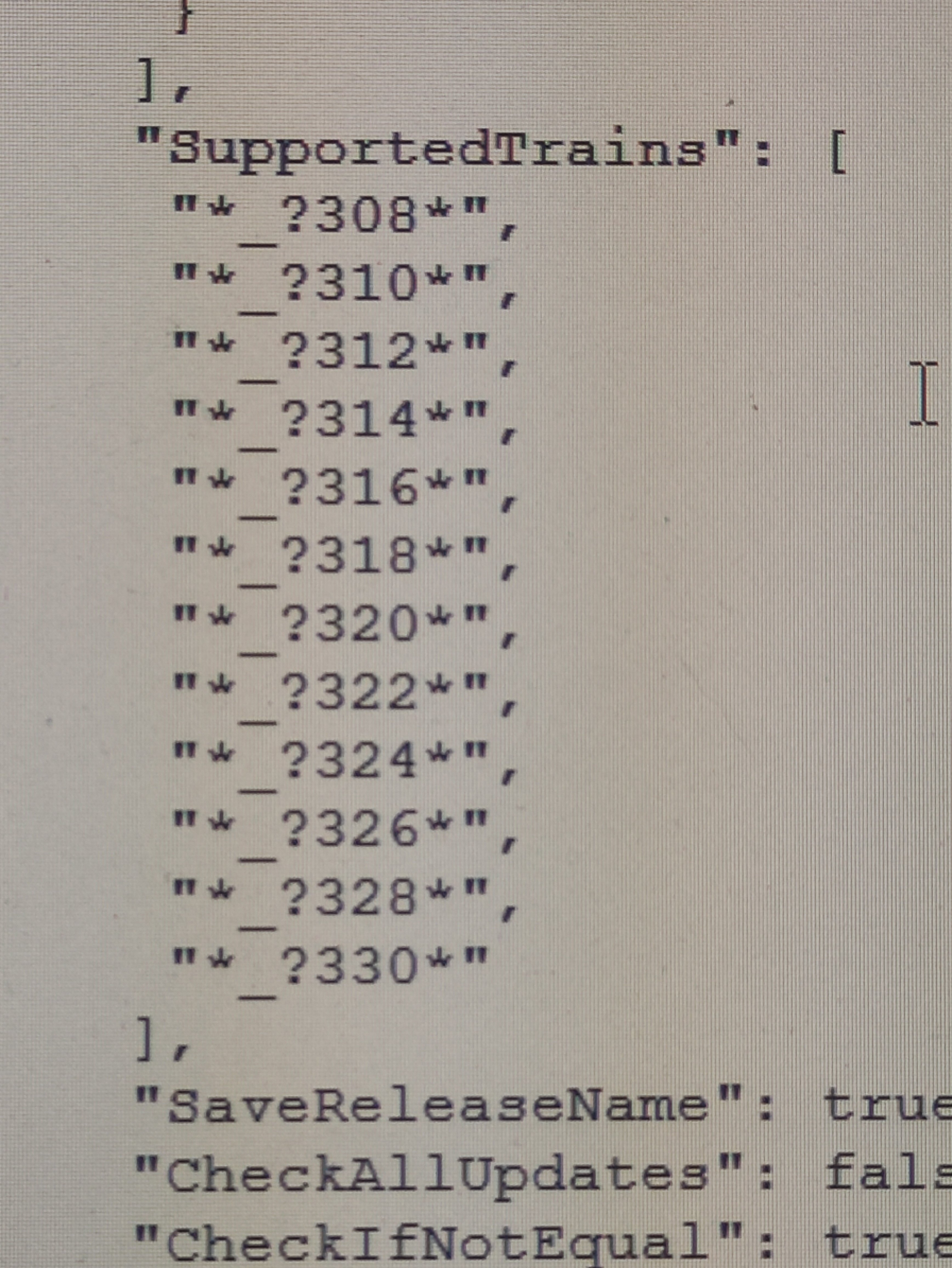

according to the 0308 manifest you should be able to update from 302, you could probably do the same on the Karoq just try it the software will check the hash and only do it if it's compatible.. you will not have any functional error just need to do a SVM to complete the procedure but it does not show up in regular driving.
 "Manifest": "1.0.0",
 "PackageName": "MOI3_EU_SKMQB_P30800P",
 "PackageType": "main",
 "PackageVersion": "308.0.1",
 "Release": "MOI3_EU_SKMQB_P30800P",
 "MuVersion": "0308",
 "SupportedTrains": [
  "*_?268*",
  "*_?270*",
  "*_?272*",
  "*_?274*",
  "*_?276*",
  "*_?278*",
  "*_?300*",
  "*_?302*",
  "*_?304*",
  "*_?306*",
  "*_?308*"

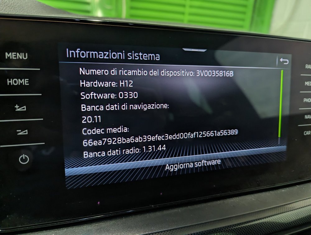

On 17/02/2024 at 18:28, r0bb10 said:
PS: btw, proof that i'm on 330 now :) i also connected the car to my wifi in the garage and perfomed an online update for the maps, i'm now on 23.6 database and not on 20.11 like the photo sais).
I've done all the process today, everything works. As I have the Nav already present I didn't lost anything durint the update from 0156 to 330.
For the Nav update, you download the file from skoda website or you just wait an update pop up in the radio ?
Anyway thanks for the guide and the files :)

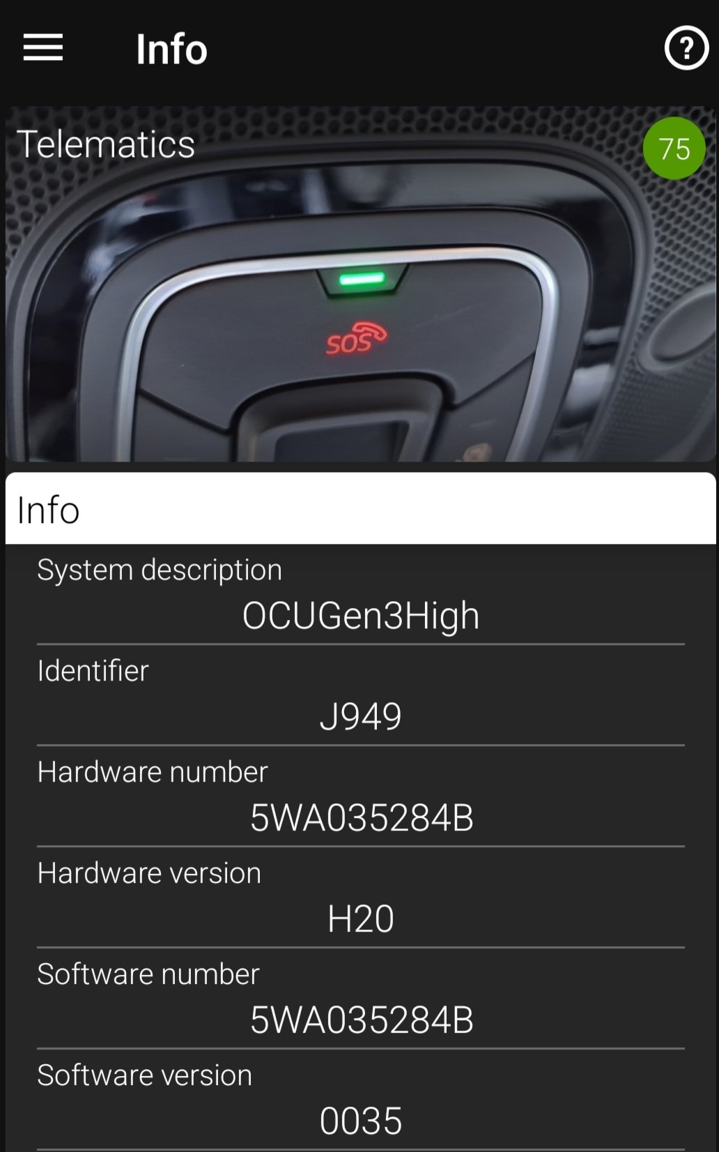

I purchased an ODBEleven dongle to check my OCU version and to be able to clear the SVM error when I will (maybe) run the software update of the MIB. We talked about OCU in this thread before and checking my version I'm worried that it's very much out of date...
See the attached screenshot. Any tips and info you may have to update it ? If not needed I wouldn't touch it though.

23 hours ago, chli said:
Hi @r0bb10,
that's a very very old version, does obdeleven say that there is a new version available? i dont know if there is a special procedure to update from that version but technically if the update allows you to flash it you should be ok doing it, the only problem could be that maybe it requires other updates on other modules.. you could try in erwin looking for a TPI.

Hi @r0bb10,
Thank your for the insight. I just checked with ODBEleven and no update is detected for that component.
I don't see any instructions in my TPI regarding the OCU, I will maybe get another "one hour plan" on ErWin to see if I missed something.
Do you have the same HW number / version of the OCU ?

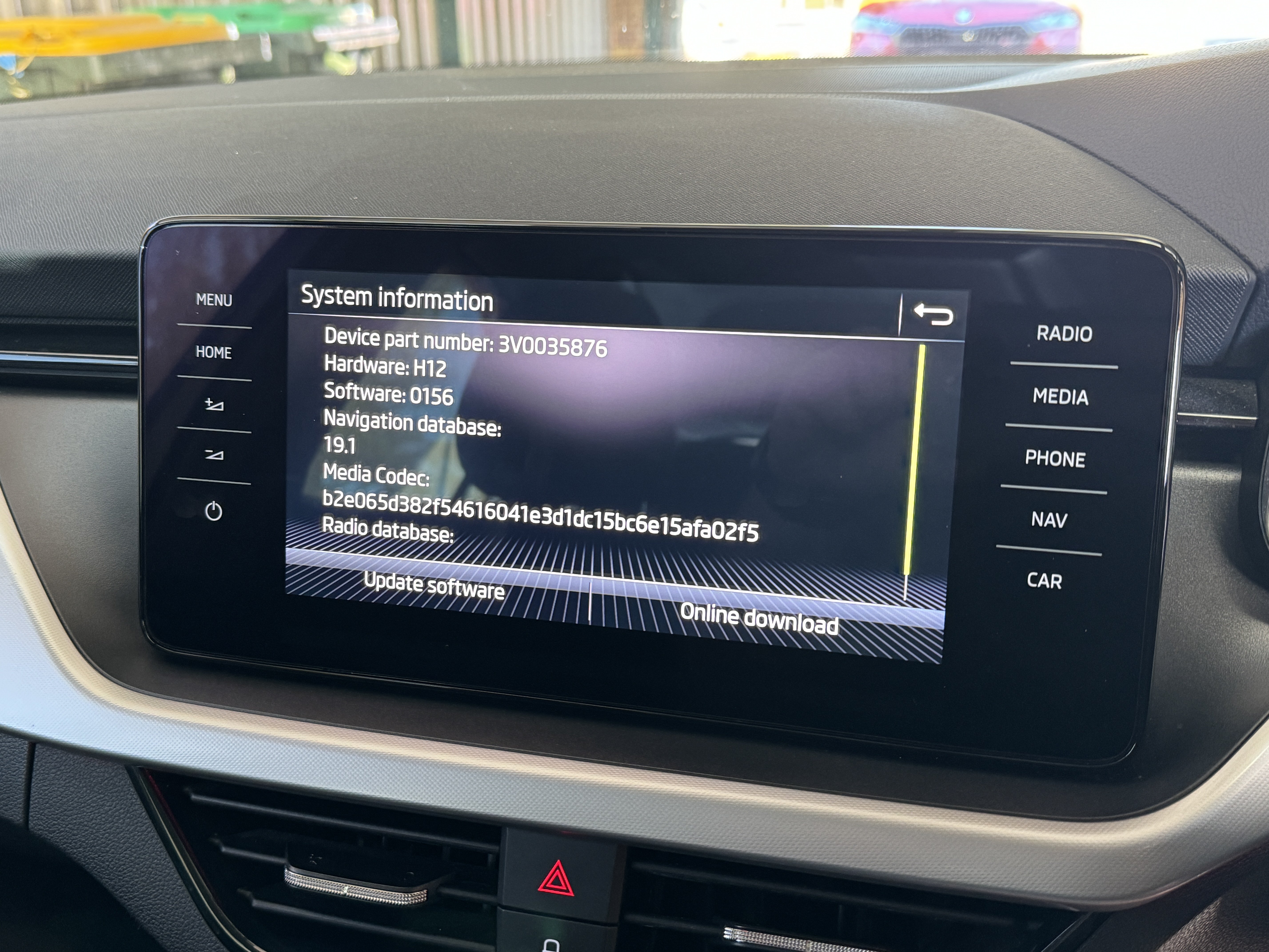

I need help to find Rest of the World or RW files to update from 0156.
can anyone help?

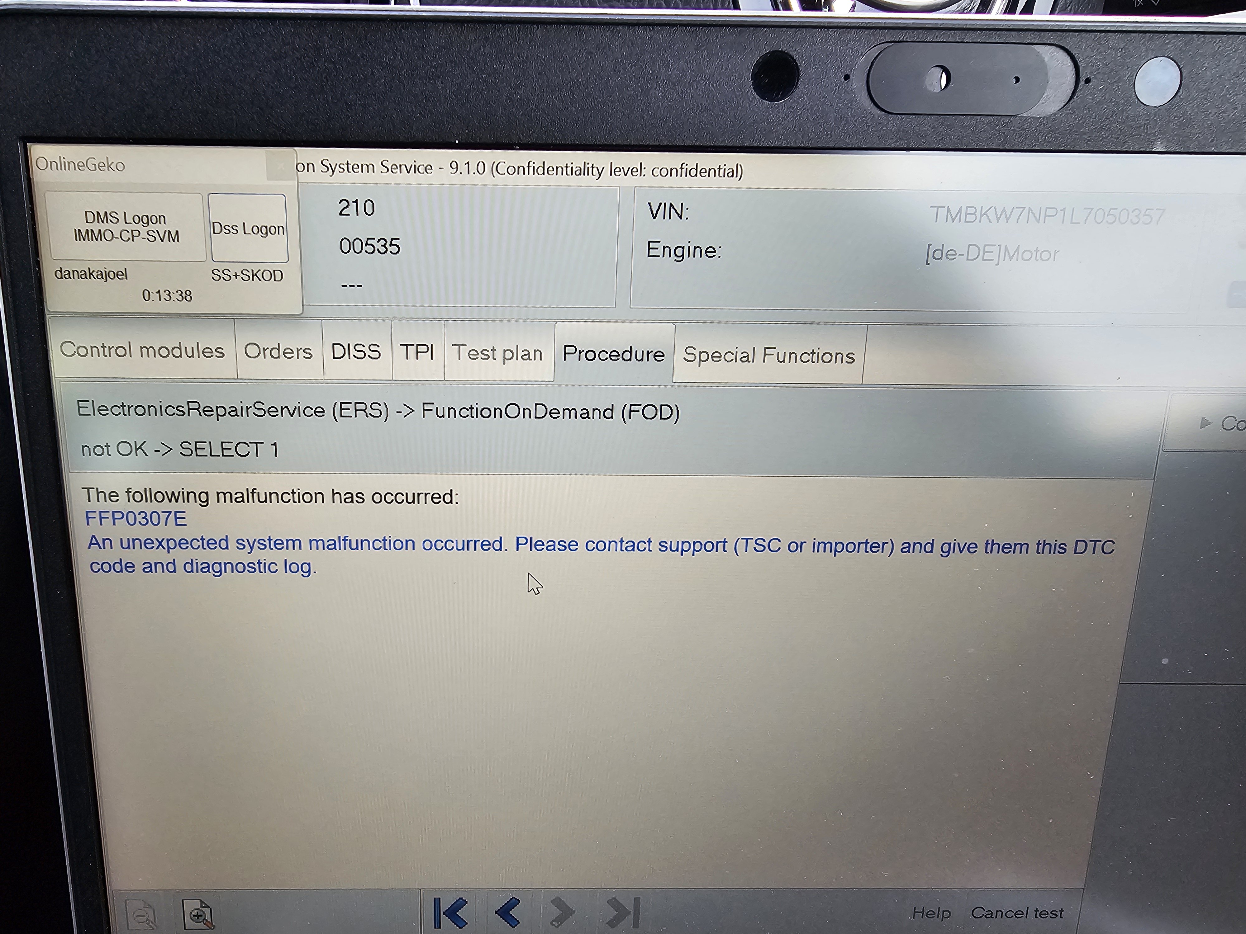

Hello i have 0324 already on my car but navigation not active only carplay work and android auto work
So any help to active navigation gbs on mib3
and thanks

Hi, sorry for the late reply.. i did not encounter in such an error but you cannot use other codes from the excel, they wont work.. your codes are "TMBKW7NP1L7050357 FREPPSDNAVB1 SV8719ZZTRBM 489747", did you follow the TPI correctly and used the FFS menu to reactivate navigation? It requires DSS Login on Geko, it's wierd that it does not allow it, but i used 7.2.1 odis so dont know if something else is messed up.
You could bring the car to the dealer and make them reactivate it no problem, you just have to pay the work if out of warranty but they should do it.
Thanks R0bb10.  I have been chatting to Lennart, fairly sure I went through the correct options and used the above codes. I used ODIS 9.1 so that's the only difference. Unfortunately my dealer is useless in this regard and recommended changing the infotainment unit for £3,000!
The only thing I wonder is that I have an expired Connect subscription for the Connect Services - Infotainment Online and Care Connect - Remote Access. I wonder if this makes any difference or perhaps activating from the UK makes a difference. Not sure?

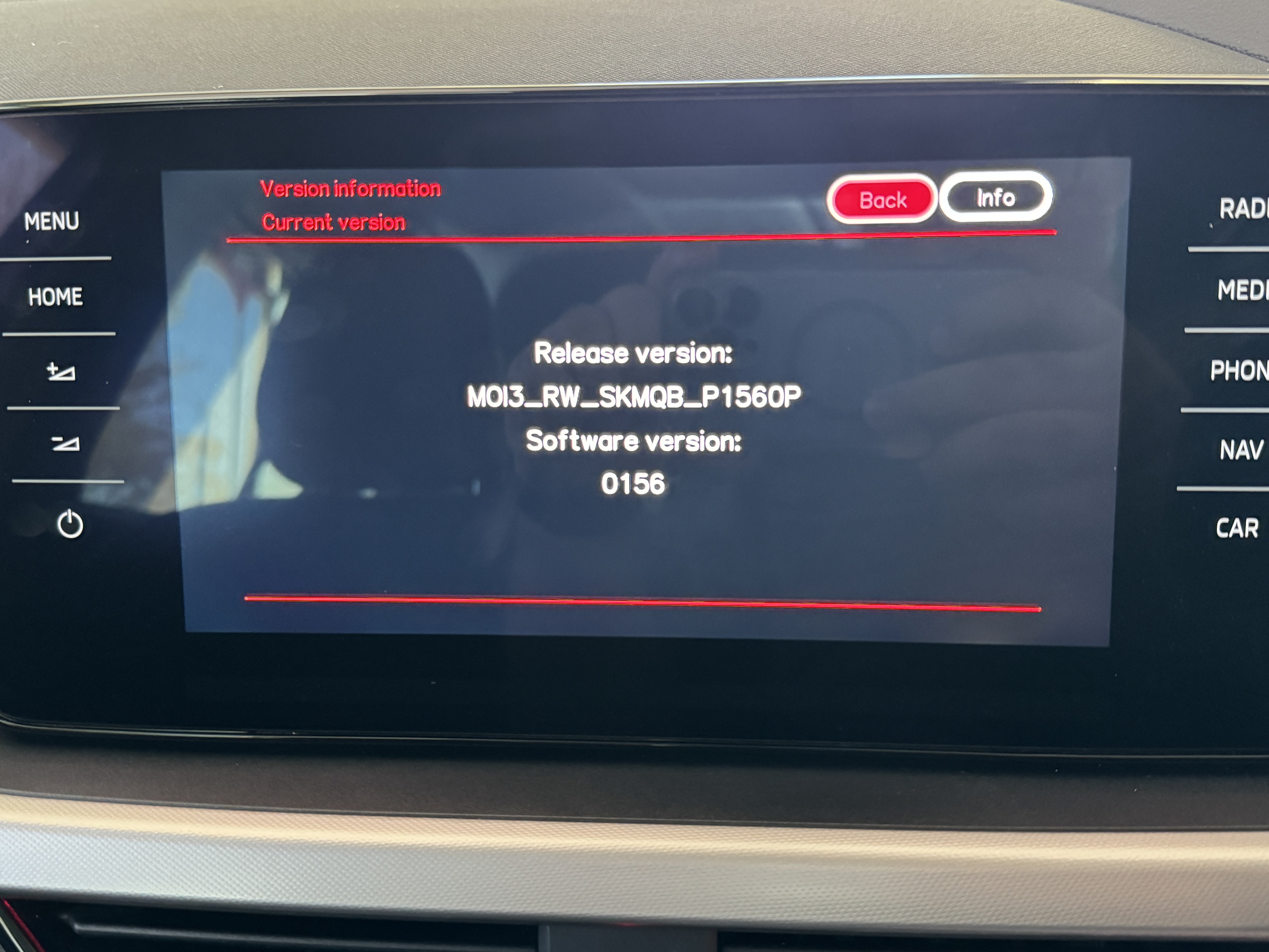

can anyone help?
So I need the following files:
MOI3_RW_SKMQB_P30800P
SK20230716RDW308.zip
MOI3_RW_SKMQB_P32400P
SK20230718RDW324.zip
MOI3_RW_SKMQB_P3300P - This one was only added on the 10/3/2024.
SK20240308RDW330.zip
However, as the car is on version 0156 then I'm assuming there are older rest of the world files not listed on Vag-Flash Info.
Is anyone able to help with Rest of the World/RW updates? I'm in Australia and we don't have Skoda Connect which why I assume we use a different file.

Yeah you need other files before the 308, if you upack the 308 file there is a file inside called manifest.xml iirc, you can open it with notepad (or notepad++) and look on which version it can be applied, like this example:
  "*_?268*",
  "*_?270*",
  "*_?272*",
  "*_?274*",
  "*_?276*",
  "*_?278*",
  "*_?300*",
  "*_?302*",
  "*_?304*",
  "*_?306*",
  "*_?308*"
the EU version of 308 can only be flashed if your current version is at least 268 on newer on on 308 itself, you have to trace back evey version but i assume that RW it's very similar if not identical as the EU.
finding older versions is difficult i know, i have the olders one for EU only because @Lennart shared them, i dont really know where to look for them, surely somewhere in the VAG flashdaten.
sorry for not being more helpfull 😞

330 need at least 308 update.
