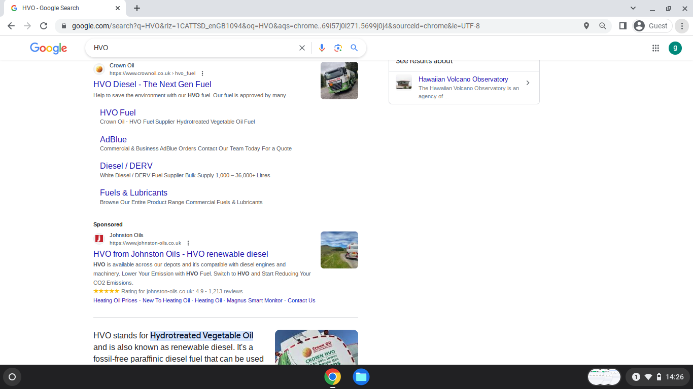

I watched a Guy Martin programme about energy and he mentioned HVO which I’d never heard of, but I’m sure he said it was around double the price of diesel.

Last year it was between 15p and perhaps 30-40p above regular diesel but that was for corporate customers with own tank on premises. Maybe my numbers are outdated.
There are plenty suppliers and customers for it, and the country has plenty waste vegetable oil.

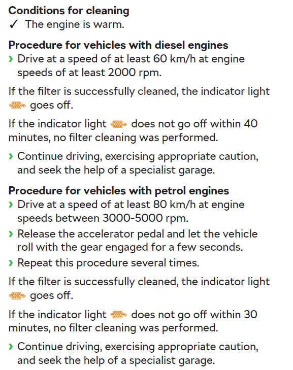

What these cars should have had is a manual button for DPF cleaning, so when you know you’ll be on the motorway or dual carriageway for a while you press the button and it starts if needed.
Some vans have this now, which makes sense
The Buttons i know about are so that the driver can push it when the vehicle is stationary with the engine running.   That is not stationary on a Motorway or Dual Carriageway.
