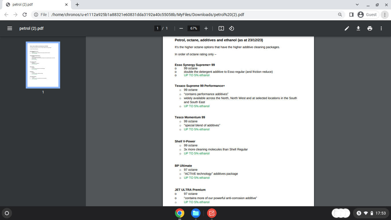

E10 in UK    Unleaded petrol with up to 10% Bio-ethanol.   Maybe much less.  95 ron minimum.
E5 in the UK might have up to 5% Bto-ethanol. Might have 0% bio-ethanol.  97 ron min at some sellers & 99 ron at others.
The amount of Bio-ethanol might not just be at different brands, but in different regions of the UK.
Trying various is simple, but at least try and know what you are buying.   And you petrol engine should run just fine on 95 ron E10 so any Dealership staff saying wrong fuel do not use supermarket stuff is just a Rodney.
E5 might help but first have car running correctly.

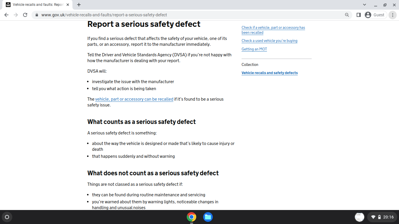

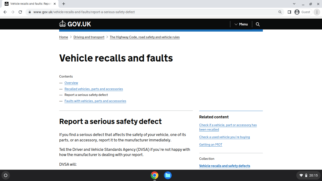

@ken2  The issue is that 'They do not all do it',  only the ones that do do.
So no point going with the same old that Skoda Dealership Staff might spout 'They all do that', because if they do the DfT / DVSA better get VW Group doing a safety critical recall.
& resolve the fault as they had to with the 'Lack of torque recall'.
The other Dealership rubbish from some is 'Never heard of that before',  so be sure your issue is logged and with Skoda / VW UK, and with DVSA.
There are contacts for them when there are safety concerns.
