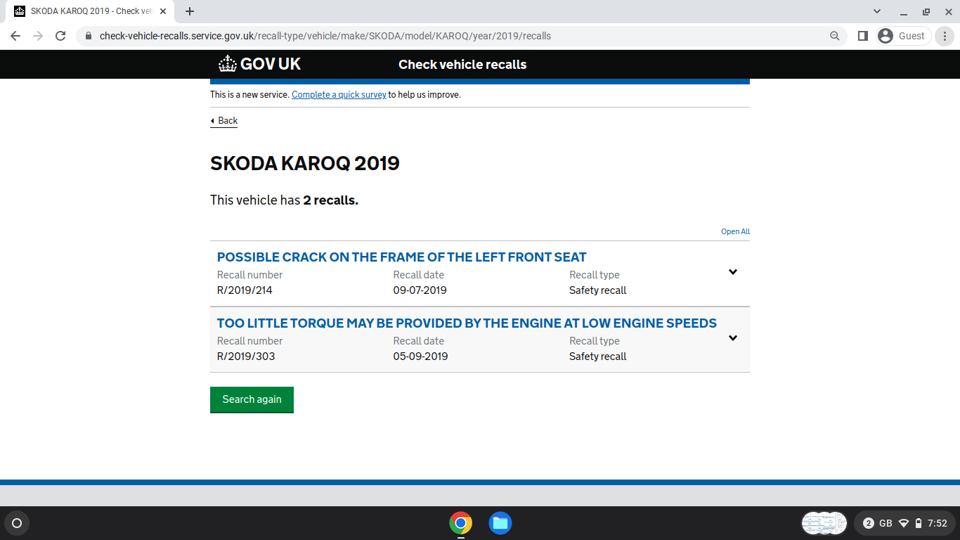

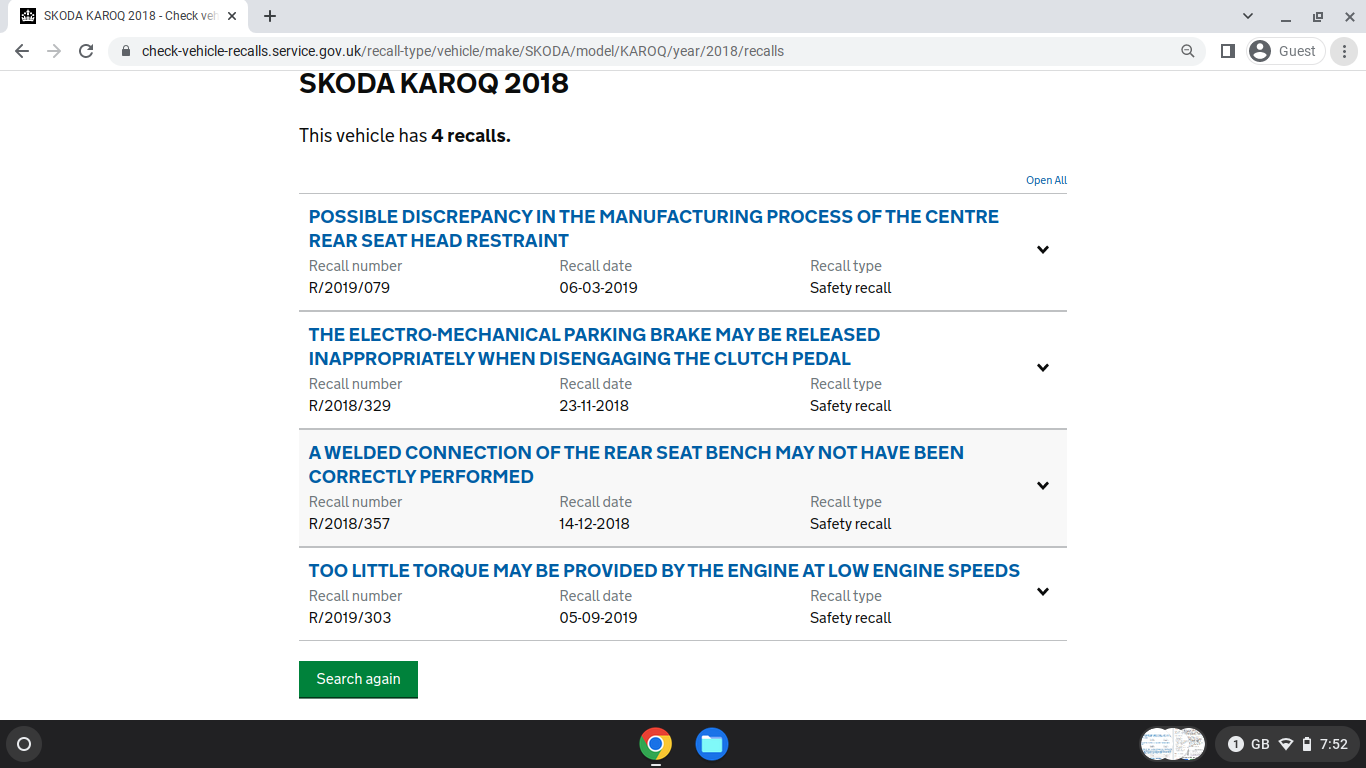

Pathetic after sales service from Skoda Dealerships.  Really this nonsense needs more from Skoda / VW UK.     Deaf dumb and blind Franchised Dealerships / Authorised repairers.      The people you have to report Warranty issues to and unsafe behaviour to.   They learned nothing from the WLTP / 2018 kangarooing issues.   That ended up with RECALLS.   Well past time that the DVSA were involved.
Was the kangaroo a recall? My car is 2020 how do I find out if it had been done, although I don't think it has as I can get it to kangaroo it accelerating very gently.

So there is a recall for it your not imagining stuff.
