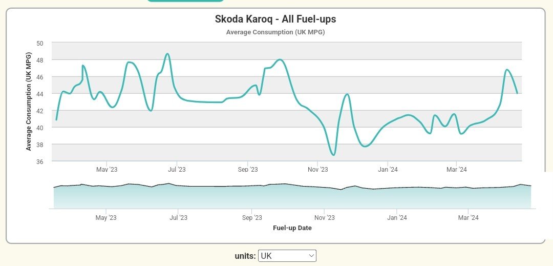

MPG over first 20k miles:

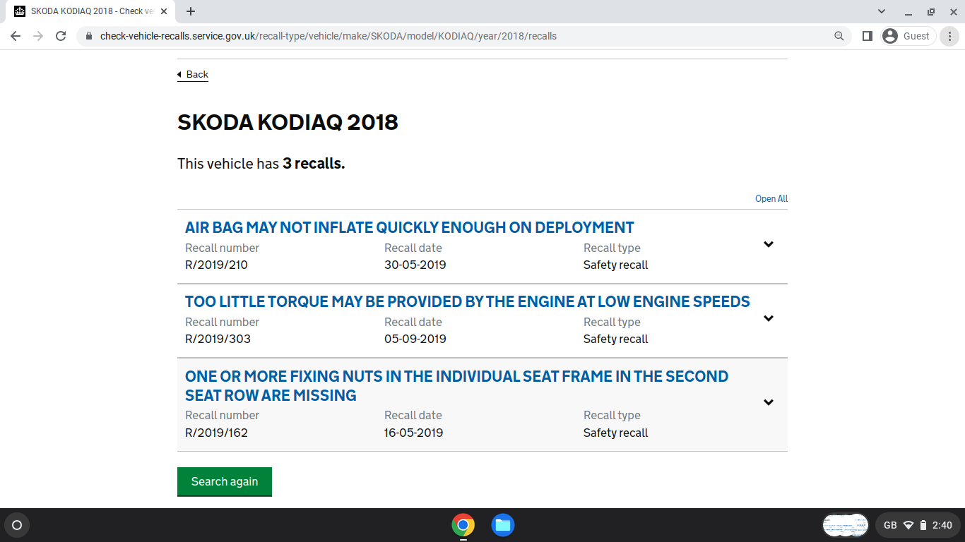

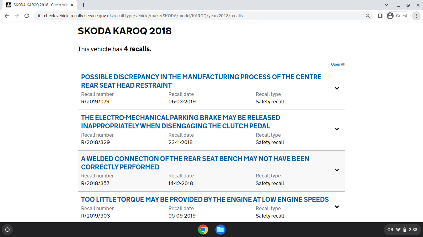

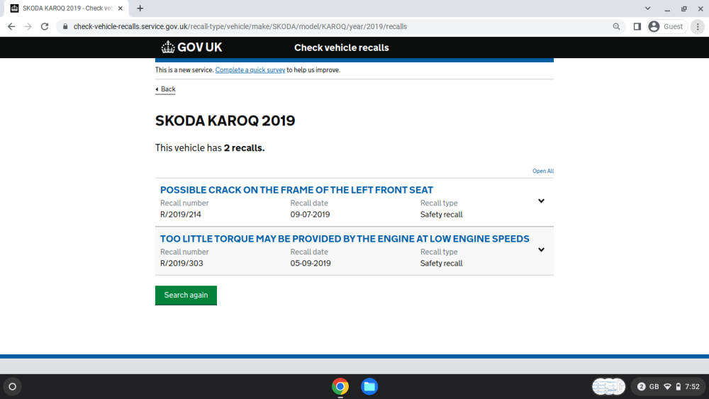

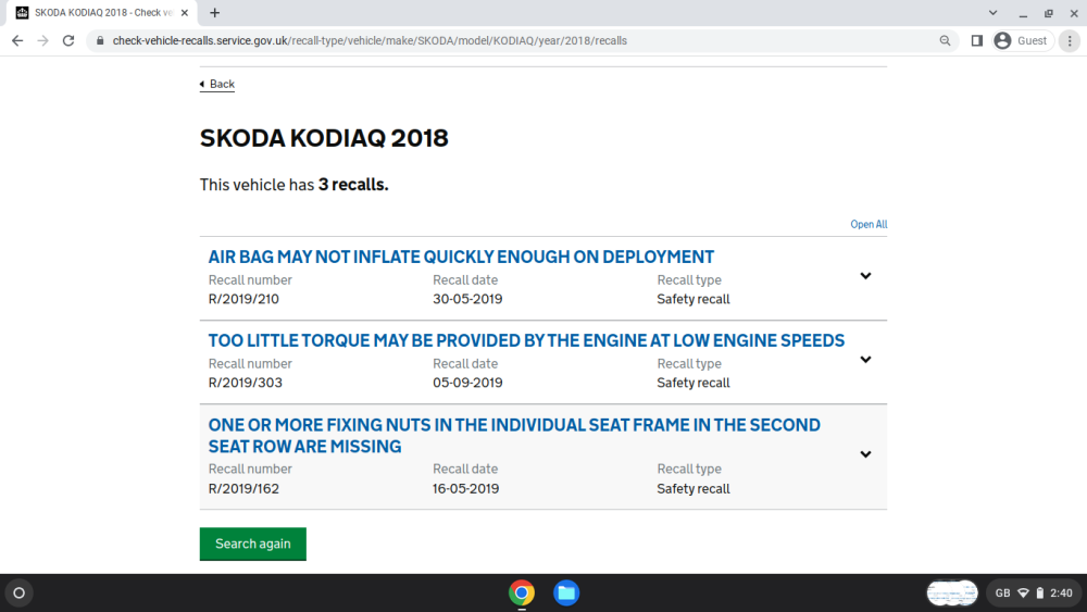

Never heard about it being acknowledged as a safety issue before. My previous car, 2019 Octavia with 1.5 engine was a pig to drive when cold and needed a heavy right foot to avoid the kangaroo style of driving. Other than that the car drove beautifully, powerful engine and fairly economical to run. Garage offered me the so called “fix” software update. Sadly the car was never the same again, engine was flat, fuel economy permanently dropped by 10% too. They denied that this was anything to do with the update. My own car needs to go back into the garage too but I know they won’t really do anything about it. All they seem to do is let a salesman drive your car for a day or so to see if they experience the same issue.
27 minutes ago, ken2 said:
My Karoq is less than a year old
Same here

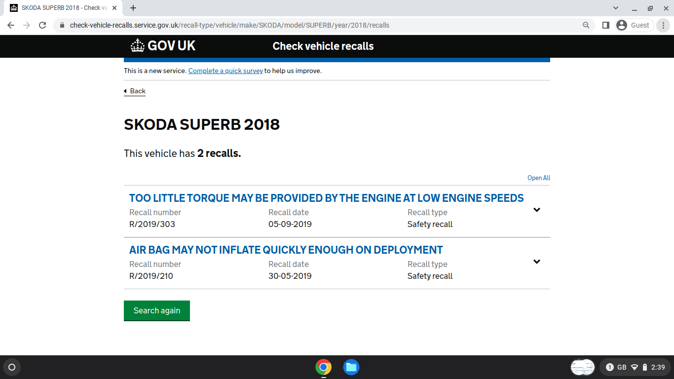

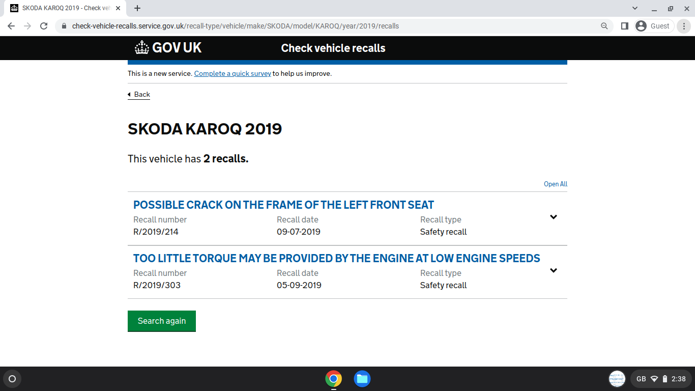

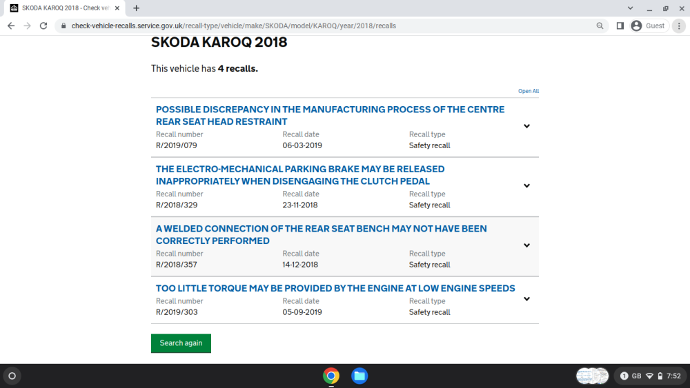

@AllanDJ They maybe never needed to manipulate the Mk3 Octavia 1.5 TSI for WLTP certification in the same way as others, or maybe the persuaded the DVSA as they do try to, No issues.
It was not all vehicles, dependent on manufacture dates maybe.   Likely just they denied issues.
Those without issue are lucky.   That does not help those that do.
Never let VW Group get away with denial when there is evidence of issues.  Denial from Dealerships as well.   They all do that, and the NEVER HEARD OF THAT BEFORE.
