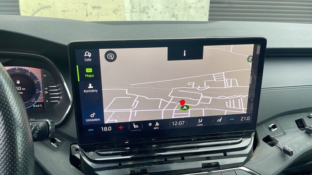

I now tray retrofit  my octavia 4 on screen 13". In unit MIB3 OI - 5e3035816 have diferent resolution on the screnn. for  13" must by change unit to MIB3GP  5h7035816. Only this unit have SFD2 protection. on foto 13" conecting to MIB3 OI
Is the unit a physical fit? I guess with the older OI you aren’t able to go back to home / menu?
update:
1. not correct work PDC PLA - probably difference hardware between O4 and O4FL
2. not correct work RTA - problem between PDC/PLA - RTA
3. not possible adjust climatronic - no screen on HMI -probably difference hardware between O4 and O4FL
