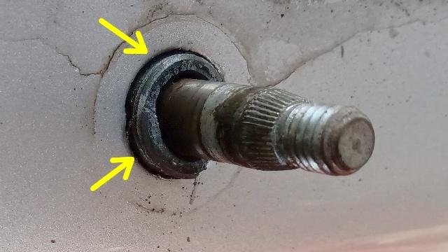

I have done everything i had to do, put the bolt, tighten and nothing...the bolt was in the end of the thread but there was to "resistance", i could screw the bolt with my hand no need for tool.
I tried again and again but nothing, although there was no thread left the bolt wasn't reached the final end, it just turning around and the whole structure was a bit loose. I start slander my decision to buy this VIKA (and the chinsese metallurgy), i packed everything, took my motorcycle and went to the local market to buy a new bolt.

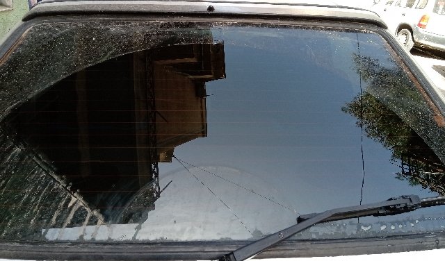

Installed a new wiper blade,made a first test (the new motor looks much stronger than the old) and here are the results:
and
The sound of the motor is normal, it's one click faster but i don't know if the whole ''system'' was solid or not because all these years i never try to check it if it's was loose or not.

Some quick points on the thread and nut issue on the Chinese motor fitting.  Not your fault but I'm a little confused about so forgive me if I have misunderstood.
I think it sounds like the threaded section doesn't protrude enough through the tailgate door panel, if so and all the length the dimensions of the shaft cover (sorry can't think of the correct word) of the Chines motor are the same as the original motor could it be the location or fixing of the body support bracket or the rubber insulation (which look thicker than the previous ones) are locating the Chinese motor more inside the tailgate than previous motor thus not allowing enough exposed end thread?
I am unsure if you have used the 'Hex nut M20 ISO' or nut that came with the Chinese motor with additional Teflon tape - my thought is that the end nut is to securely locate the "shaft cover(?)" by clamping force and all the rubber washers are to reduce movement and vibration for wear on tailgate panel (hole) and driver's comfort (noise).
The thin M20 hex nut is metric thread, assuming it has been checked to fit correctly and smoothly all the way down and back on the thread (three times) this should confirm the thread on the Chinese motor (my eyes are too poor for thread gauges) but as the thin nut is so thin and Chinese 'metal' often so soft and threads so poorly done what I would suggest is buying three of the thin nuts and try them on the thread and select to use the one that goes all the way up and down three times the easiest and smoothest and use that.  Bear in mind the thin nuts could have poor quality threads but easily screwed on by fingers only so any slight catching (forget the proper word again) carefully remove that nut and put it in recycling.
The way you have fitted it now may be fine and durable but I don't know I have not seen and felt it but by reading your description(and I might have misunderstood, I often do) I would prefer a different fixing arrangement.  The Chinese 'metal' being as we sometimes refer to technically over here "soft as ****e)" you should not need or want to use any Telfon tape (water plumbing Teflon tape is thinner than gas plumbing Teflon tape).

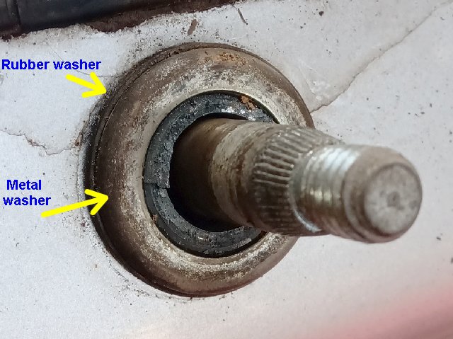

Factory motor-thin metal washer-rubber washer-car body-thin metal rubber washer-curved thin metal washer-bolt

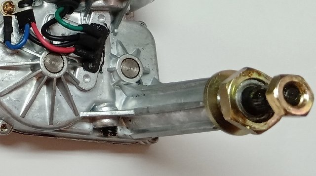

VIKA motor-thick metal washer-mine rubber washer-car body-mine rubber washer-thick metal washer-new bolt.
The thread in both motor comes out from the metal body same distance (same length protruded), the car body hole is intact so both thread have a small gap (yellow arrows).
Since i have never touched in the past the factory motor i can't be sure how robust the whole combination was from outside but when i opened the 5th door cover i saw factory motor to be mounted only in a plastic base with only one screw, from behind was slacken a bit.
VIKA motor, mounted on a plastic base (different design) with only one screw also, from behind was slacken a bit.

I use this teflon tape although i should use this but at that time standing in the sun, with african dust, in the corner of road i had no choice than use the 1st tape on the thread just to make the bolt tighten better-more tougher.
Maybe in future i will use Thread-locking fluid.

I follow the sequence of washers and hole aperture and agree with Thefeliciahacker about only the start of the motor thread possibly being poor (and assuming the hex nut has a good thread on it),but I don't see how a spacer will help, perhaps I'm missing something but surely you want to reduce the the thickness of the washers so that more thread is exposed for the nut to clear the poor starter thread, or is all the thread poor.
@nta16 This photo that you post was the old thread-washers combination. Even the last bolt needs a 14 wrench which is very uncommon in my car at least.
@Thefeliciahacker From the first attempt things went wrong, chinese metallurgy ''my @ss" as the Americans say. Still can not believe that this bolt is so rare that no store has it.
I couldn't use the old because a mechanic ruin it trying to take out the old broken thread, with new bolt and teflon tape (for metal) things would be as the must be.
Today i made a quick check, the whole situation is stable but not solid so in the future maybe i will need a new motor if the vibrations destroy it.
Yes I know.  That was my point previously, that you could perhaps use some of the old motor parts such as metal and rubber washers, clean and revitalise the rubber washers with whatever you have that is best for the job, metal washers it's up to you whether you clean and polish them.  Getting nuts and bolts/setscrews is more difficult now because of the obsession that everything, even a washer, must be posted to the customer rather than the customer going to a shop so retail places that used to stock and sell wide selections of fittings have closed or had to reduce their ranges, you're luck to be dealing with just metric, try getting small sizes of UNF, UNC and getting a selection of BSF, BSW and BSPT, BSPP.  🙂  Until about 10-15 years ago I didn't even know there were three different metric threads.

You said the length dimensions of the two shaft covers was the same so I assumed this included the length of the treaded section so the photo of the old motor and washers and nut would be relevant.  If you want to use the thicker washer(s) then you could look for a half/lock nut which would have more threads on it than the very slim M20 hex nut but take up less motor thread than the supplied whole, standard depth, nut.  If you wanted you could add threadlock as anti-vibration security, or my mate reckons Tipex is fine too (unless they've changed the formula).
Edited by nta16
ETA: forgot the photo. -
The 1st rubber washer (factory) was damaged, i tried the 2th and the metal washer (factory) but again the bolt refuse to tighten completely.
First time i heard about the Americanic UNC from a seller, an example:
https://tsamouris.gr/category/2626
I knew that some items for example mailboxes, living room lights have their own difficult to find thin bolts but in a EU car i was expected to find mm metric system.
The factory hole (on car body) is a bit wider than the diameter of the thread, maybe this (also with the addition of 2 rubber washers) was done in purpose due to the vibrations of the windscreen blade.
Why not remove the Teflon tape, clean motor shaft cover and nut threads and generous use of threadlock, the rubber washers are taking up small movements so the fitting doesn't need to be "murder tight" as long as the nut remains secure in its position.
Thefeliciahacker is the engineer here but I would guess the hole is bigger with washers and nut clamping as -
