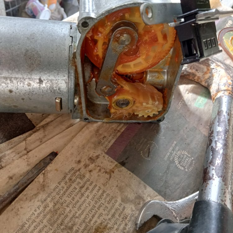

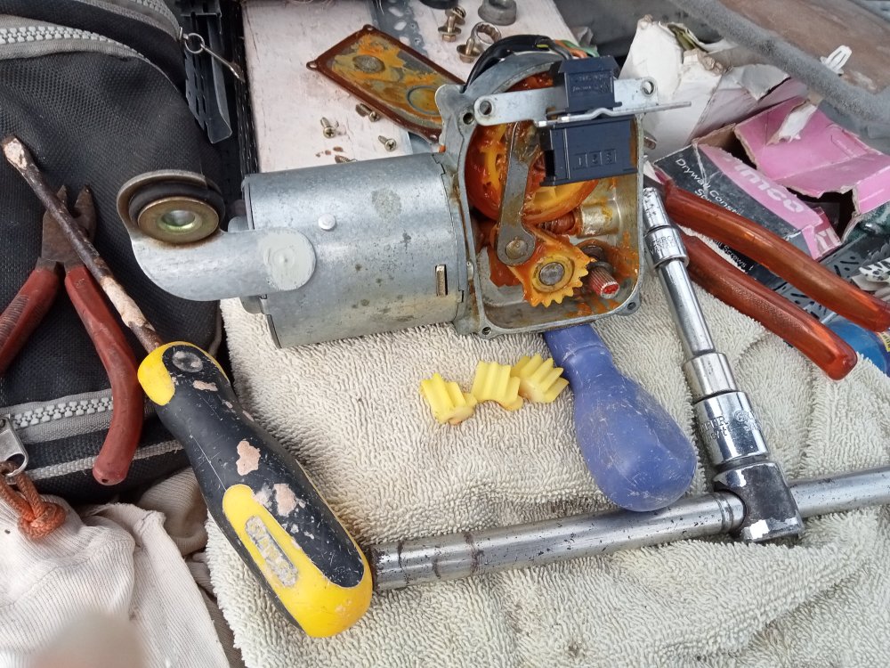

I have removed the motor, does not work properly but even if he was the thread is out and in used spare parts store they sell it as "all together" so the axis goes with the motor as "package".
I will post photos of the motor when i return home.

Mine except the thread must have a problem with the plastic gears (teflon maybe) so i don't think worth or can anybody will take the responsibility to repair it.
Rain in my place is rare and very rare i have used that windshield wiper.

Again you will know this for sure if you open it up IIRC four screws(?)..  Find the wiper type and you might find new plastic gears sets are available (perhaps NOS?), if exact degrees of sweep aren't available other degrees of sweep may be, that increase or decrease area of sweep but still cover enough, or not go too far, for purpose.
