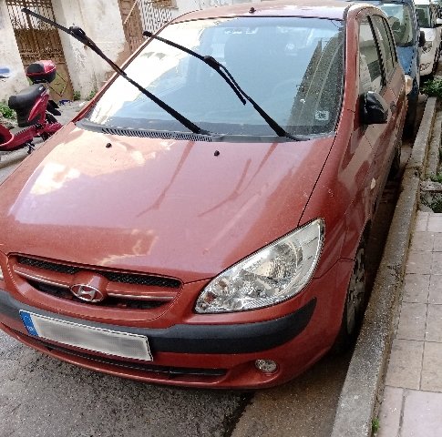

A characteristic example of what's happening here, the cars are parked as they should be and a moron raised the windscreen wipers, imagine this to happen some times more and the driver would have a problem as mine.

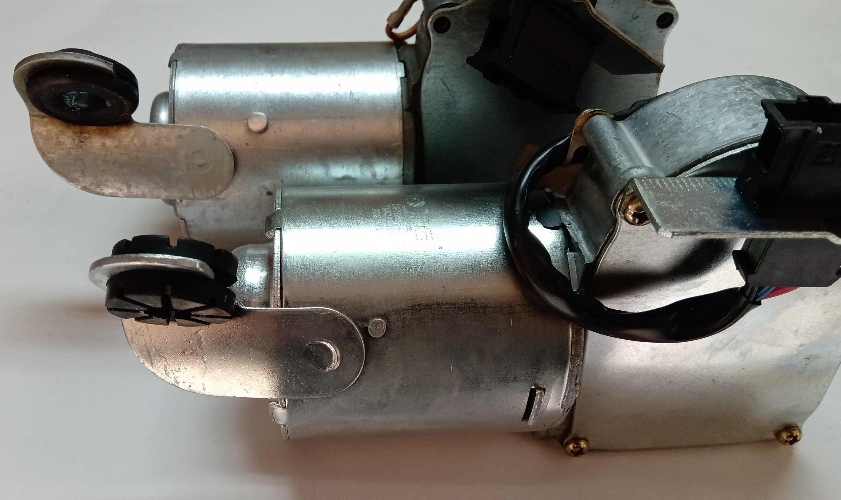

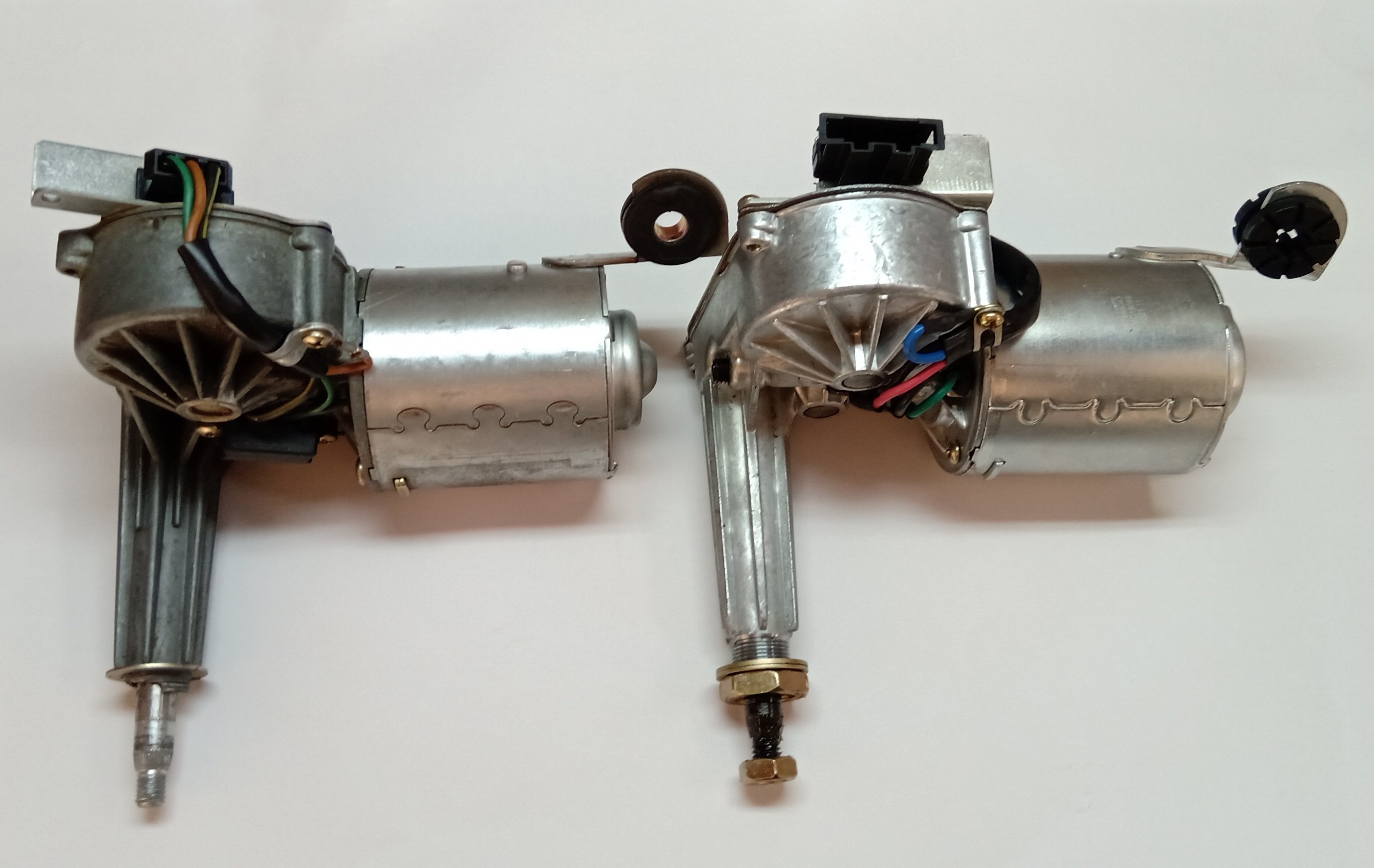

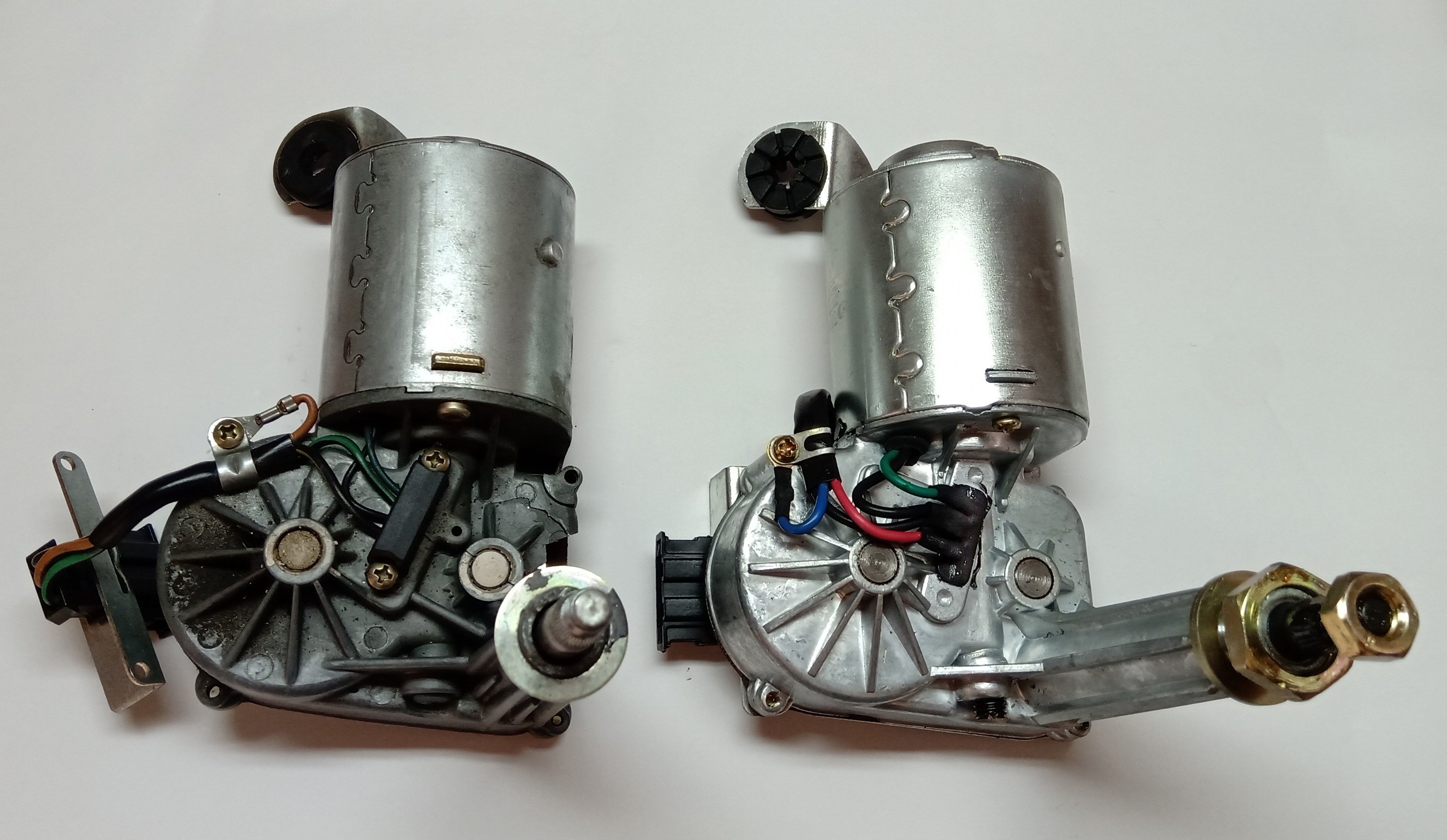

Today was a nightmare, i have installed the new motor but with many difficulties, i will post photos soon.
Here is the Original (old) and the new VIKA (chinese)
-(1).thumb.jpg.f4770dcecfe7a9d33a32b05cf7e7f917.jpg-(2).thumb.jpg.39e48239ff51392e8d82cb10df13d030.jpg
As you can see there are some differences.
It's not a big issue, i will reverse the plug and let's see how the new fits and works.
There are a few differences, that is how these Chinese copies tend to be, they or the car often need some modifications to get them fit properly or well but as long as they work (test the motor before trying to fit it) and they continue to work reasonably for a reasonable time you can accept it.  Some can work well for a long time, some faulty or don't work straight out of packaging or within minutes, hours, weeks or months of being fitted or actual work, it's all a bit of a gamble, quality testing and assurance seems to be a thing of the past with such items.
NOS if still around, or used refurbish or repaired original items can often be much better for performance and longevity - but then, not always.
Perhaps this will outlast the car. 😊

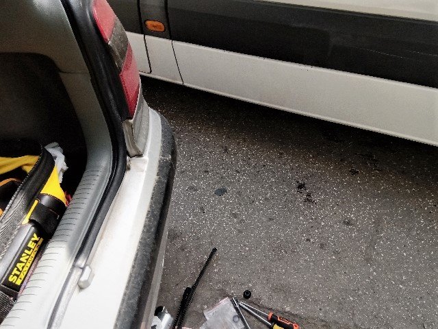

Nevertheless i have bought the VIKA and install it, the task wasn't easy because i had to work in the street, under the sun, lot of African dust, standing upright so much time with cars-trucks passing very close to me.
This is for you @Thefeliciahacker who believe that we mustn't have tools in the trunk but on the other hand ''do the things by your own".
Take a look how close the other vehicles were, one wrong step by me and...♿
