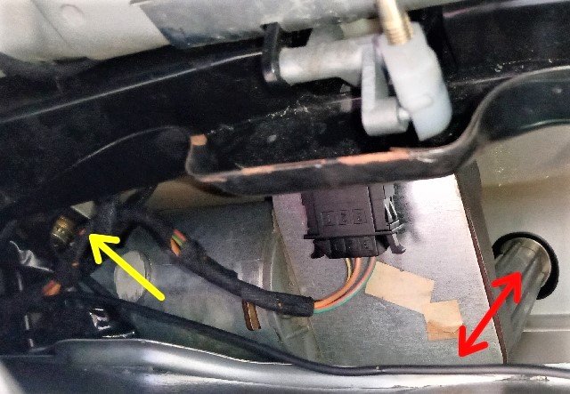

Mine is 95% like yours, if i move it harder i have a tiny slacken feeling but from the rear of the motor
https://www.briskoda.net/forums/uploads/monthly_2024_03/PPM.jpg.c5dc931fe446f6ee0f49b6654a042dfe.jpg
Since there is a rubber ''base'' (yellow arrow) there, for sure there would be a tiny amount of tolerance (red arrow), i don't think it's significant and can cause any problems in the future but only the time (of use) will tell.

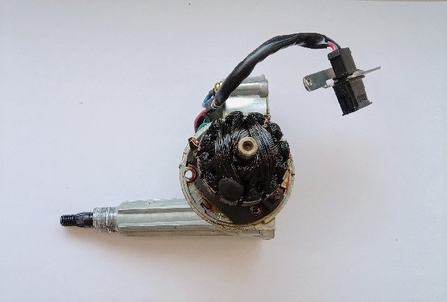

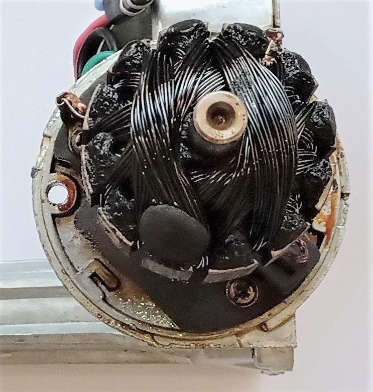

Here is that damned VIKA motor, still stings and i will send it to recycle bin today.
Winding is totally burned.

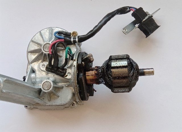

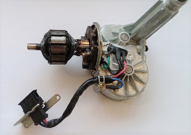

The brush broke and jammed the motor see one contact of the armature is completely destroyed and the brush holder is twisted

Due to heat the motor winding varnish was spilled all around and the grease from the side which were the gears was not on them but in the side walls. I don't know these how long would last.
