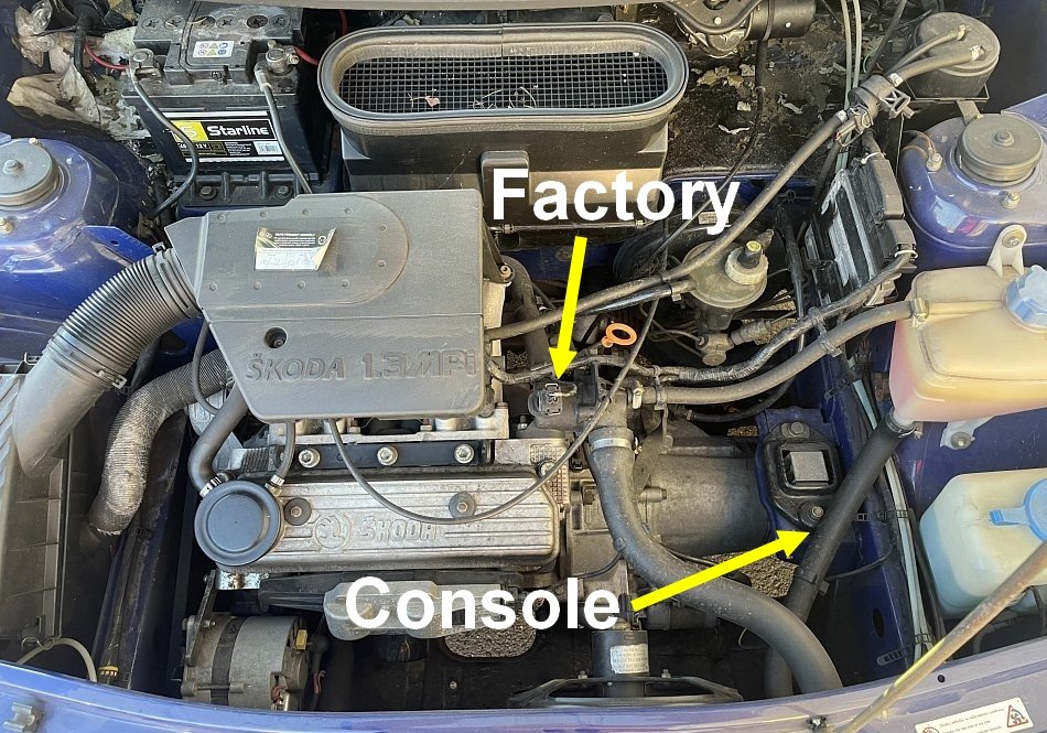

90C on the dial - I forget, have you established how accurate that dial reading is, have you another gauge in your car or off-board, perhaps digital readout, of the same point of source for the dial reading to confirm that reading the dial shows?
The left analogue gauge in the console reads the coolant temperature between the expansion tank and the radiator.
Always is one click less than the one in the cluster.
So different location and relies on accuracy of of gauge and sensor/pick-up/wotsit/thingy and their pairing matching?
The car's original gauge is good enough for everyday general use but for your more precise testing and comparisons you need to stick with whichever is the most accurate measure and allow for it accuracy and precision.
Can not translate them to Greek, no meaning.

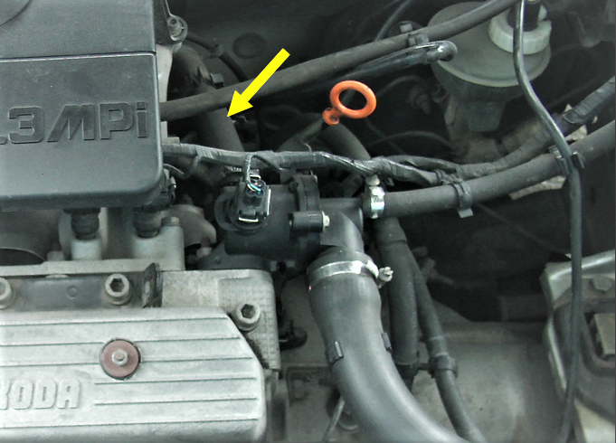

The factory takes indication from the coolant sensor and the after market from the lower hose, when the thermostat is closed of course shows much less, when the thermostat has opened and hot coolant returns to the expansion tank shows one click less because the lines on the factory are not so good in reading.

The initial spot was there, before the factory one
but there was an accident (Chinese metal...sigh)
and i had to remove it from here.
