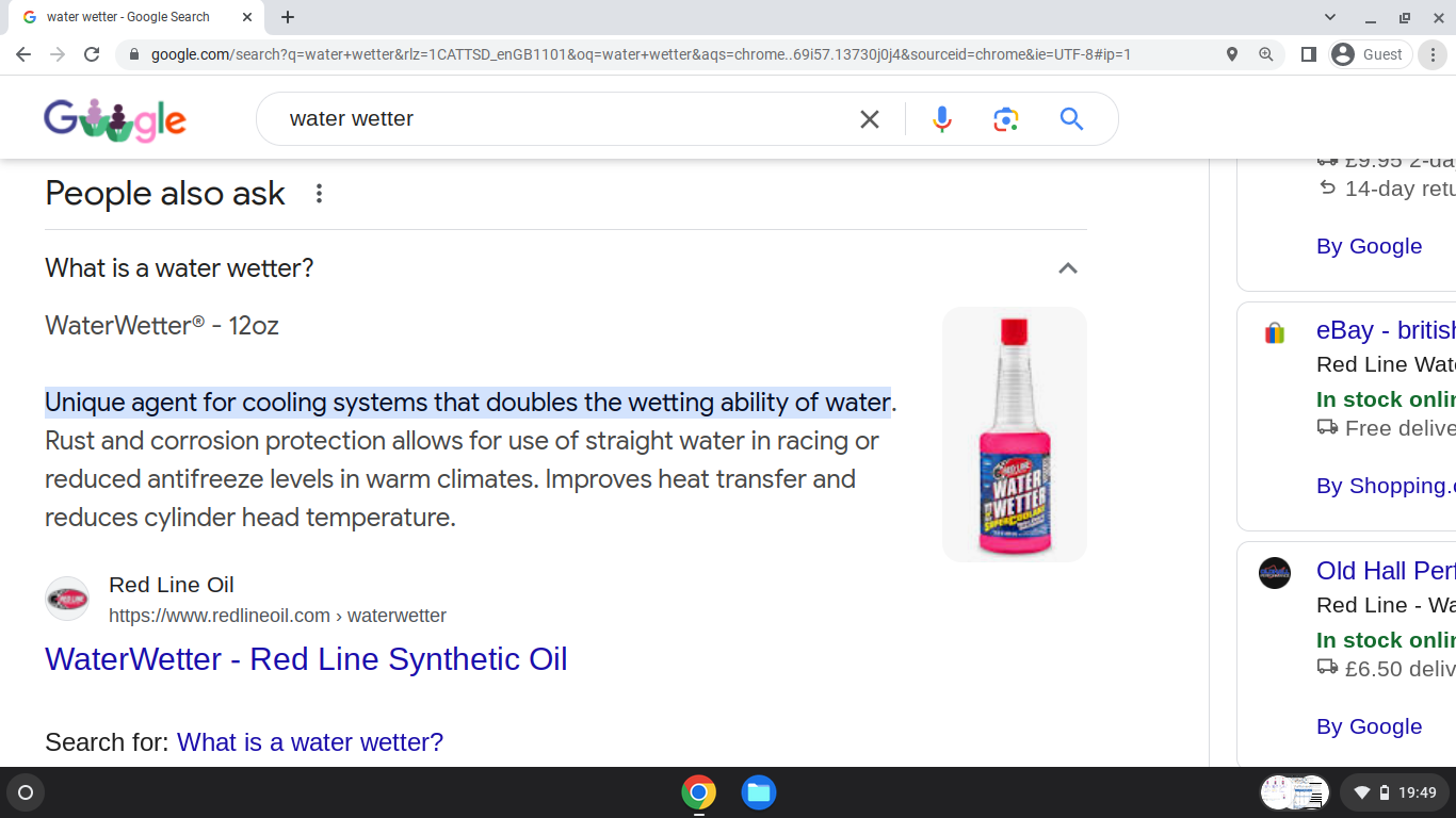

I know nothing about science, but i do know that a cars coolant system has a pressurised system for the Coolant / antifreeze / anti corrosion liquid.
This raises the temperature at which the liquid boils.
When i ran V8,s on LPG i used Water Wetter, So when i ran remapped Twincharger TSI,s i did the same.
