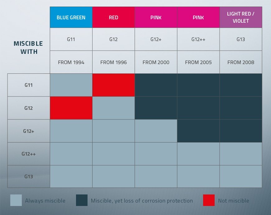

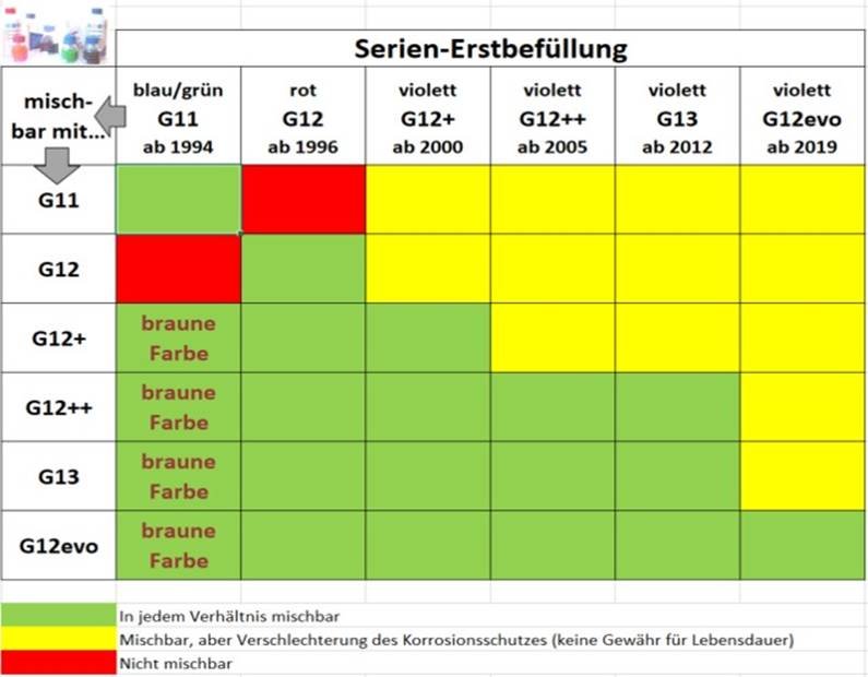

On 20/03/2024 at 16:06, Papez said:
I think that facelift Felicia uses G12, not G11.
What's the benefits of G12 instead off G11 in our engine?
G12 should have better corrosion protection, which is crucial on these engines. But you have to flush the engine properly, as G11 and G12 don't mix well. G12+ supposedly mixes better with G11, but I wouldn't risk it.

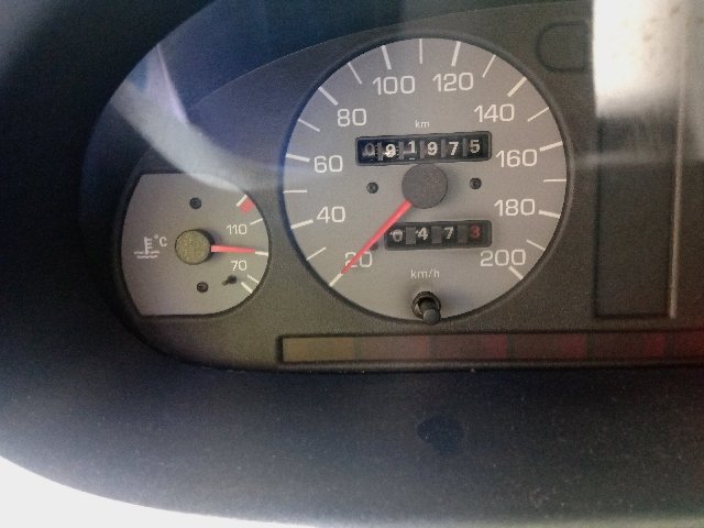

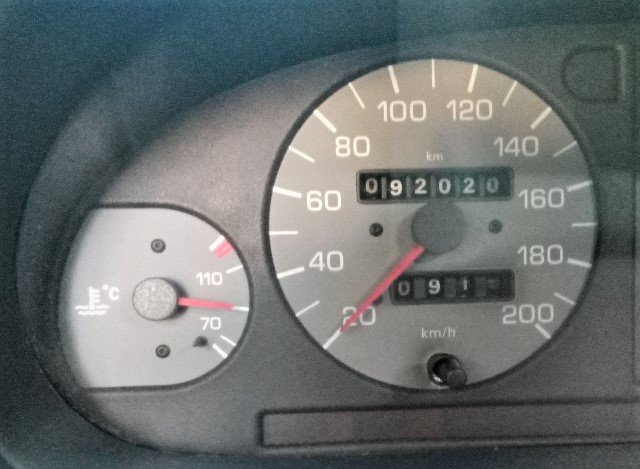

I want to move to the G12 but take a look my G11 today, at least 25 Km distance at noon, under the hot sun in very hard City traffic situation, i was moving like a taxi but when i finally parked take a look at the gauge.
The G12 is going to give me better or at least the same protection against overheating?

I was in a fuel consumption test in City traffic, 1-2 o'clock at noon under sun.
